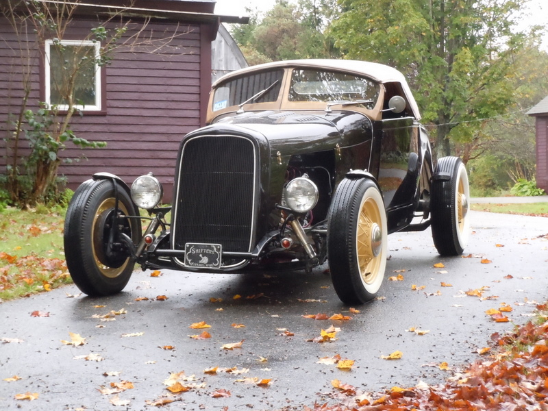

    Hey we could use all the help we can get could tell us where this is a " LITTLE OFF " ?

    Maybe the guy that made the windshield frame extensions ****ed up ! Rick

    OK...I saw the original post and now the new post. Rolling Bones build's great cars, no question. So as per the first post...... this "expert"...thinks some kind of "visor", or maybe an extension over the windshield posts.
    By the way, I have to think of a way to make a top for my rpu that I streched. So if I make a **** top let me have it! Your's, though cool, is just not right.

    It's a small picture there is a hood over the windshield by the way IT"S RIGHT

    just a little over the windshield........
    [​IMG] It would look righter.

    About 1 1/2 inches the windshield lays back at such an angle that it's deceiving in the picture.

    I think if the header over the windshield extended a total of 3-1/4" over the windshield, enough to hide the upper part of the windshield frame, it would look much better. By doing this, the top would be longer and looking more proportional with the car. There is also a problem with the angle of the rear part of the top. It is not enough. Don't think the rag top allows for the right angles for a two-piece windshield like yours. All-in-all, the top looks as good as can be considering the limitations. Looks awkward/ungainly tho.

    Here are some larger pictures of my non folding top

    *****6 is right. On my project I plan on extending the roof line, thus creating an extended visor, but my windshield is straight. I wonder if making a straight header on the Hal**** windshield, extended maybe 2 inches from the center bar of the windshield and being a visor over the swept back portion would look better then trying to match the swept back sweep of windshield top?

    if you notice the gl*** on the bones roadster it is larger and straighter across the top, no? without the top, from pictures i've seen, it looks like it has different gl***.

    answering myself. just so i don't go crazy. look at the first pic compared to the latest. different. changes the angle of the dangle.

    I'm not good with the pictures for the hamb either , I have to have Emily who runs our site reduce them before I can get them to go on. When the owner decided he wanted a top after the roadster was almost completed it was soon obvious that the only way would be to make removable out side post extensions and aluminum spacers between the gl*** and top header . Unless you make them match the center in height which in our opinion didn't look right you have the problem of making the top material go in three directions as it comes forward from the center bow. Since we wanted a folding cloth top rather than a ridged one piece formed one we modified a set of 32 irons and bows and made the hooded front header bow.

    This is one of those times. I'm no builder. I will never have the chops of an outfit like Rolling Bones or the means to employ them. I am just a guy who loves hot rods and asked what I thought was a simple question. And the answer I have arrived at for myself is that a top simply doesn't look right. No one has posted a shot that has convinced me otherwise. That's good enuf for me. No offense intended to anyone in this thread. Can we just stick a friggin' fork in this and be done with it.
