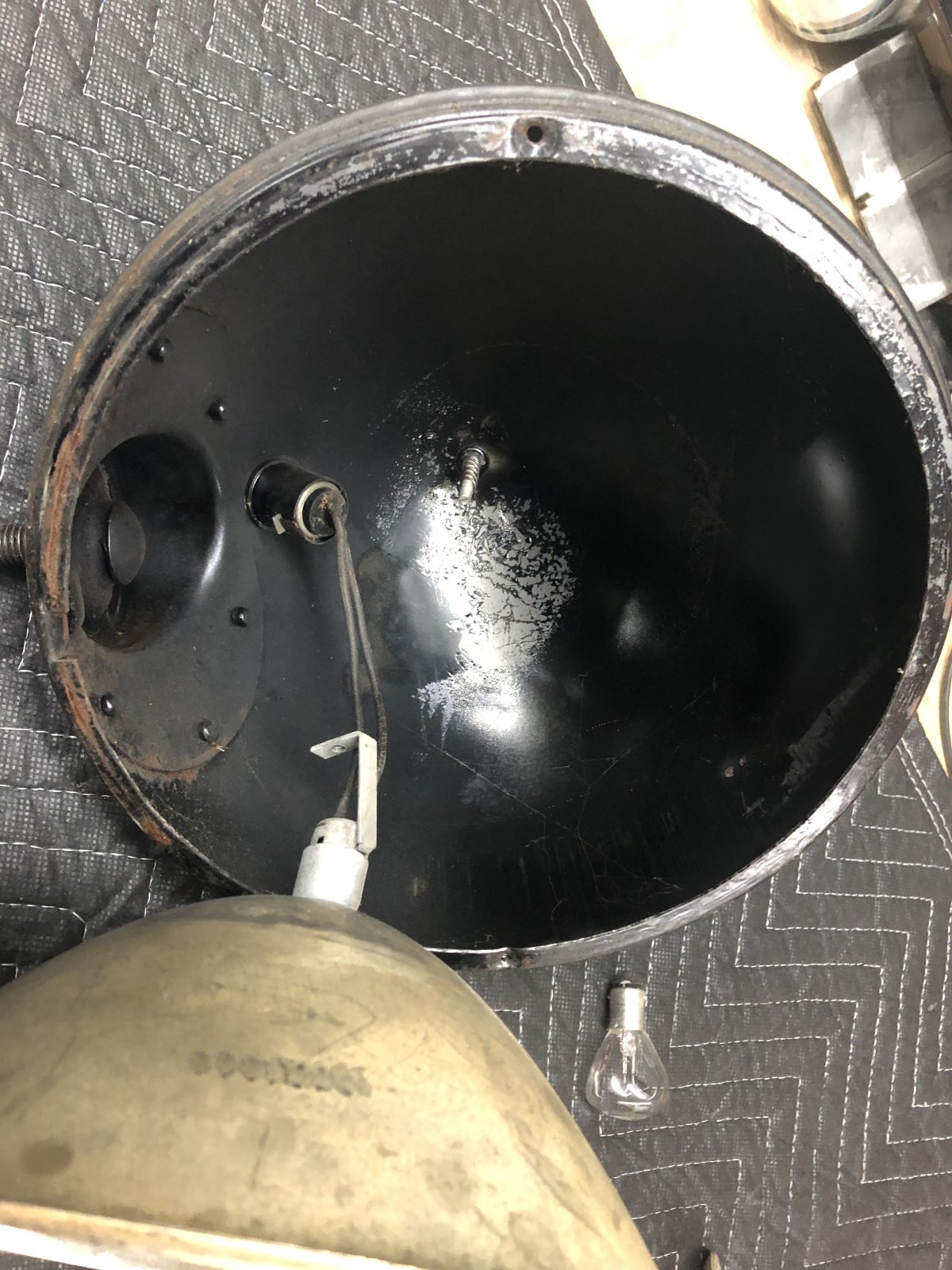

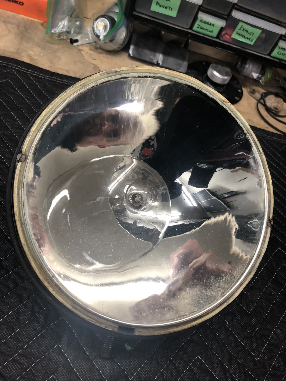

    I have a 1930 Dodge Brothers DD6 with original headlights. The diameter of the reflector is 9.25” and I’ve been looking for a halogen conversion with no luck. I’ve checked Drake, Brattons, Julianos, Speedway and nobody has availability.The car has been converted to 12v. I would like to have a hi/low in the headlight and use the original buckets.
    Any experience finding a replacement for just the bulb that will work with the original reflector? Is the reflector OK with a modern halogen? Is heat an issue?
    I would also consider an LED.
    Thanks in advance for any input!

    Use Motorcycle H4 LED replacement bulbs, thry are very bright and low current.

    Ther are 12v 35/35 BA15d Halogen bulbs available. Direct replacement for originals.
