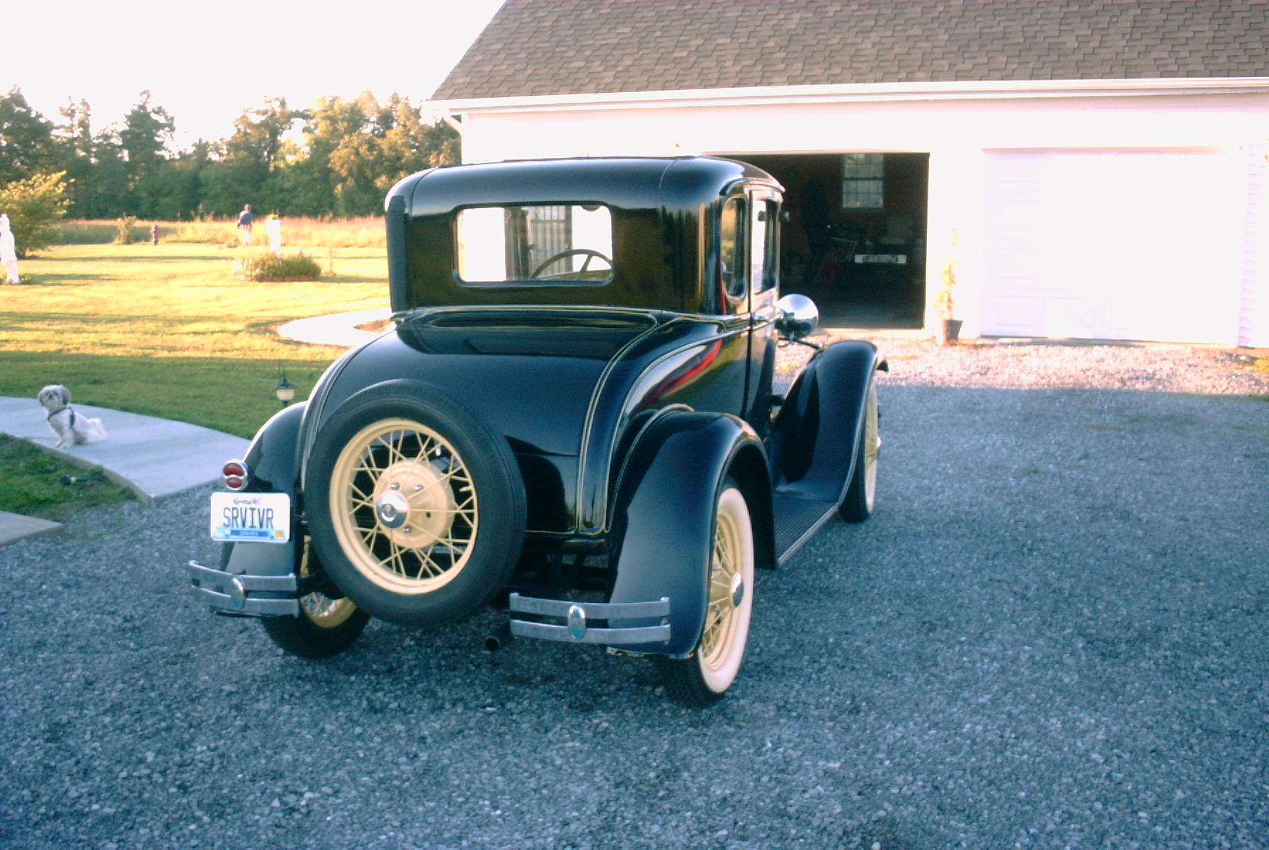

  4. miraclepieco
    Joined: Mar 17, 2011
    Posts: 103
    miraclepieco
    I'll be club Treasurer; everybody send me $20

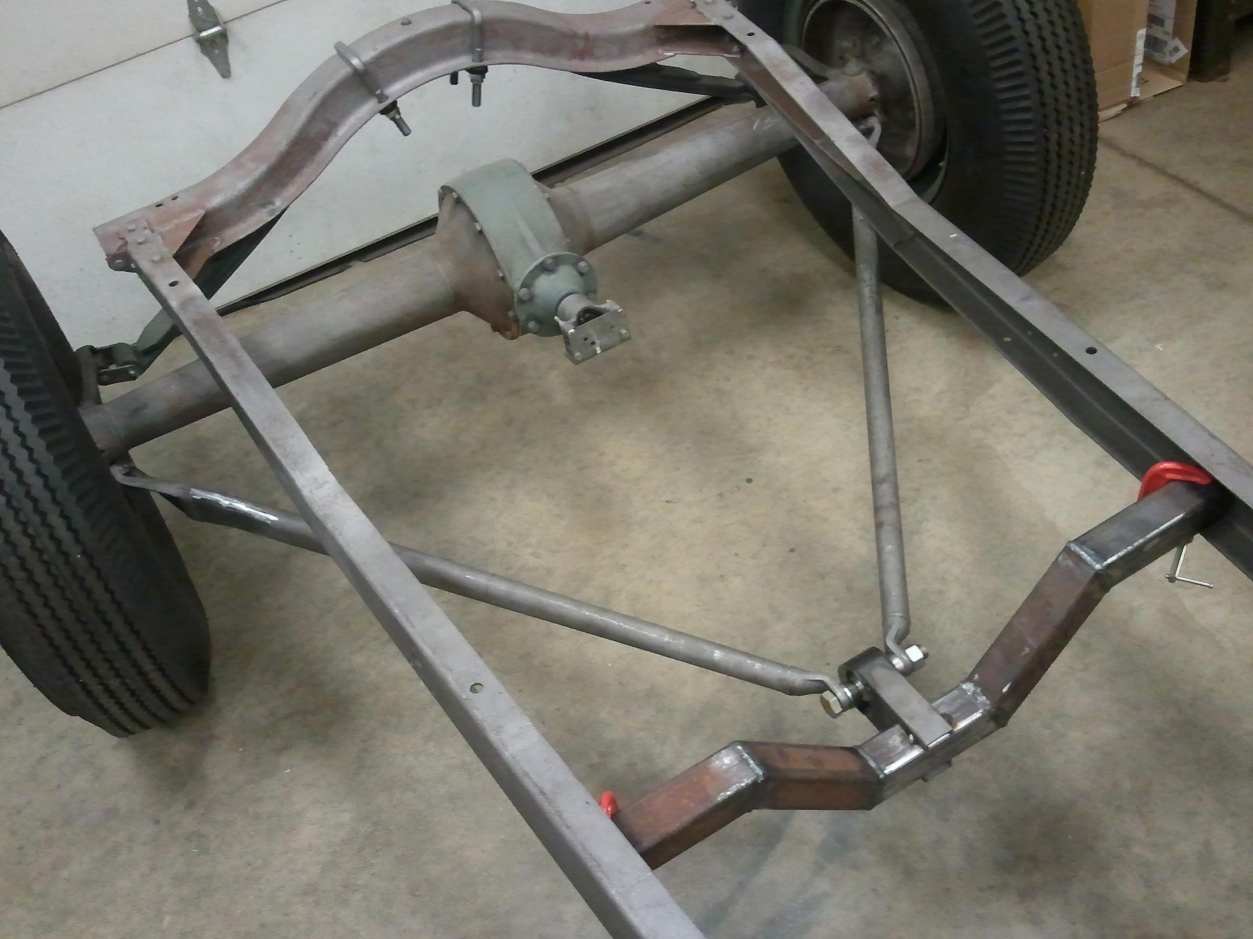

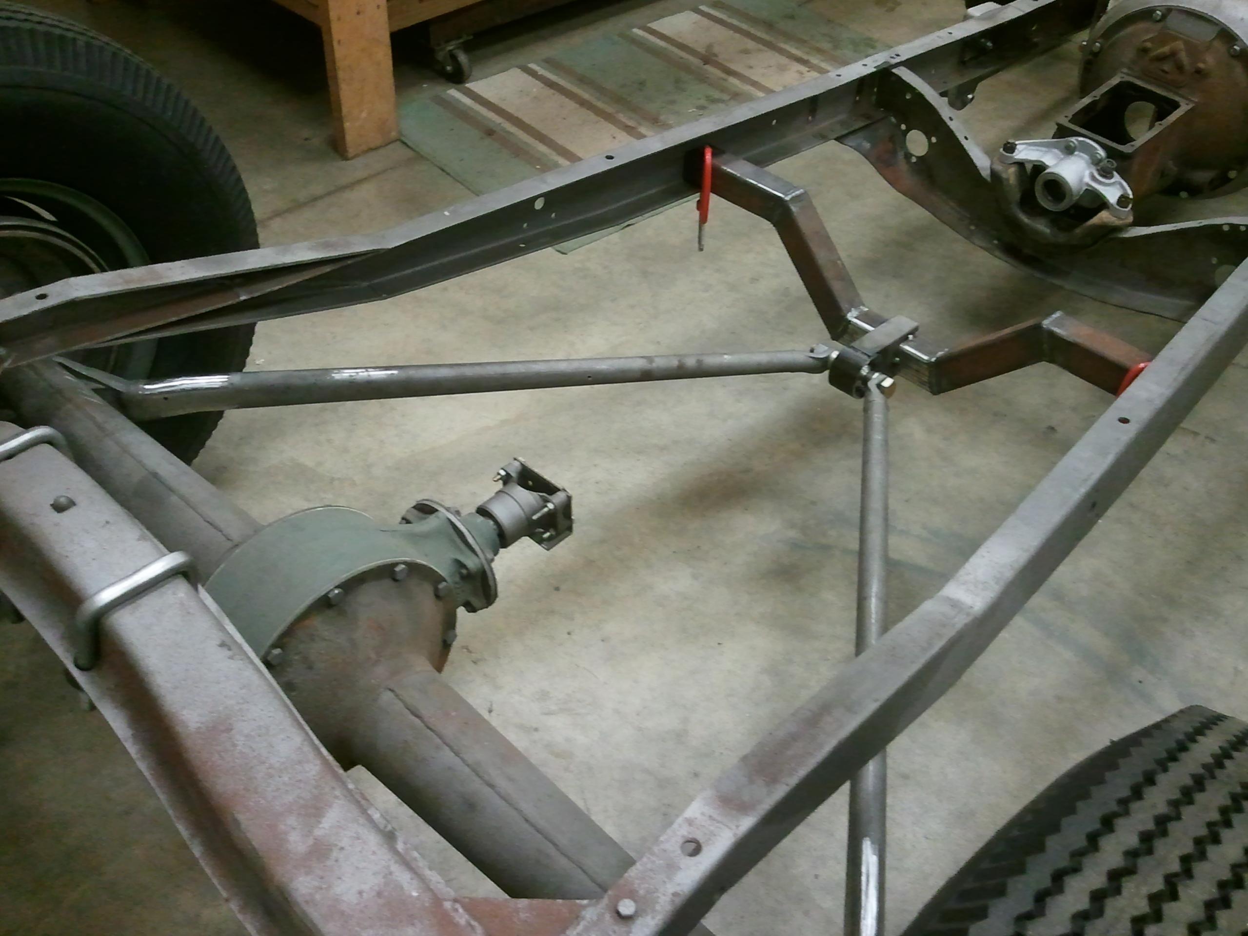

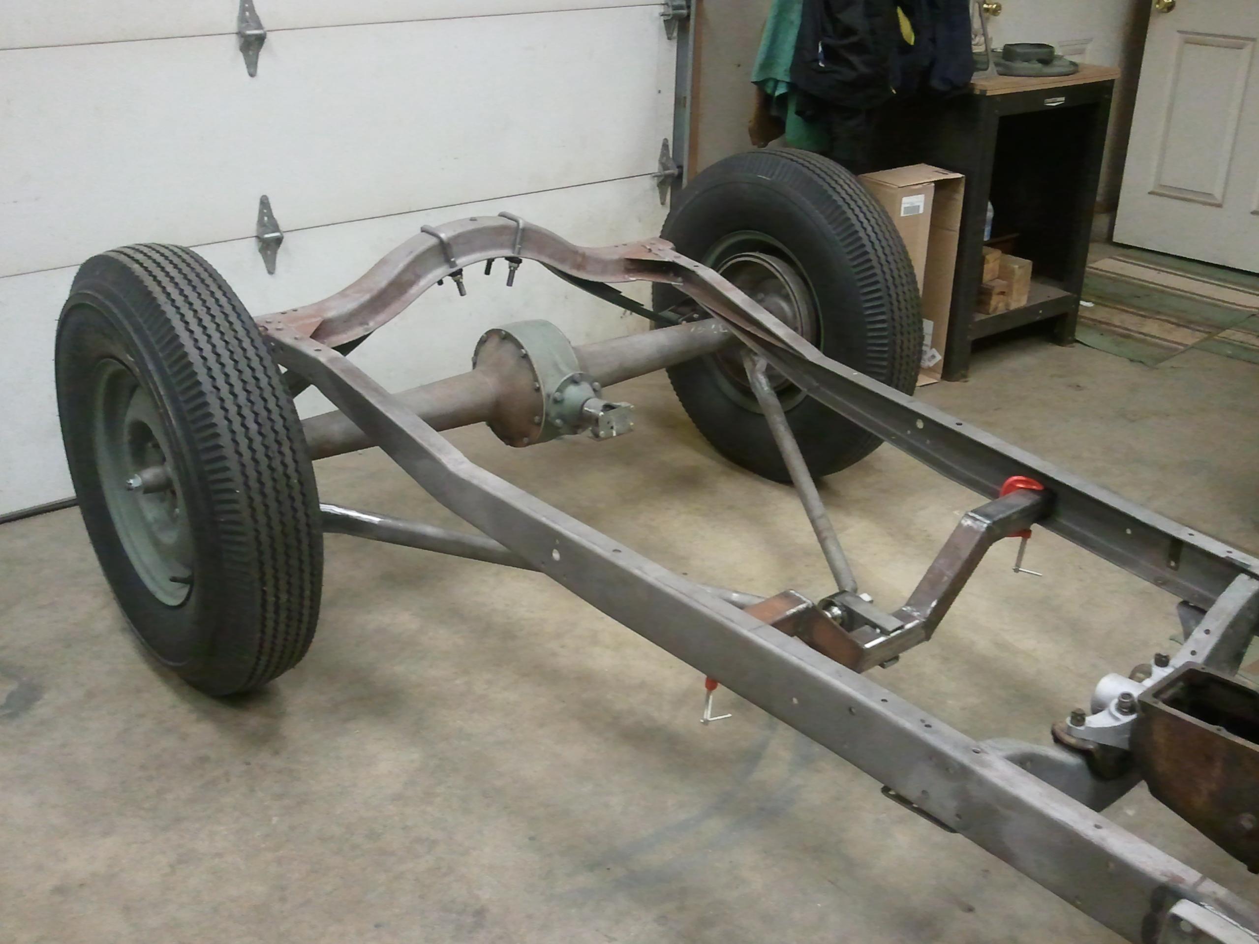

    Thought this might be of interest to some folks. Rear axles, I prefer Ford Banjo's and Ford radius rods above all others. Just my preference, nothing against folks that use others. For me, they just look right under an A. I scored a 42-47 open drive banjo center with good 3:54 gears, good for long distance cruises. I put that together with 37-41 bells, axles, and spiders. I put an open drive 39 style trans together converted to open drive with all Ford parts. So, what to do with the radius rods? We've all heard that splitting them leads to binding/breakage as does the torque tube not being there anymore. A torque rod will take care of the torque tube being absent but still, what about the radius rods? I found a thing called the "Uni-Ball" that looked like it might be the answer I was looking for. It's basically a Heim with no threaded portion that fits into a "Cup" and is secured with a snap ring. It has 32 degrees of movement up and down on both sides due to what the manufacturer calls "High Mis Alignment Spacers". So I built a mount for it, shortened/pie cut and tipped down the radius rods and put it all together. I'm going to add a torque rod from the top of the Banjo housing to a mount on the right hand radius rod to control pinion movement. I'm also going to add some sort of bracing to tie both radius rods together just behind the Uni-Ball. Should allow things to operate without binding like the bell shaped end of a torque tube.

    F-6 that is cool.

    Thanks man, we've been cycling the axle up and down, it lets one wheel up and the other down just like a torque tube would when you go over uneven roads etc. It look's like it's going to operate good.

    Awesome! I'm totally stealing this idea.

    It's $100. there are cheaper parts like the "Uni-Ball" but this one looked like I wouldnt have to worry about it being strong enough. Here's a link to where I got it:

    sounds like an excellent plan Scott, please keep us posted

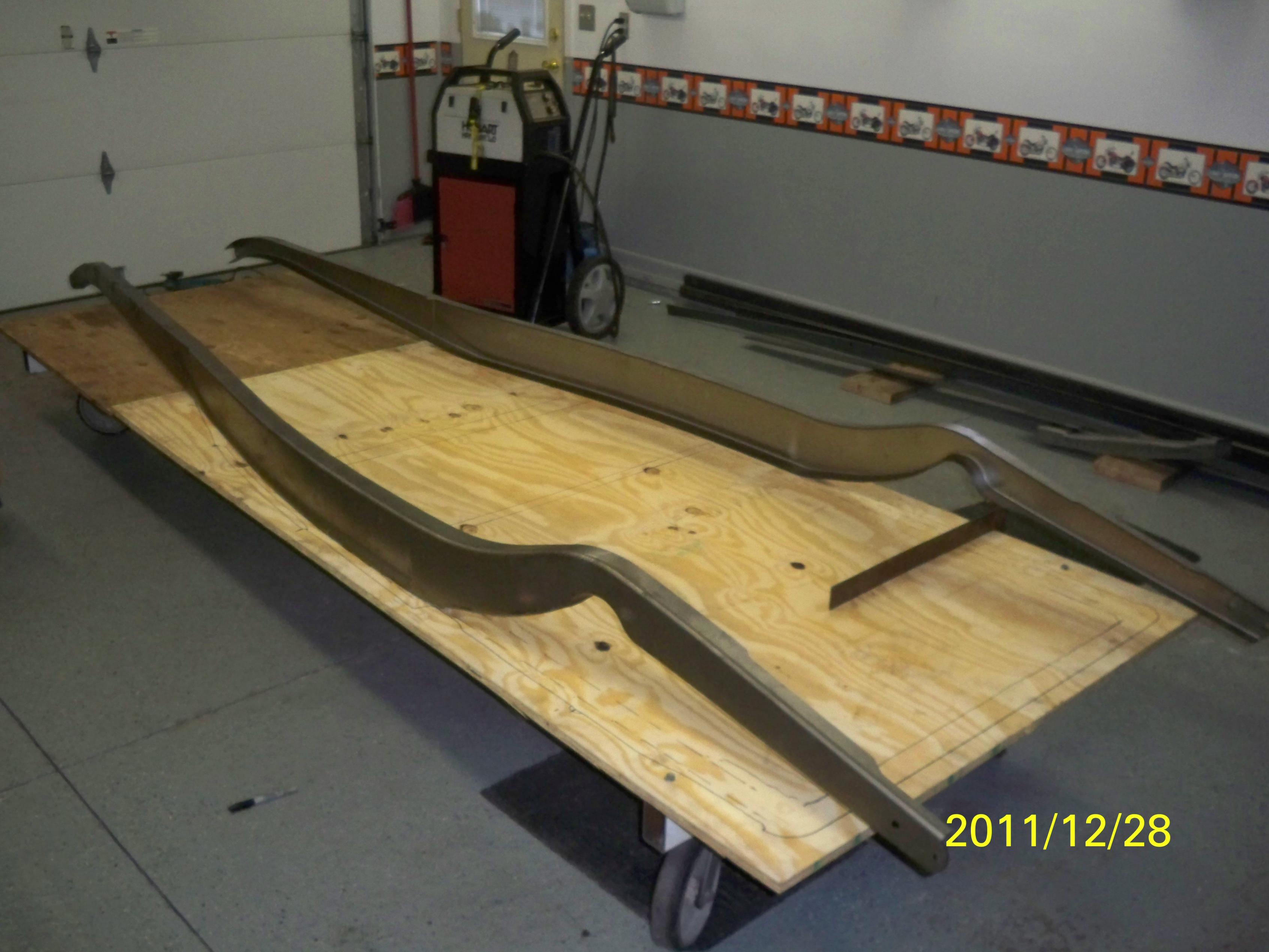

  18. I want to be a member too!! Been collecting parts for a project when I retire in August, but just can't wait, so I started on the frame.
  19. F-6Garagerat
    Joined: Apr 12, 2008
    Posts: 2,652
    F-6Garagerat
    man thats a nice roadster body
  20. F-6 Thanks but it's an 80's something GL*** body,--I know,I know not everybody wants a gl*** body, but the price was soooo right that I COULD NOT p*** it up. The body is 20 plus years old and has never sat on a frame, go figure. Will I'm going to make me a nice little hot rod out of it.
