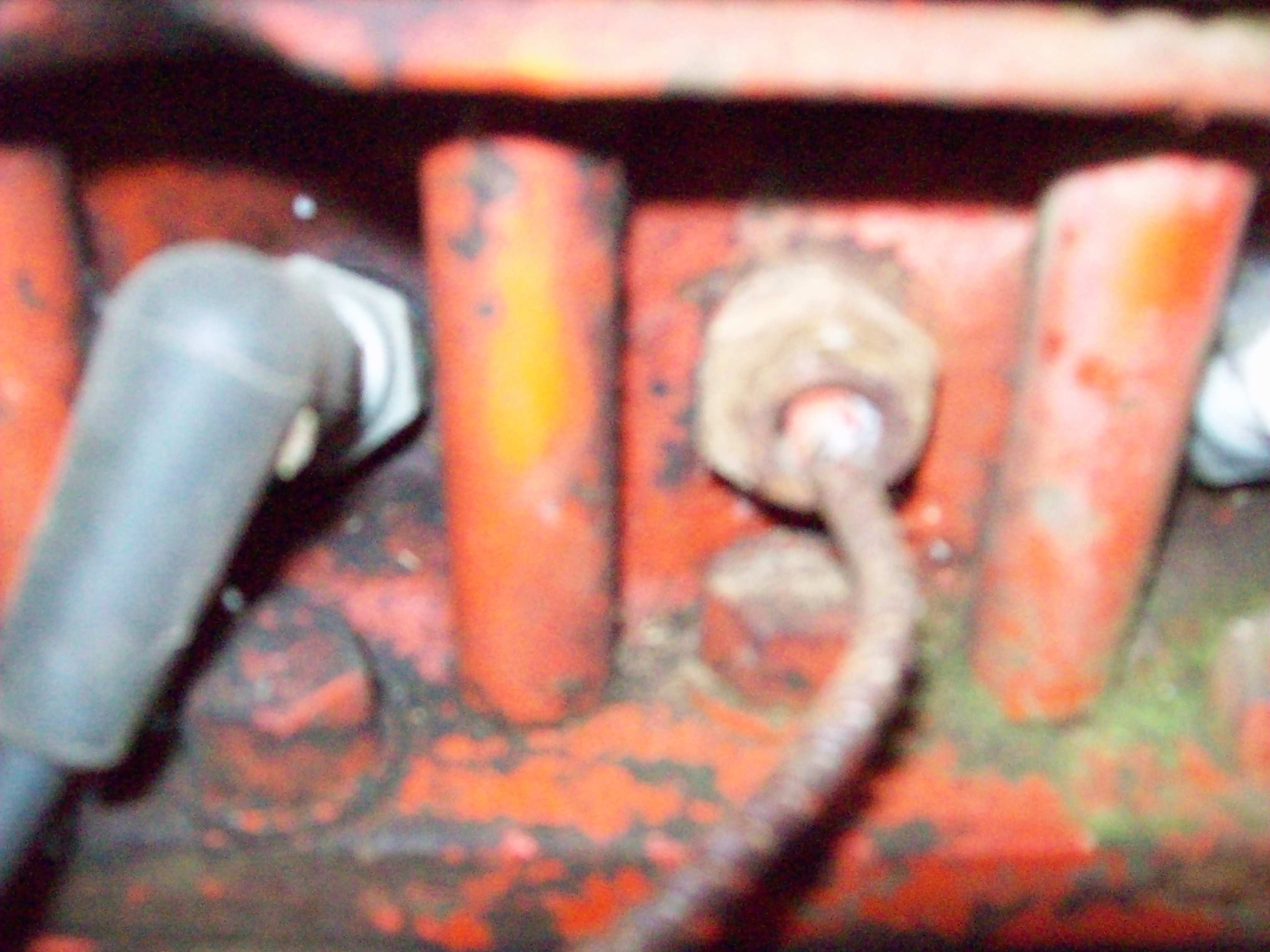

    I'm working on my OT Case tractor and am having trouble removing a sending unit from the head. The sending unit isn't detachable from the gauge in any way that I have found,so this makes using a 6 point socket a no go.I can get the sender out by cutting the wire but I don't want to ruin the gauge so I'm looking for away to remove the sender without cutting the wire. I have tried using a tubing Wrench but the sender wants to round before the threads budge. The threads appear to be pipe threads (tapered) so once I can budge it I think I'll be golden! I'm not sure if the photo will show but the head casting stands above the threads making it difficult to get a straight bite on it with a wrench,pliers or vise grips.I'm a bit reluctant to heat it in fear of damaging the sender. I know there are some REAL resourceful folks on this site, any suggestions of ideas that I've missed? (please spare me the sell your Case suggestions)

    Soak it with PB Blaster then try cutting a slot in a socket for the wire to slip through then after you have it in place, put a couple of hose clamps on the socket to keep it from expanding.

    I think you are going to have to bite the bullet and cut the cap tube. Pics is a little unclear but it is likely a two piece affair the cap tube screwed into an adapter that has the seat and pipe thread to go into the block. so there are actuall two pieces that you'll have to unscrew individually. If the cap tube nut isn't loosened then if you get the adapter loose it'll want to 'wind' up the cap tube since it can't turn.
    If this is a critical one-of-a-kind item heres what you can do. Cut slice out of a sixpoint socket, wide enough for the cap tube, and weld a handle off to one side to turn it with, in effect you make a deepwell tubeing wrench.
    Good luck, i love an old tractor.

    You might also be able to heat and bend a flare wrench so that it will seat down around the casting.

    The sending unit is 5/8" and I' not sure if you can tell from photos but it threads into a bushing that i think is 7/8" to 1".The sender threads to the bushing,the bushing threads into the head . . Those slotted sockets look like the concept, I have some duplicates in those sizes in my impact sockets I may try to slot one myself. If not there is a Sears about 1/2 hr away. Thanks for the help guys I see on a regular basis that there are a bunch of guys on here sharper than me...proven again:rolleyes:!I wish I'd have known about those sockets a couple of sender/gauges back.

    The slotted sockets combined with patience and Kroil can get these thigsd out of the Case head - it took me close toa week to get mine to come undone. If the worst happens the gauge can be repaired by any number of the guage rebuilding comapies, buut costs in the area of $125 or so. Not an uncommon problem with old tractors and old cars. Heat is not good unless it is kept low to only help the penetrant to work its was in. The end can easily handle high water temps, but try to keep heat under 250 degrees so the solder jont does not melt out.

    Thanks,right you are that is why I'm posting here instead of out looking for a new gauge like a younger Rustdodger would have been.The slotted socket (home made w/clamp)worked like a charm!!!
