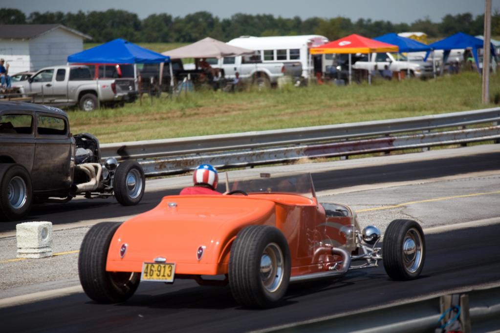

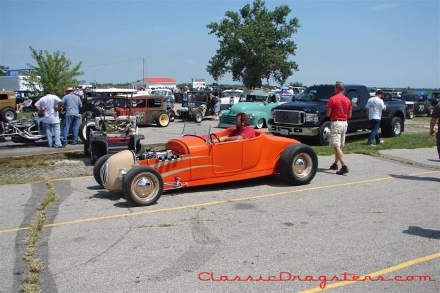

    It was a great weekend even with all the problems. I can't wait for next year. Dean (ps) I like these two pictures.
