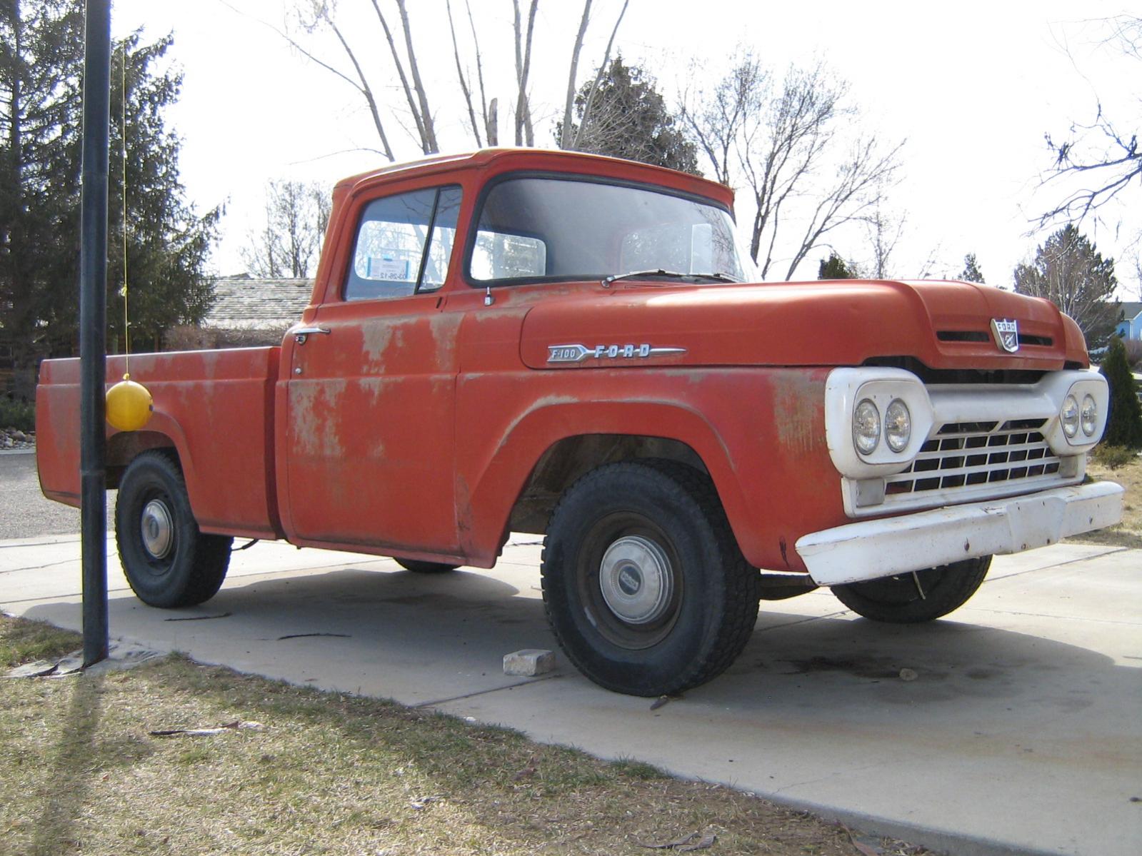

    Hopefuly noone really cares about my sub frame,but its out of a '65 GTO! I thought"no way I'm sub'in my '60" but,its free(how much $ are sids axle?),and correct for my goal of mid sixtys hot rod,AND,my wife loves the truck but cant control the wandering beast and shift the ol4speed!I am impressed.a old ford or buick430 or 472 cad,havent decided but the 429at is free,so that makes it,I have a FREE upholstery job comming,all the ac parts,and the only cash I'm in the hole project will be wheels(maybe)! I AM STOKED!:D

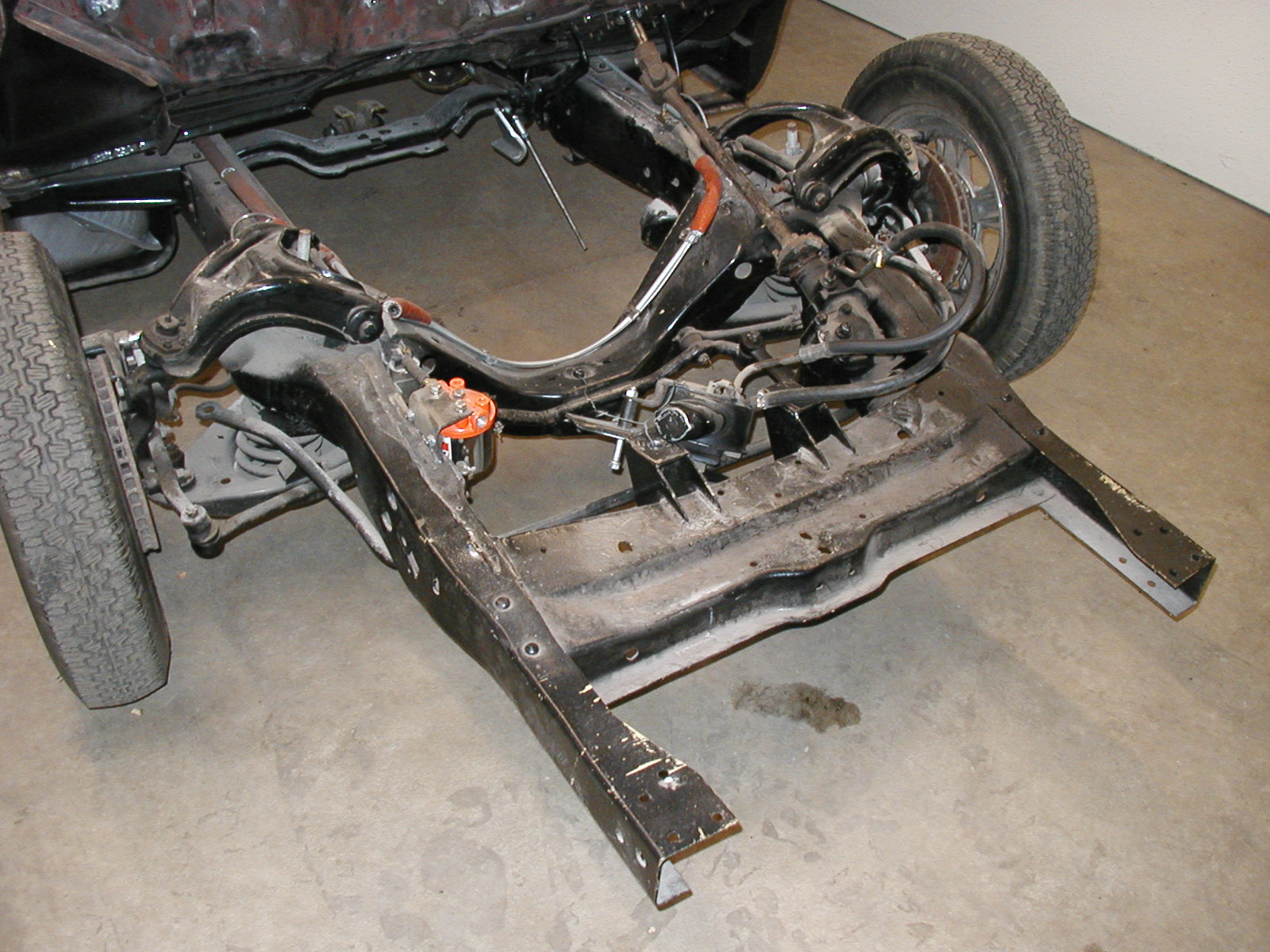

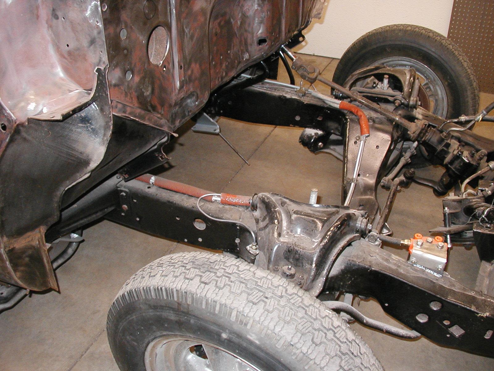

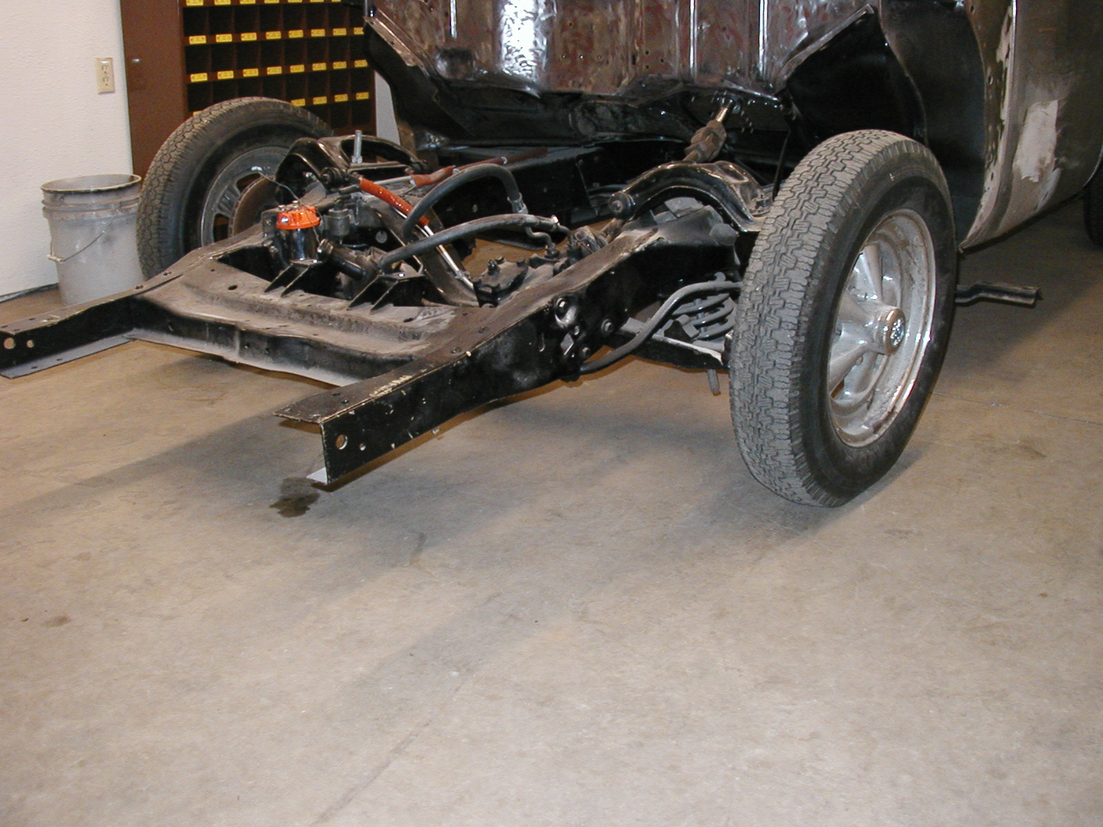

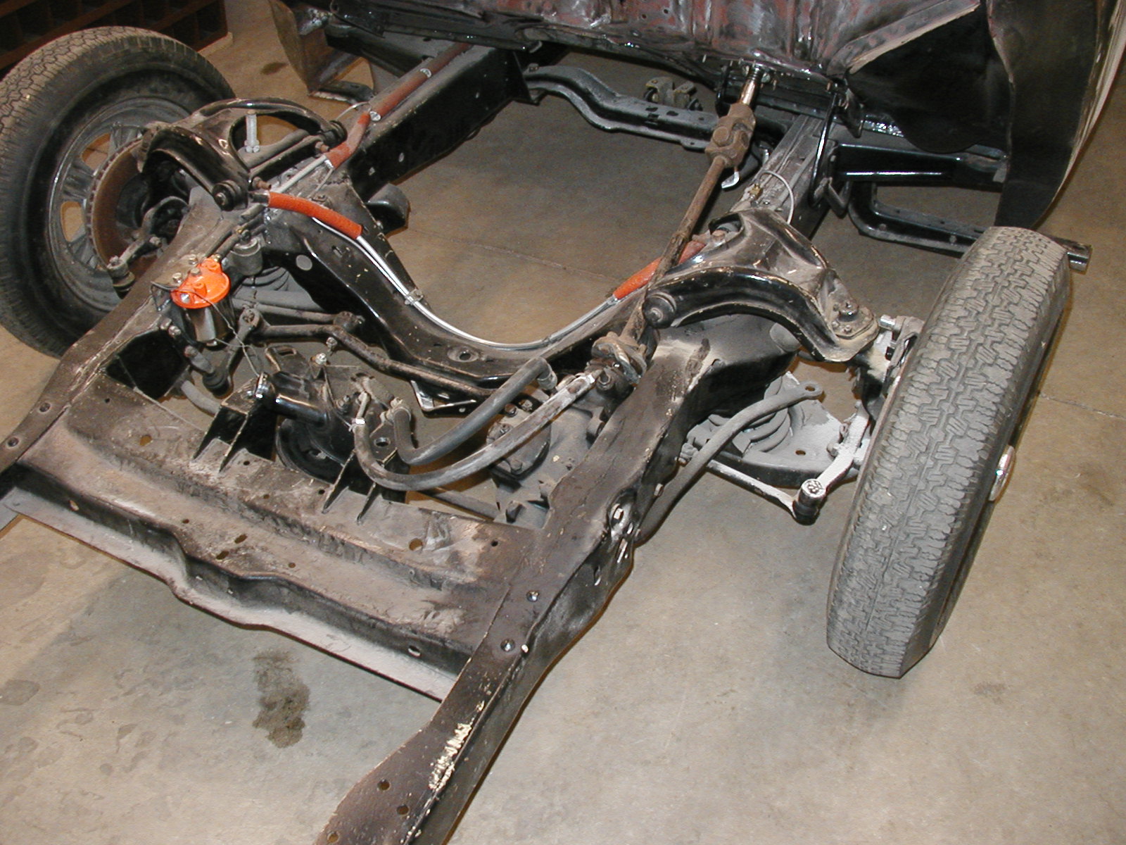

  19. Just do it. I've done countless numbers of them and started in 1968. That was before most of these Nay Sayers were born. This is my personal F-100 done back in 1972. The sub is a Chevell same as the GTO unit. I've done M-2, Volarie, as well and if I were doing another one for myself it also would be Chevell- GTO or Nova. It works well, fits well, Drives hands down better than any kind of M-2 platform kit you can buy. Installing a Ford motor on it is no problem. You gotta build mounts no matter what you do.
    Tradition is subject to personal point of view. If you weren't there your dealing with second hand information.

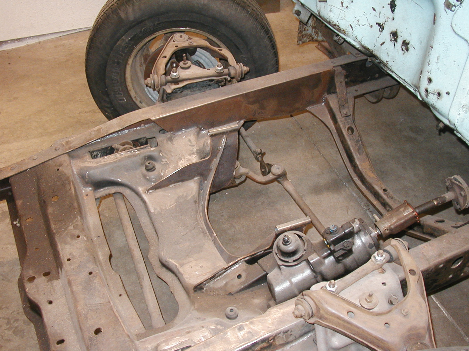

    I also included a shot of a Volarie unit. This truck got a 351 C motor put in it.
    I've made a lot of $$$ doing them but never did one for myself. There is a reason for that.

  23. Volarie Unit on a F-100 is just not the best answer in my book. If you want to drive a Volarie for a Kid Hauler I guess I could understand that.
    Use the photo's at your own risk.
