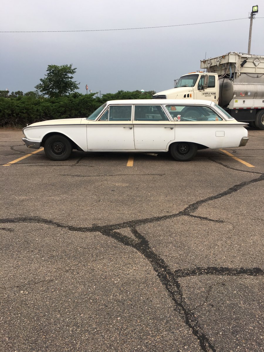

    image.jpg Hi everyone,
    I know it is a long shot , but I just picked up a 1960 Ford Country Sedan in CA and am on my way home to MN. IN Sidney Nebraska I pulled off the road due to a noice and it looks like the outer wheel bearing seized and welded itself to the spindle. It took out the drum as well.
    Does anyone in or near the area have a front drum that would work? It’s a wagon so it has 3” wide brake shoes.
    Wade

    the race that is welded to the spindle is hard which means a solid hit with a hammer will crack it and you can get it off. get a new wheel bearing and "knurl" the spindle and hub with a hammer and center punch so the parts will fit without spinning. that should get you home. while you are there you better repack the other 3 bearings....

    We got the outer race off the spindle. The hub is way too far gone on the outside. I probably have 1/4” of play on the race to hub on the outside.
    If I can locate a hub I should be able to put my old drum in the new to me hub.

    The car is now in Ogallala NE. At least they had an auto parts store that was open. I have the bearings and seals but the hub is pretty much impossible to track new ( a long shot I know).
    I am thinking the U Haul might be the option to get the car home quickly. Hopefully they will be open in the morning.

    Look for a machine shop in the area (fat chance on Labor Day...) that can make up a sleeve to salvage the hub. That will have to be put on a lathe with the drum to clean up the I.D. and accept the repair sleeve. Press in the repair sleeve and race... good as new. Probably a 3 hour job at the minimum.

    The update is that we were able to source a hub but we might have to move the existing drum to the new to me hub (wagons have wider brakes). I will likely need a machine shop to help with that piece.

    image.jpg New hub secured. Trying to find someone to remove the drum from the hub. My guess is that we will be able to find someone tomorrow.
    Thank you to everyone that offered advice. I’ll keep you in the loop. The above is a picture of the good side. :)
