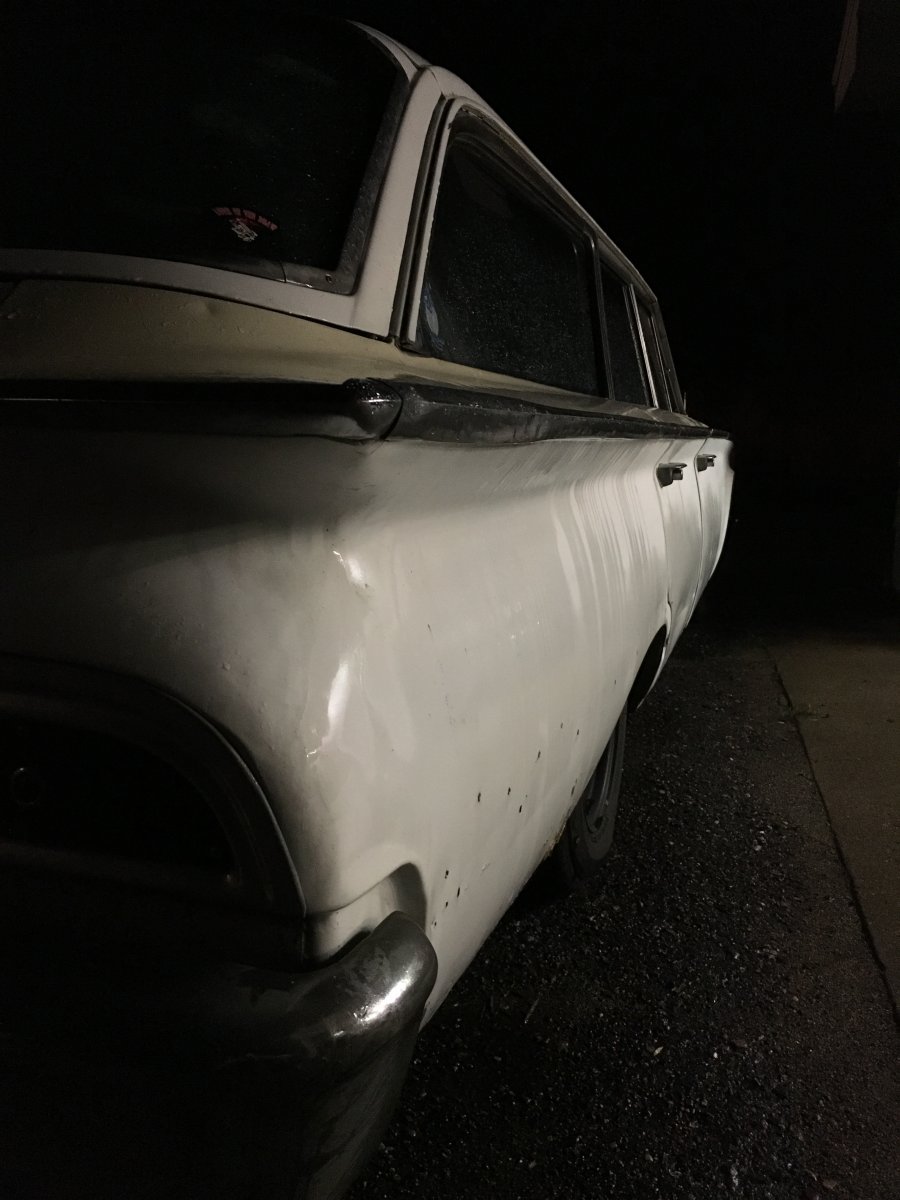

    image.jpg I made it home. We were able to get the hub swapped from one drum to the other. Got it back together. Drove the 700 miles home. It feels good.

    Cool, glad it worked out well for you. Kinda diggin that wagon, what engine does it have?

    352 2 barrel. :)

    That's a pretty clean looking wagon. Congrats on the successful memory-making roadside repairs and getting that barge back home!
    Some more pictures of the wagon are in order...
