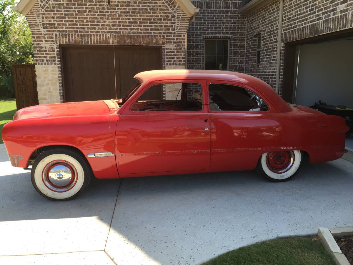

  19. P1020502.JPG I'm in, sign me up.
    Just kinda getting started though.
    consider this a "before" shot.
    MO_JUNK, dwollam, Cooon and 1 other person like this.

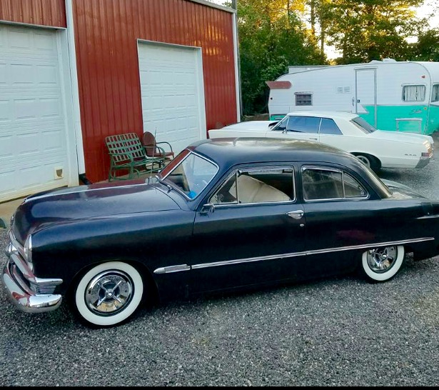

    Duck's Goat
    Here's mine, had it for a few years now. I lowered it with cut springs in the front, blocks in the back. Rebuild the original rear end, overdrive transmission, and built a stroker flatty. I don't get to drive it much due to the girlfriend taking it over, but I think its pretty cool to have a girlfriend that loves to drive a 3 speed on the column.

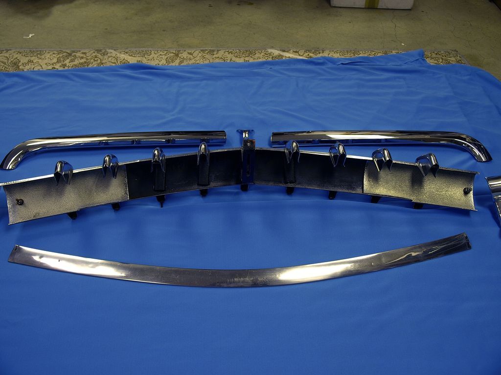

    Whats up guys. Just have a question . Have anyone used the 54 chevy grillteeth on the original 51 ford grill bar. Thanks for the help.

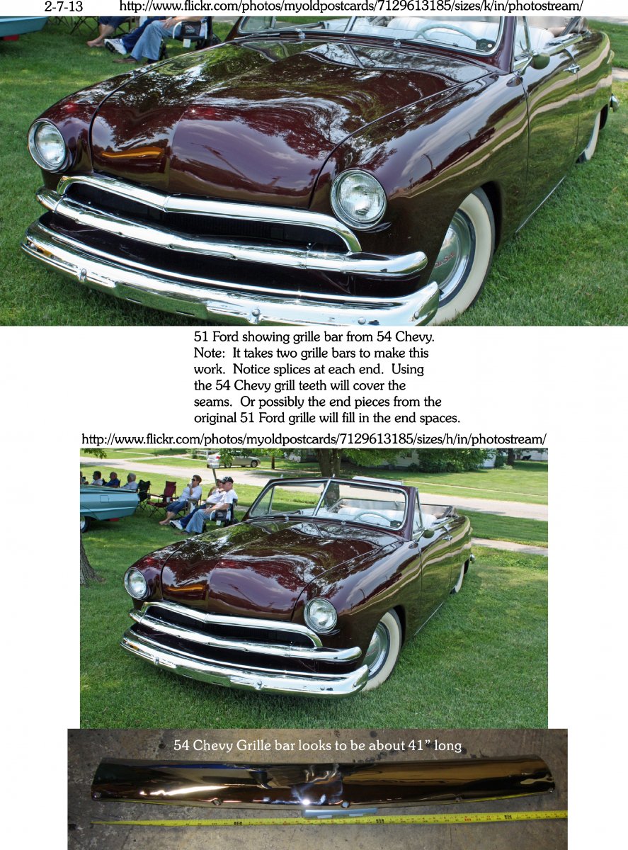

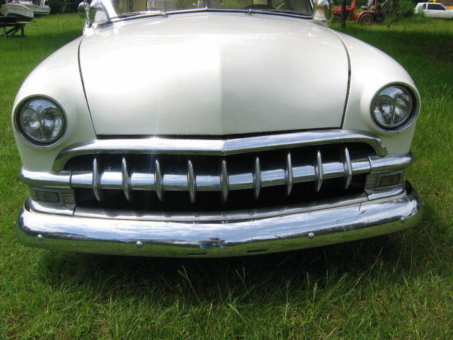

    [QUOTE="Whats up guys. Just have a question . Have anyone used the 54 chevy grillteeth on the original 51 ford grill bar. Thanks for the help. [/QUOTE]
    54 Chevy Grill bar3.jpg 54 Chevy Grill bar with 9 teeth HAMB Shoebox Grilles.jpg Lakewood  50 LF-HAMB 8648345.jpg
    I'm not sure but I don't think the profile of the 51 grill bar is the same as the notched area in the Chevy teeth. You would have to shape the teeth openings to fit as long as they weren't too big in some areas already. Also you would have to drill holes to mount the teeth. Chevy bars are pretty reasonable but you have to use two to span the opening of the 51 between the corner pieces above the turn signals. One bar has to be split, then used on each side of the other bar. 54 Chevy Grill bar3.jpg 54 Chevy Grill bar with 9 teeth HAMB Shoebox Grilles.jpg Lakewood  50 LF-HAMB 8648345.jpg

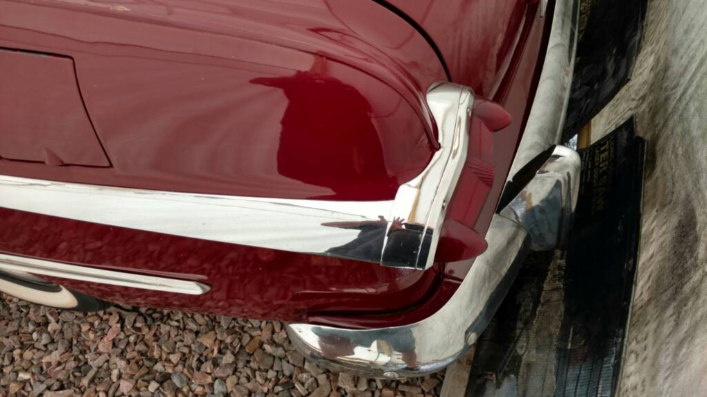

    [​IMG] The 50 Ford in the pictures is the one that i now own. Bought it from HAMB member in Lakewood Washington. I am under the impression that the grille mods were made before he bought the car but I did take some pictures when I was taking all apart for the changeover to Flashback 50 (project is on HAMB). Here are a couple of images that might help explain what was done to make this one 'work'. Regards, bob

    I have the 54 bar grill but now i see i need 2. Thanks again for the tips

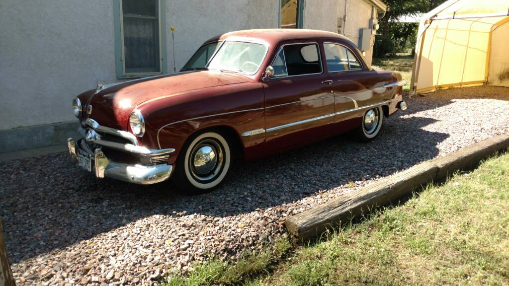

    1BA6FBD4-6B60-479A-82CE-73F98A874163.JPG I'm in I just dragged this one home for the wife. Just gunna get it on the road with the flat 6 before anything major gets done.
