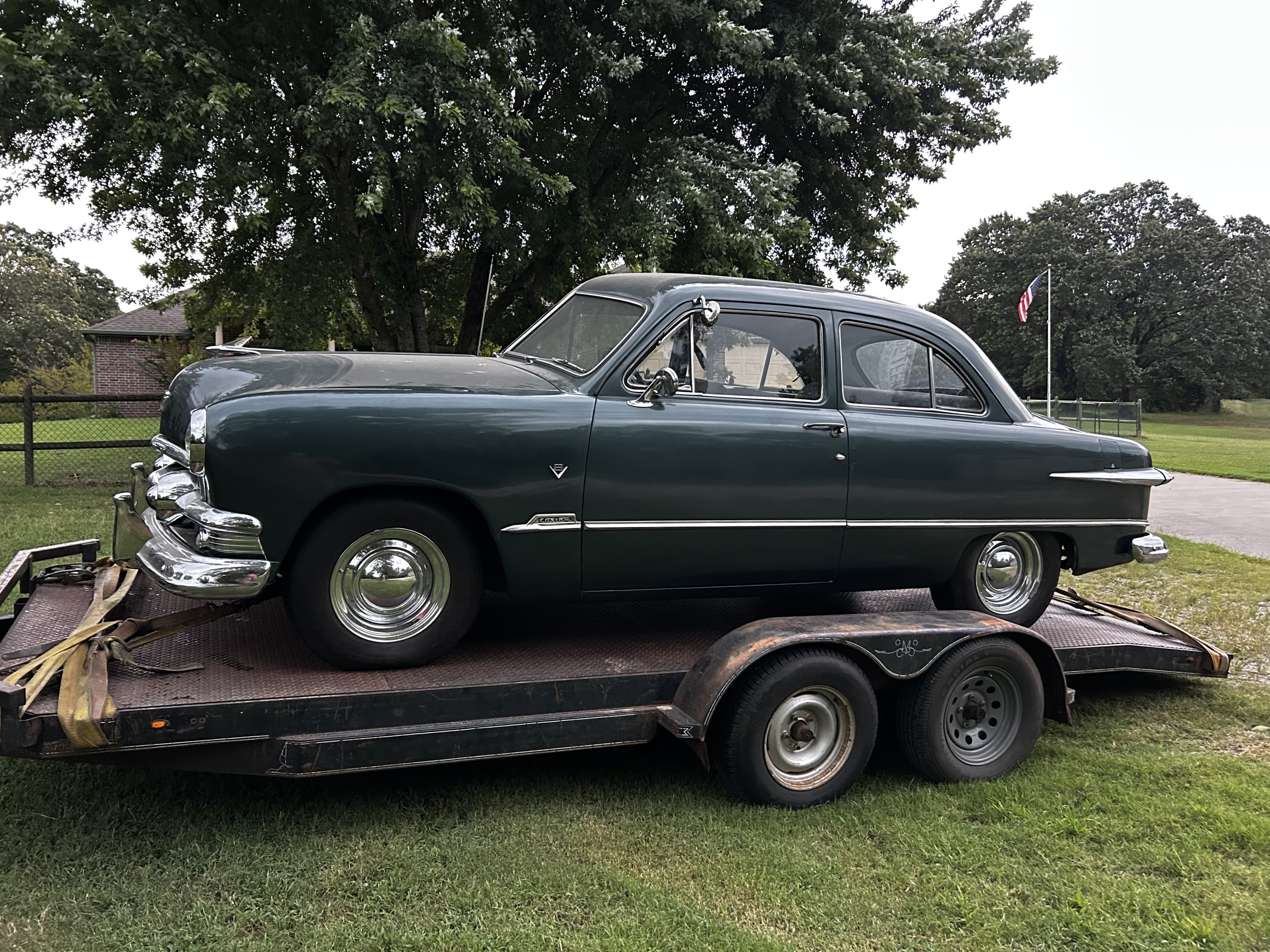

    I guess I have one of these again as of last night. Haven’t even unloaded off the trailer yet.

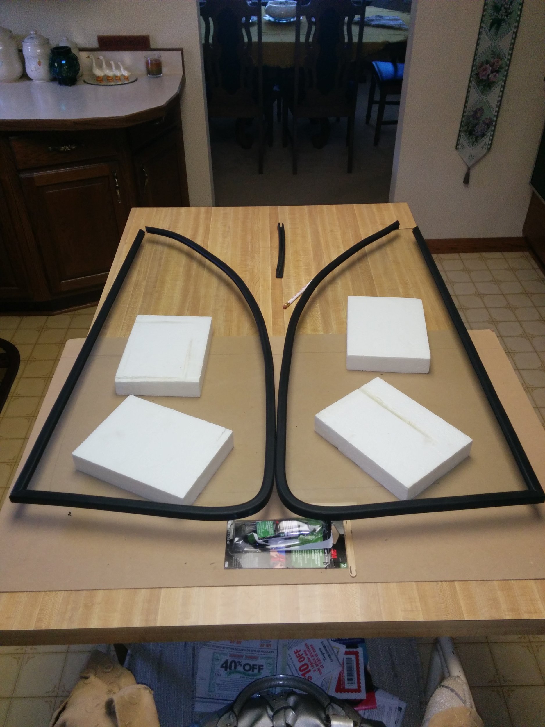

    I made a pattern and took it to my local gl*** shop and told them I wanted it in a tempered gl***. They could do it but it had to be sent out to be tempered so in a few days they called me and I picked them up. I used a double face foam tape they had to install the gl*** and a single side foam tape on the garnish molding to seal it from both sides.

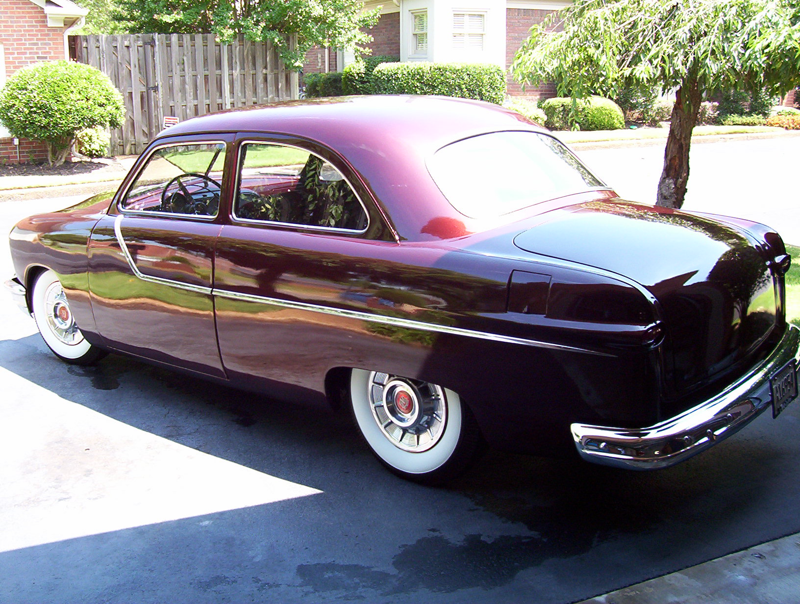

    I replaced the quarter windows after making some wood filler pieces to take up the track space from the removed crankable windows and vent framing. Used 1/2 inch wide one side adhesive weather strip (not the airy foam type but the rubberized seal strip type) to 'stick' to the inside flange edge of the opening. I found channel weatherstripping for the gl*** pane and the combination worked out just fine. You can get any local auto gl***
    house to cut a shatter resistant auto gl*** pane for you. bob
    Jalopy Joker and Rand Man like this.
  20. Bertolasi
    Joined: Aug 19, 2012
    Posts: 298
    Bertolasi
    Here is the closest shot of the rear window that I could find. I can take better views if you need. bob upload_2025-10-18_10-1-51.jpeg

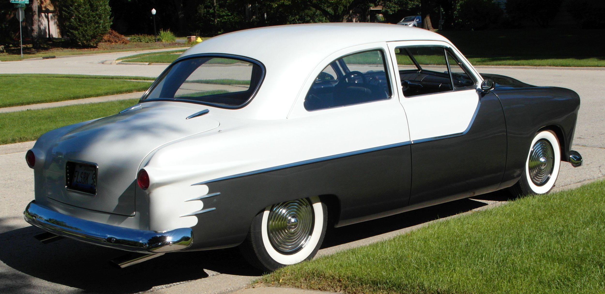

    IMG_2450.jpeg Here is a Photoshop of my sedan with the one piece gl*** back there. I think it makes it look a lot better
