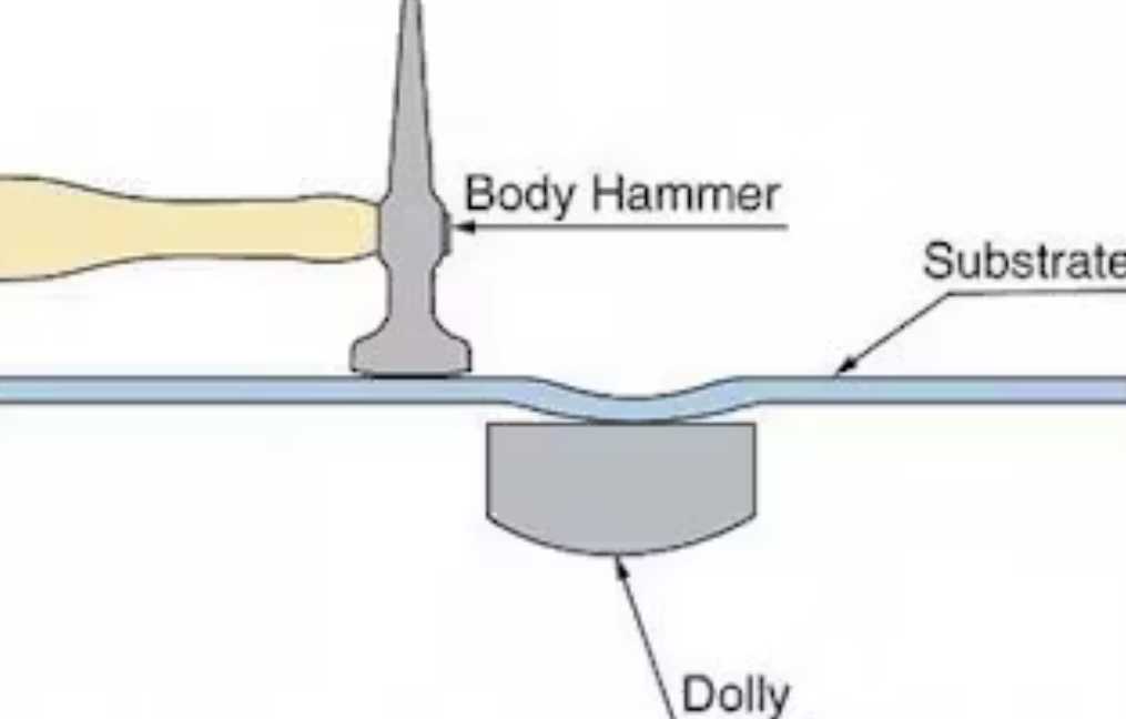

    When hammering and dolly does the dolly go on the surface that is visible from the outside and the hammer on the inner panel?

    So hammer just off the dolly? Is there a use case for hammering on the dolly?

    hammer on dolly stretches the metal.

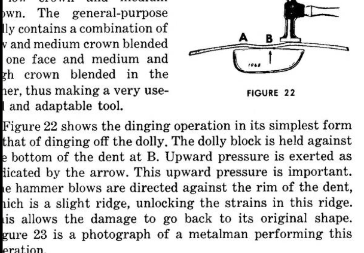

    I started to read the book. A screenshot is below from the book. So if I understand correctly I should not be hitting the dolly using this method.

    Correct. Sandwiching the metal directly between the hammer and dolly will stretch it.
    "a 3in line that has indented maybe 1/5 inch" means the metal is already stretched a bit, so "off dolly" tapping is used to shrink the metal a bit.
