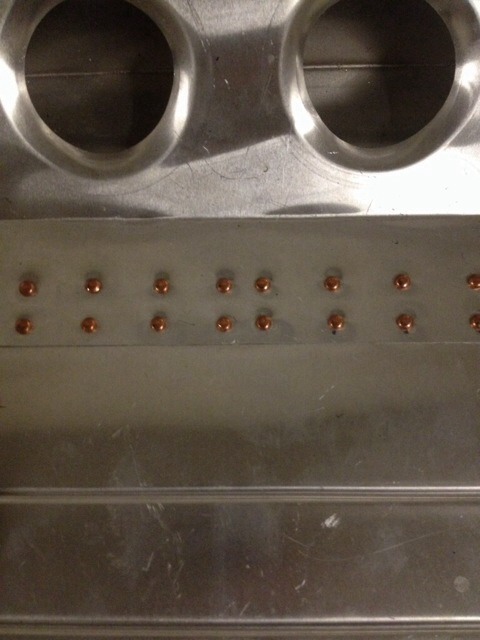

    Here is the front window frame done in all 1/8" aluminum. I didn't grind any of the welds down. Instead I used a hand file because I have the greatest control I make it even. Also the scratches will buff out with a little work, they look deep but try aren't. ImageUploadedByH.A.M.B.1386276967.168424.jpg

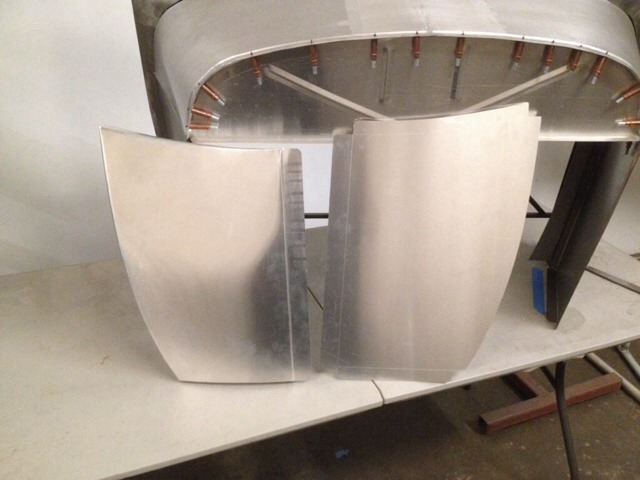

    Here are the lower cowl pieces. One is made the other is the flat sheet that will become one. ImageUploadedByH.A.M.B.1386277101.993035.jpg

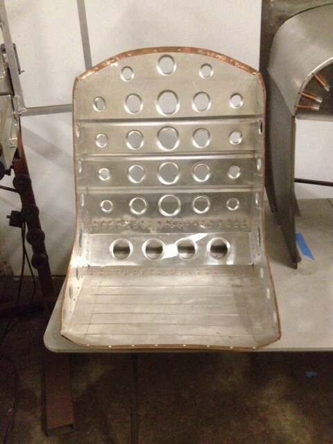

    Here is on of the bomber seats I plan to use. I really like the look of aluminum and copper together. Even though his hasn't been polished out it still looks good to me. ImageUploadedByH.A.M.B.1386283067.409451.jpg ImageUploadedByH.A.M.B.1386283097.904510.jpg

    You do some nice work.
    I'm doing a similar all aluminum and copper rivet interior in my coupe.

    That is a fantastic look isn't it?
