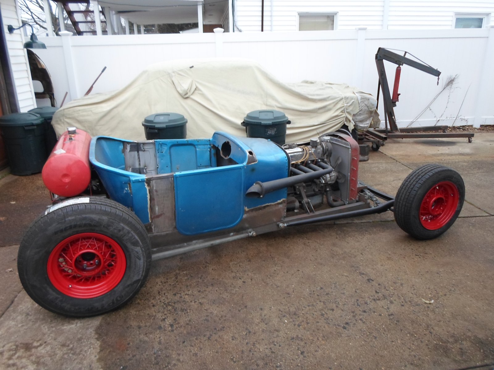

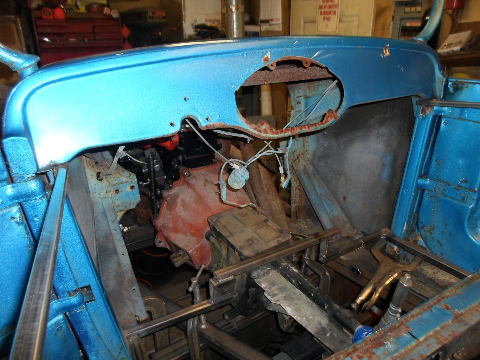

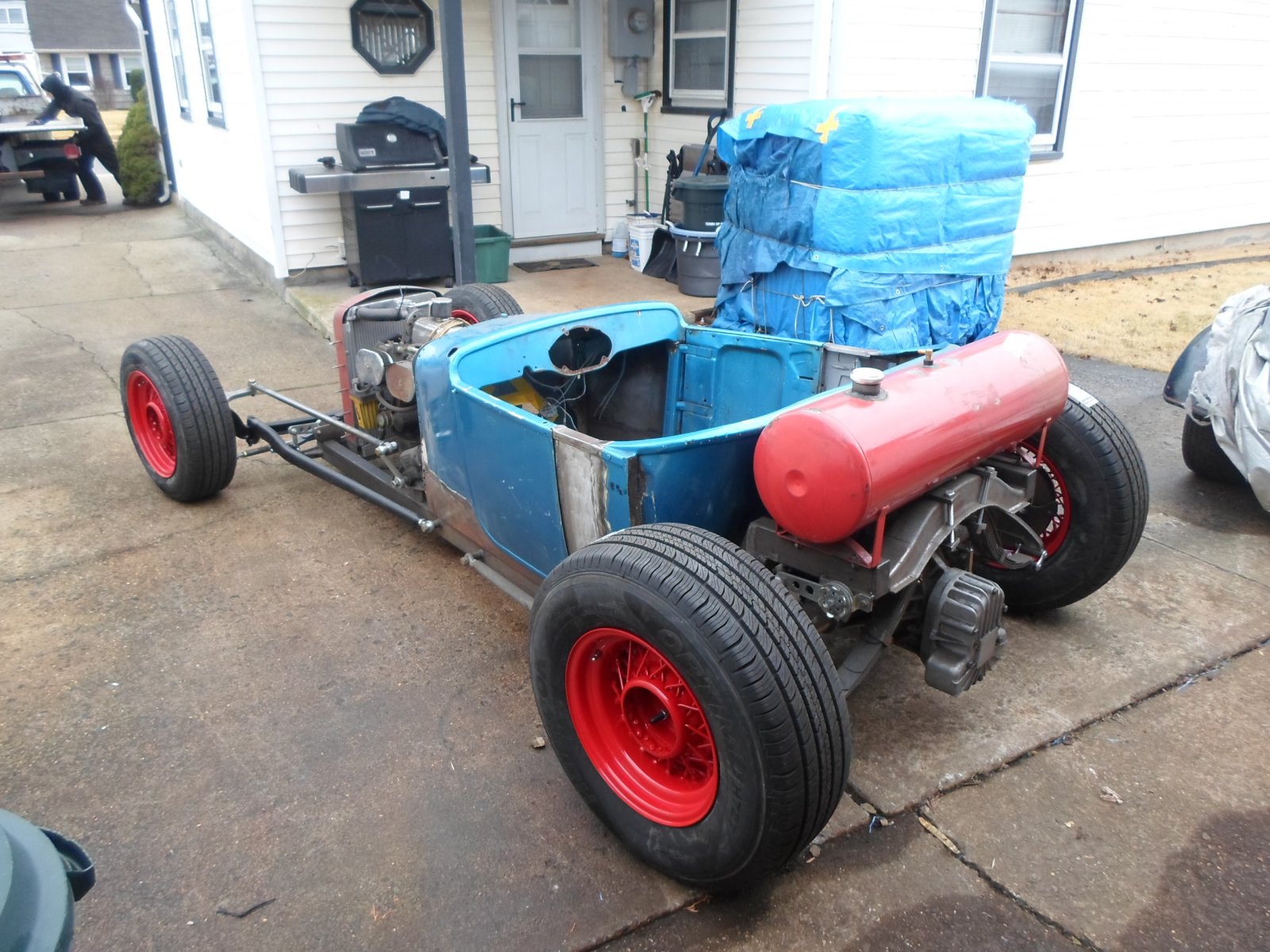

    How about posting some interior shots then to help illuminate your problem? Hand brakes were common on early cars and racers. But they’d be ***bersome on a street car, especially in traffic.

    A suspended ***embly would have all three pedals and master cylinders mounted up and behind the dash. No room for that - ***uming coordination with your steering column, drop, shaft, etc.?

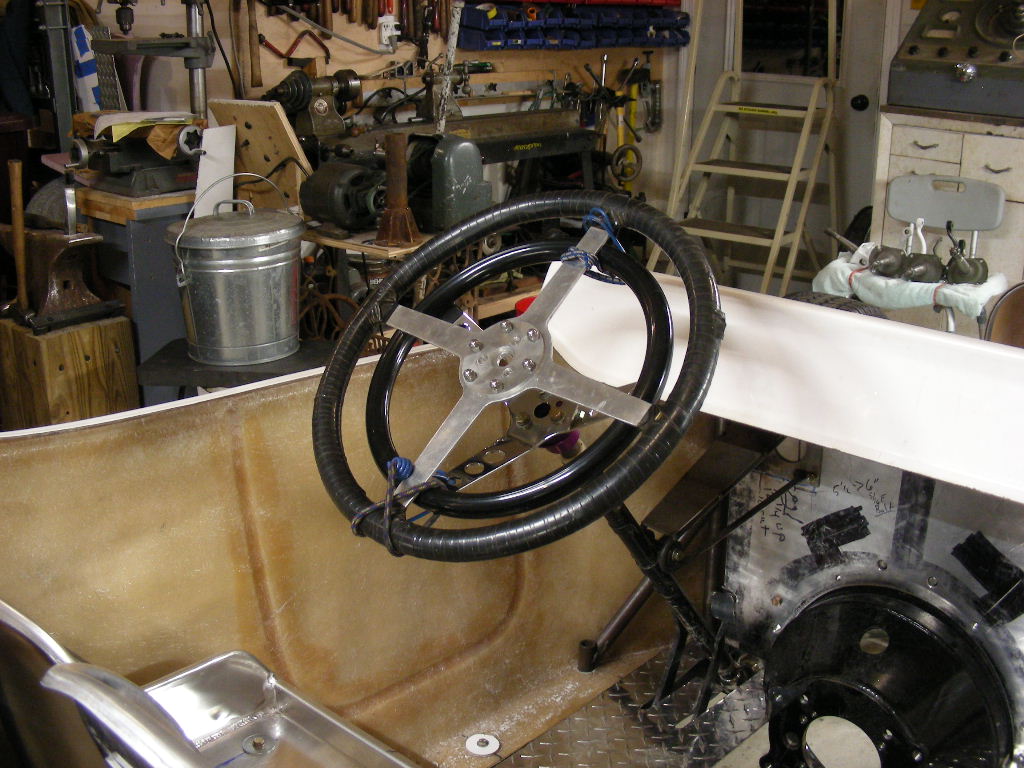

    I have 8E width feet, short and wiiide. I'm building a 23 t with 3 pedals. I used 1972 Austin Mini pedals turned upside down. You can make something similar to fit. Here's a picture of the setup. DSCN1668.JPG Unless you have narrowed your body, I believe it has more room for the pedals than a 23. Also take a look at Marty Strode's #10 track roadster thread. His pedals are old Ford and bigger than the Mi i pedals. I bet you can get something to fit down in your car.

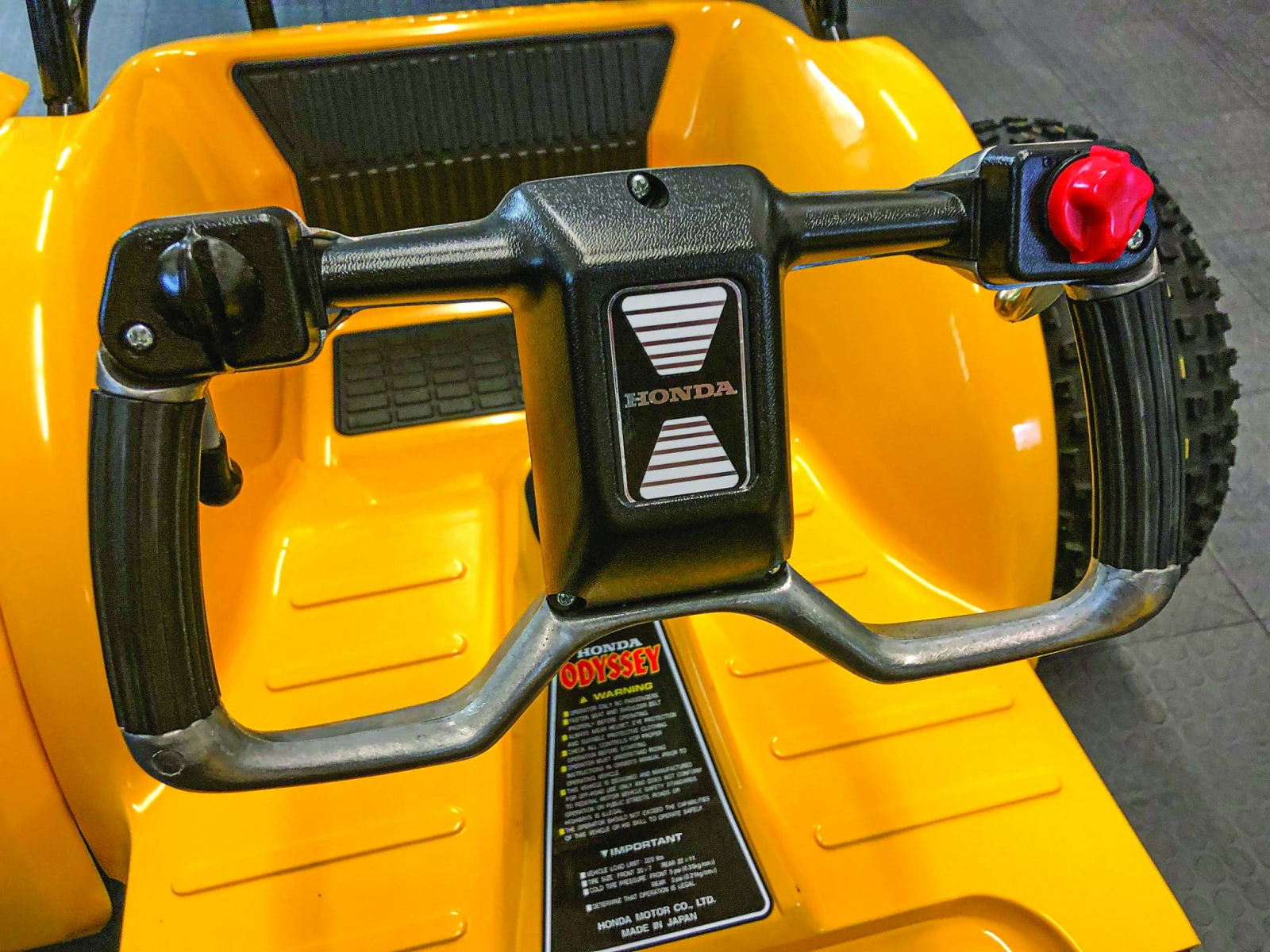

    I raced shifterkarts in the early eighties and used this from a Honda Odyssey.
