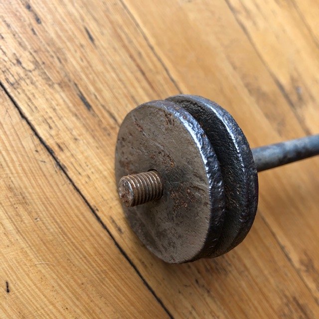

    Maybe a little off topic, but has anyone replaced the plunger seal gasket (for lack of a better word to describe it)? I have an Eelco one that I'd like to replace. I understand that they were all leather, not rubber? Here is a pic of the old seal, which I promptly lost when I had it apart years ago. Am I safe to assume that I could just find a piece of thick leather I cut a circle out of it that's a bit bigger than the metal washers that hold it in place? The washer towards the end of the rod has a slightly smaller diameter than the other one. Any tips?
  3. Look in McMaster-Carr under piston cups

    Thanks, guys. Only here can you get an answer of something so obscure, in a few minutes.

    The leather cup is nothing more than a large version of a carb accelerator pump cup. Can make it yourself, but I'm fairly sure the cup needs to be oiled. Neetsfoot might be a good start, gut iirc, it gets sticky. Or other light oil. Like a bicycle pump, a drop or two every so often will do. Esp if it doesn't slide easily.

    The next time your spouse asked you to oil her Singer sewing machine, hide the can of oil in your toolbox after you finish. The Singer oil works great on leather.
    Really a good idea to oil leather accelerator pumps when rebuilding a carburetor.

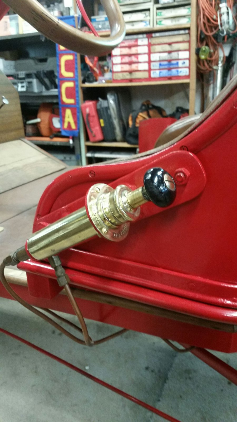

    I made a pressure pump - non functional - for my champ car because I like the authentic look.
    BigRRR likes this.
