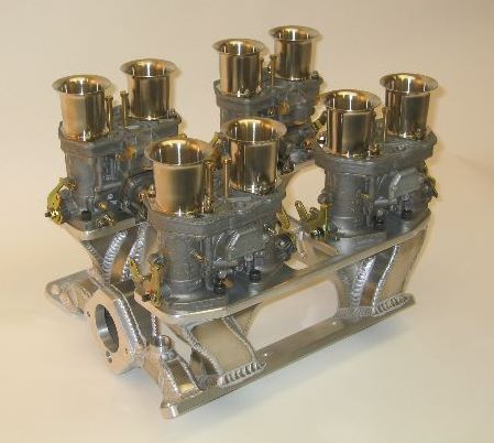

    Try Hogan sheet metal? You might also ask Jim Inglese if there are cast manifolds out there. 0ace82e4-86ce-4eff-add0-792d.jpg
    timmy2times, Ron Falk and saltflats like this.
  21. FrozenMerc
    Joined: Sep 4, 2009
    Posts: 3,423
    FrozenMerc
    At least the Lincoln Y has a more standard port configuration. Shouldn't be too hard to fab up a simple log style IR manifold for Webers. Don't throw the tunnel ram out. Finish welding it for a pair of dual 4 bbl's and have fun at the track on the weekends.

    I will be separating the runners from the plenum and shortening the runners this next week.. The Carb baseplates are done..so I will work off of those and the head plates...and weld up runners as I go..but try to keep it as short as I can.
    That 292/312 Intake is beautiful!!!I will post progress soon!
