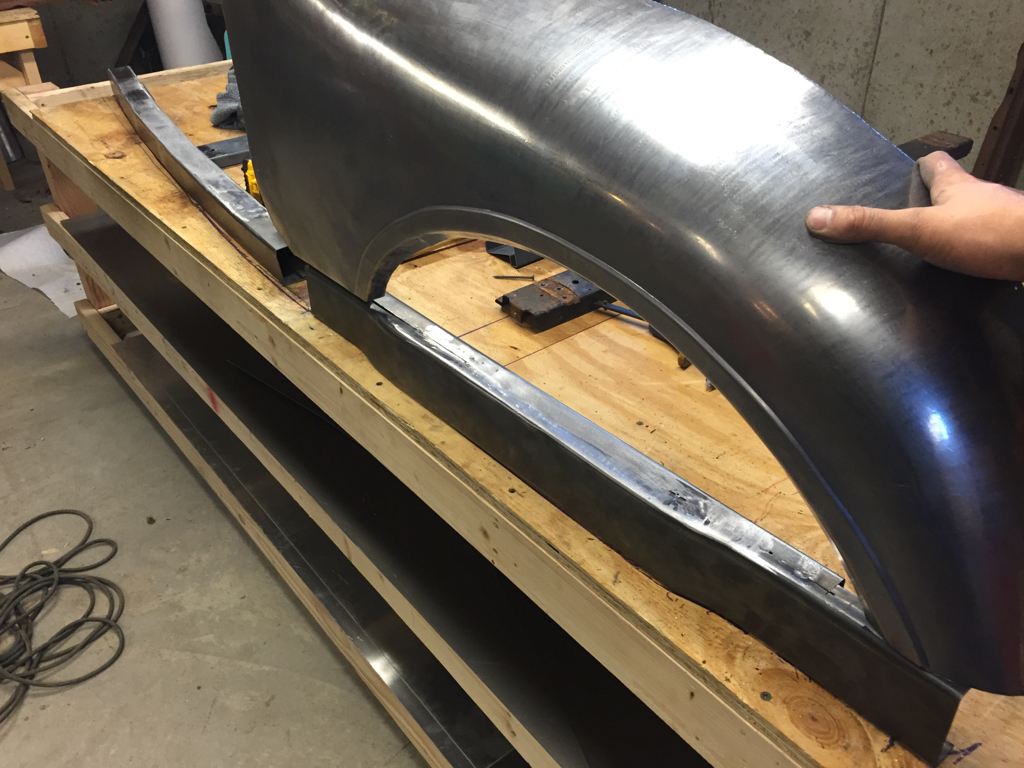

    ImageUploadedByH.A.M.B.1445917529.054180.jpg ImageUploadedByH.A.M.B.1445917539.759075.jpg
    Started the main section of subrails, heat and bent them to fit the wooden template. They got a little tweaked. I will straighten them and clean them up. Not happy with them at all actually. But the stock seat riser fits...

    What gauge are the sub rails?
    Whats the reason for using the wooden templates to make them? Are they to long or is the material to thick to bend in a traditional box and pan brake?
    Sorry for all the questions at once, just trying to see if i can think of a way to not use heat to bend them. Then hopefully save you a bunch of time trying to tweak them at the end. Good luck.
    -Chris

    Only the outside edge that the sheet metal folds over is curved on the stock subrails, from the b pillar forward.

    Thanks for that tidbit. Makes it even harder. Oh well, mine will be curved the whole way I guess . I revisited and remade a new subrail with a new approach today. Came out better. More Pics tomorrow

    Yes it would be hard to reproduce unless it was a seperate piece then welded on.
    thanks for showing us your progress. I'm especially interested in the sub structure.

    This was my thinking on the subject. I've been pondering it since yesterday. You could do a 2 piece construction pretty much like what you have but make the side profile out of a piece of sheet run through a shrinker then cut and welded on to the rail tube.
    It would probably work best on a tube that's got an inverted T shape to it at the height you need it. You should have room to do something like that, IIRC the top of the rails is only 1.25" give or take (that's the size tubing I am using on mine).
    Curving your whole piece should work great for your body though, I'm just thinking in terms of stock panels and bracketry.

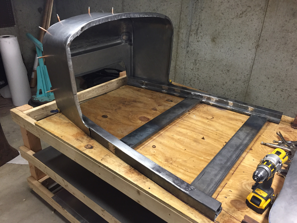

    ImageUploadedByH.A.M.B.1446090053.534754.jpg ImageUploadedByH.A.M.B.1446090065.861362.jpg ImageUploadedByH.A.M.B.1446090075.100046.jpg ImageUploadedByH.A.M.B.1446090103.579979.jpg
    Lots of Safety and subrails happened tonight

    ImageUploadedByH.A.M.B.1446175072.123249.jpg ImageUploadedByH.A.M.B.1446175091.649541.jpg ImageUploadedByH.A.M.B.1446175119.013885.jpg

    ImageUploadedByH.A.M.B.1446348894.389003.jpg ImageUploadedByH.A.M.B.1446348903.541027.jpg
    Rear subs started.

    Rear subs are 16ga. Factory is 13, but open on be bottom. I feel 16 fully boxed is sufficient.
    ImageUploadedByH.A.M.B.1446482170.680843.jpg ImageUploadedByH.A.M.B.1446482210.083348.jpg

    ImageUploadedByH.A.M.B.1446607482.093644.jpg ImageUploadedByH.A.M.B.1446607492.947986.jpg
    One more night I'll have subrails
