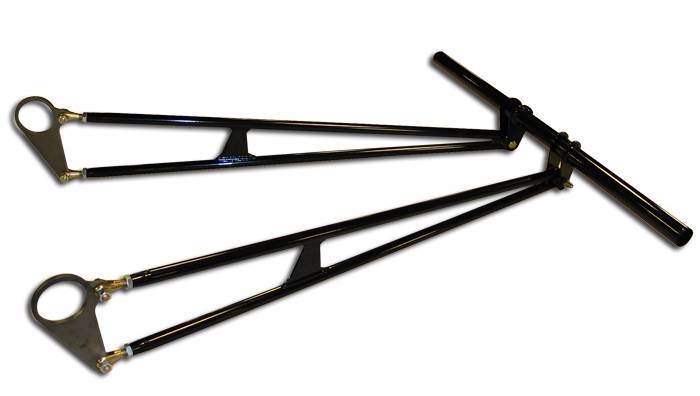

    I've noticed that when you do something around here....right or wrong... the trolls come running to tell you what a mess you made, how it will never work...how you should not be allow in business and such... So lets reverse that,... I have a 32 ch***is... the rear is 60'' wide... though not a wanted thing to do,.. I purchaced a 56'' wide rear as to be able to fit the tires and wheels I want...with the 60'' wide I need 6'' of back space.... can't get there with a 5 or 6'' wheel.....so... gotta narrow the rear...
    the ch***is has a cross leaf, which I wanna keep... it also has split wish bones... whats a better way to hang the rear??? on a cross leaf the movement is straight up and down...
    If you have a pic it would be more that helpful

    of co**** this would require use of a lateral panhard bar

    will a triangulated 4 bar work??? or bad idea??? would it eliminate the need for a panhard

  11. catdad49
    Joined: Sep 25, 2005
    Posts: 7,062
    catdad49
    upload_2025-2-3_12-36-14.png I have this and a cross spring in mine, seems to be OK for me. How wide is your existing spring?

  14. chicken
    Joined: Aug 15, 2004
    Posts: 677
    chicken
    from Kansas
    If the shackle angles are correct at ride height it'll work just fine.
