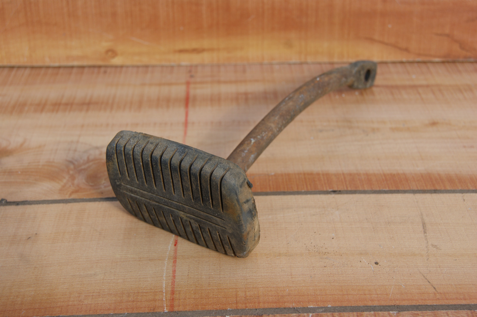

    If the effort of pushing the clutch pedal isnt a problem can you bend up a custom arm that bolts onto the arm itself?
    I'm not sure how far apart you've taken your truck but the clutch arm bolts on. Stock ones look like the attachment.
    How about whippin' something up that puts the stock pedal in a more desirable location for you?
    Don't get me wrong, I'm all for hacking shit up :D I just also prefer the cleanest, easiest, and sometimes cheapest solution to a problem.

    I agree 100% with the cleanest and easiest...sometimes cheapest ends up biting you in the you know what. I could look into relocating the arm, but cutting another hole in the floor is something I'd like to avoid, and the heel-toe method of shifting that a hanging assembly offers is so much easier than lift your leg off the floor 100 times in one trip. As far as clean, I think the hanging set-up will look the cleanest...it won't be the easiest. Easiest might be relocating the arm and/or pivot point.
