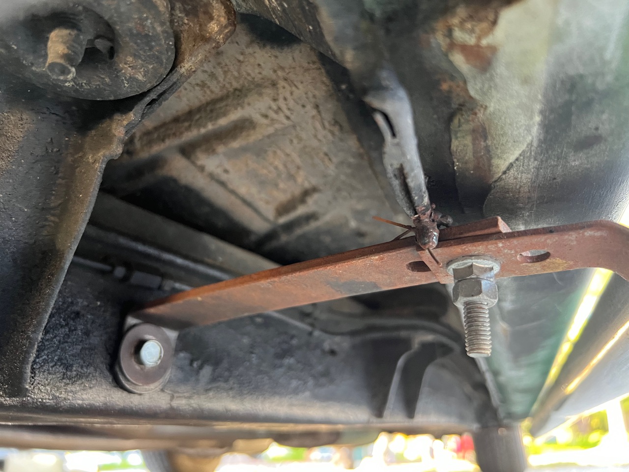

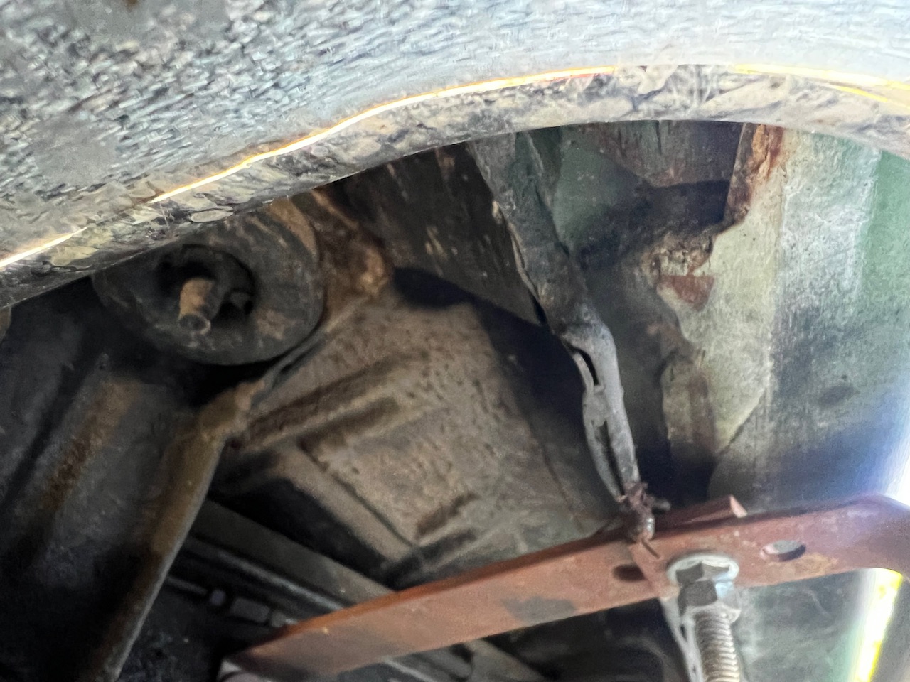

  4. I drilled the backside of each of my lakes pipes about 7 times and installed 3/8" rivserts (dorman calls them rivet nuts) and cut pieces of sheet metal about 2" wide and bolted one end of each piece to each rivsert. Then I screwed the other ends to the bottom of the car

    I ended up extending the loop on the back of the bracket on the flat side. Next step is to make a rounded cover on the fender from some 45* tubing

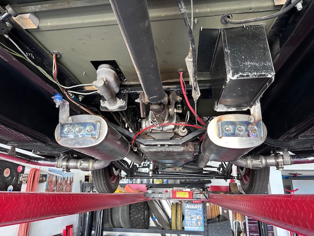

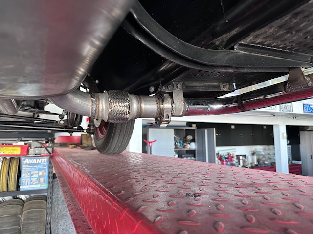

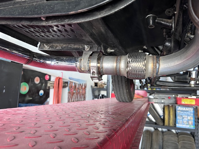

    IMG_1296 - Copy.jpg IMG_2923[8869].jpg IMG_2964[8881].jpg IMG_2965[8880].jpg IMG_2966[8879].jpg
    depending On whether they will be exhaust pipes (functional) or rock slider curb feelers.. you need to put flex pipes , but best way is to tig brackets on and mount them solid so the don't rattle and bust loose
