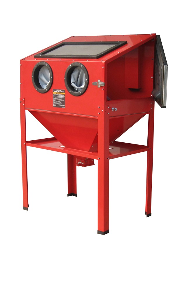

  1. I'D NEVER BUY ONE AGAIN!!
    We too bought the HF floor model blast cabinet. Four years ago.
    What a POS!
    1. Not enough light - replaced the interior light with two floods.
    2. Leaks dust like a screen door.
    3. No easy way to keep the dust down inside the thing to see what you're doing. Wrecked a couple shop vacs and etc. Still too dusty for us.
    4. Gun is not reliable - sometimes works sometimes not - usually not. Replaced the gun with a better quality unit from Mac tools which helped.
    If I used it all the time, it would have been tossed out long ago. Cheap is what you pay for it and cheap is what we got!
    When I do this again, I'll built one from plywood and invest in good internals or just invest in a better cabinet to begin with.

    Be aware that there is more than one model of the HF blast cabinet. The one everyone complains about is the screw-together one. I bought one that had the main cabinet already ***embled, and I had to install the legs, bottom, window, lights, etc. I can see if I can get the model # if anyone is interested. It's a pretty good cabinet. Yes, it leaks a bit, but nothing horrible.
    Yes, the gun ****s. I replaced it with the TP tools gun, which works a LOT better.

    Cant complain to much about the hf cabinet. When i ***embled it i put auto seam sealer all over the seams on the inside of the cabinet. The dust was bad so i bought a dust collector from hf and pulled the air inlet plug out the back and havent had any problems. The only problem is that the gl*** leaks a bit and that some of the media builds up around the door but it doesnt bug me much. Ill be replacing the gun soon, not cause its wore out but mainly cause i want a foot pedal. It is what it is and for that price for a starter you cant go wrong.

    Mine was the one that you only had to intall the bottom legs, window. The basic cabinet was already together. I only saw one cabinet listed at the HF store that I bought the booth from

    slammed, that is the cabinet that I bought from HF

    I sealed my HF cabinet with white silicone bathroom calk when I ***embled it. I also use a 2 1/2 hose going to my shop vac and installed a pipe tee inside the cabinet one going to the gun and one going to a hose wipe with an air nozzle on it, that way I can blow of the parts and blow the sand away from the door before opening it. I don't have any dust issues with the cabinet after doing these updates. The gun does have a lot to be desired.

    I bought a HF last year and it works great. The one I bought was their floor model and they were changing to a new style with the light inside the cabinet. This one had a light box on top .I liked that because it didn't take room from the inside. I guess I lucked out that the gun was missing from the display unit as I used a TP gun and it has worked great.
