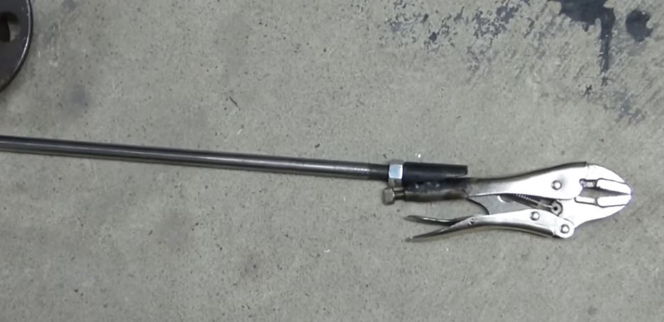

  7. I've seen the slide hammer portion of the tool welded to a set of vise grips...seemed like a quick solution to the problem.
    sunbeam likes this.

  10. H380
    Joined: Sep 20, 2015
    Posts: 494
    H380
    from Louisiana
    54reno and anothercarguy like this.
