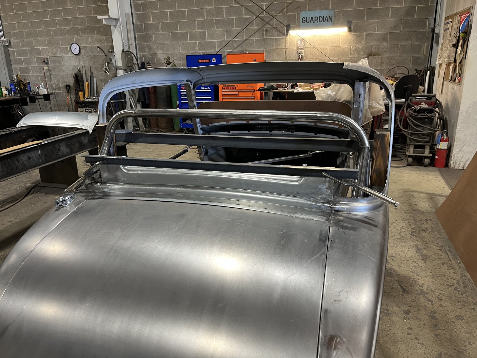

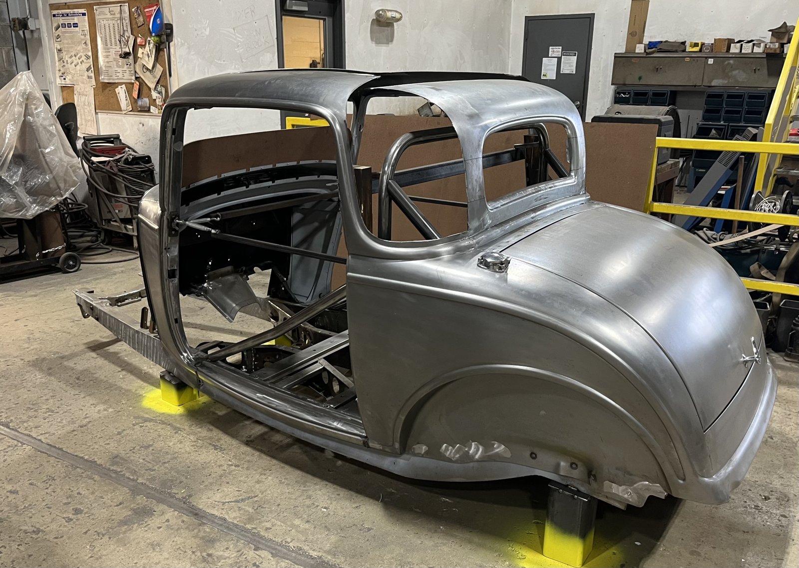

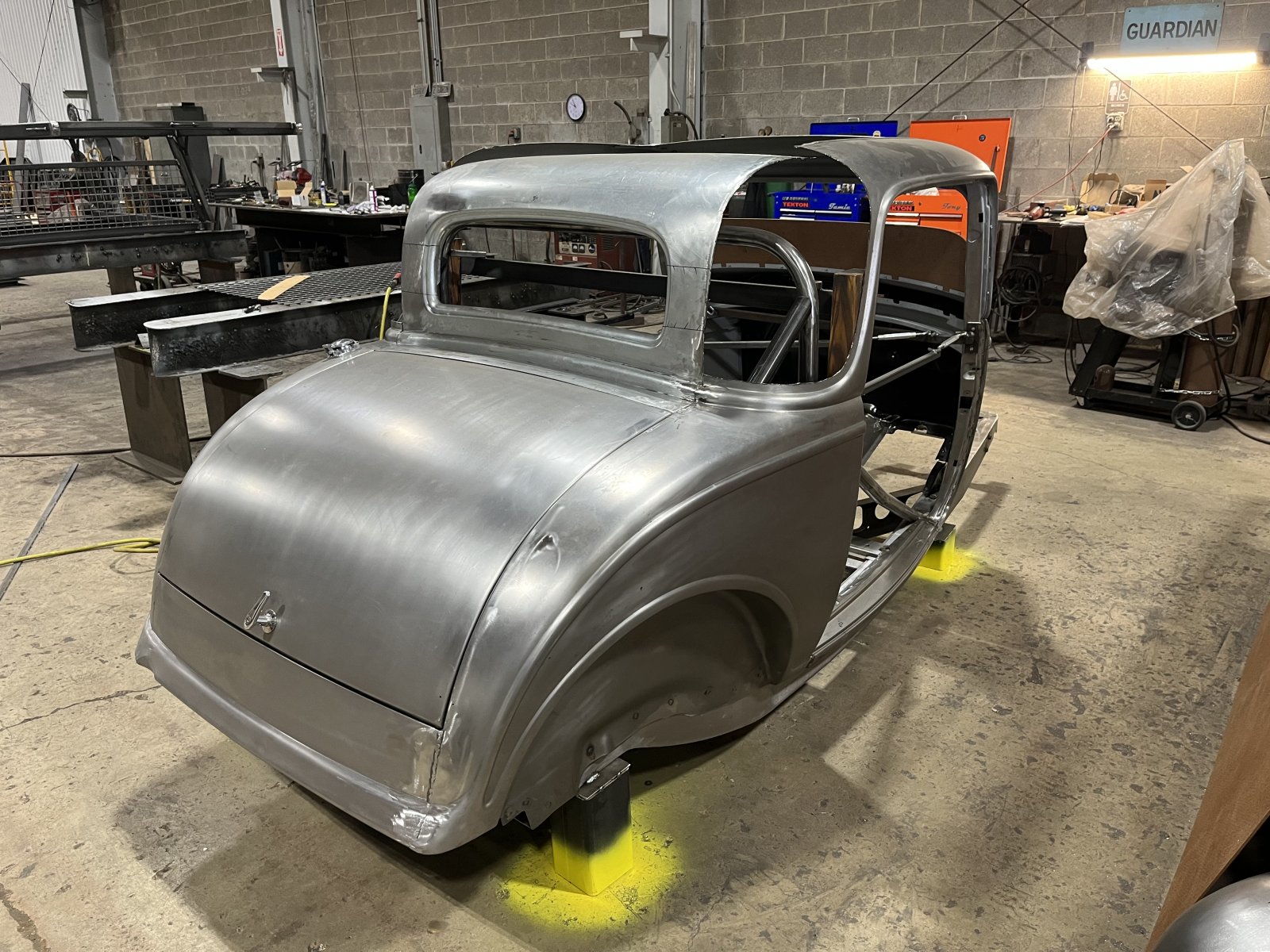

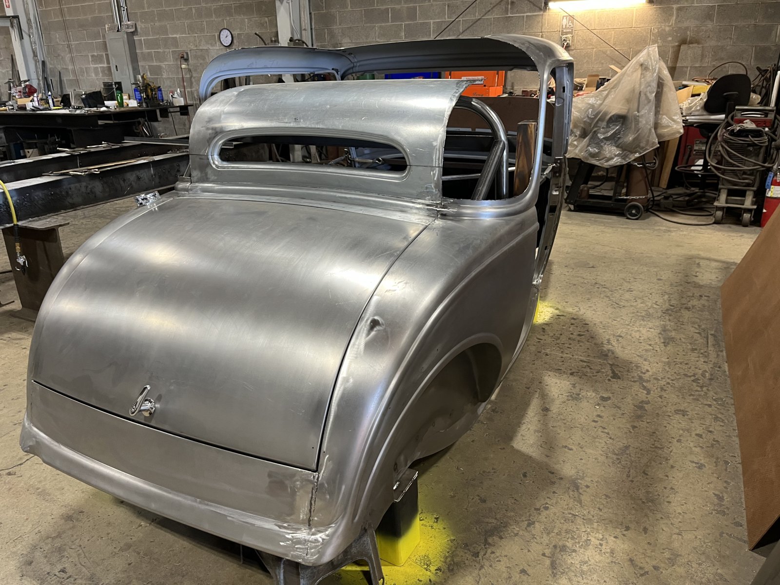

    82D459C5-D8F1-4EFE-9E76-AE0EEF5046F1.jpeg ACC1E11B-1C03-4DAE-9A65-CB18FC81FC56.jpeg I have the body leveled in all directions getting ready to do a heavy chop. Still need to add a couple more braces and the firewall before I make any cuts.

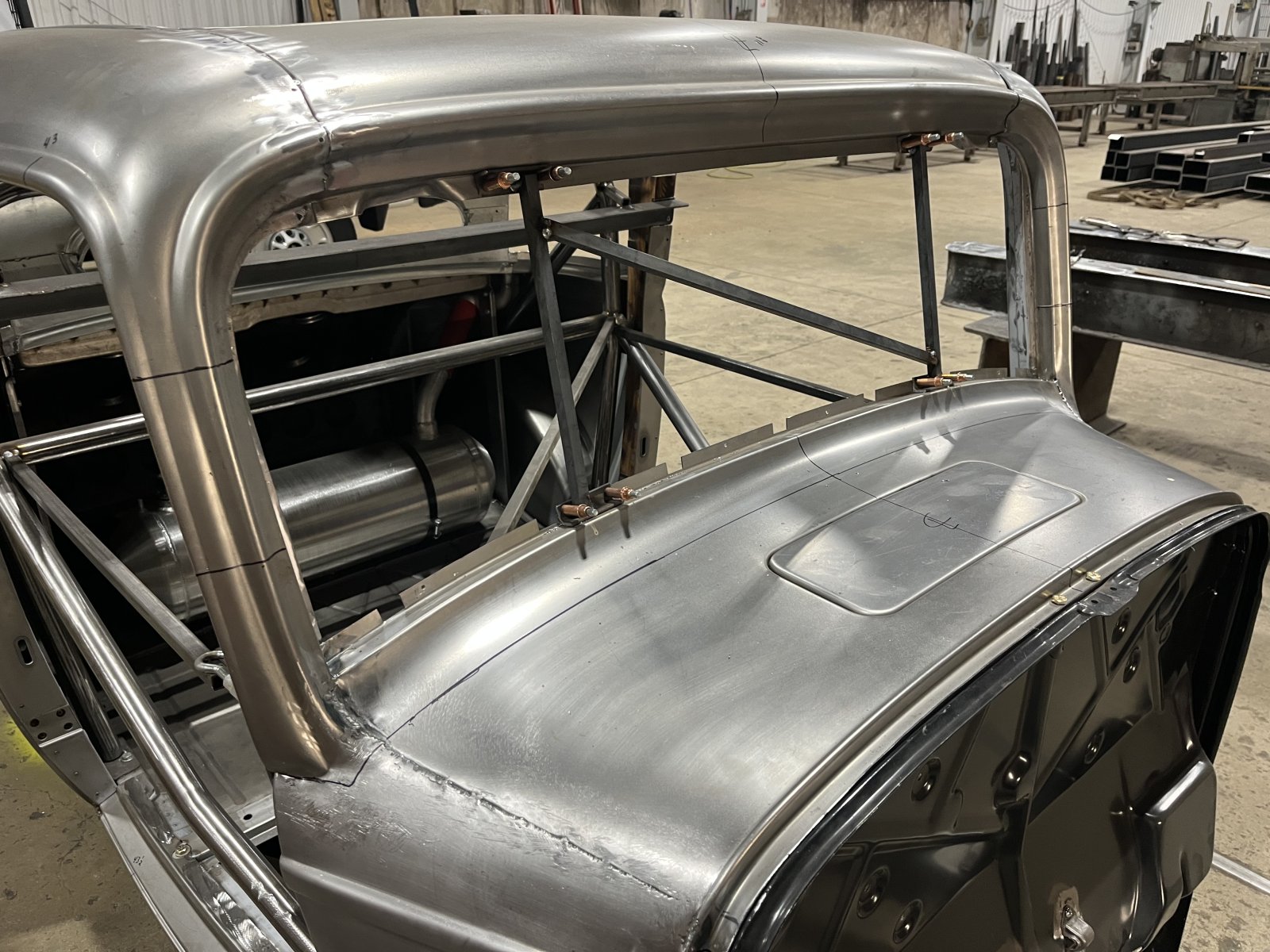

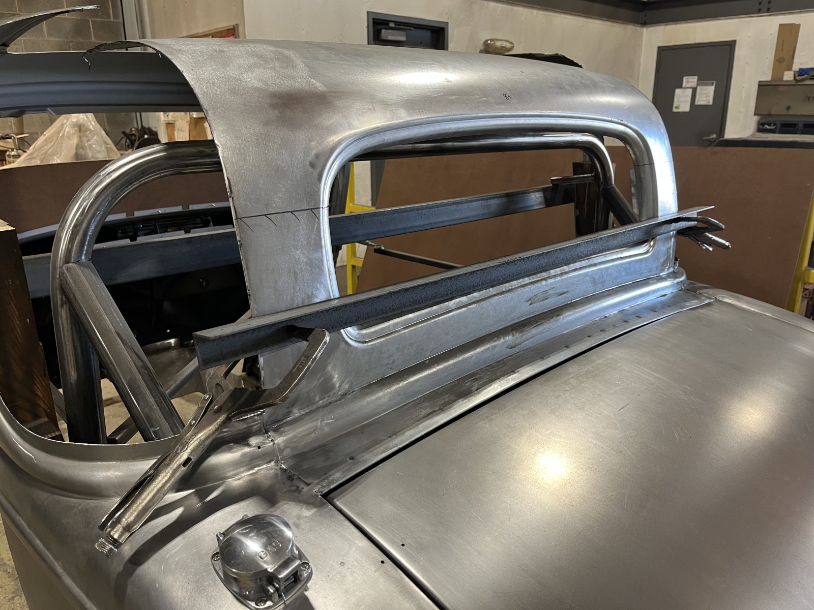

    I filled those notches at the rear of the cowl, in the screen apperture, as I couldn't see any point in them other than to allow moisture in ( it can rail here). Welded some nuts in to replace the funny original style fixings. No problems so far.

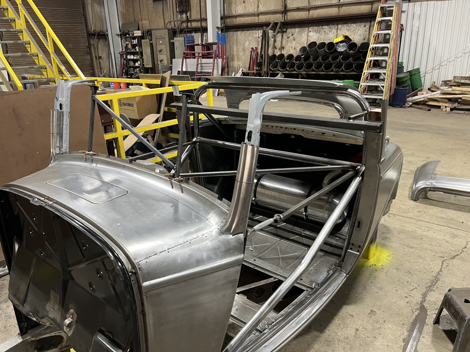

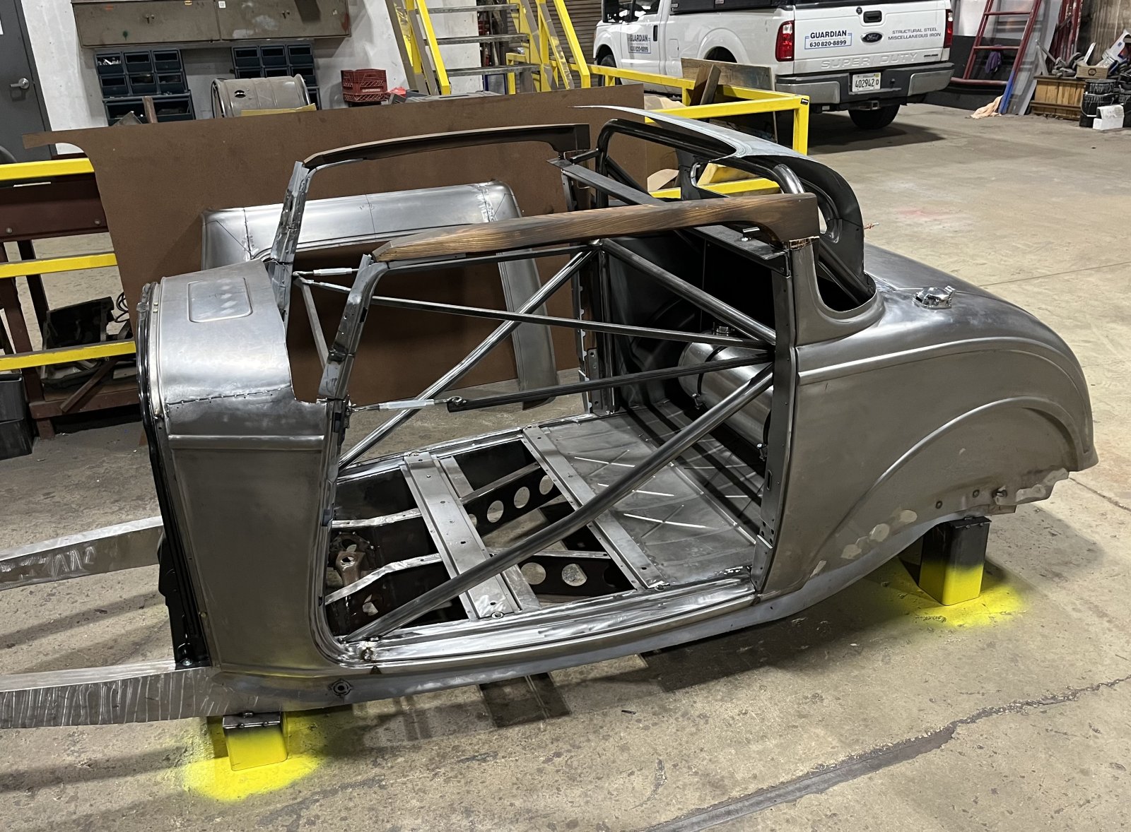

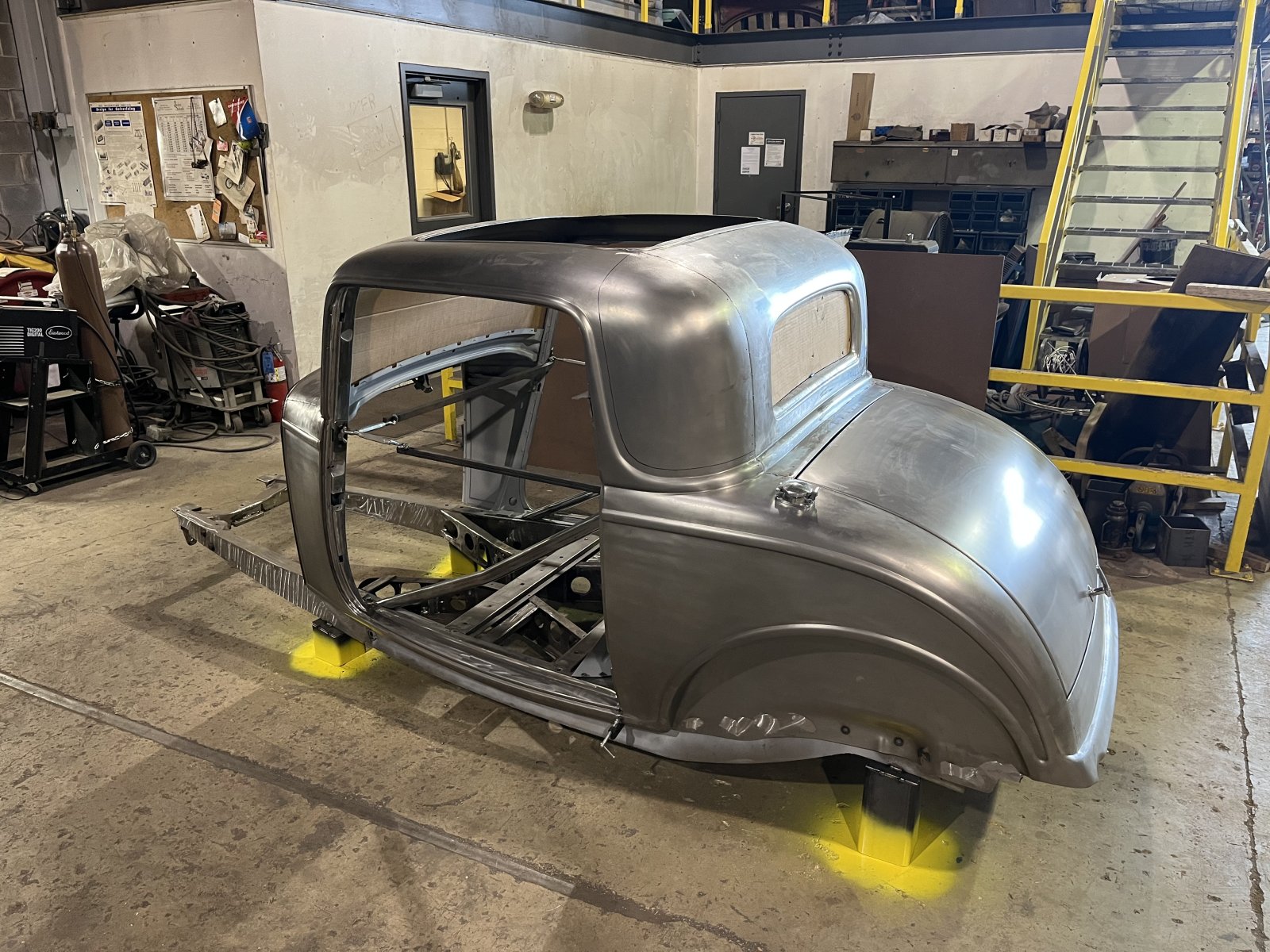

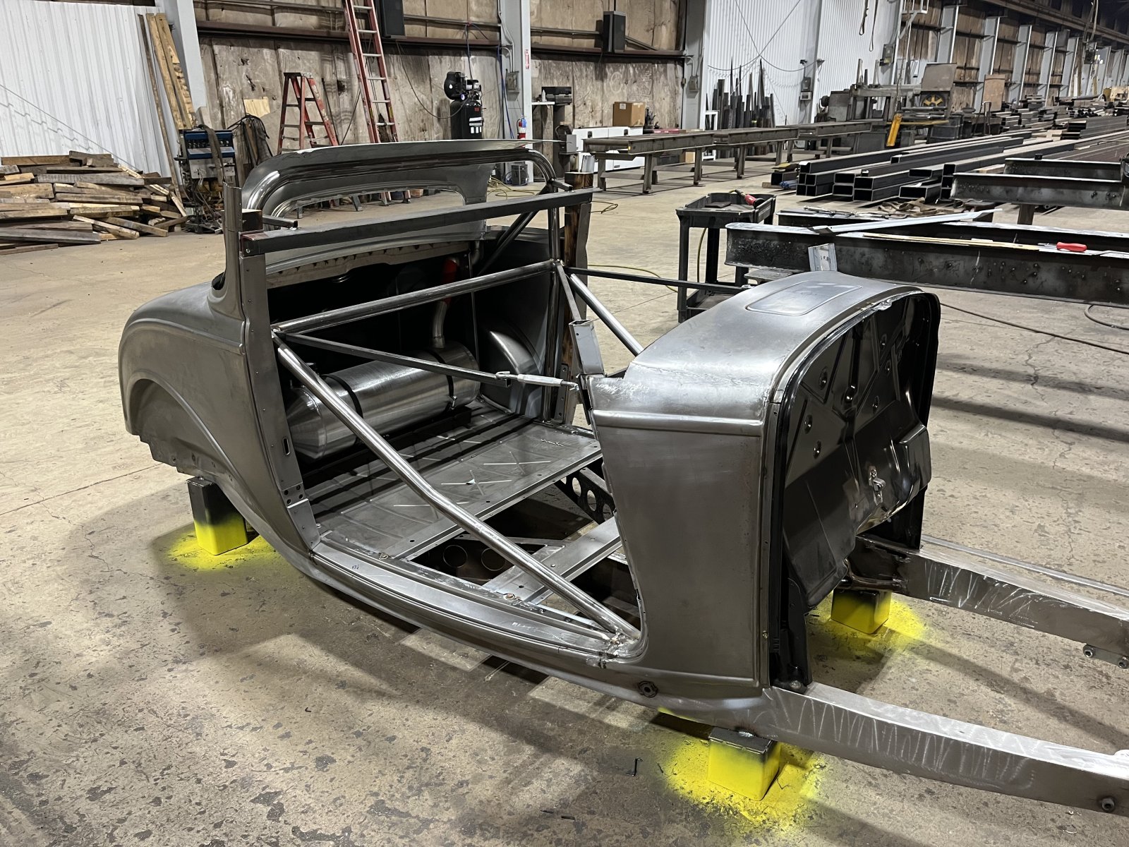

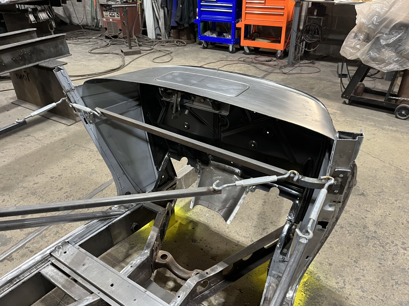

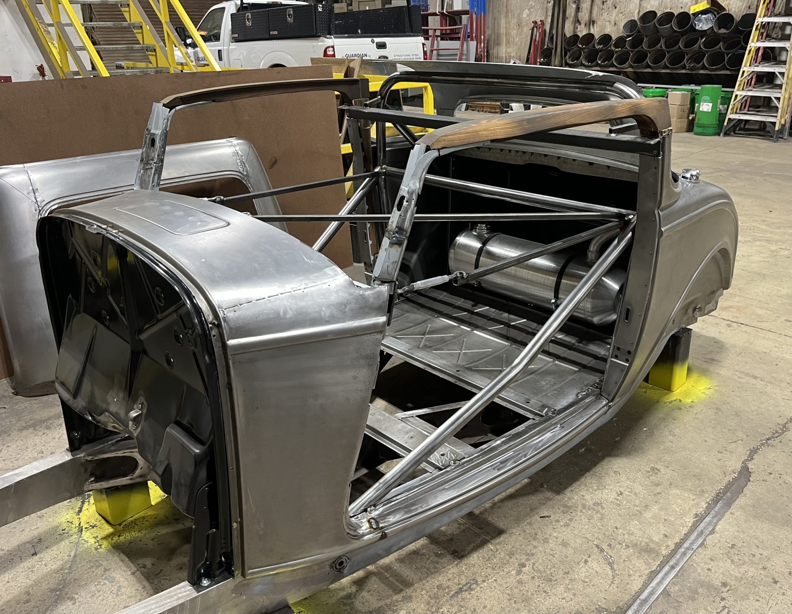

    E1BDA6ED-2DC5-4913-9E97-59436ECD4E0E.jpeg 565A97B1-1892-4865-8520-413E3BB7C002.jpeg DA0D933F-BFB7-4B4B-89E1-13B7BA28C5F9.jpeg Working on the a-pillars inner structure. Shortened and laid back.

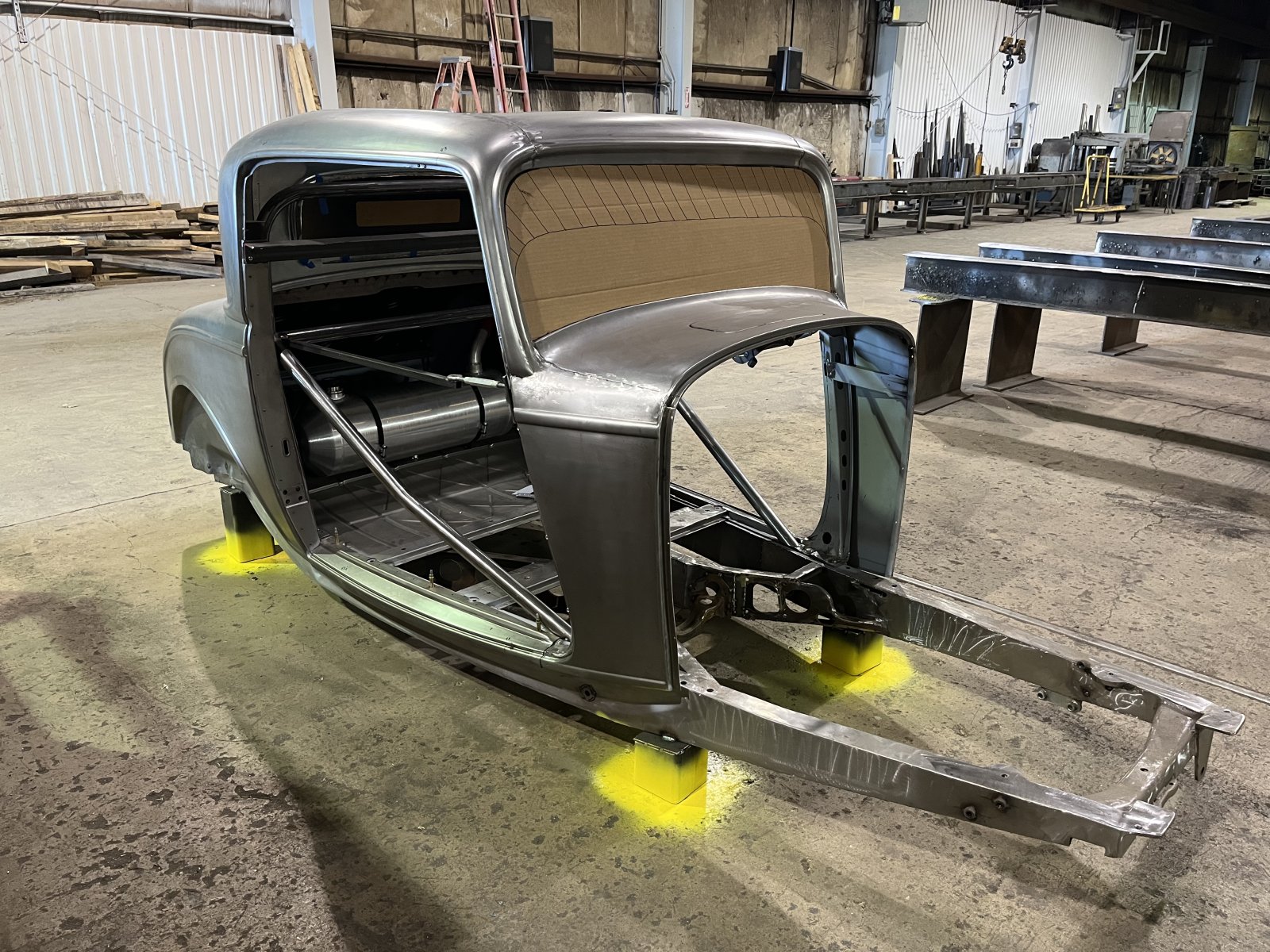

    As a hack, I might ask what the yellow paint on the risers and floor does.
    Indicates shift or movement?
  29. snoc653
    Joined: Dec 25, 2023
    Posts: 1,038
    snoc653
    from Iowa
    I would say yes. Without the roof the car can be twisted if moved. We didn't think to use paint on the floor to show movement at the shop I was at. We did put a series of reference marks on the vehicle and took measurements that could be checked and rechecked to verify nothing was moved prior to welding the roof back on. Say from b post to b post, across the door openings, b post to a post opposite side, ect.... Even with braces welded in the can might twist if moved and if you put the lid on with the car twisted, you might never get it straight again.
