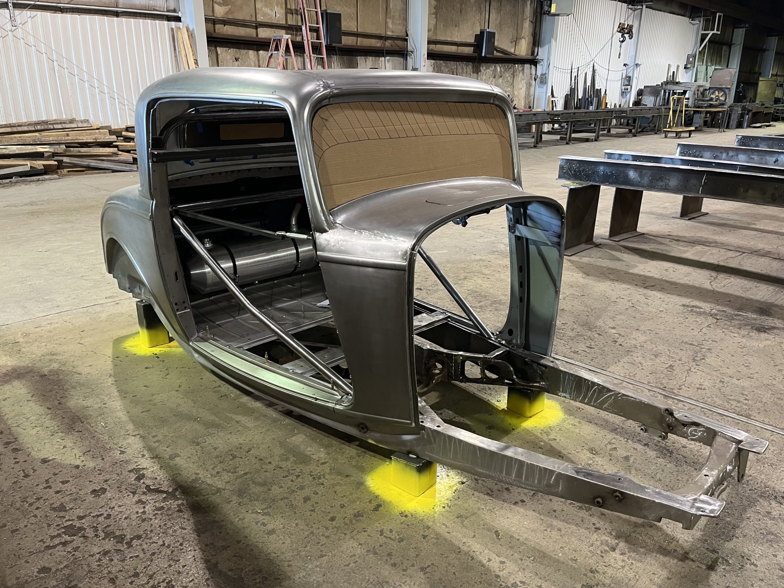

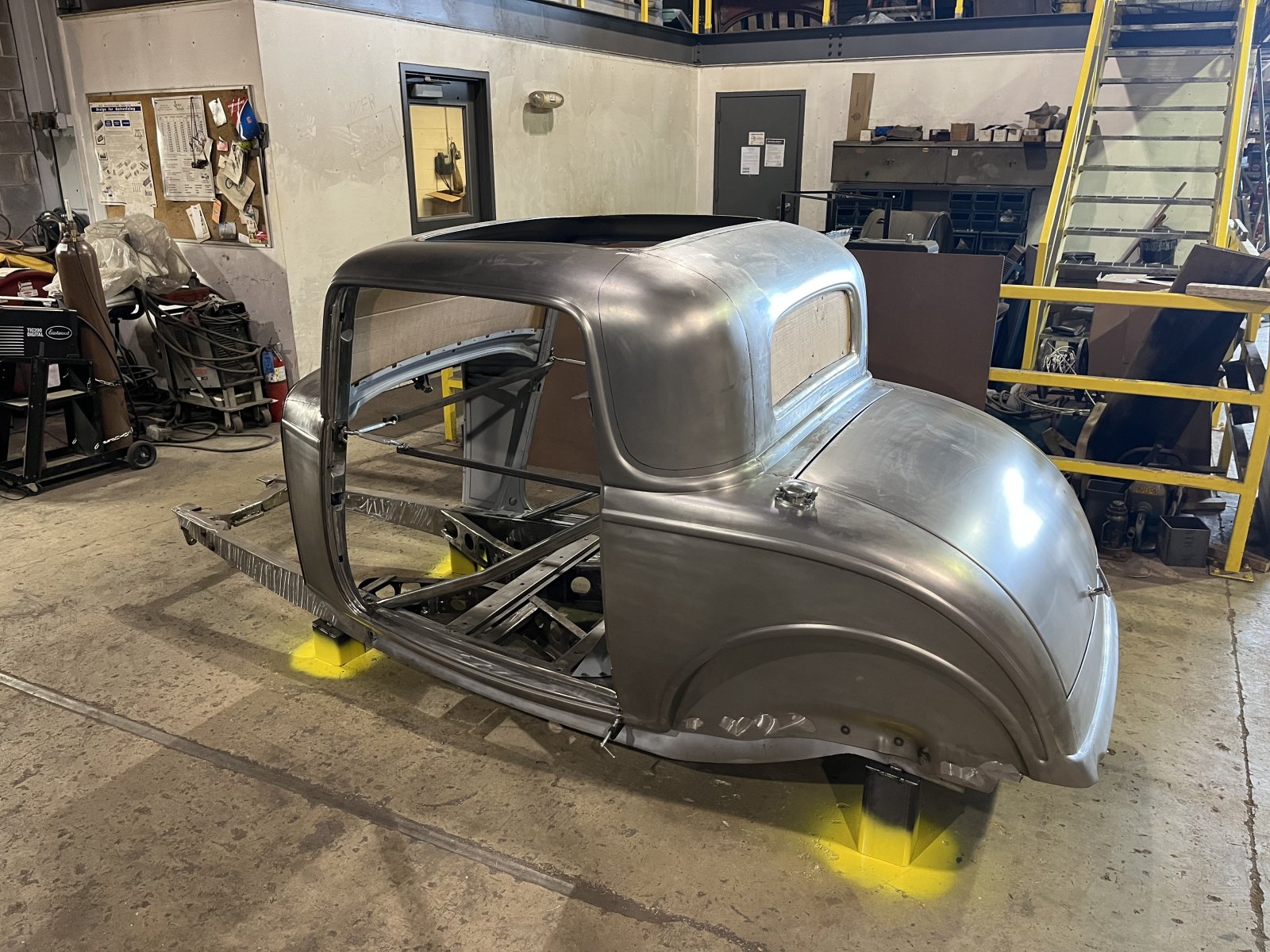

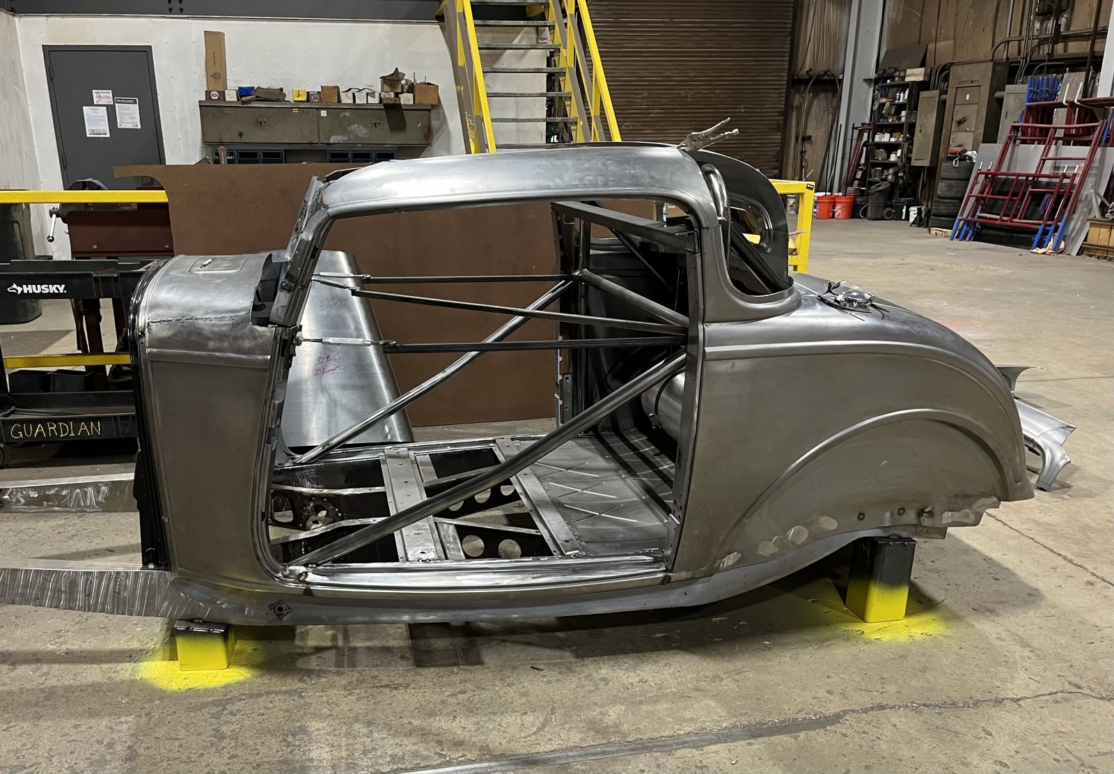

    I marked the floor just in case I have to move the car for some reason. I can put it back exactly where it was so it stays level.
    Yes. Many ways to chop a 3w. This one will be a rolling bones style chop. Angled chop with rear window leaned forward 3/4” and whole windshield laid back so I don’t add length to the roof.

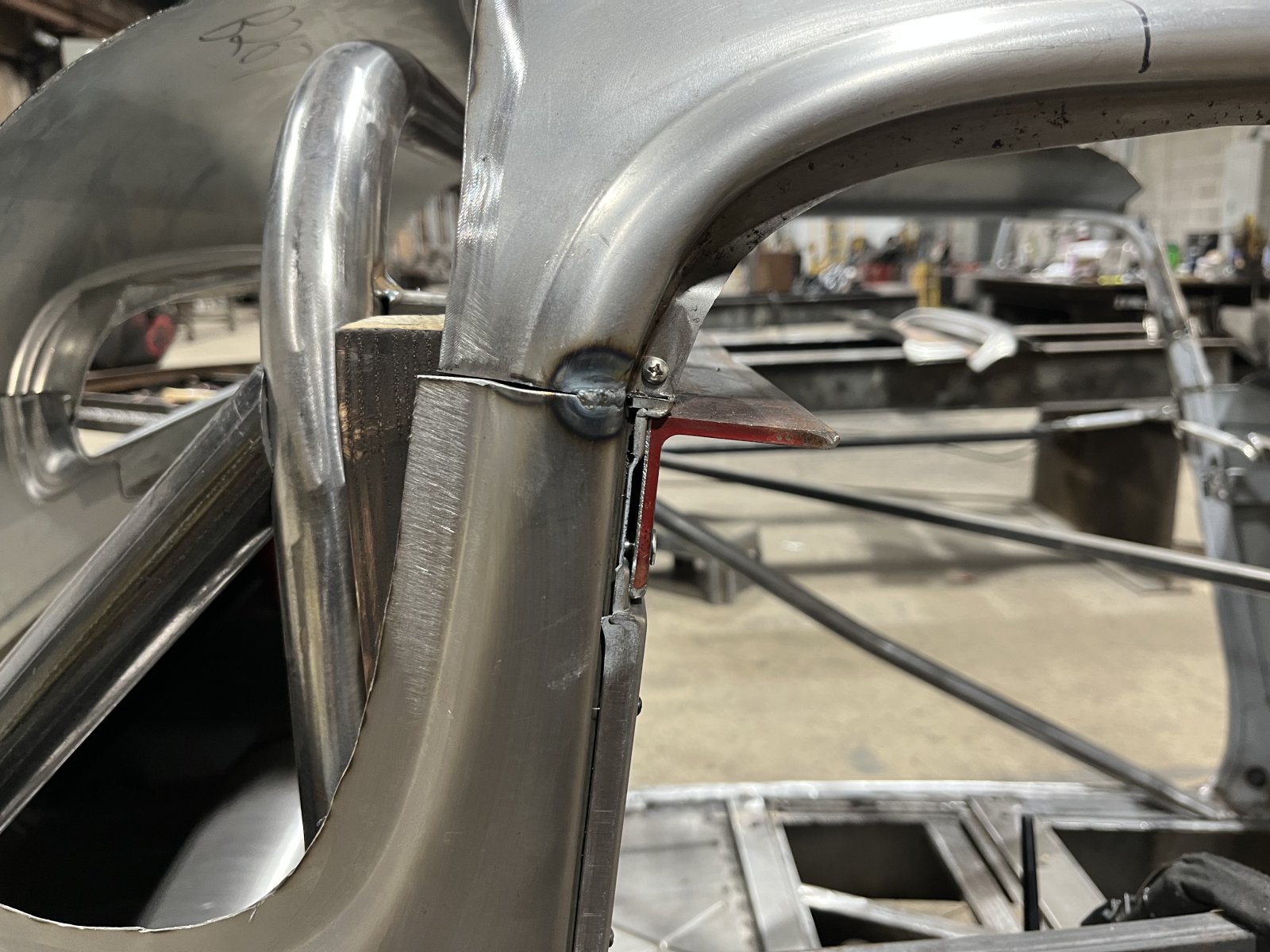

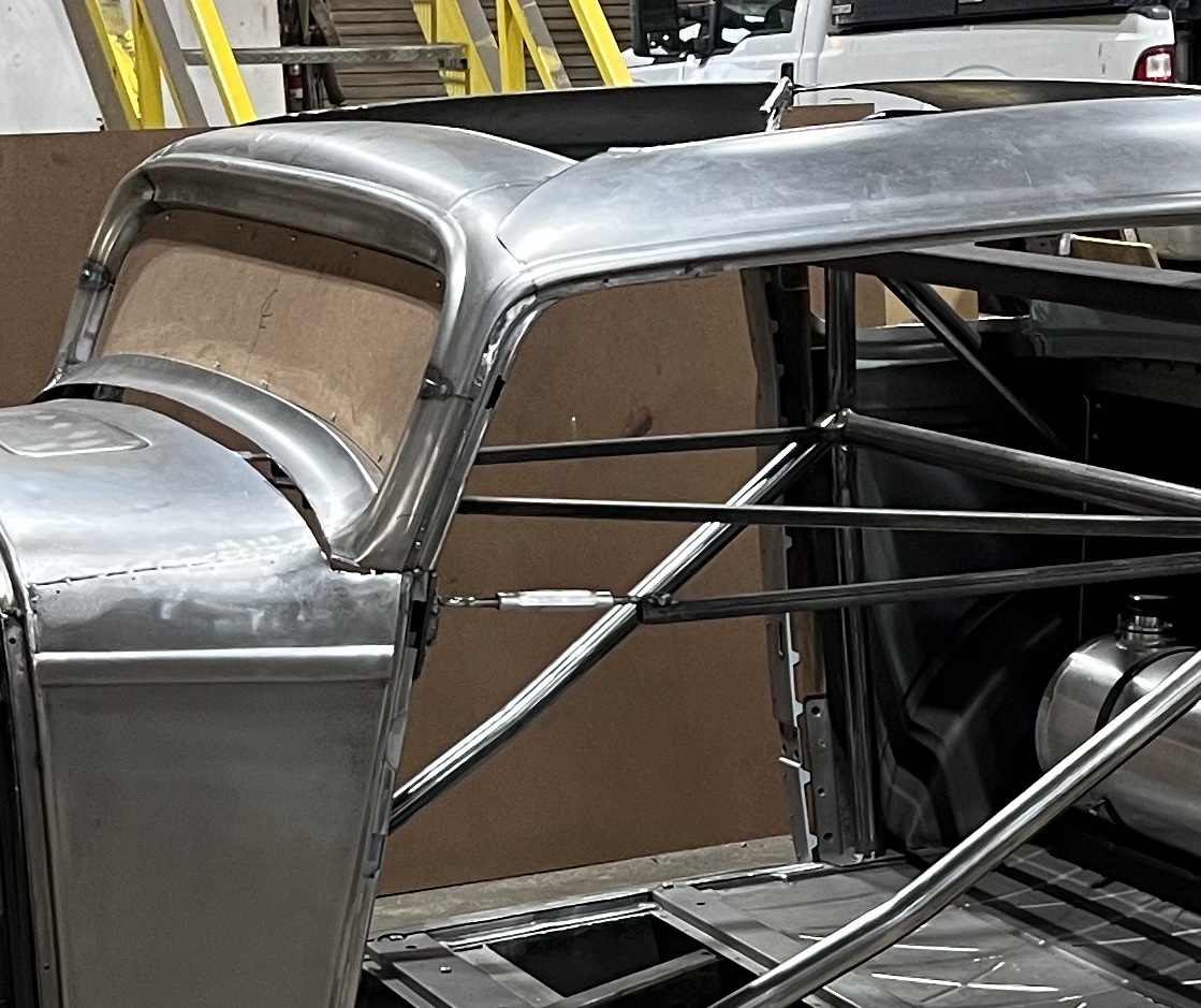

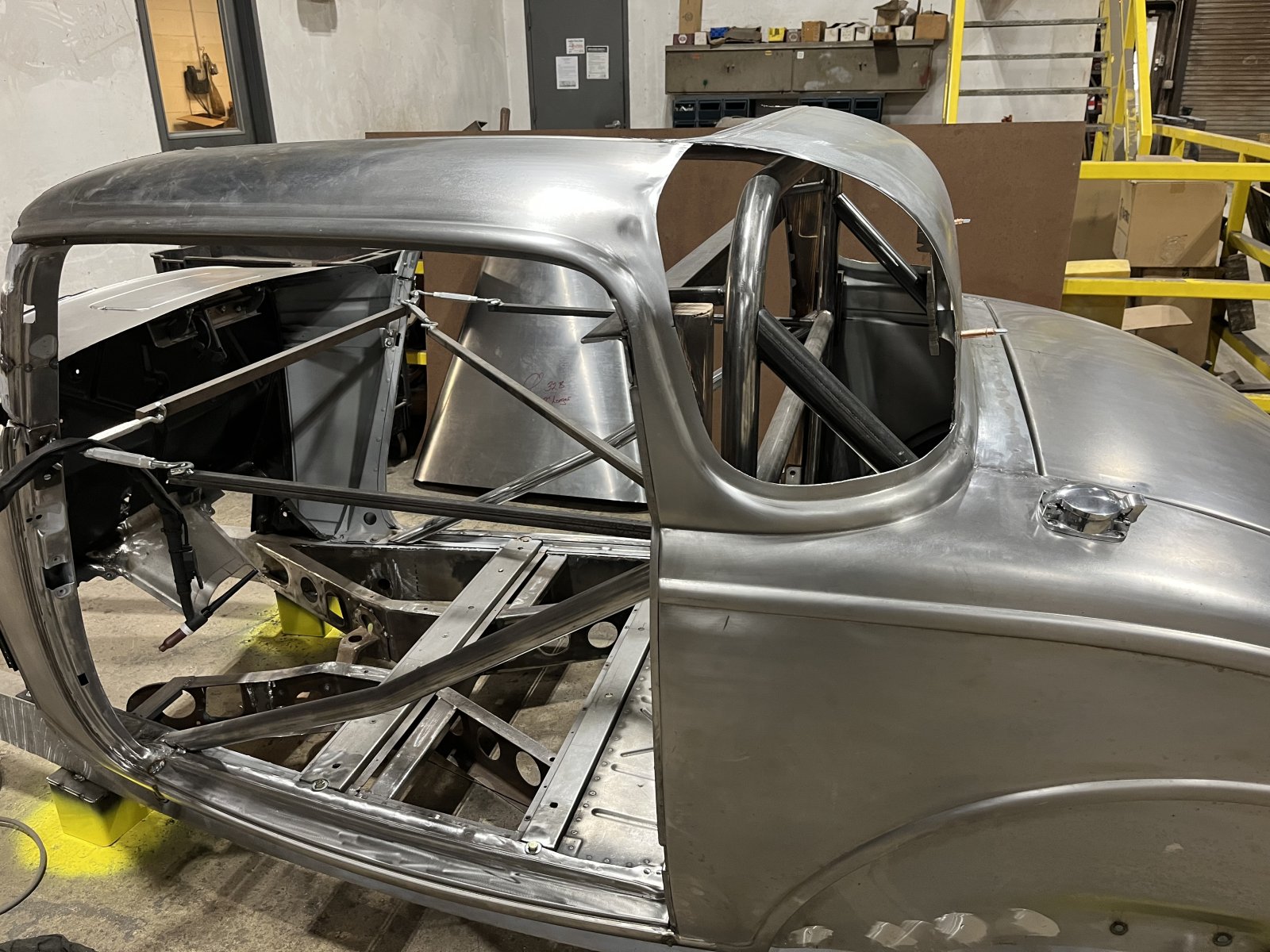

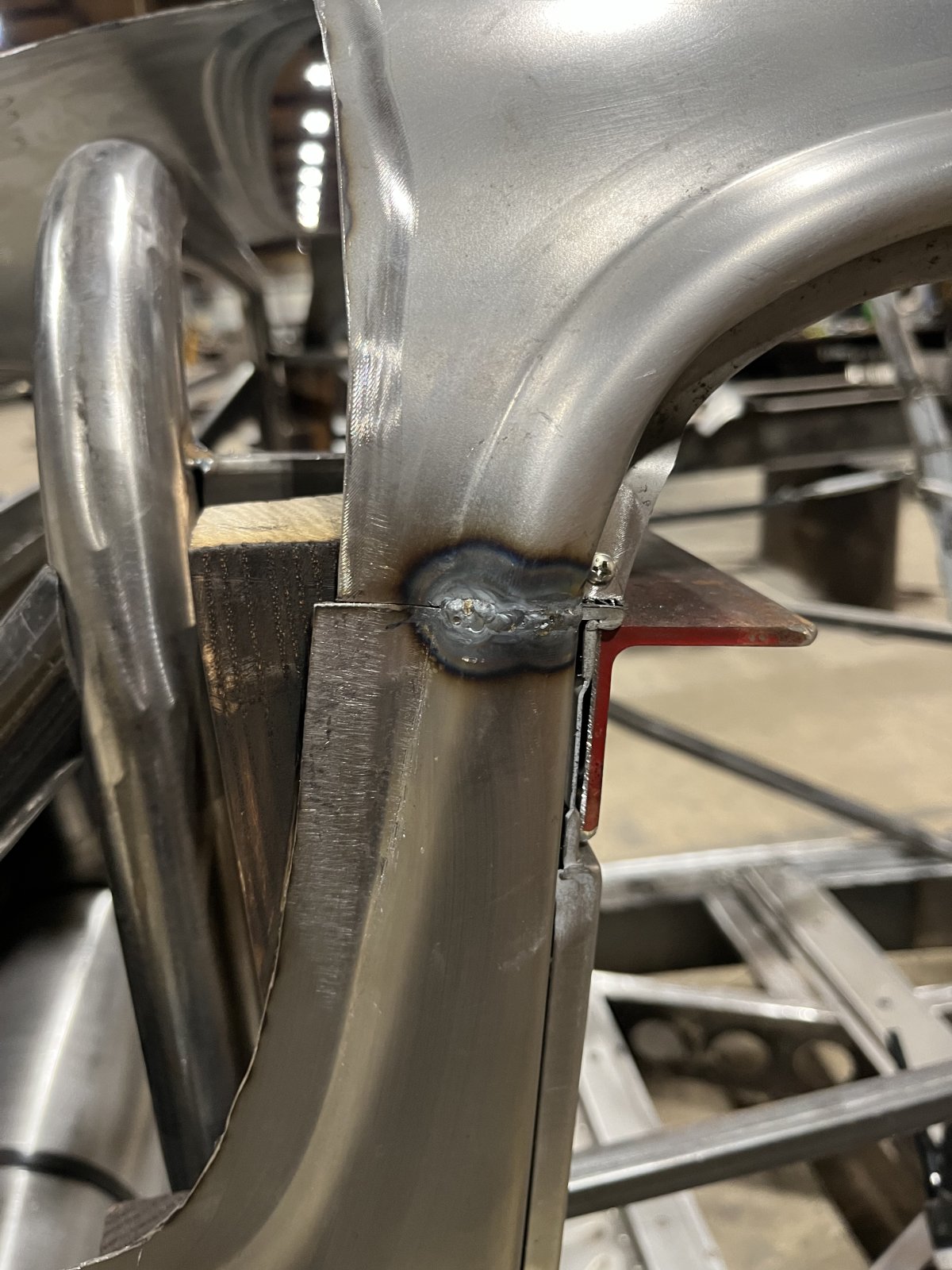

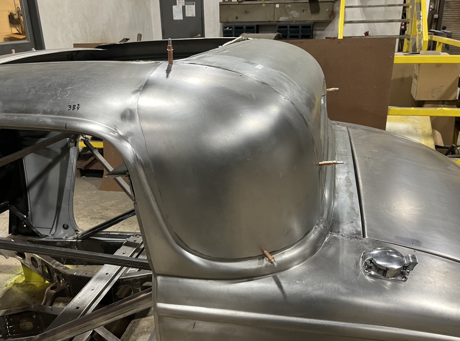

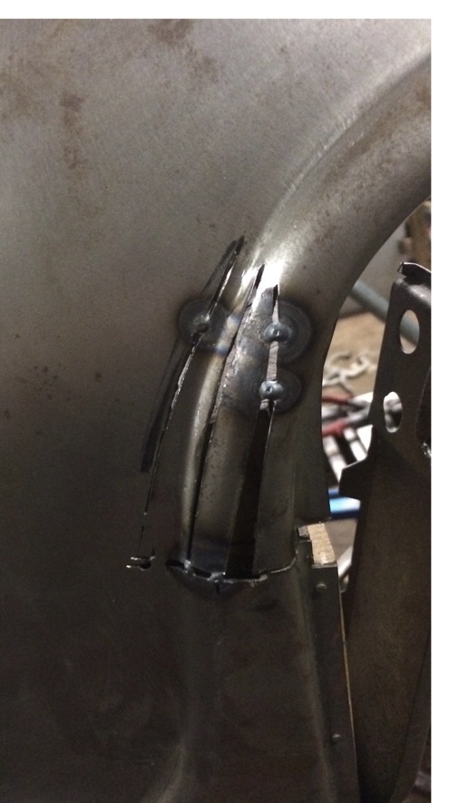

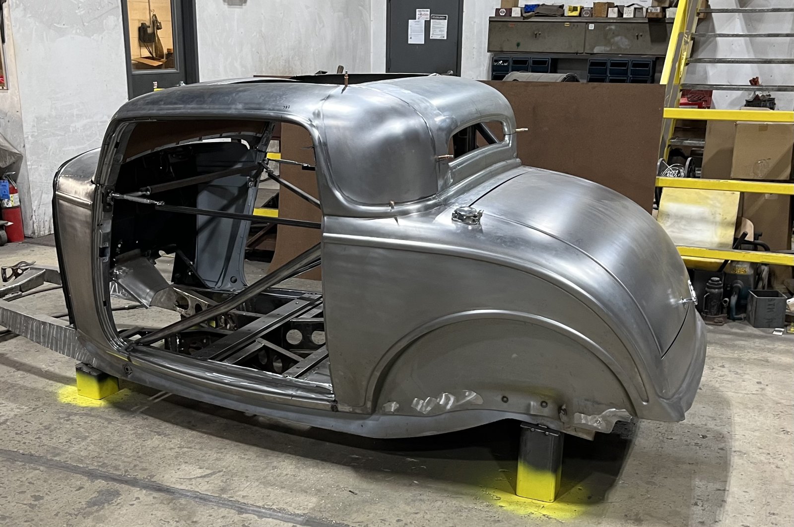

    C24361FB-EB2A-4B0A-A047-07923CB66AA4.jpeg 65BB5C2A-882C-4817-B4D8-CECCD9770275.jpeg 2D0D76FF-D293-40D4-918A-A6EEE6C839C0.jpeg 4EC61E3A-46D5-4A53-8967-78D53B53E9B2.jpeg Zero pie cuts. Just good old hammer and dolly work to blend the B-pillar. Maybe 15 minutes to move and align the body lines.

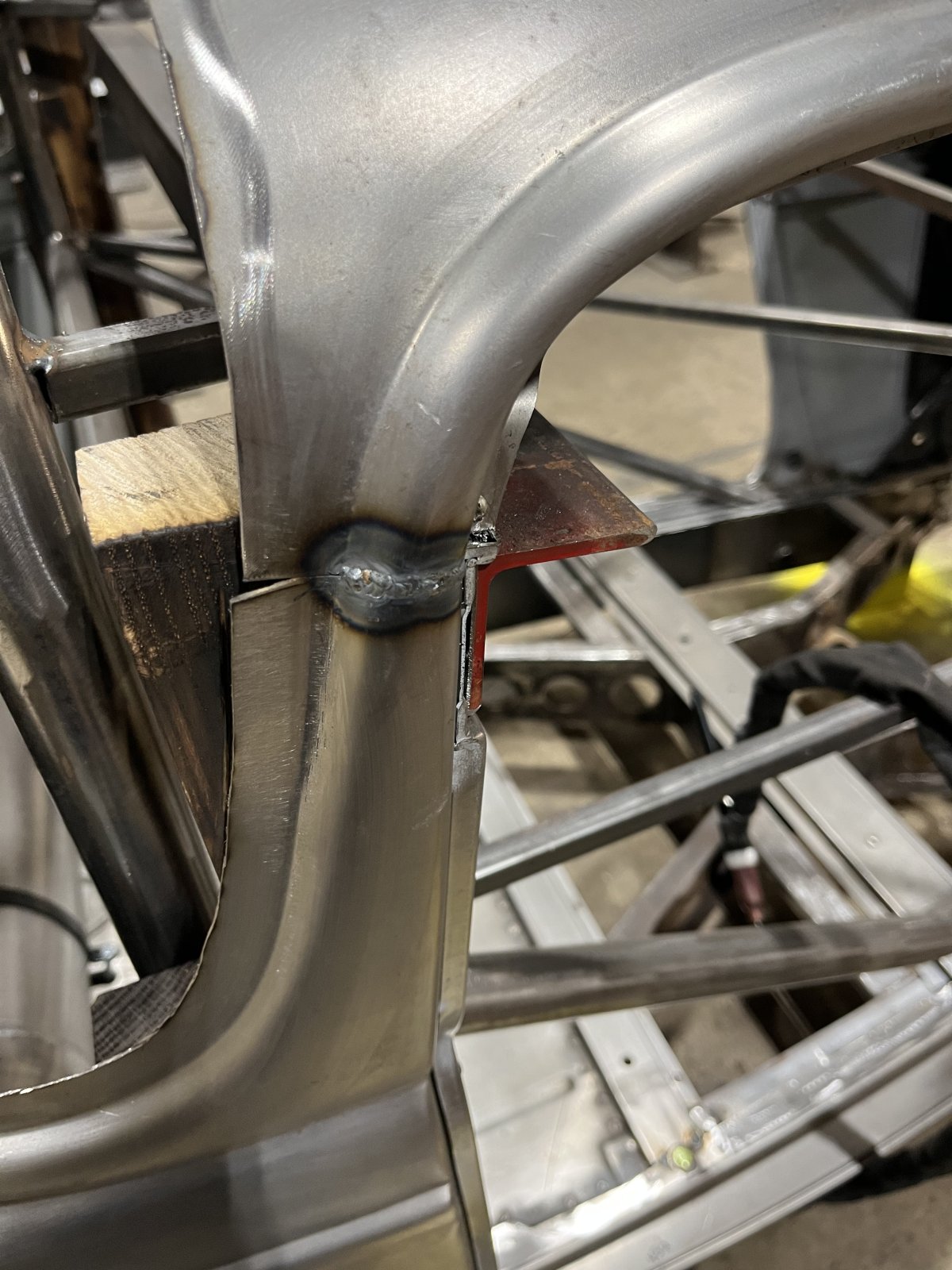

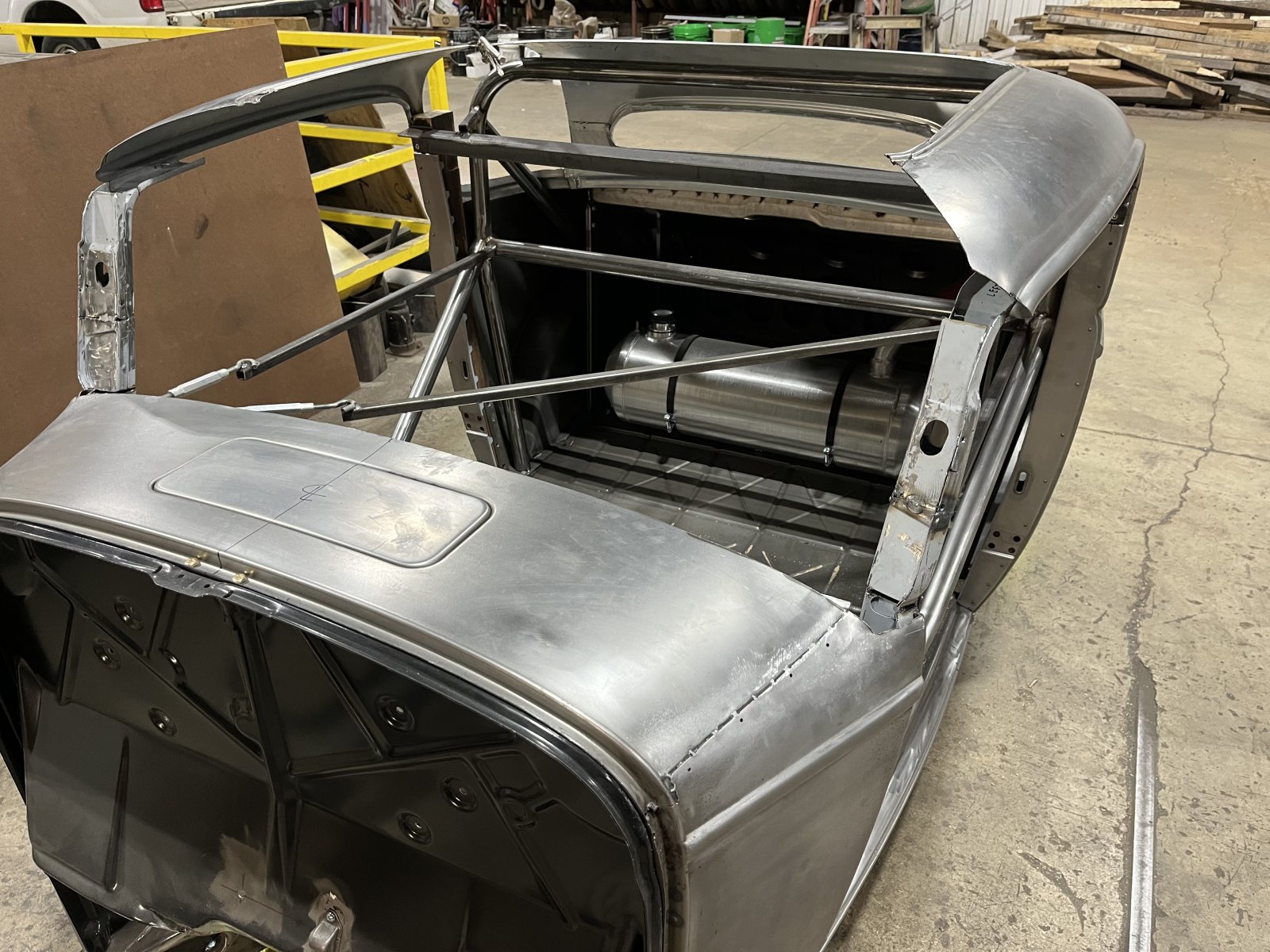

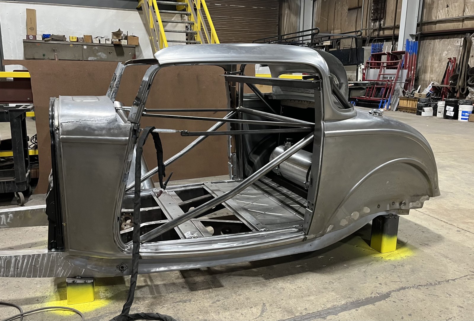

    C5FE91A0-3790-4763-A851-F69F7AC1C2EB.jpeg 61CCCC99-5925-4AD9-AA98-83E122FD7A57.jpeg How I blended the B-pillars. Start by aligning the door opening edge.

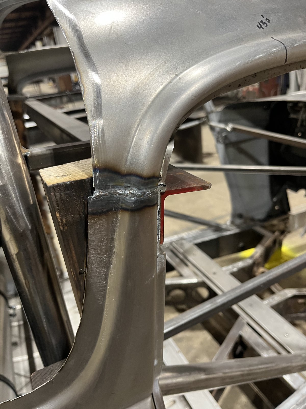

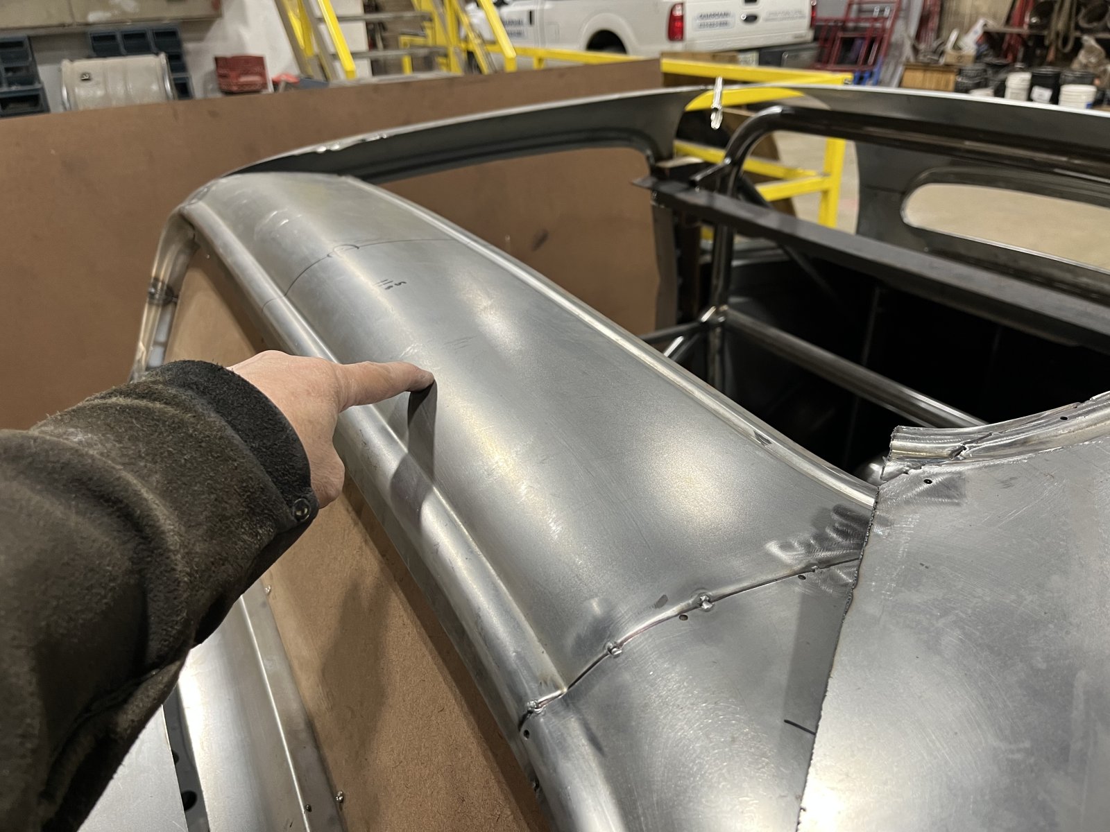

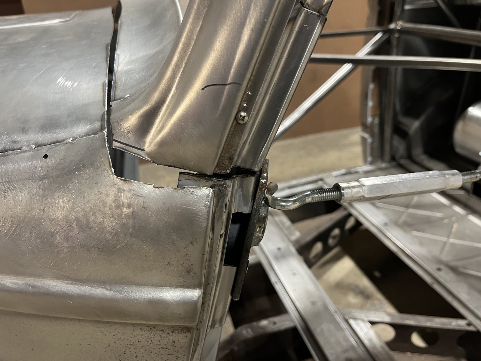

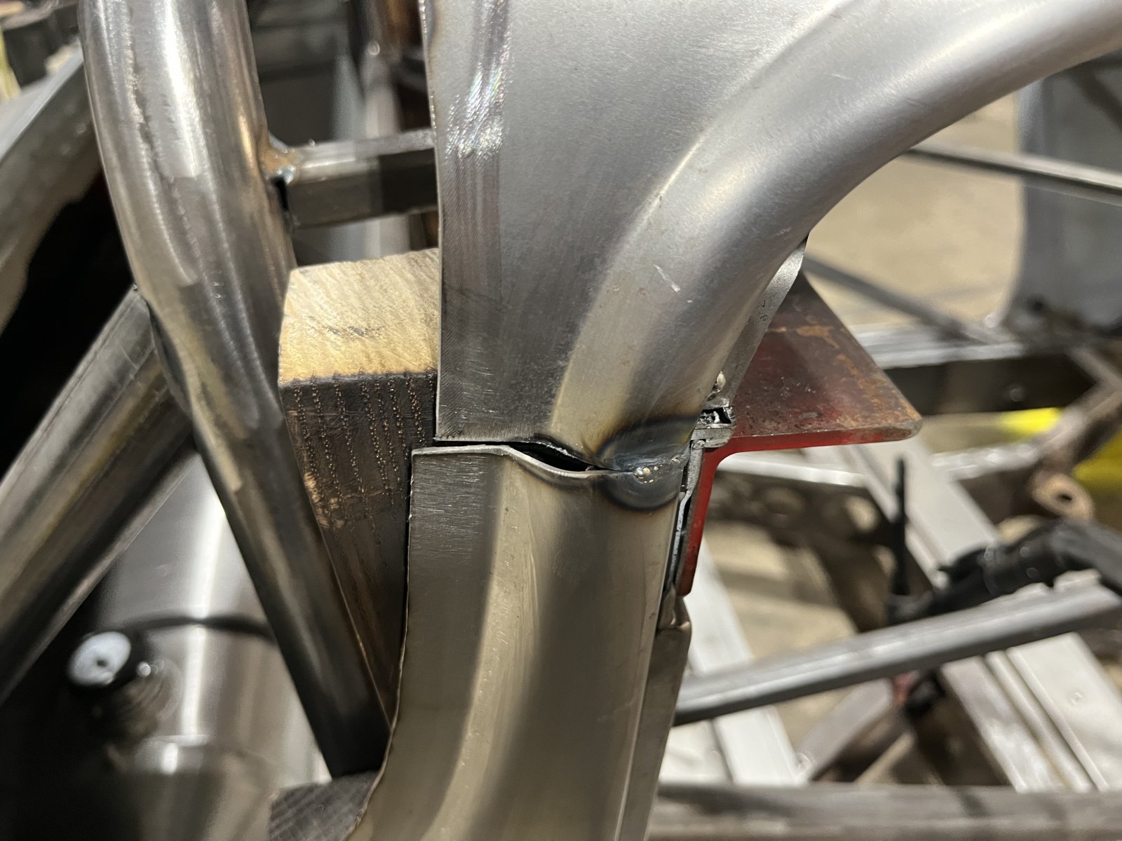

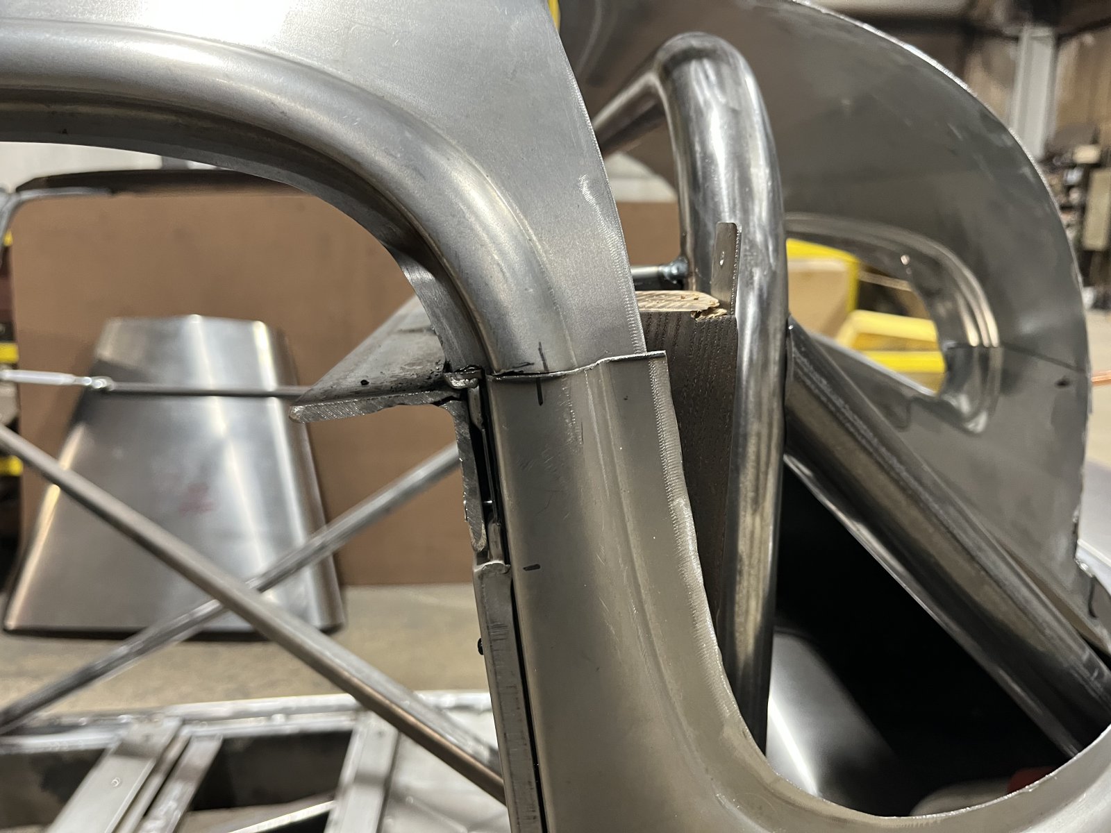

    Then hammer and dolly to blend them together. Then weld up that seam. 9C3FF73E-4987-4F1F-848B-22DF4F0F4581.jpeg A3ED76A6-CEE1-4BAA-A256-6E99E85E89CF.jpeg 5920D1B6-0BFD-4427-ACD2-A4B122C5BAF2.jpeg 367EA6AD-5C91-45D5-9CEB-14D72B5CC086.jpeg

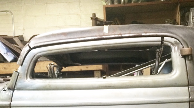

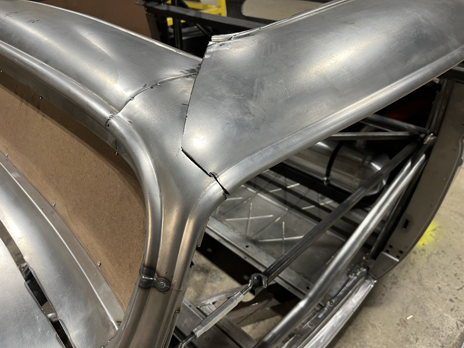

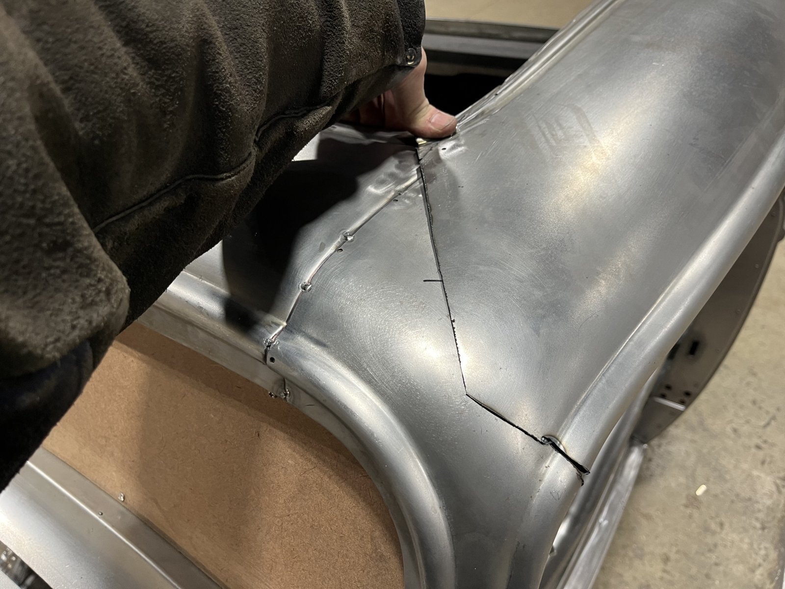

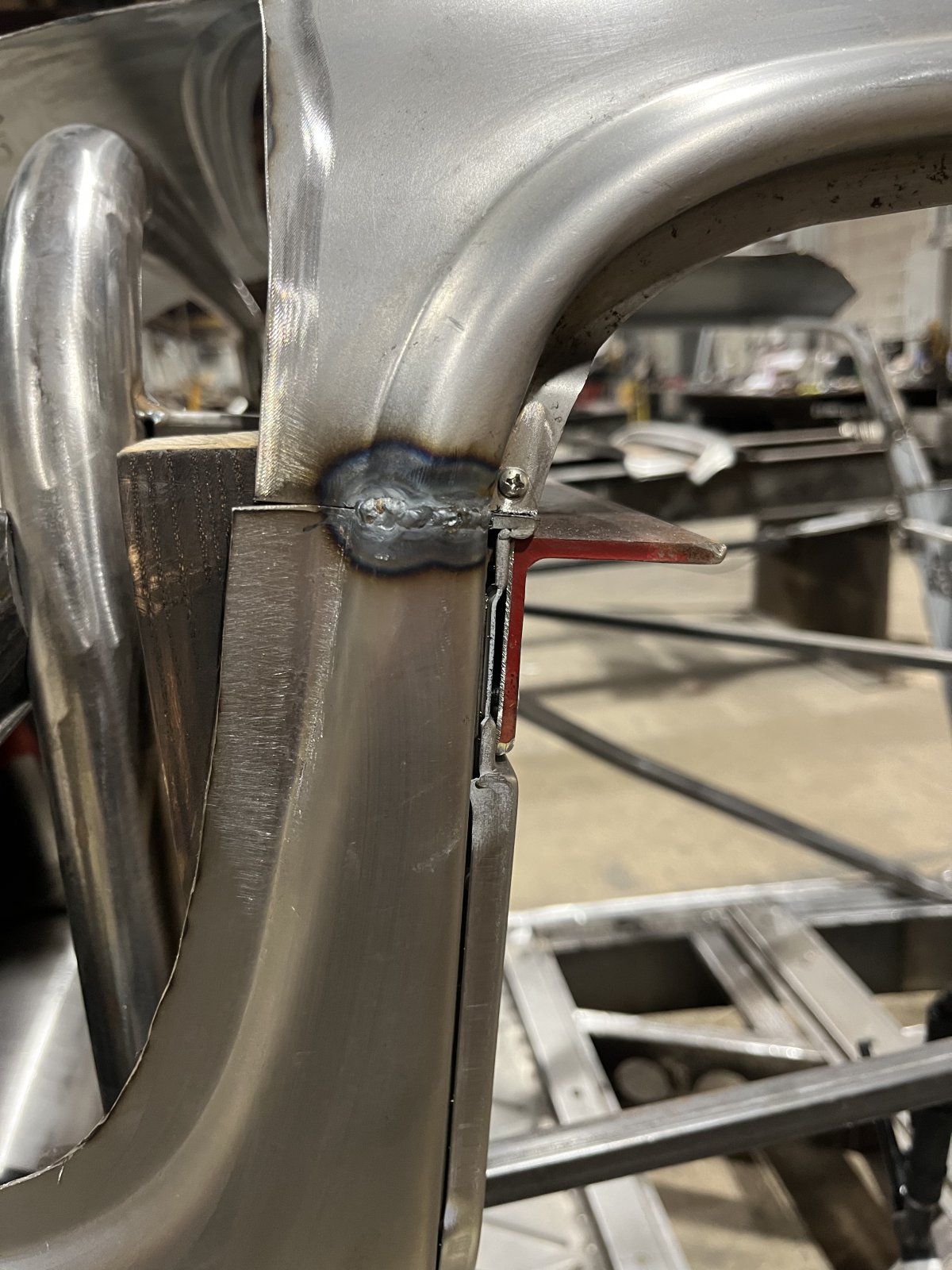

    D84B51B6-22F8-44D3-B6DC-89D0C203DBF0.jpeg Or the alternative method I’ve seen done by others. Not sure if one technique is better than the other, but I saved a lot of welding and grinding to blend the B-pillar in.

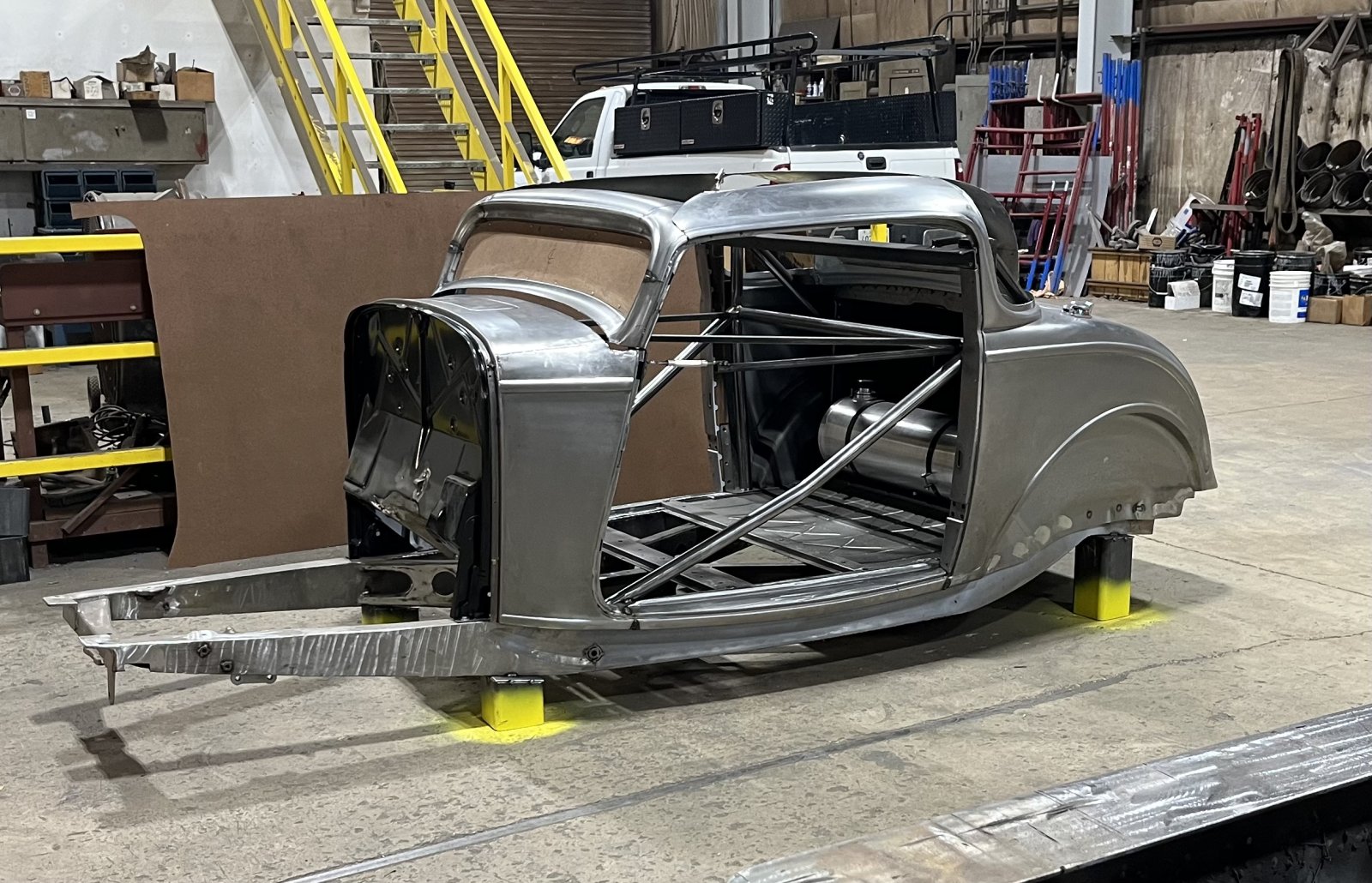

  24. 65standard
    Joined: Jun 14, 2011
    Posts: 1,096
    65standard
    The front of the frame rails are done. It’s been bobbed and pinched.
    Still tweaking the A-pillars to flow as smoothly as I can make them. I want to keep the stock length along the door tops.
    Any pie cut here will open that distance and then the door tops will need to be lengthened. 6DD3F43D-E97B-438C-8D09-25588FB04CEB.jpeg

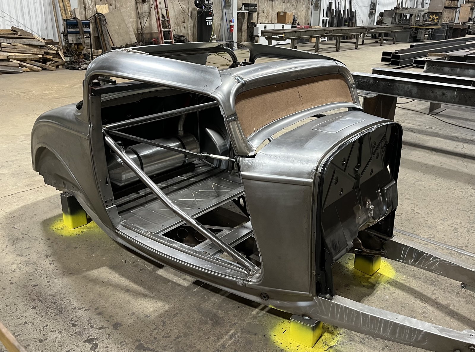

    D6E93C0A-42D7-4B5B-AC6B-37A4E23870D4.jpeg E5C04315-6CDA-4BB1-9D23-186D8CEDDF00.jpeg
    The corners will be easy. Just scribe and trim to fit. Here’s a rough idea of where I’m going with the corners
