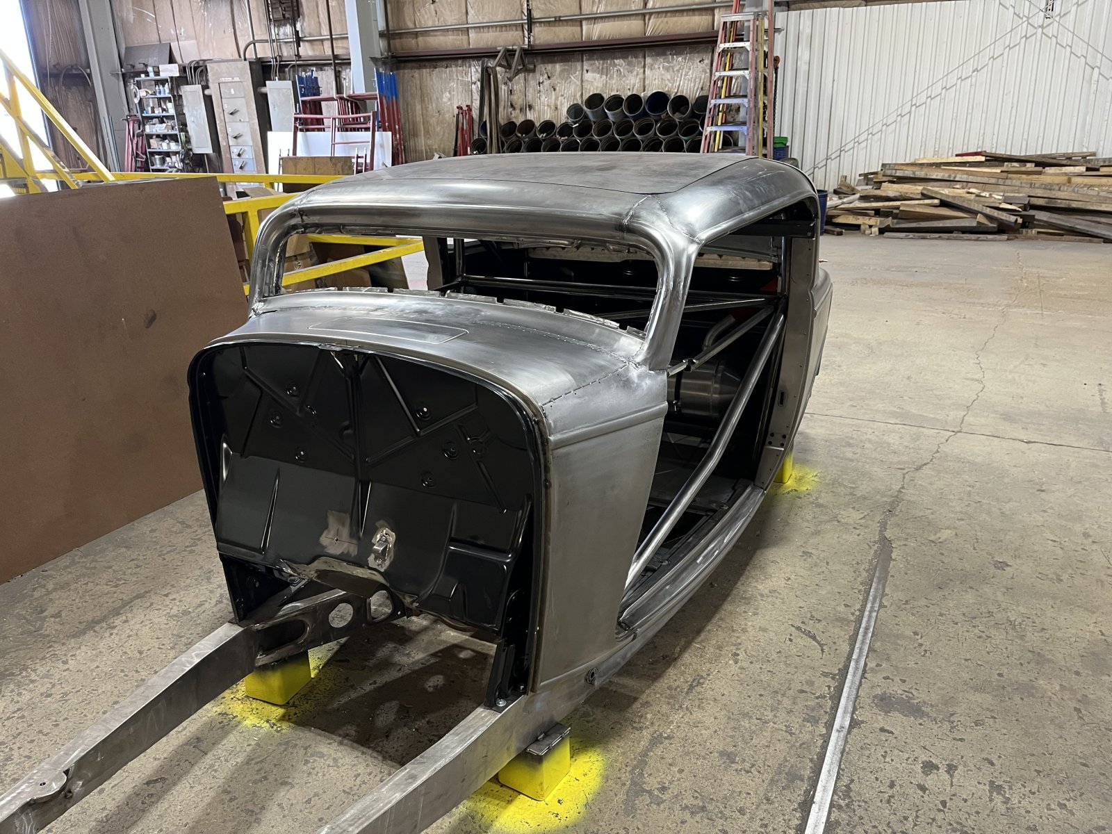

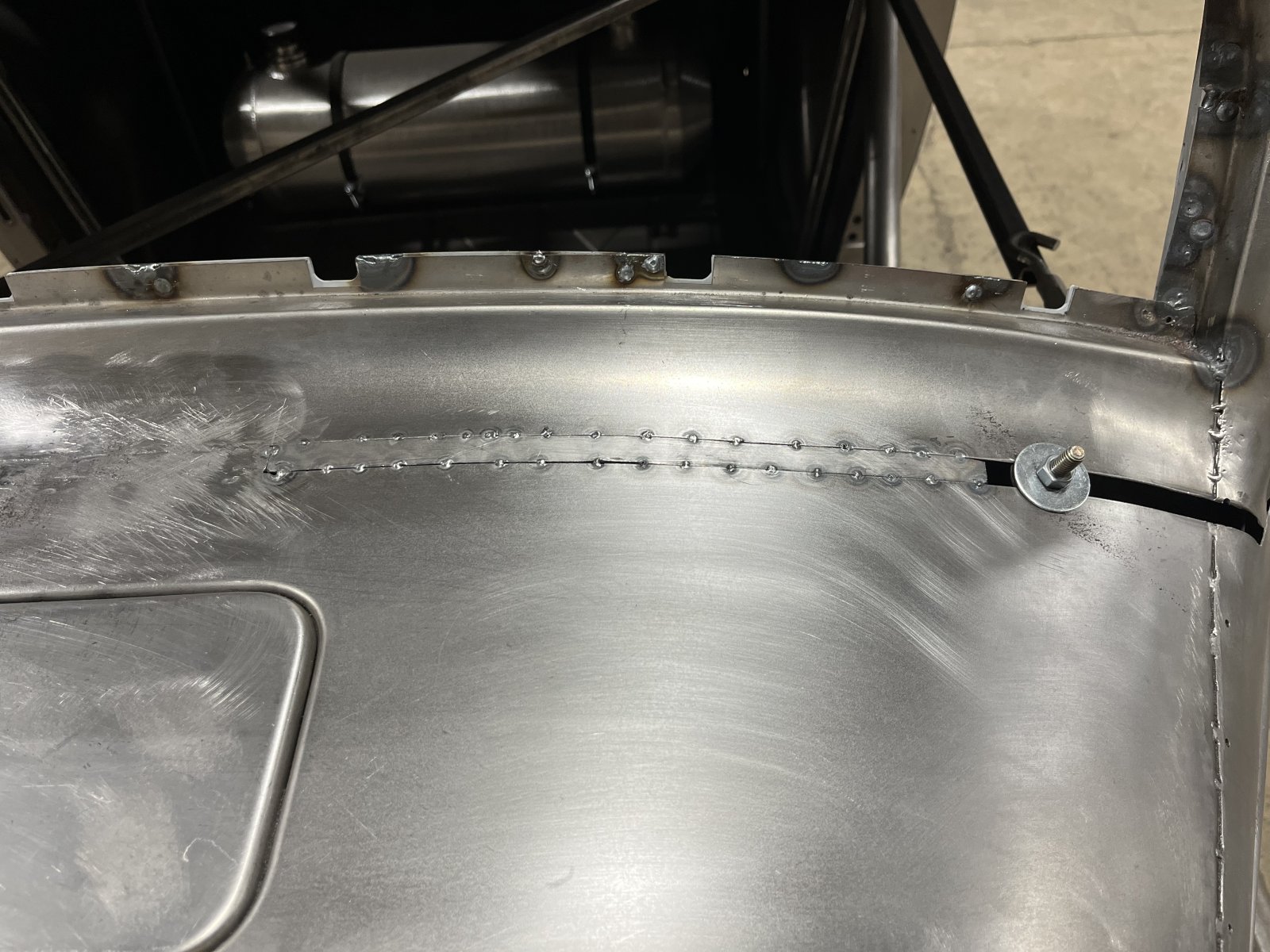

    Next the other corner and then that long 5/8” gap across the cowl.

    Lovely work, thanks for walking us through what you are doing, such a nice job!

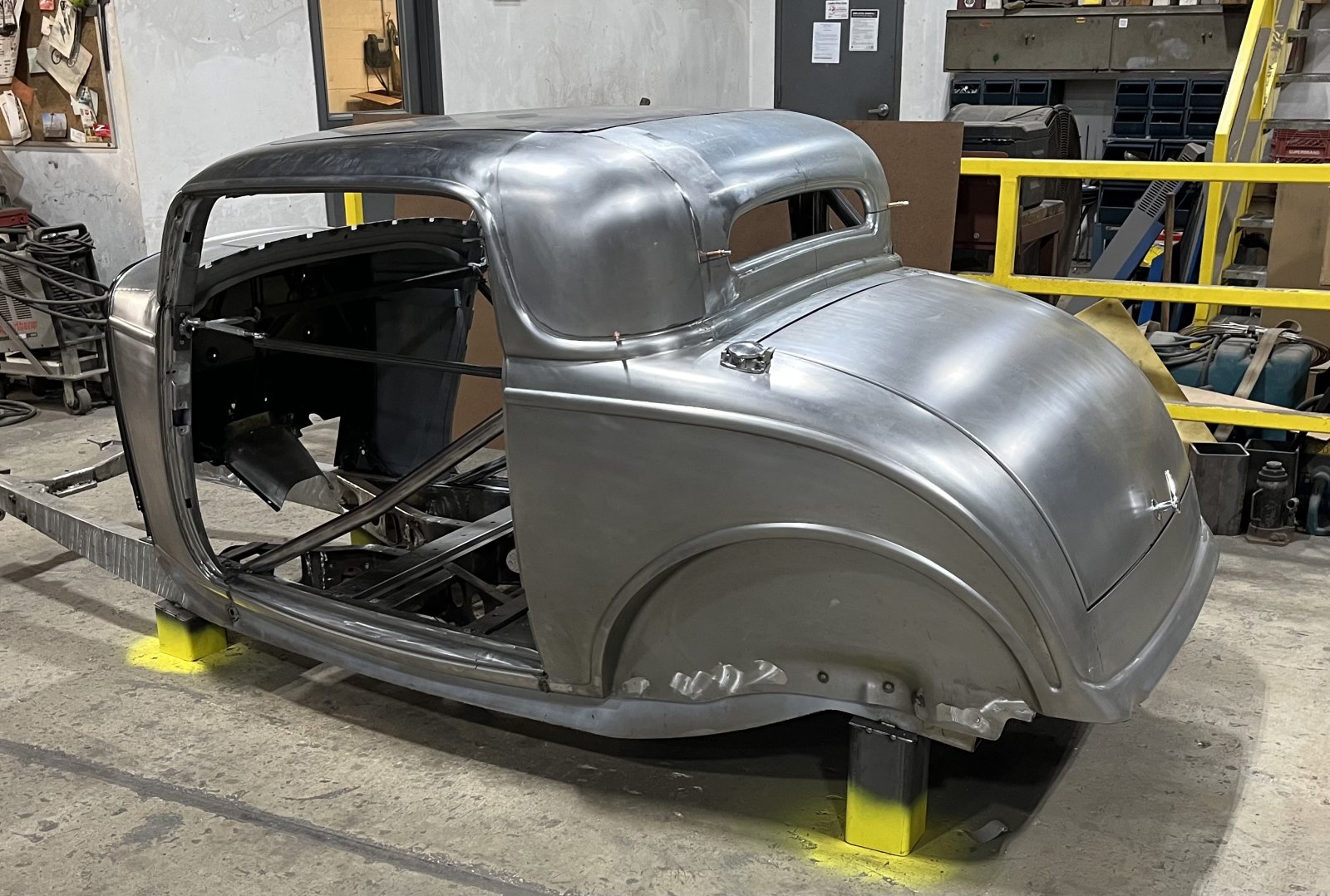

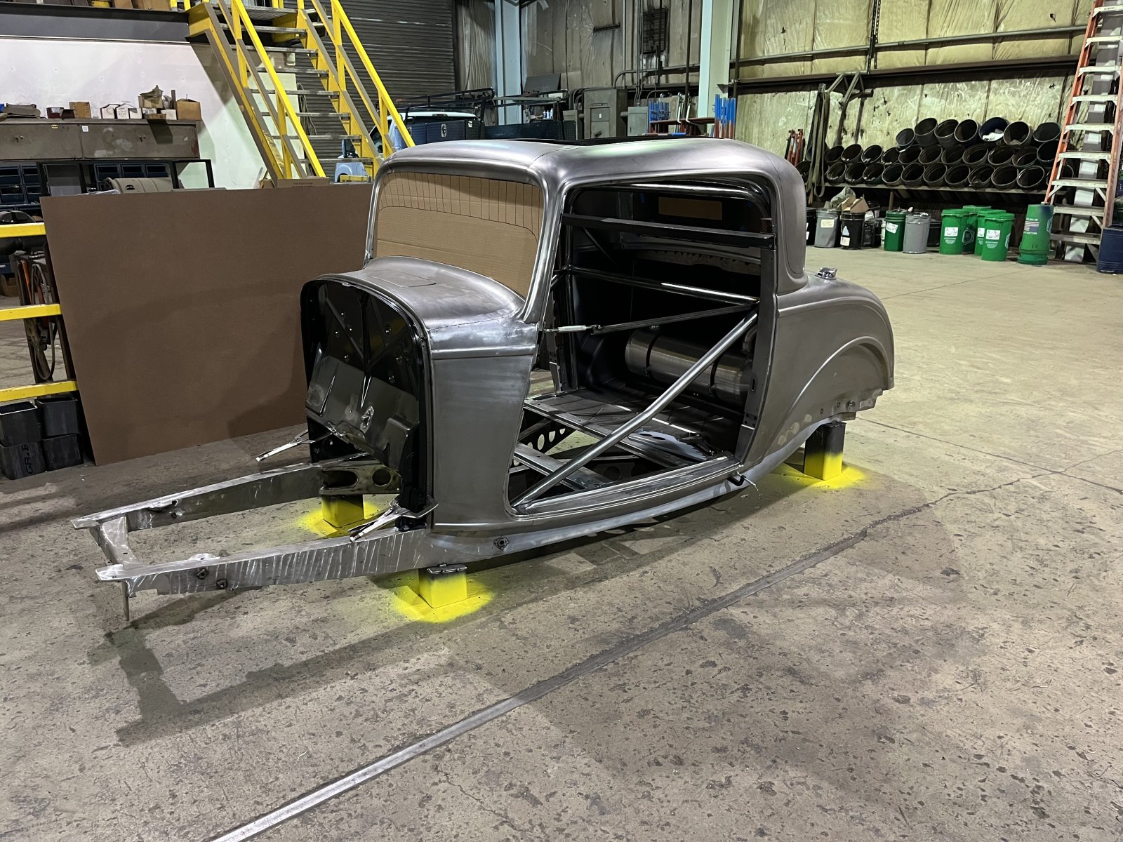

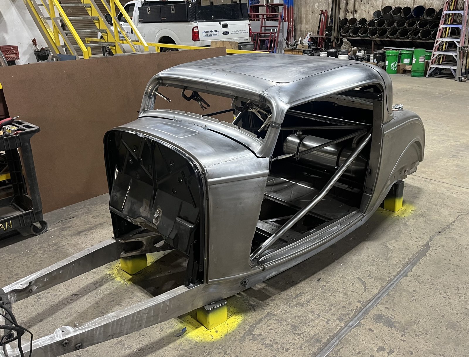

    DDB76123-348C-43CC-87D7-FB40821C9277.jpeg 6436633E-C83D-4C9E-B1E3-620881998ED9.jpeg Starting to work on filling the cowl gap. Test fit the roof skin to get a look at the profile. Everything is coming along smoothly and easy.
    I’m no Bobby Walden, but I like my technique on a heavy chop.

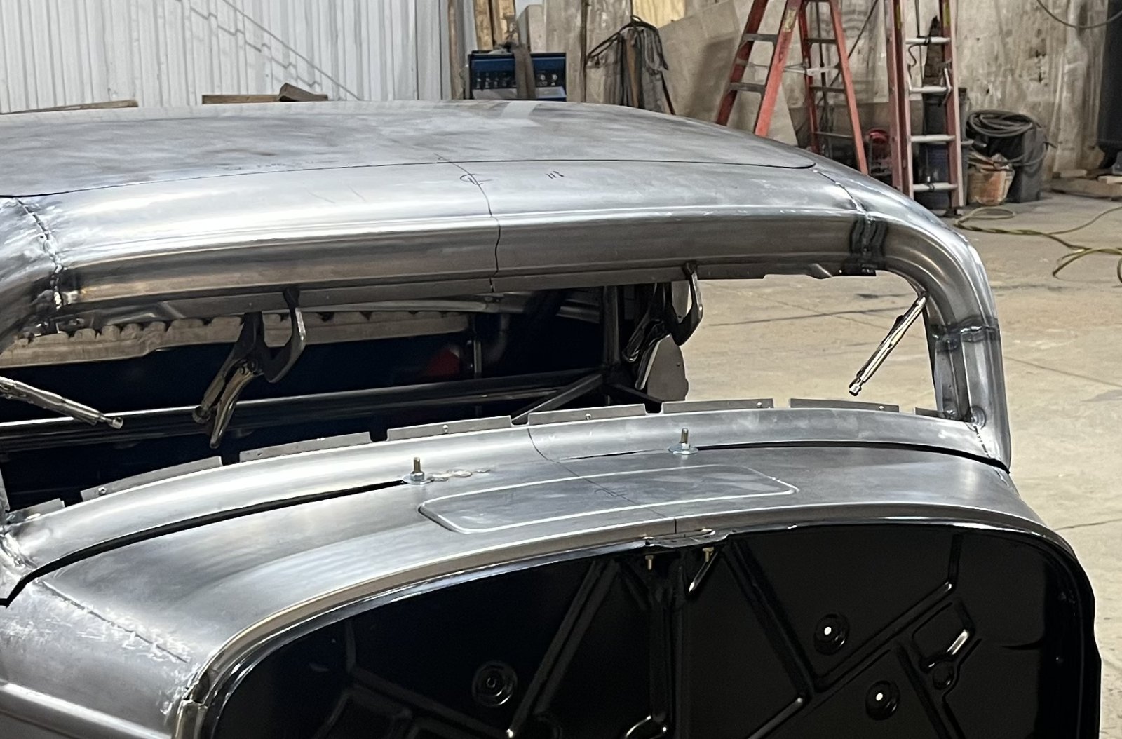

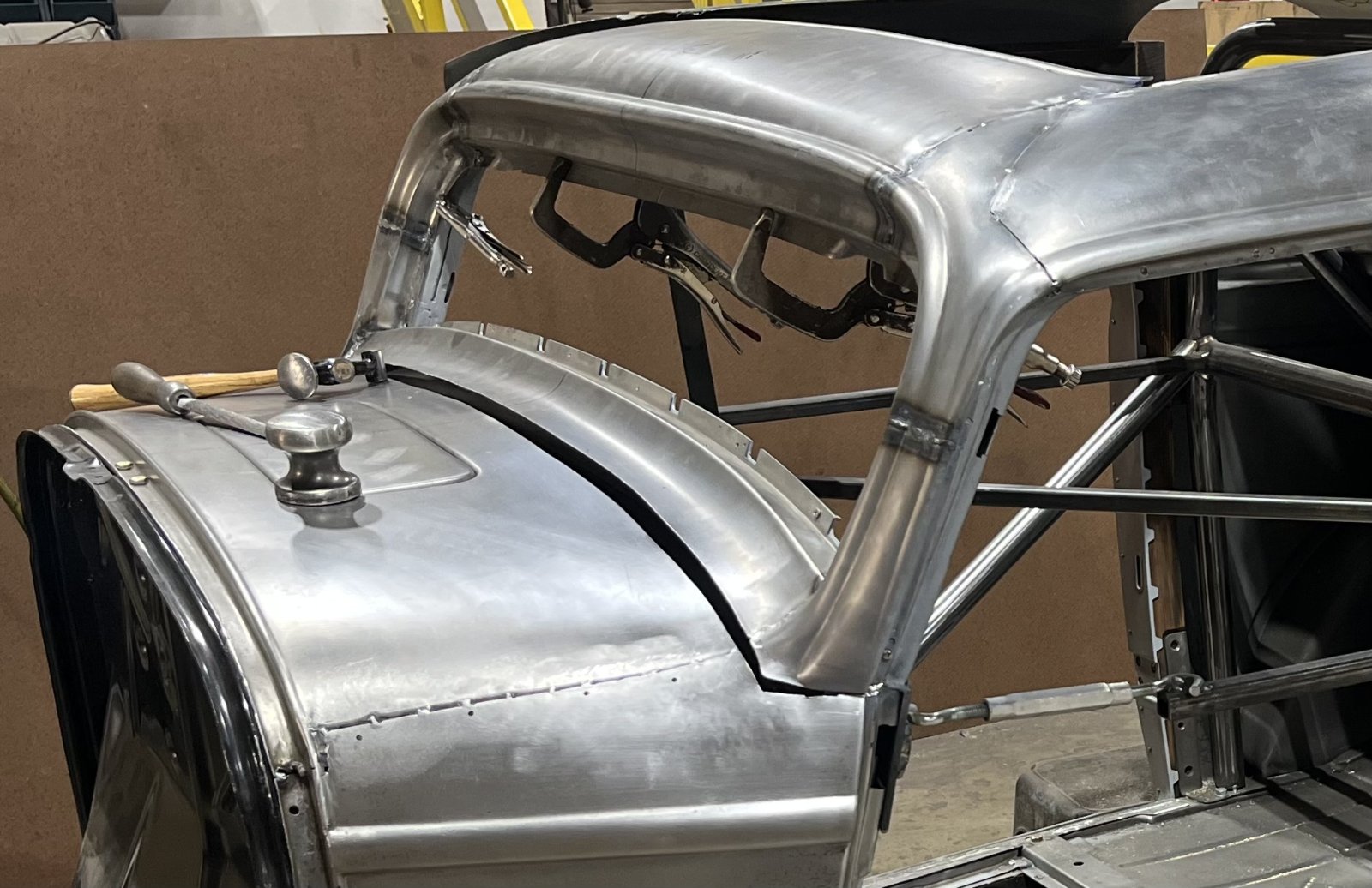

    970A31AF-18C3-44FB-9957-66D64049AE06.jpeg D3C63FEA-312B-4BBA-B808-F5D036A4BD58.jpeg Very different look

  8. Great job...fun to follow along on your progress and process! What's the purpose/story on the yellow spray painted legs and floor?

  10. Dang the un-chopped version looks goofy now
    redzula, rpm56, 65standard and 8 others like this.
  11. flamedabone
    Joined: Aug 3, 2001
    Posts: 5,700
    flamedabone
    Unchopped early Fords look like a tractor cab.
    -Abone.
  12. 65standard
    Joined: Jun 14, 2011
    Posts: 1,096
    65standard
    1. COE's (Cab Over Engine)

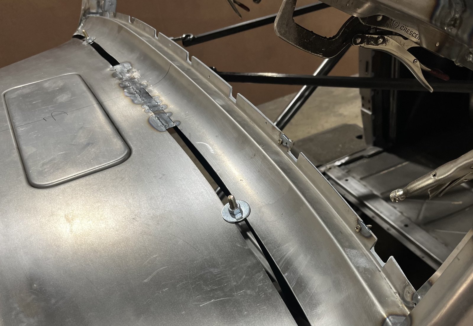

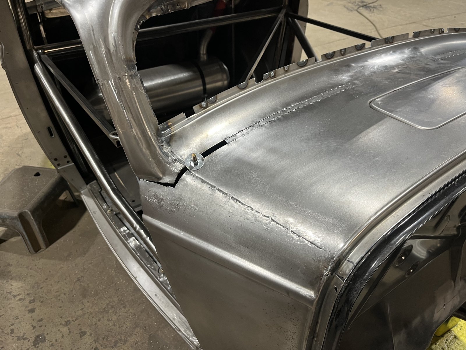

    Working on filling the cowl gap 12” at a time. I aligned the metal with a couple of bolts and washers. Then cut a strip of 19ga and scribed it to fit the gap. 8E64227A-15AB-4B9D-8372-AA0B2E76D722.jpeg 97E2F334-A0F7-48C0-B53C-AEF269140FAB.jpeg

    4A15032F-6C15-45DF-966B-7E4A4E4A522C.jpeg EF1B649B-C9FE-413F-8DF0-D278C84AE1AB.jpeg C6923EC7-4120-49DA-A4EB-EEC90CE76B54.jpeg D6AA1120-33D9-4459-AD63-2E11C9E52D4B.jpeg Tack welded it in
    Then fully welded
    Next I knock the top of the weld down close to the parent metal. Then the long process of hammering and dolling the weld to restretch it. Finally, comes the filing and planishing to even it up.
    I don’t want to grind any of the parent metal away. I would rather fill with lead than to keep grinding the weld down til it disappears.

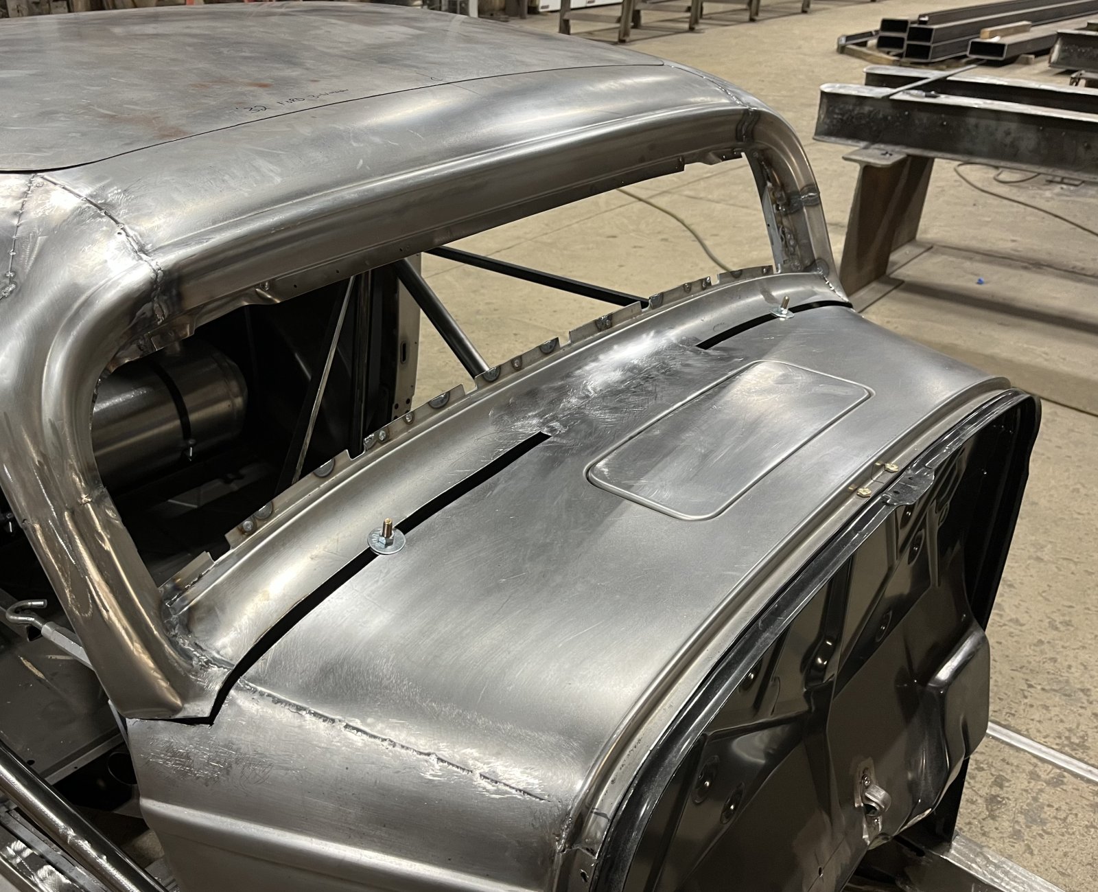

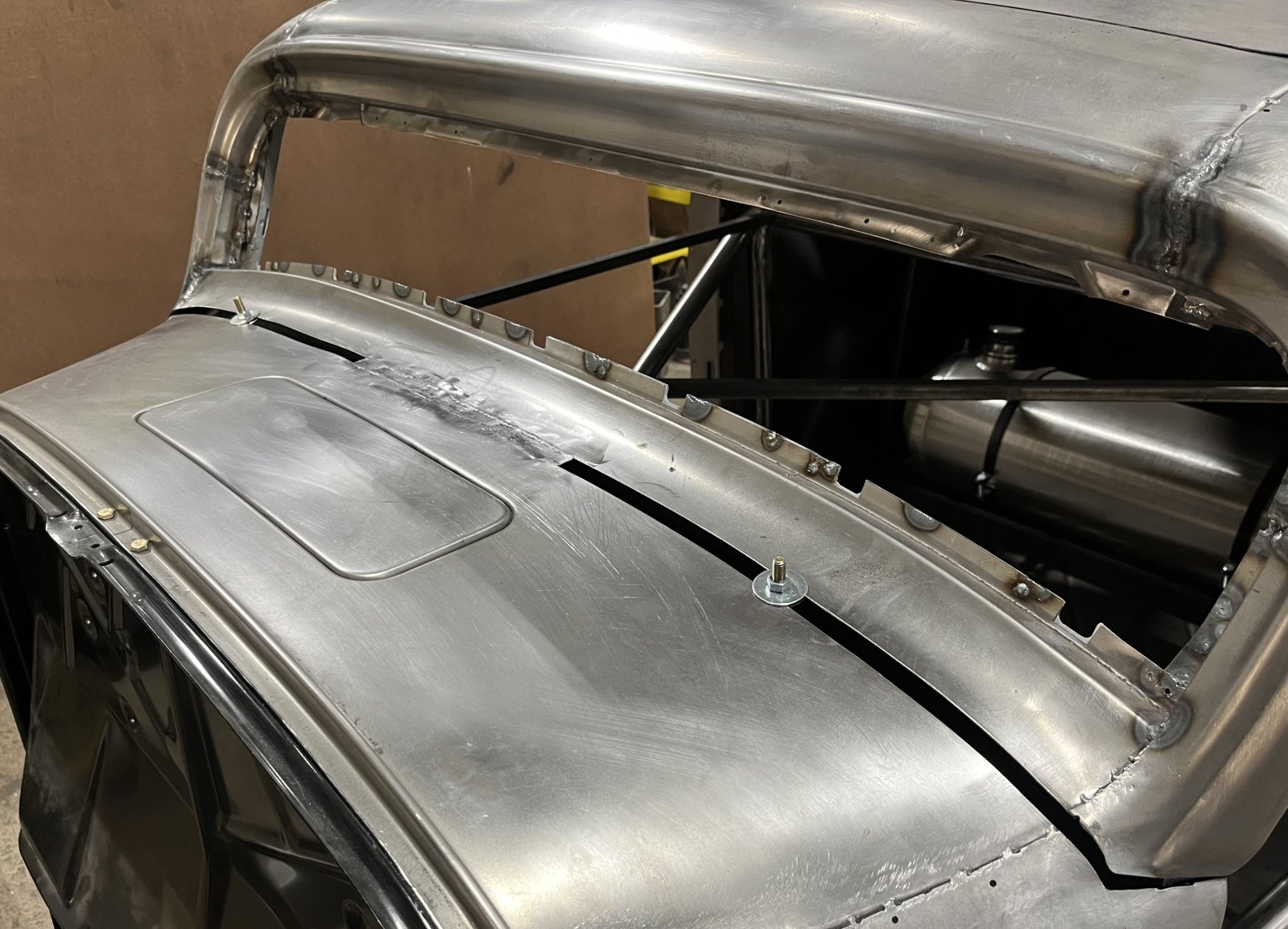

    A5E5F5BF-4D95-4617-887F-2462C78AD949.jpeg Continue filling the cowl gap.

    In pictures always looks to me as windshield section higher then rest of cowl. Is it the picture, my eyes, or do you hammer down as weld or?
    31chevymike likes this.

    I guess it looks like I bashed it down in the picture but I didn’t. I will try to metal finish the panel. I don’t want filler.

  17. It looks like the suicide doors will attach with two hinges per side.
    Do the hinge pins still align, so there will be no bind?
    Nice progress.
    tb33anda3rd and 31chevymike like this.

    I only removed the middle hinge so the doors should still swing like originals
    31chevymike, porkshop and lucky ink like this.
  21. Understood, easier to align two hinge pins than three.
    31chevymike and Fordors like this.
  22. 65standard

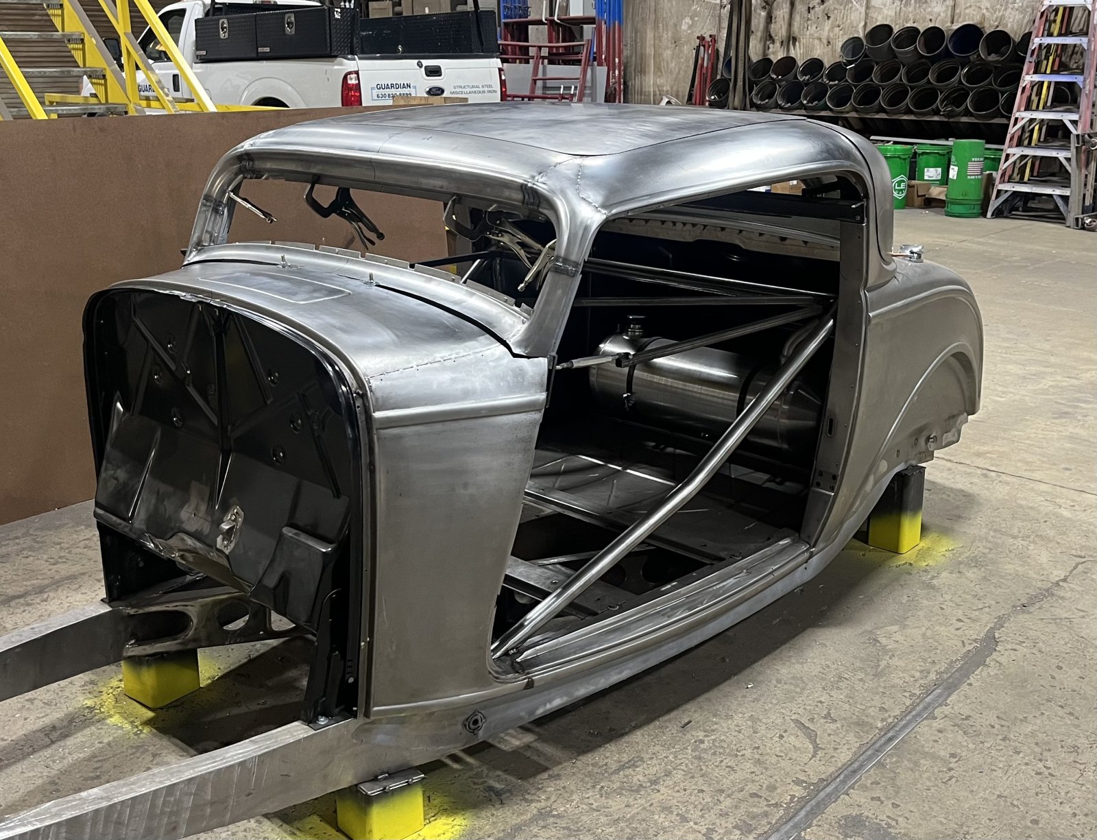

    3CCDD12A-1DC0-4D39-8BC0-98B10310AC8F.jpeg Half the cowl is filled.

    Looks like welding that narrow strip puts a lot of heat in one area. But you're keeping it from warping.
    Might be too much to ask, but I will anyway. Any chance of you doing a short video of the process? I'd love to see your technique. Especially the hammering. For our education. Perfectly okay if you're not up to it, there are plenty of other hammer-welding how-to videos. But the proof is in the pudding, you make good pudding, and I think we might be able to learn something from you just by watching. I know I would.
    Keep up the awesomeness.

    I won’t post welding on here. Too many different opinions on how I need to do it.
    Welding the strip on the cowl isn’t anything special. I can say is get it tacked in and aligned up perfect before welding.

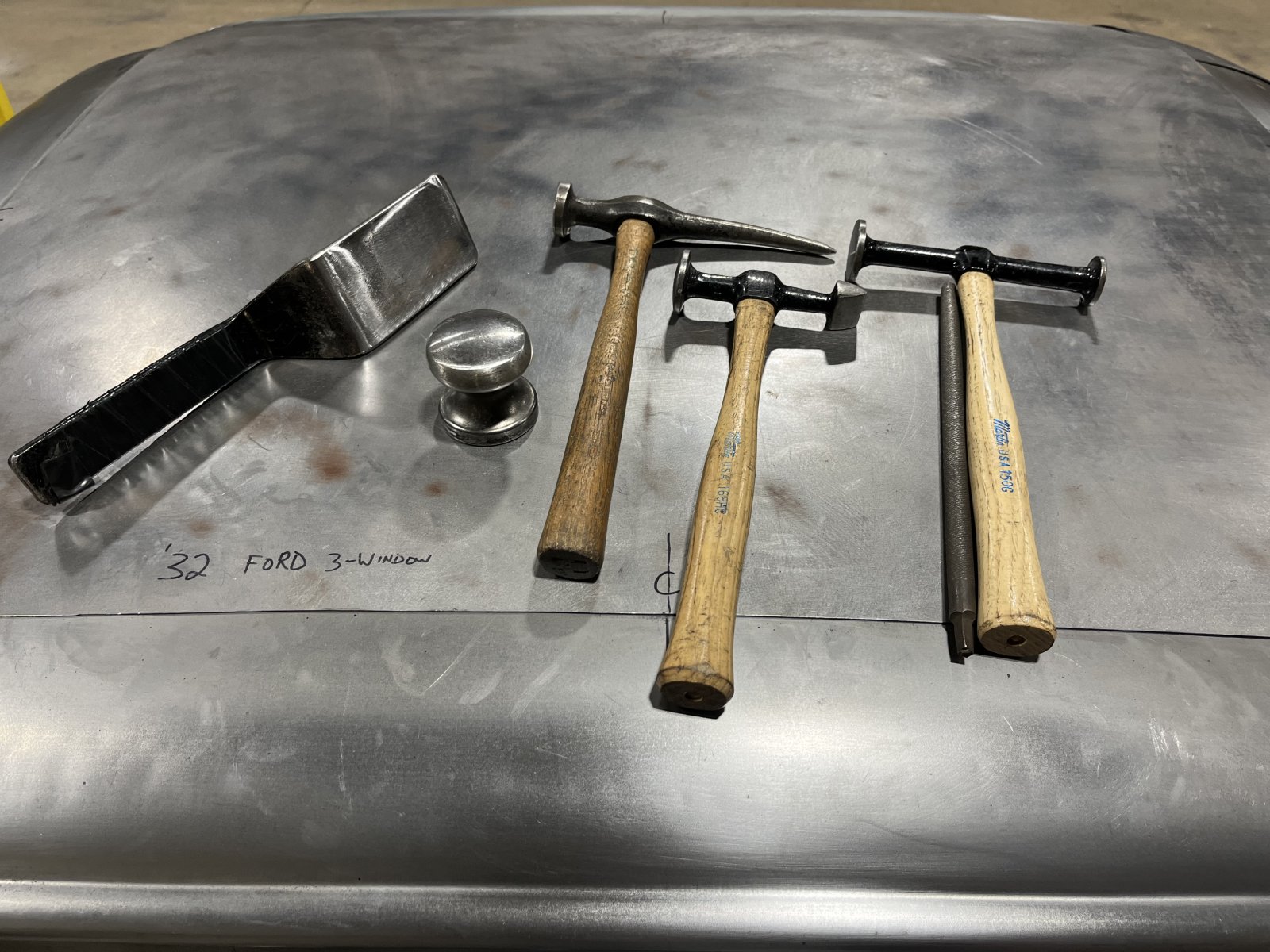

    There is no such thing as warpage from welding. What is actually happening is the weld shrinks from the heat and that shrinkage may pull and distort the metal panel near the weld. Do not try to fix that distortion. Just re stretch the weld with a hammer on dolly technique and the distorted metal will relax and fall back in shape.
    I’ve seen more panel ruined from grinding heat than welding.
    I learned my metal skills from Peter Tommasini. He took me under his wing and showed me hands on how to move metal. He sells DVDs on how to do these things.
