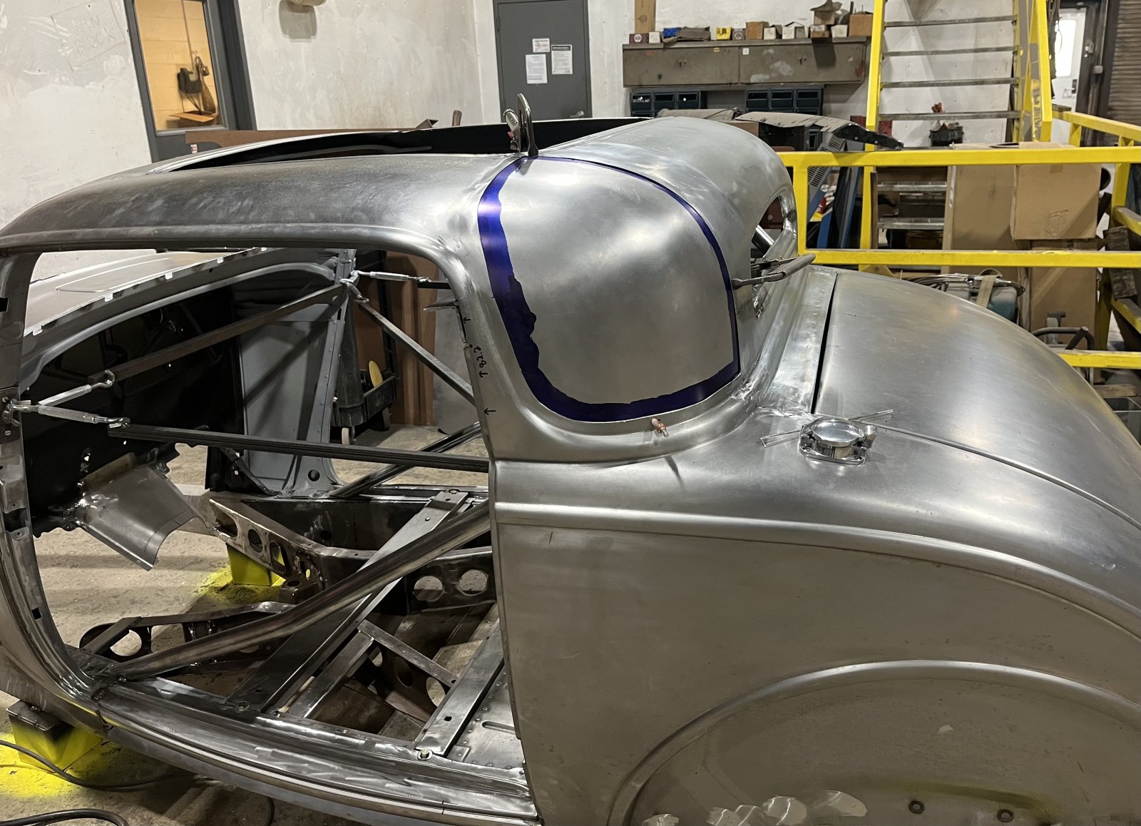

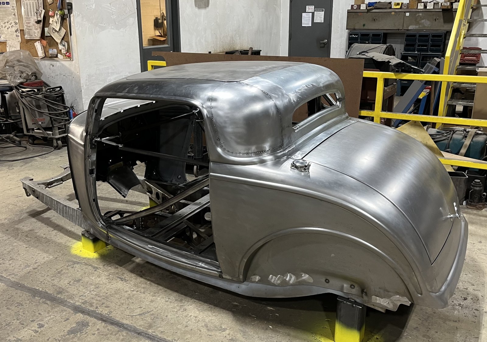

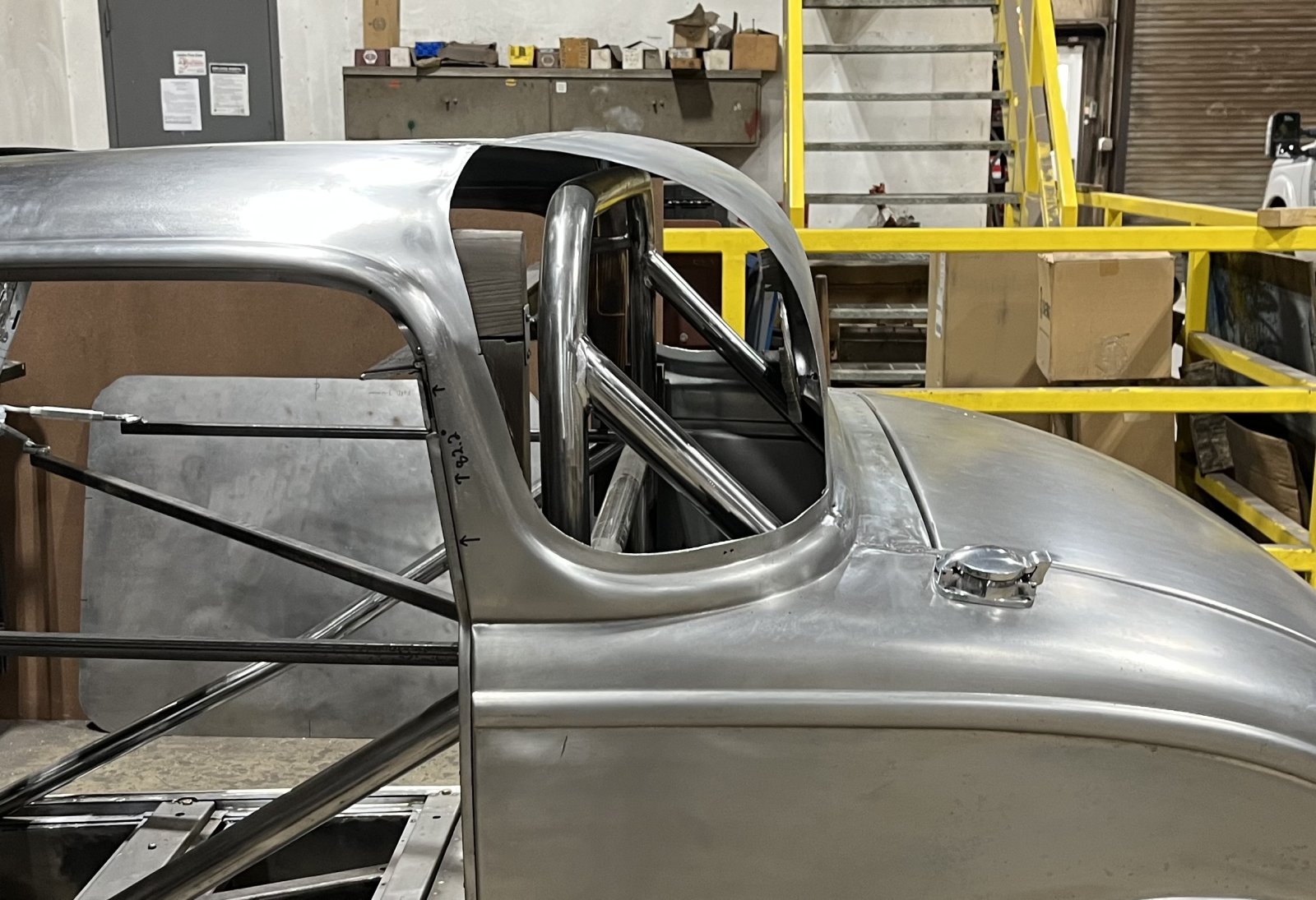

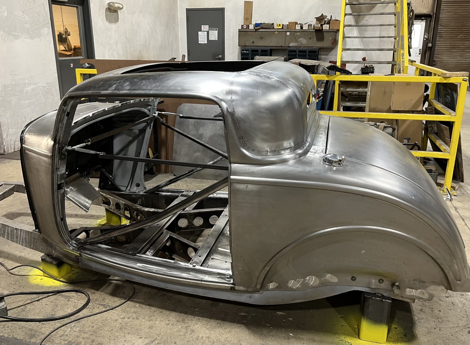

    661F63CE-9FC0-4333-B4A5-A1CF47CF695F.jpeg Finished filling the cowl gap

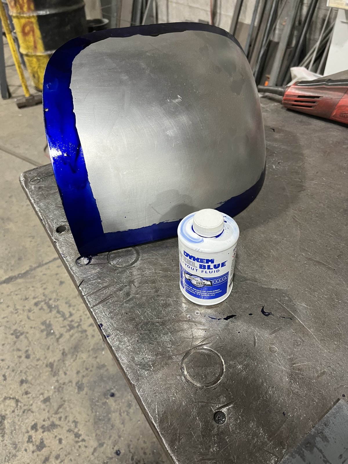

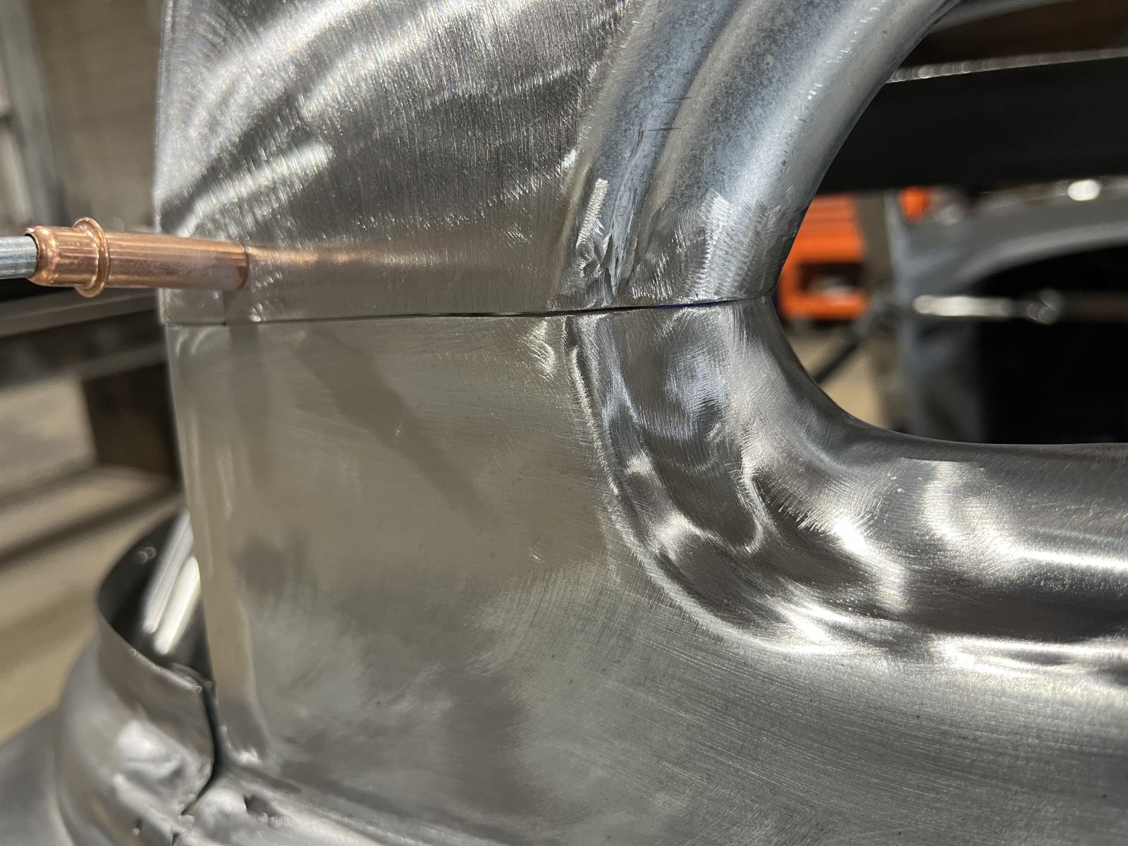

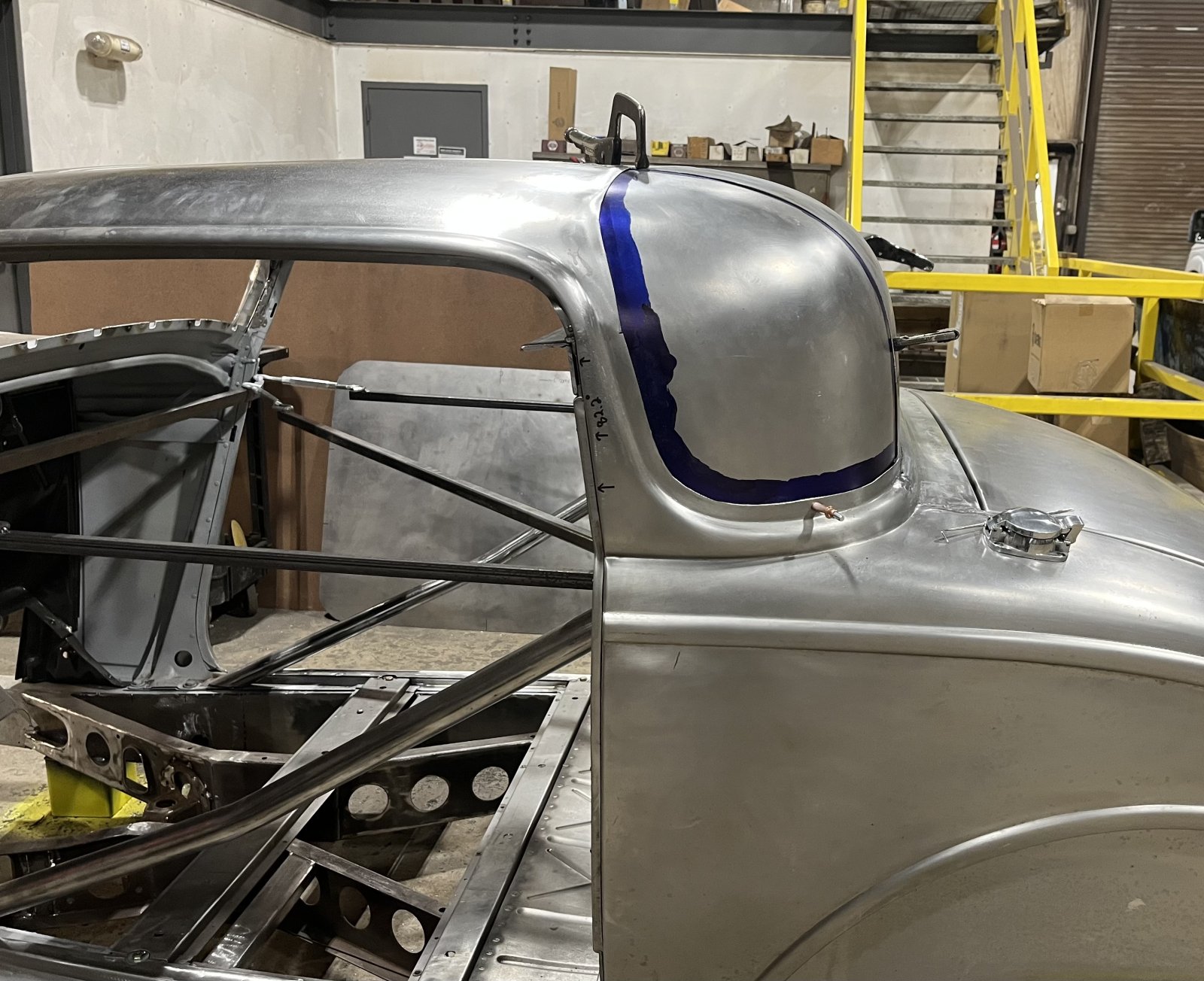

    B34C21D6-718F-4D4E-8E9D-4BBA5696650A.jpeg 68359E29-5D03-4AB7-AC81-DCDC038D10DB.jpeg 7AEAD43B-E216-4B21-A8F6-751B9012B933.jpeg Back on the rear window now. I cleaned the cut on the upper half of the window. Used ****m fluid on the lower half and cleco it together. Scribe the seam and pull it back apart

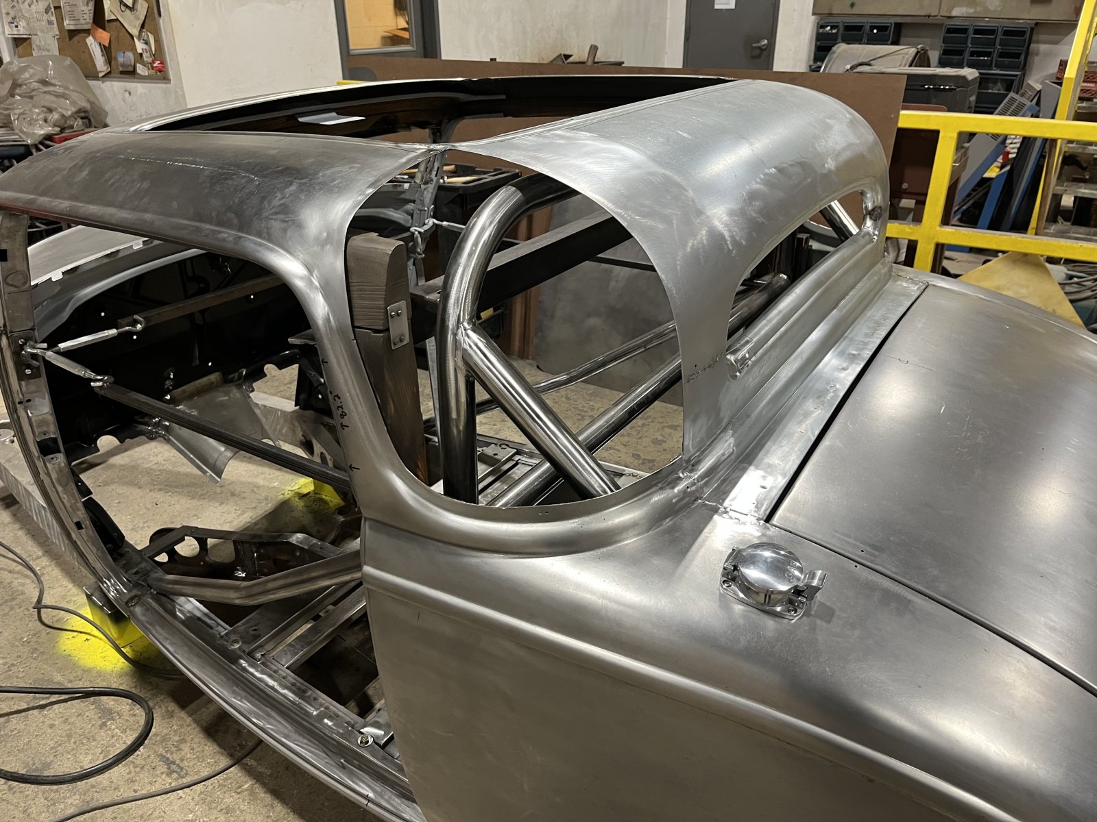

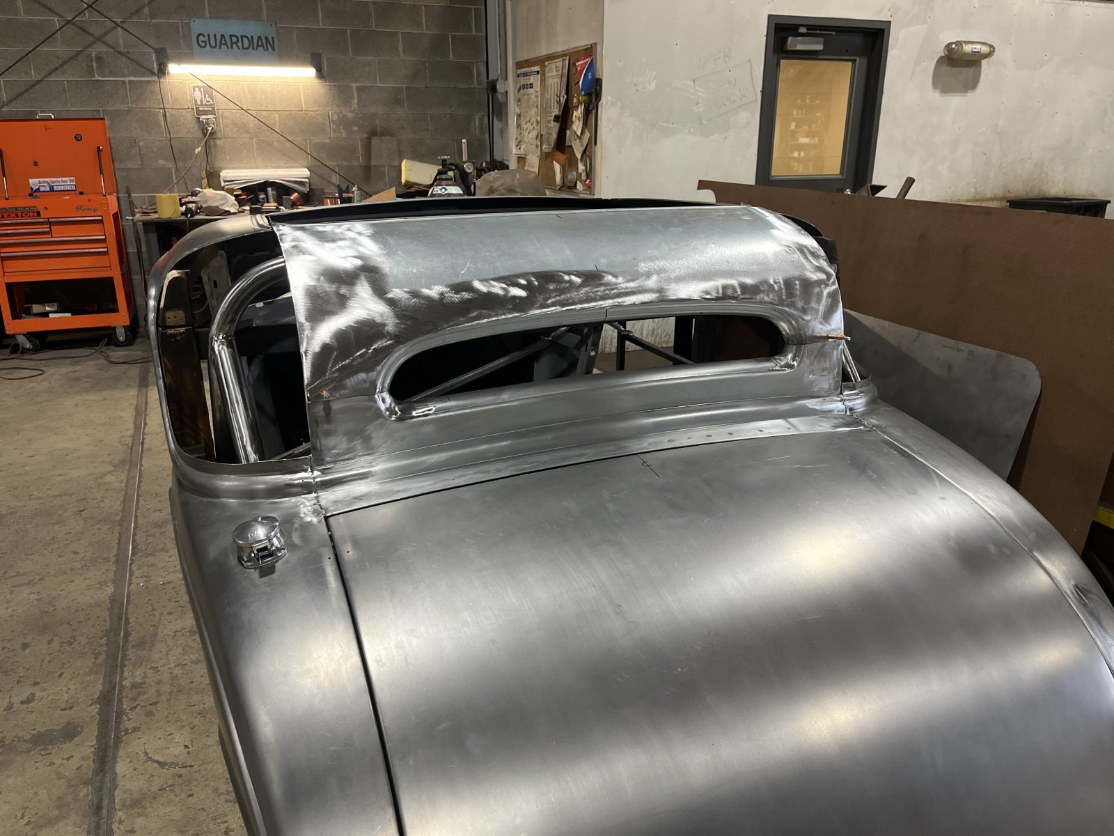

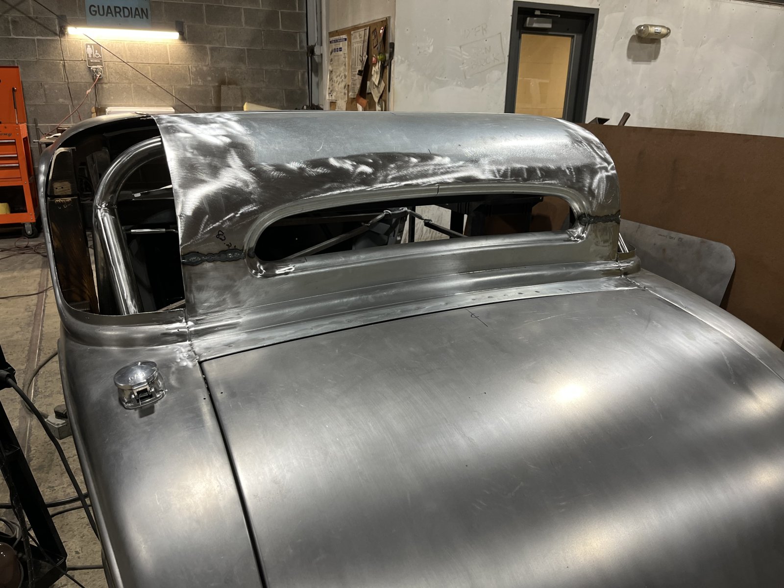

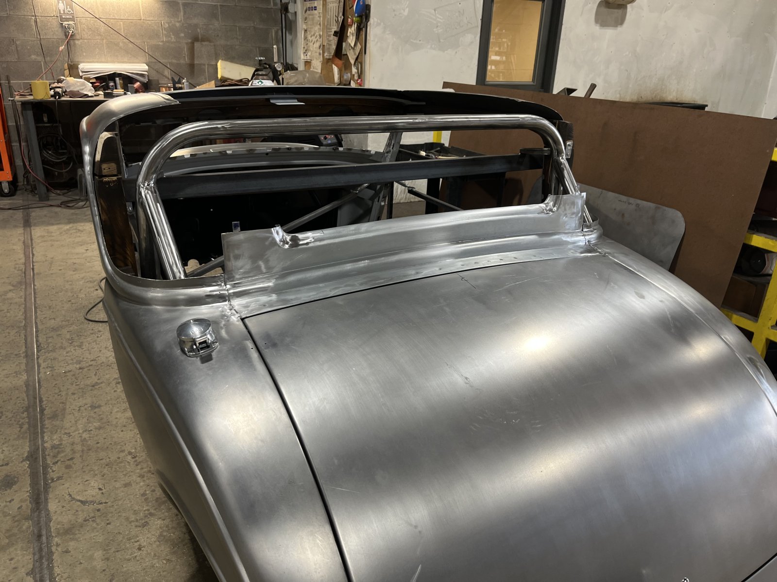

    C5FBEBA7-B2D4-4E75-9F8F-E4C535137802.jpeg 613D28A9-6ECA-493A-A1D0-BC23A9E0B30E.jpeg D904EBFD-787E-43BC-AE5B-0F6D74B258C5.jpeg 6FB3E210-0E6E-4F39-B7C3-20AD14915E75.jpeg F3AE4F6B-D746-4320-A13E-66B519AD9CF1.jpeg D4250DF1-1618-43AB-B773-ECD65E1D9631.jpeg Now Is the perfect time to weld up the roll bar. Would be nearly impossible to get it fully welded before.
    I cut the window at the scribe and left a small tab so I can cleco it back together. Carefully align the seam and start tack welding it up.

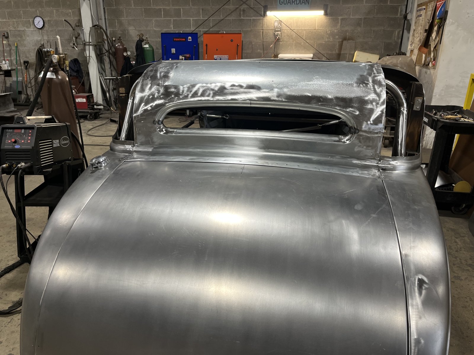

    84993BA8-3D3E-4C01-B503-01FA88E1F30C.jpeg Continuing with the back window. Finished tacking the seam.

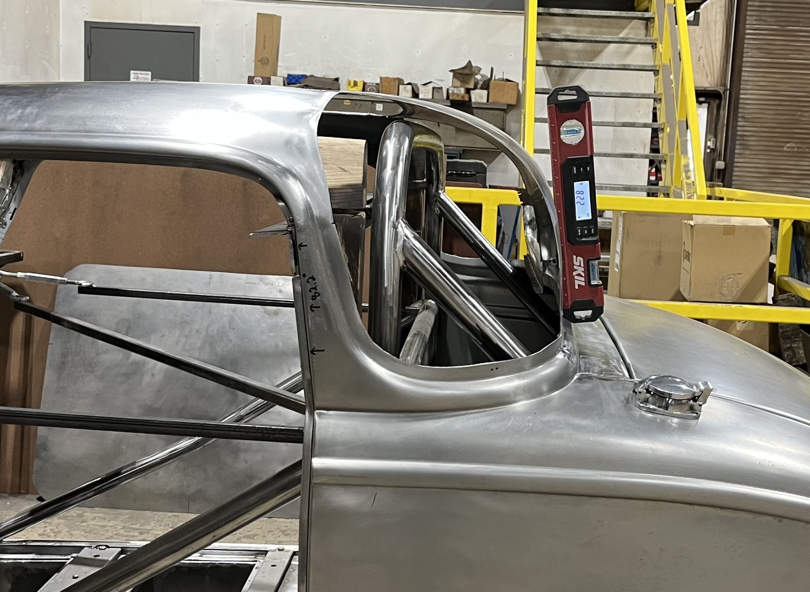

    7E5E6753-44D6-42C7-9CA3-B1A8B2605A9F.jpeg Next set the back window pitch to 82.2 degrees, same as the B-pillar pitch.

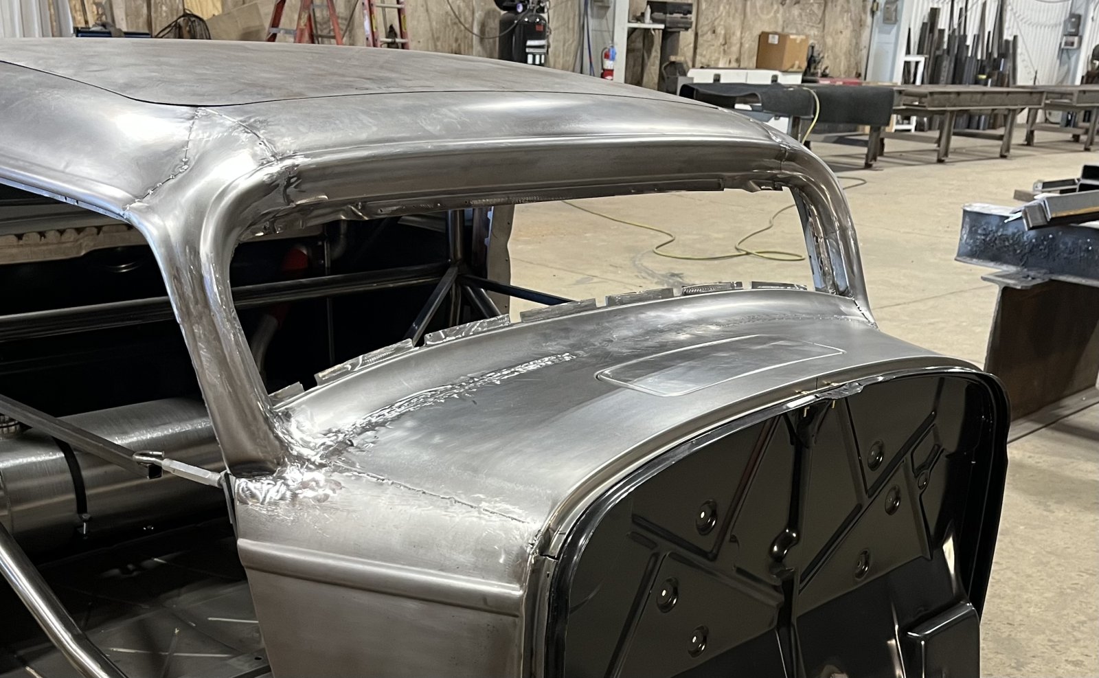

    E75CBB83-8F96-4D44-9967-E6726066C4F6.jpeg 2F1DC92B-A8EB-466A-9BC2-18FC5819AD5C.jpeg D4A345E4-1F24-4466-829F-635AA1EF4BCE.jpeg Then tack it in to the roof to lock the pitch it. Clean the corner openings so I can scribe them to fit.

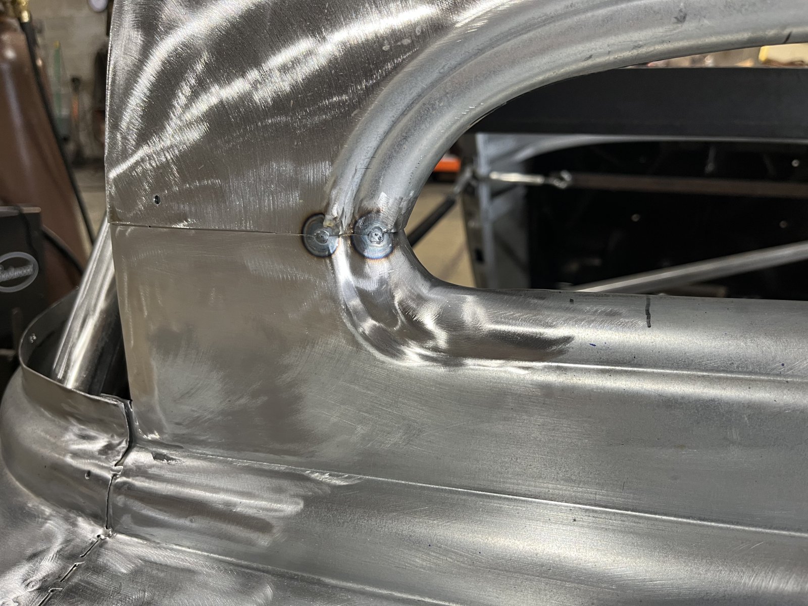

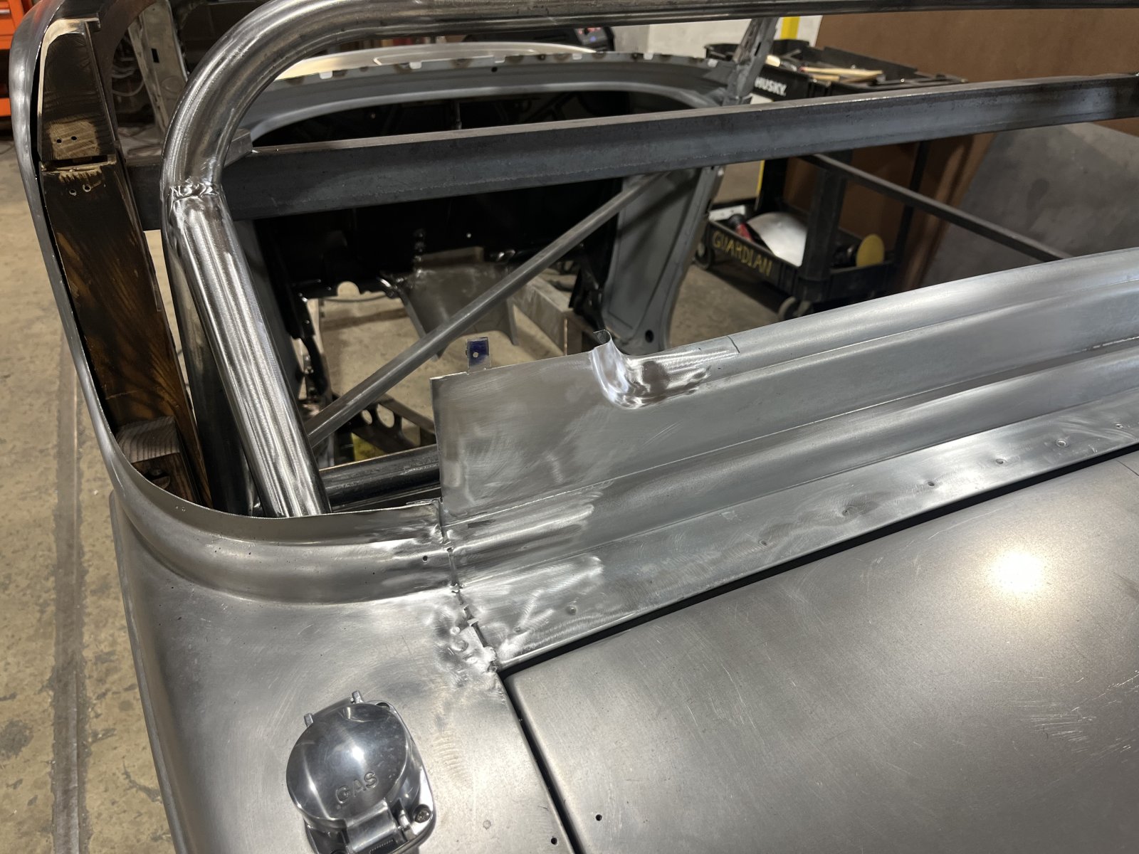

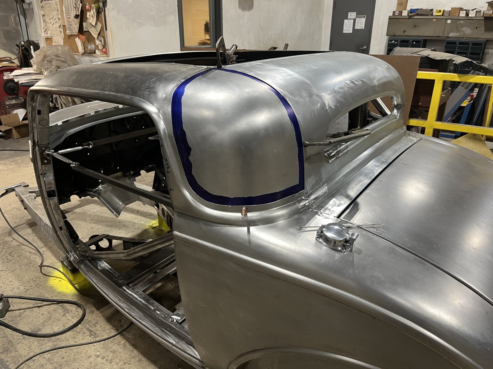

    06D8A4A8-8831-42DB-8AEA-342549B96C09.jpeg Some ****m on the corners so I can see the scribe line. Scribing will be in two steps. If I just hold the corner on the inside to scribe it, it will be the thickest of the 19ga too small. I need to do this in two steps. To be continued…

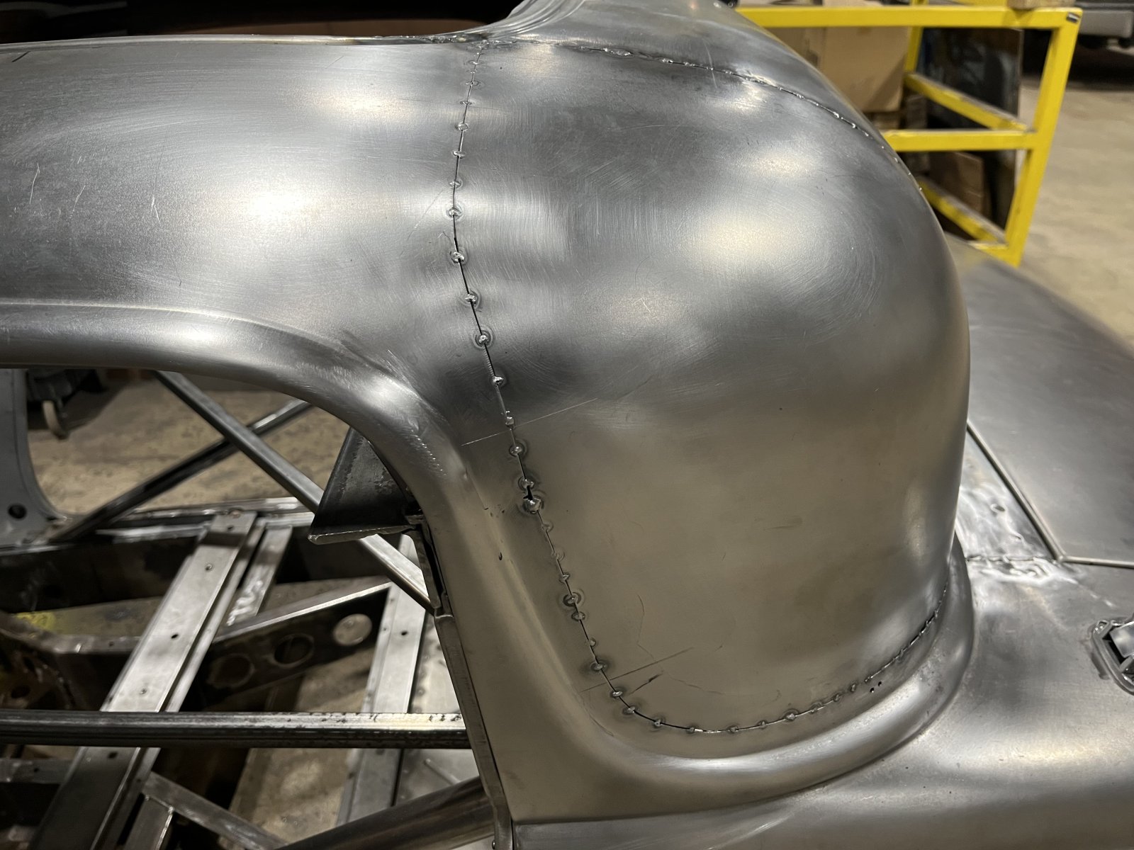

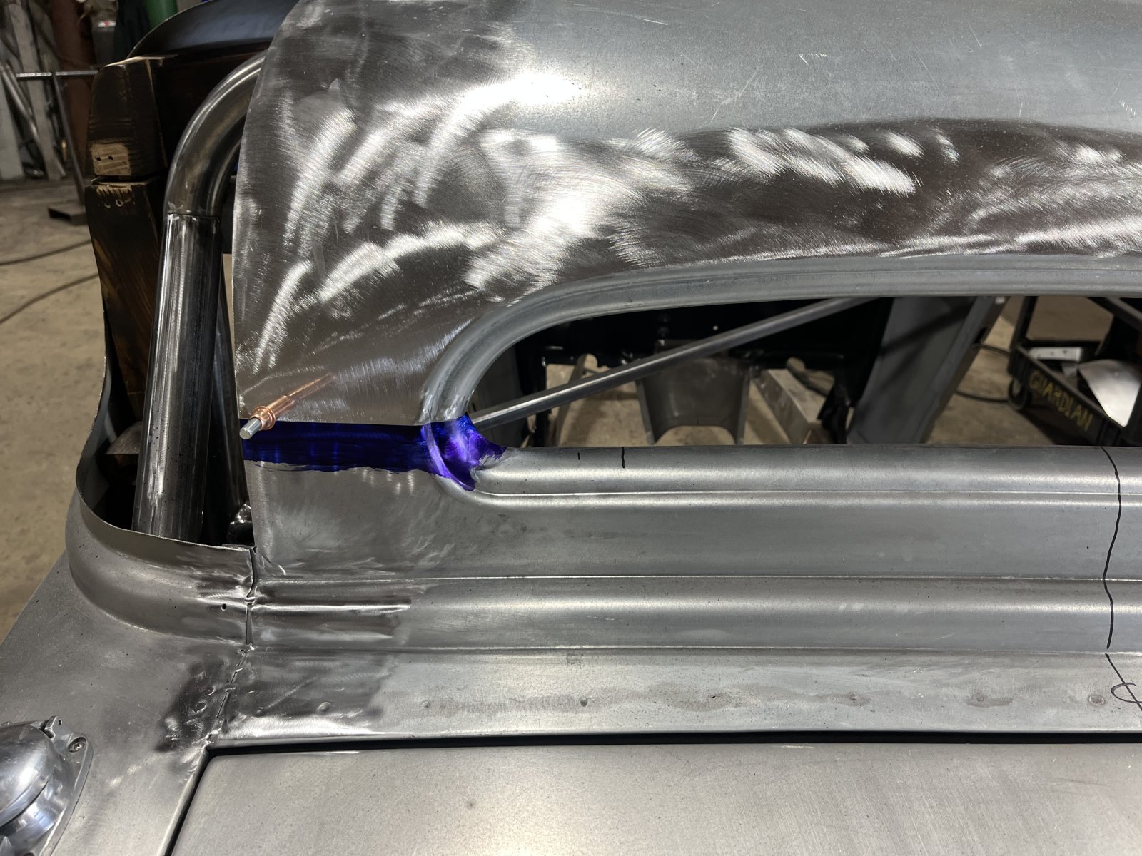

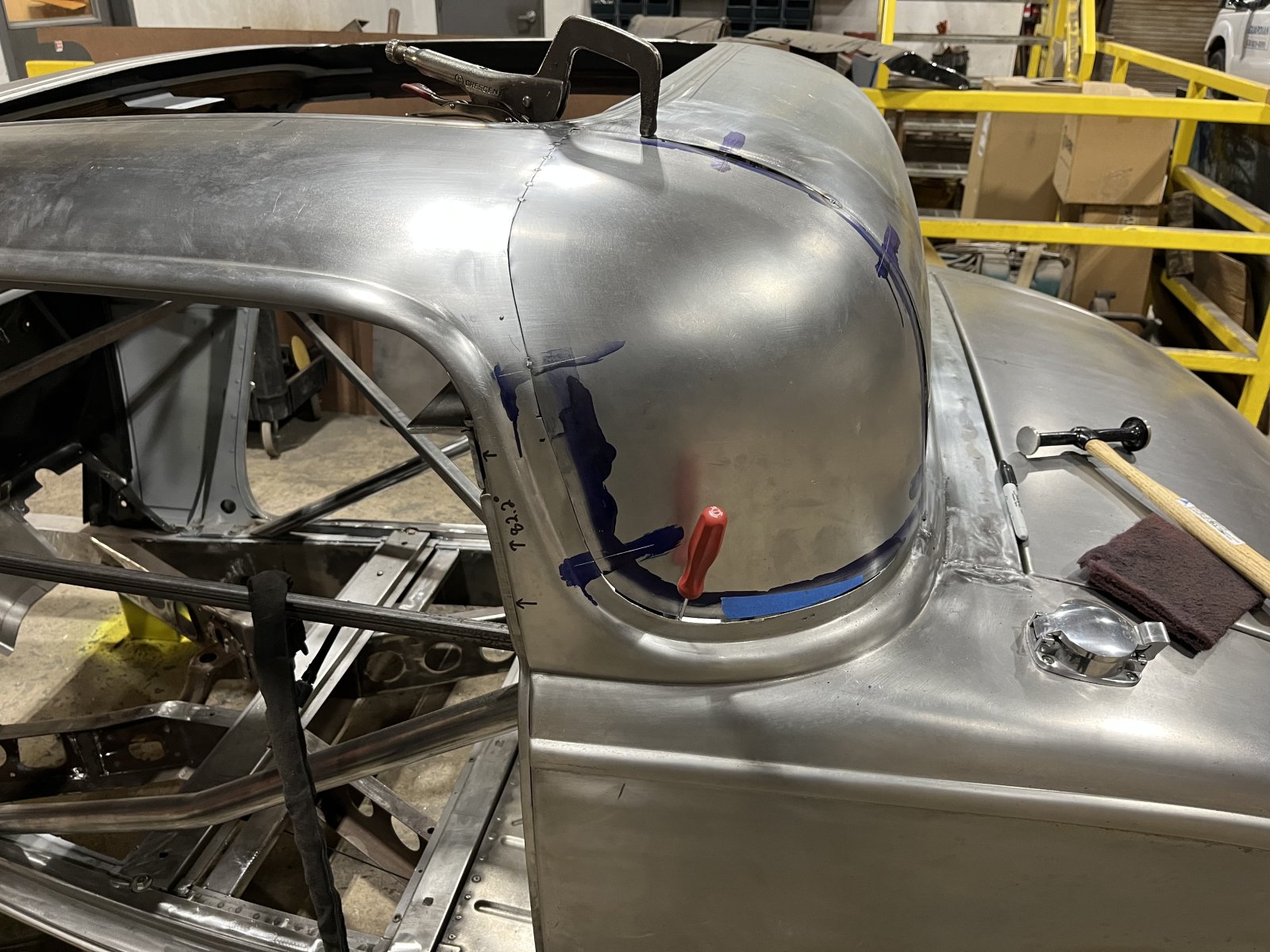

    89DA4B42-D4EE-4162-A7A7-6614917C7B57.jpeg 8C3D80D2-52BA-49B3-AB28-2007870588B1.jpeg C5BE610E-E459-4422-B0F1-BA8F468358E4.jpeg Test fitting the corner back in. I moved it around until it flowed with the top just right. I’m happy with it. I will scribe two edges now. Trim that and put it back in flush to scribe the last edge.

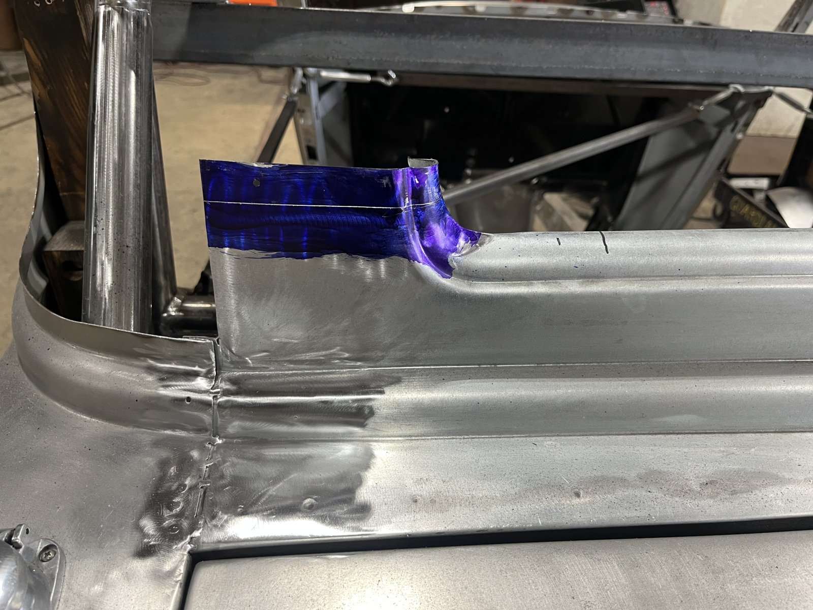

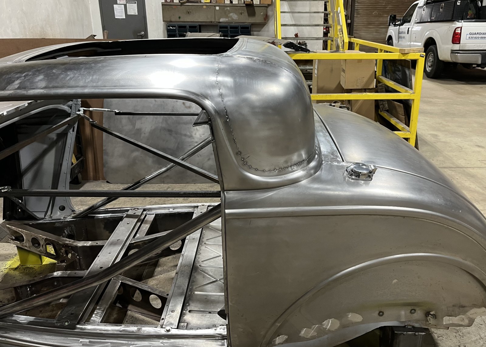

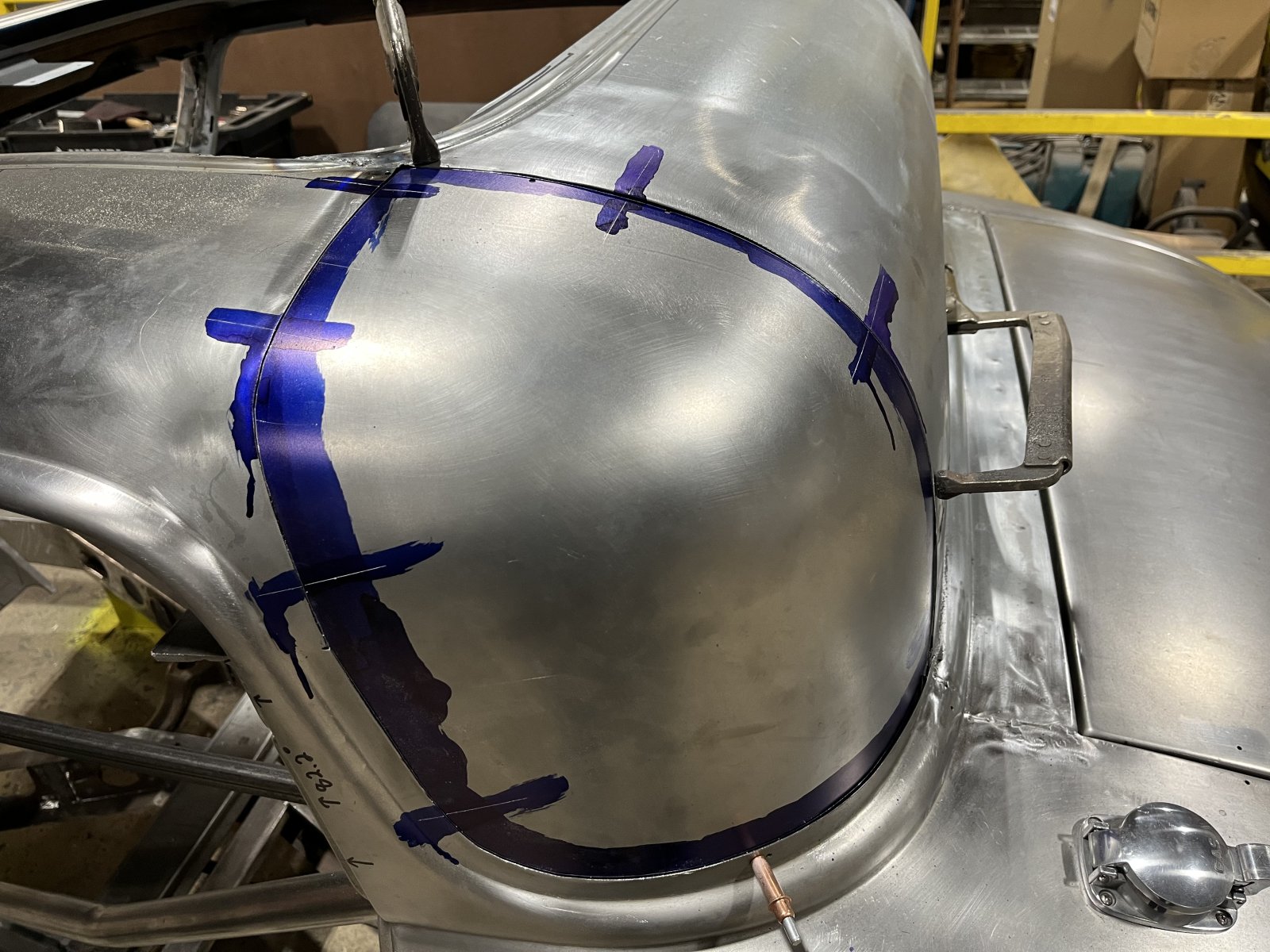

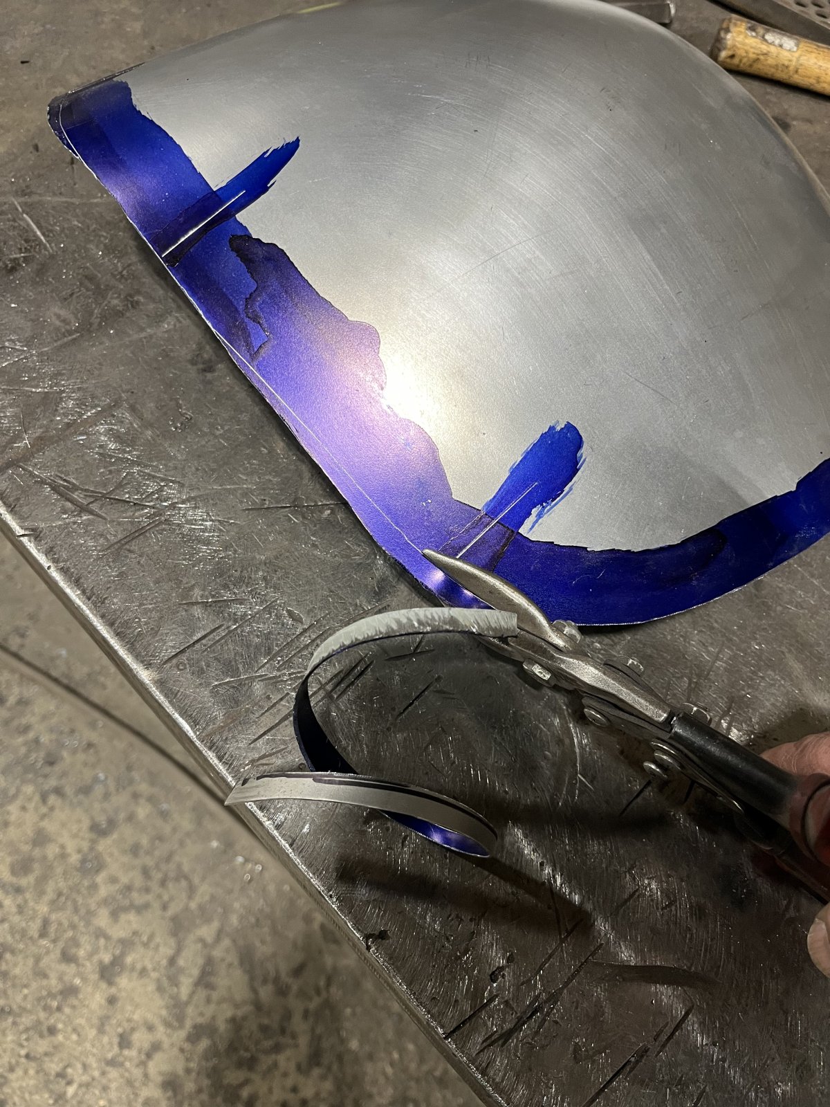

    785C5ED8-D035-4770-BFBA-A3A3D88EF6E6.jpeg 27CF6EBF-7C94-431B-8EF0-DD23BC95B581.jpeg 093AD0DD-DF19-42AE-A786-1D1D5648DF3B.jpeg E16F0B09-F31B-45C4-804B-F302C64CCE34.jpeg 89023939-7ACF-4B48-9E92-84F6F25165DC.jpeg 41B8FF4A-D745-4586-8708-AF161A384185.jpeg I scribed a couple alignment marks then removed the corner. Trimmed it with snips and put it back in.

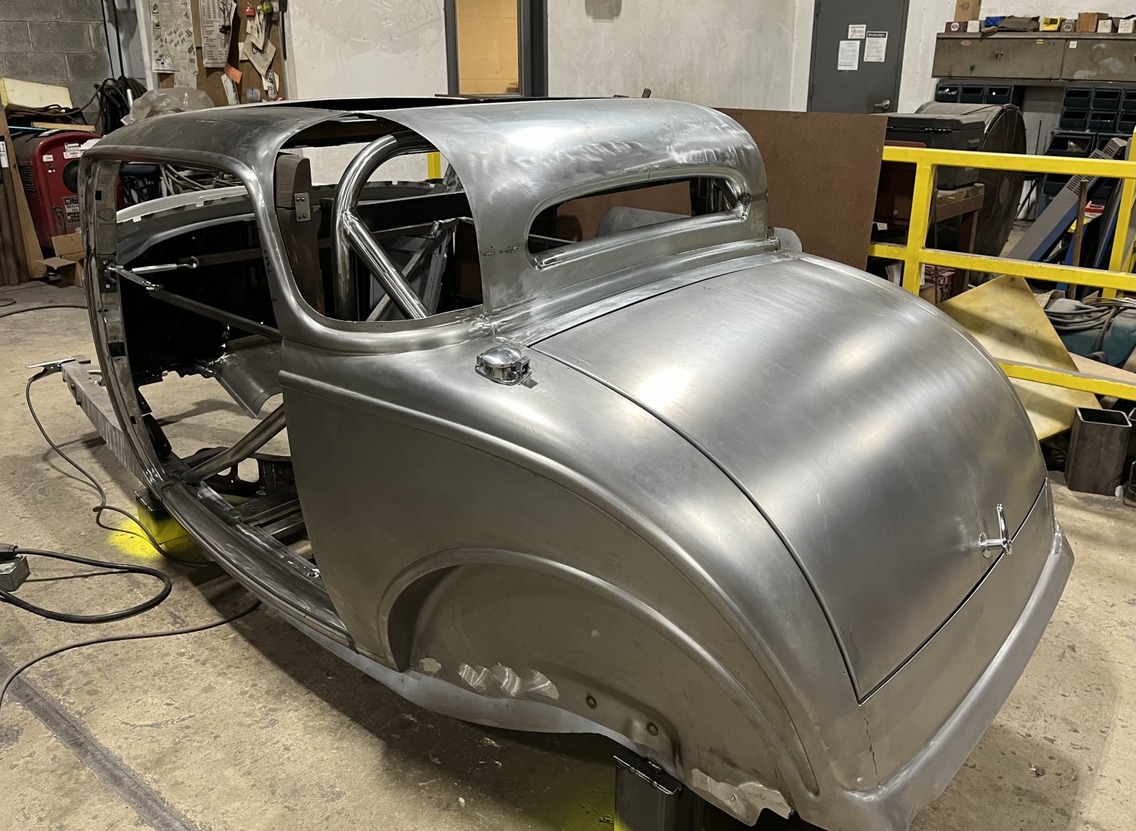

    C67C52F7-B353-42AF-BBA9-08E57372AF3A.jpeg And with the roof panel sitting on. Next will be the other corner and the roof.

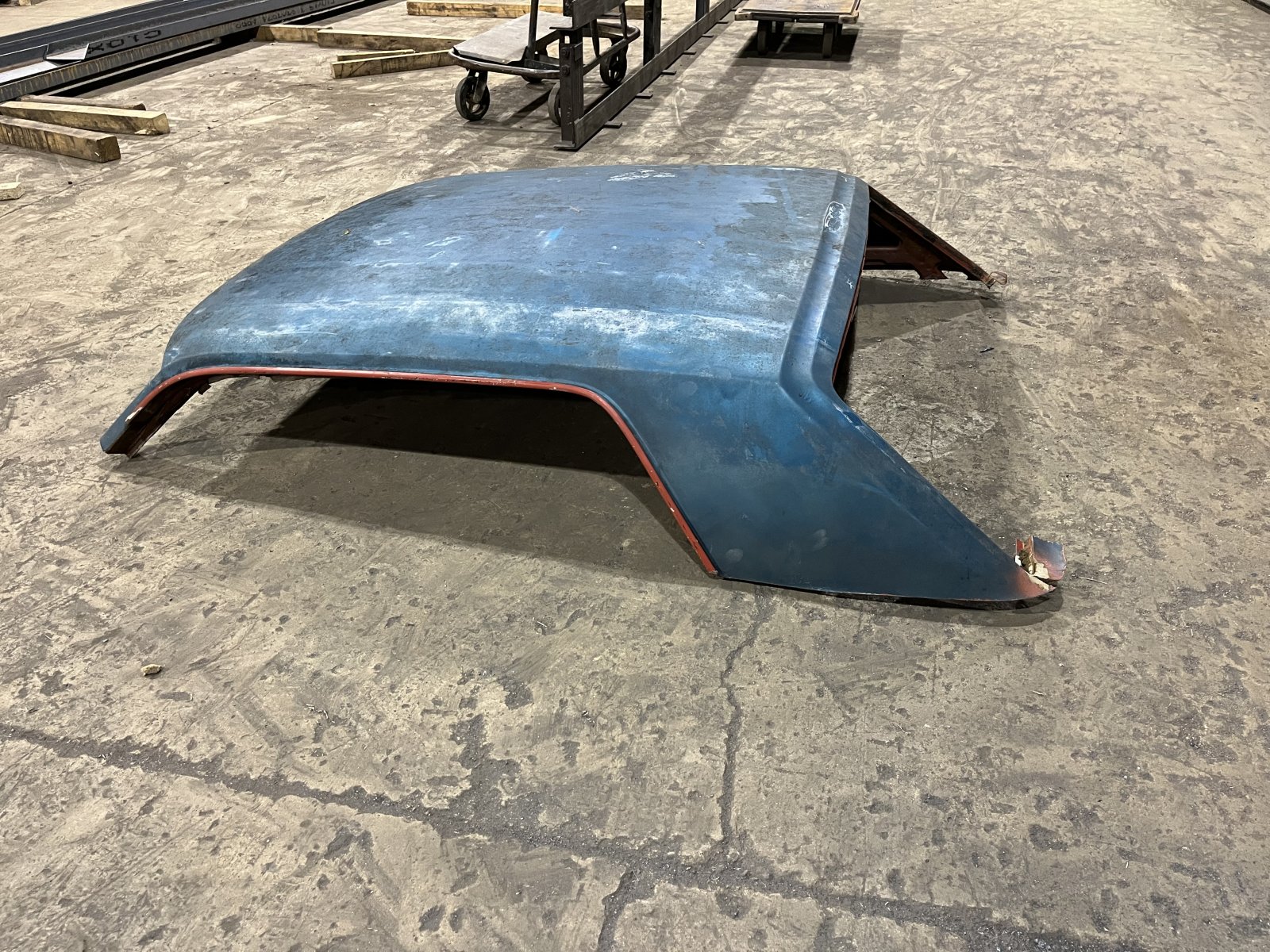

    I don’t like the soft insert. They flap in the wind. I thought about using the metal insert and gluing the vinyl to the metal. But I still don’t like the look with the aluminum nail strip. That makes the soft top look like a mattress on the roof.
    I’m not welding the steel insert in. It will bolt on the top rolling bones style. I just don’t know if I’m going to flange the roof to make the insert flush or just lay it on top.
    But I’m still thinking about wrapping the insert in Mercedes material to keep the look of an original car, but without the tack strip.

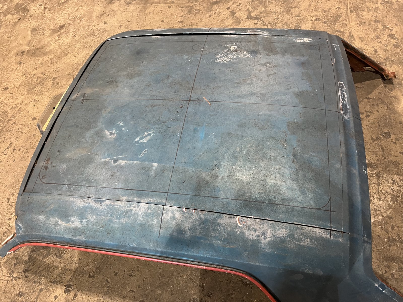

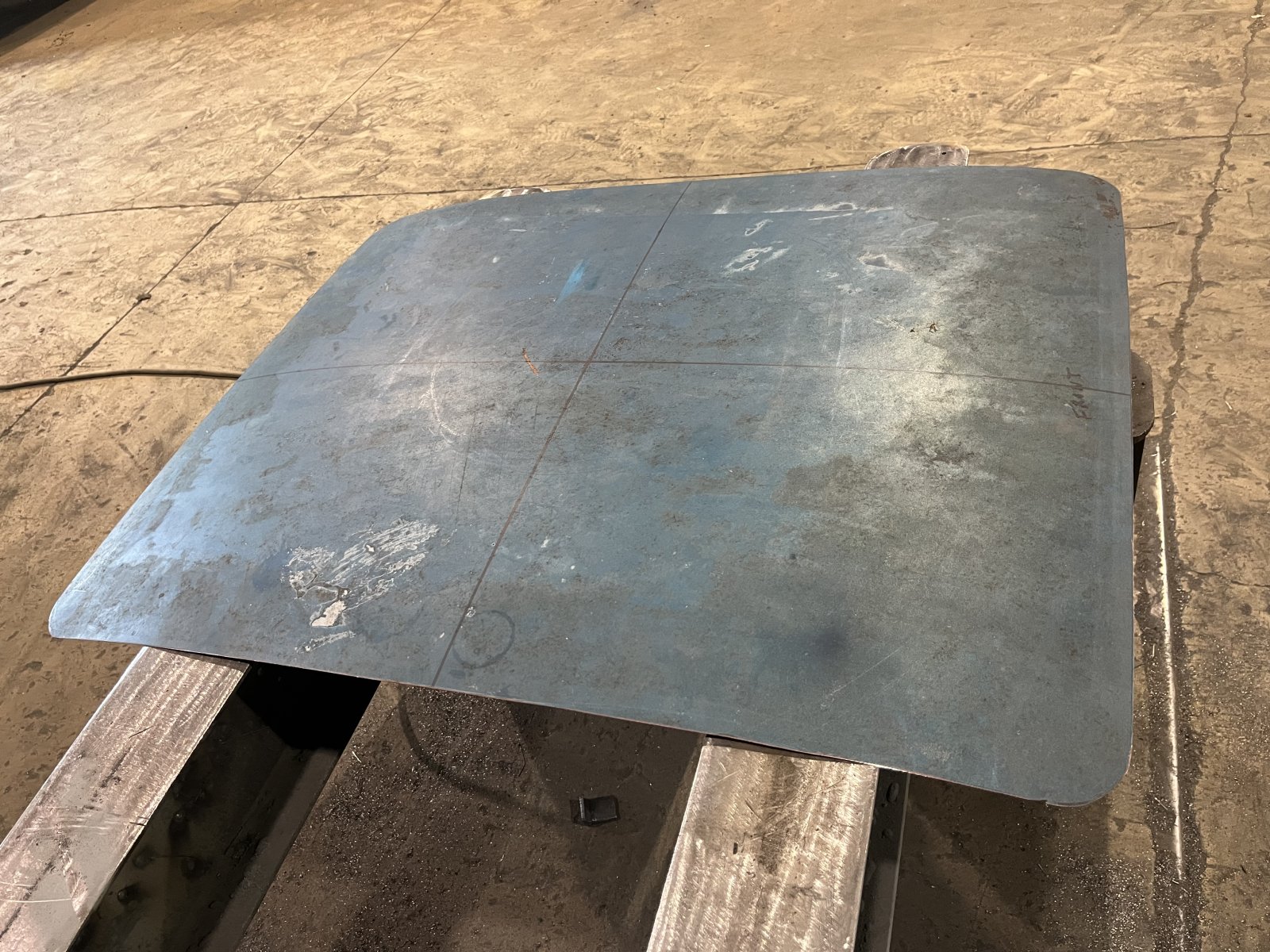

    4A341417-518E-4160-A075-D58185EEAF25.jpeg A2BC3503-902C-4B31-919D-F51E1AD4C2A7.jpeg 99523DB5-6DD3-4826-B109-EEA3621ECB4B.jpeg CA8FD3D6-8C12-419E-9A47-EB2ABDBCEB15.jpeg 15B58045-9B40-41C0-8B0D-9B8EFED90A47.jpeg I cheaped out and used a “Henry Ford Steel” roof insert.

    Looks like that one rotted up to the windows, thought to restore it. o_O

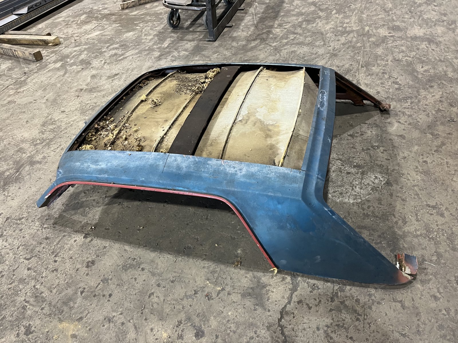

    The guy I got the mustang roof from wasn’t too happy when he asked what I was going to do with it. He said “I was hoping you were a mustang guy.”

    Rustang ....interested to see how you pull off the bolt on top....
