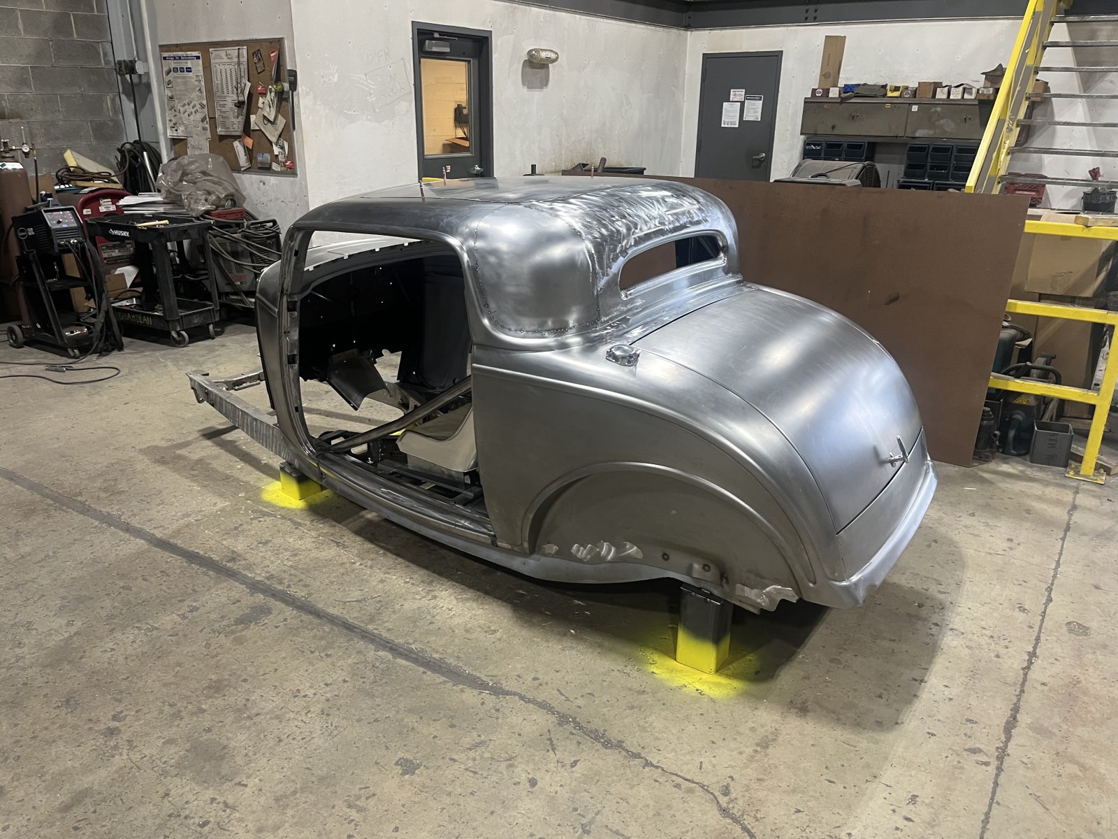

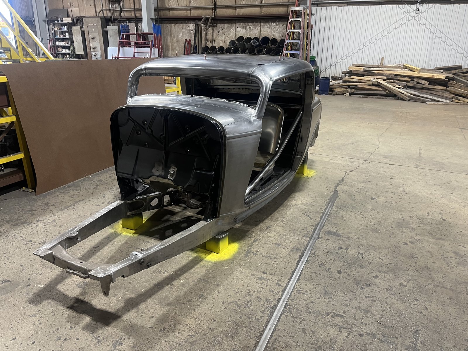

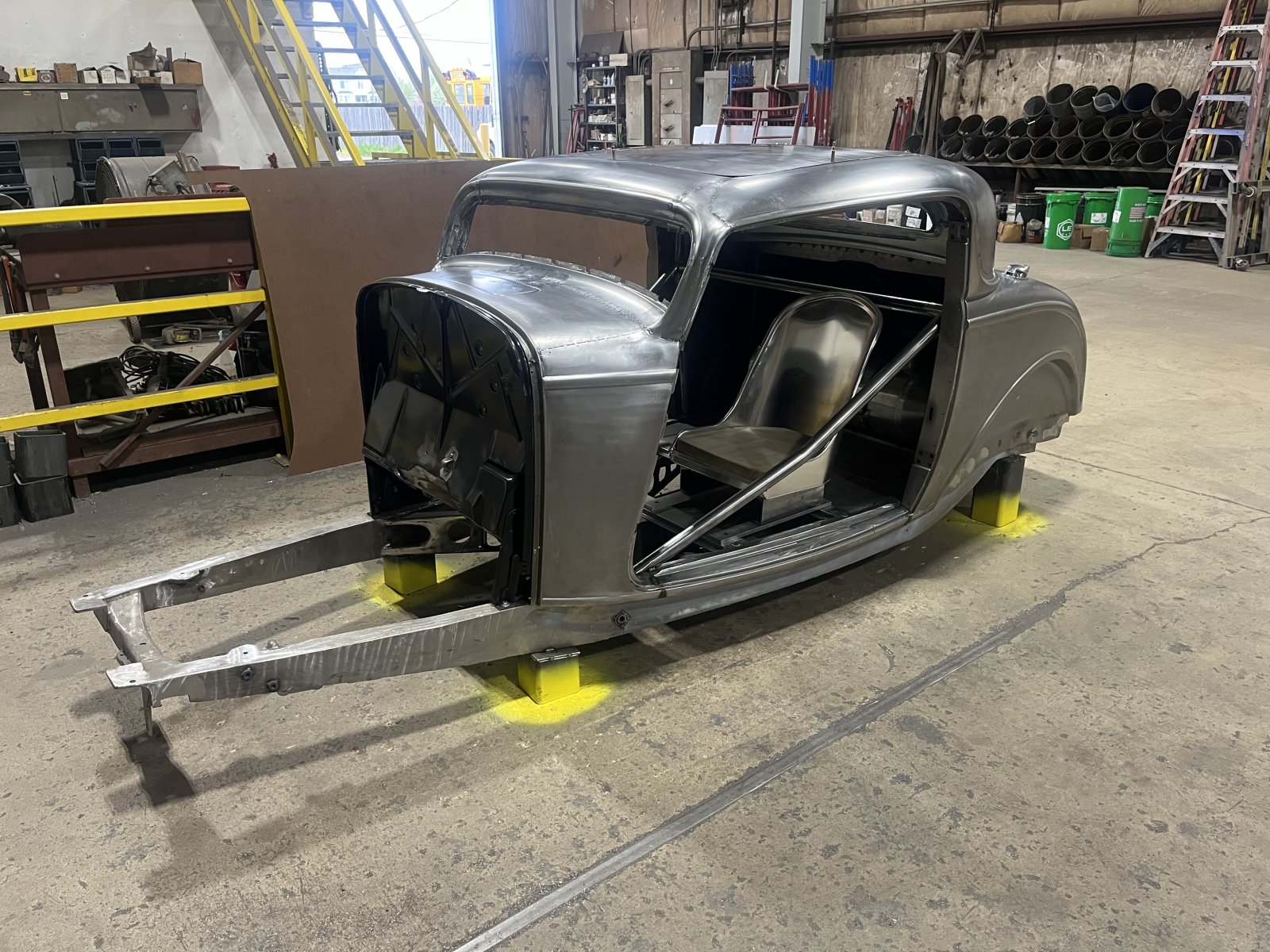

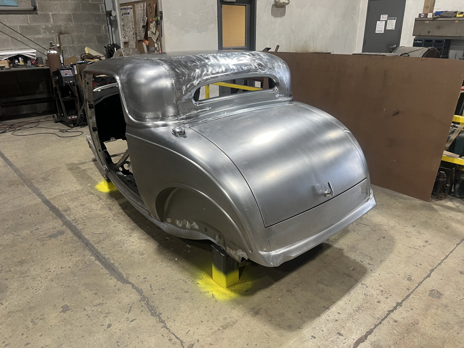

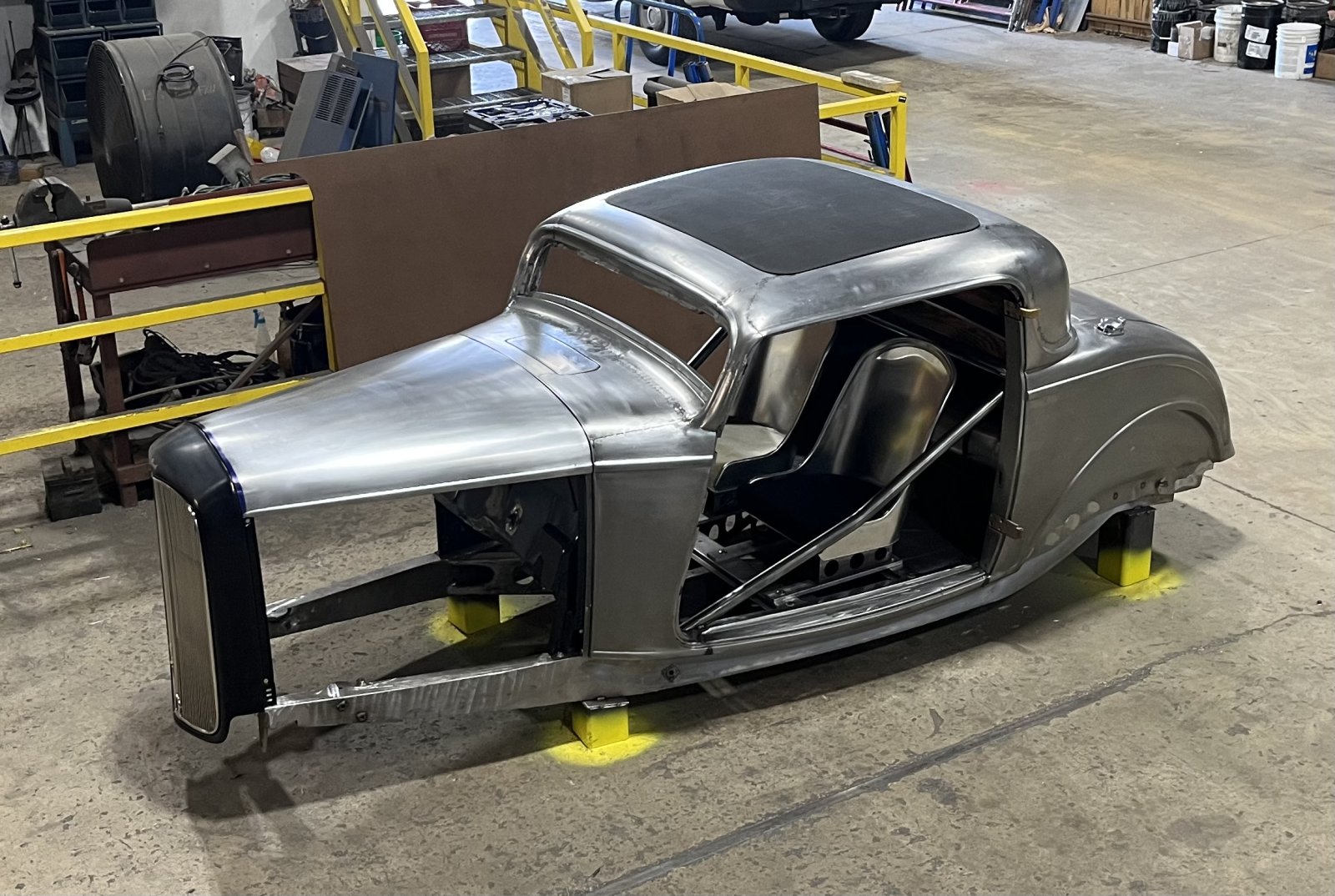

    326A7A10-A8BC-4735-93A3-2B0A149DC232.jpeg 33DAF3D9-7B48-4102-A2AE-FD29BFF3933F.jpeg 6C73D6DE-C5AB-4D84-B837-BD22A631C18E.jpeg 2A10016E-61B6-490E-823E-20636072CD33.jpeg 66384A76-E0D0-4714-9946-AB97ECFA58F4.jpeg CF9C87A6-2C45-4EDA-BC21-C5669AAA93A8.jpeg 43DFD6D4-66C1-419E-AD01-770CD2EDC4B8.jpeg B1ABBE3A-2E6A-44EF-884B-7BFE4D58AAED.jpeg The roof is back together. Just fine t******* the roof insert.

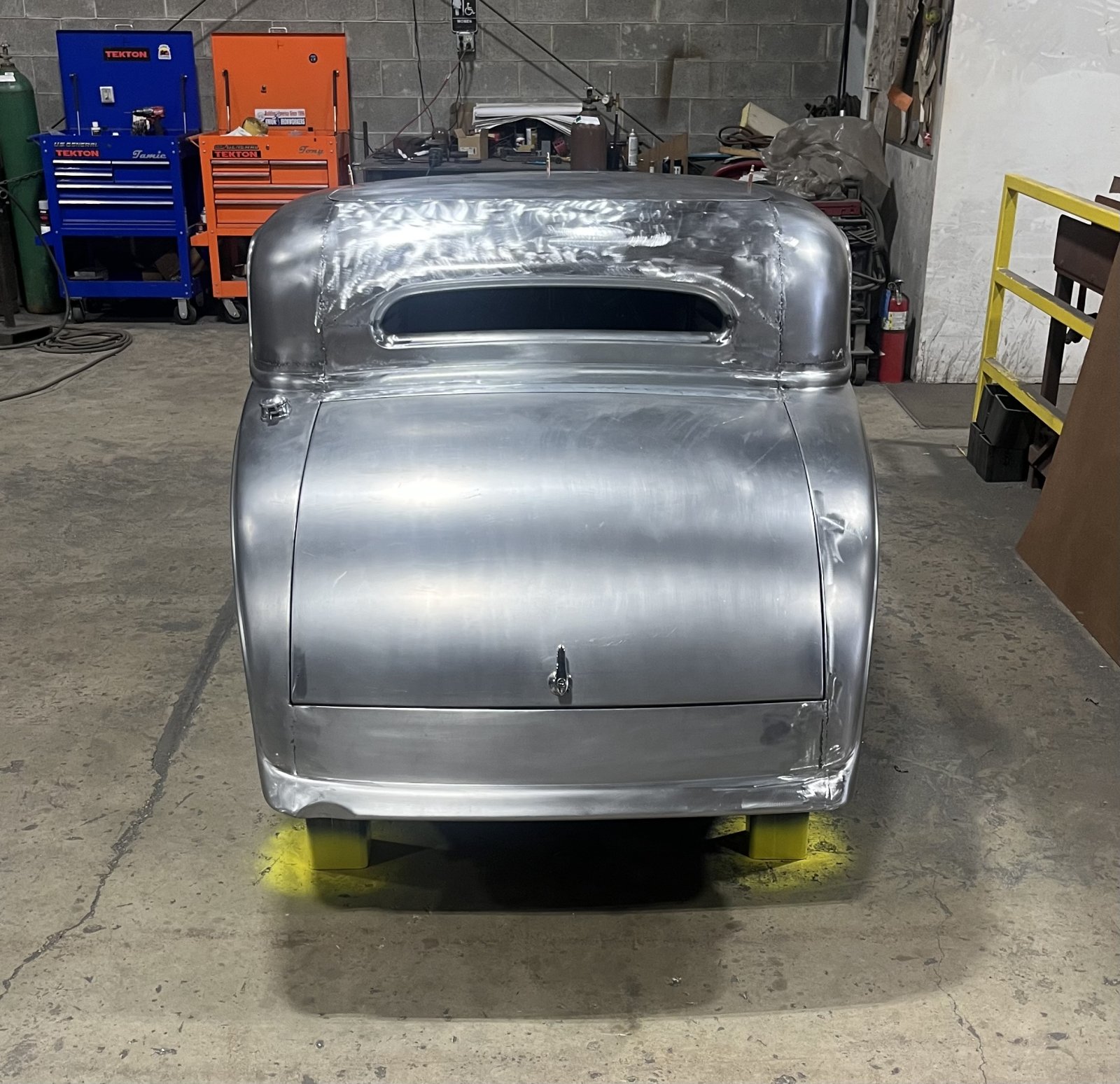

    Amazing metal work. What are you doing with the fuel filler dimple in the rear panel?

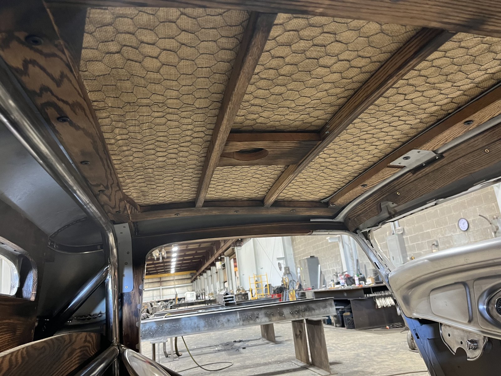

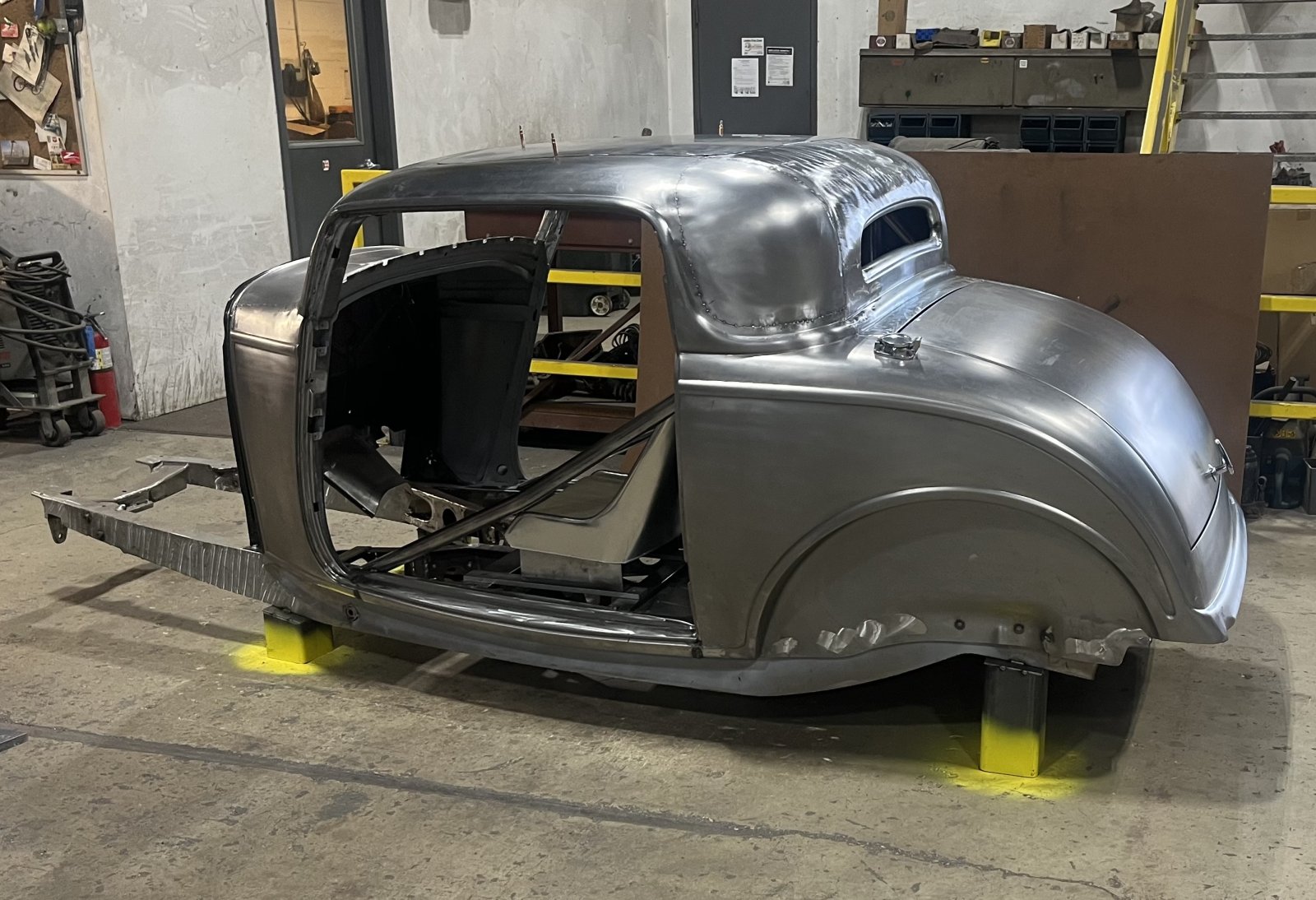

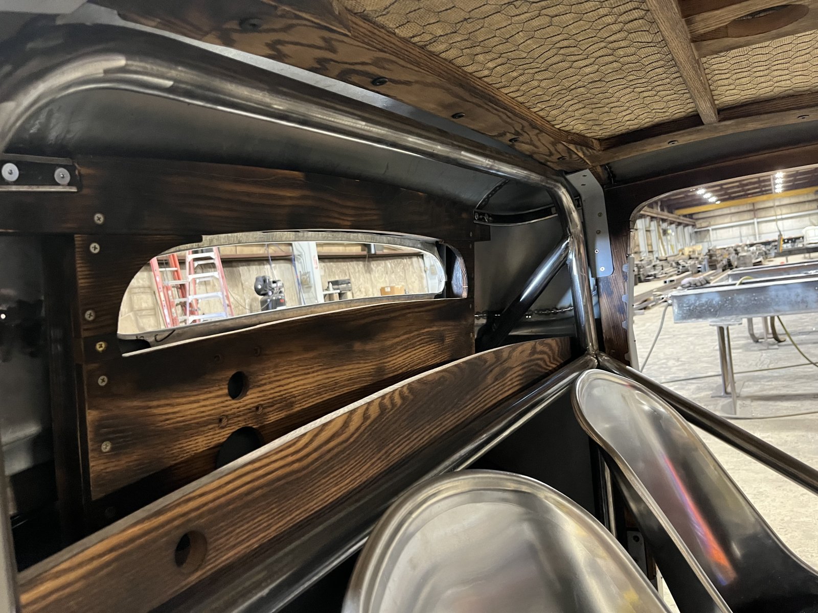

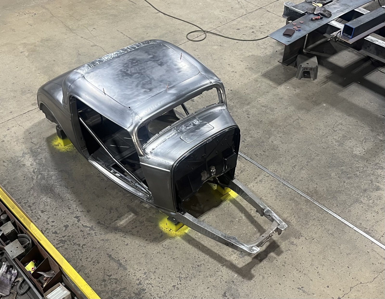

    F7F490AD-8BD7-4621-B2D7-84CC3CA188FF.jpeg 105CC4CF-D0AF-4A8B-B5EA-1B19A44415C9.jpeg ADC20723-1A34-477B-AEBD-811F68B1543A.jpeg I’m leaving it alone. Certain things like that area filled in and the roof filled in make me think plastic.
    I’m going for a late 40’s build.

    I like the fact that you stained the woodwork, guess there won't be any extra upholstery going in there. Bob

    I burned the wood to get the weathered look. Too hard to stain it with the sealer Brookville uses to preserve it.
    no interior
    Motorwrxs, Outback and The37Kid like this.

    The chicken wire and padding is another nice detail with the filled roof. Sound and heat proofing to some degree. I would think
