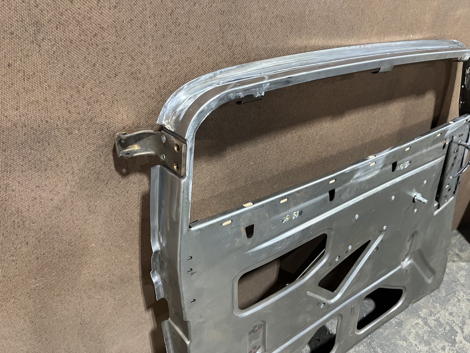

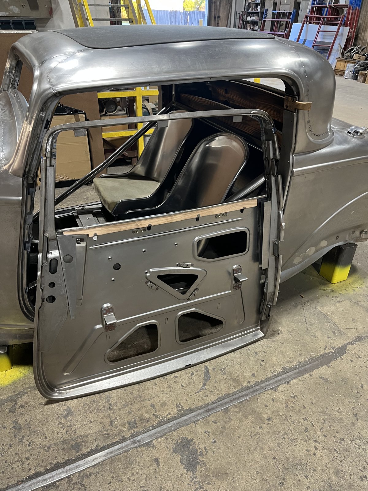

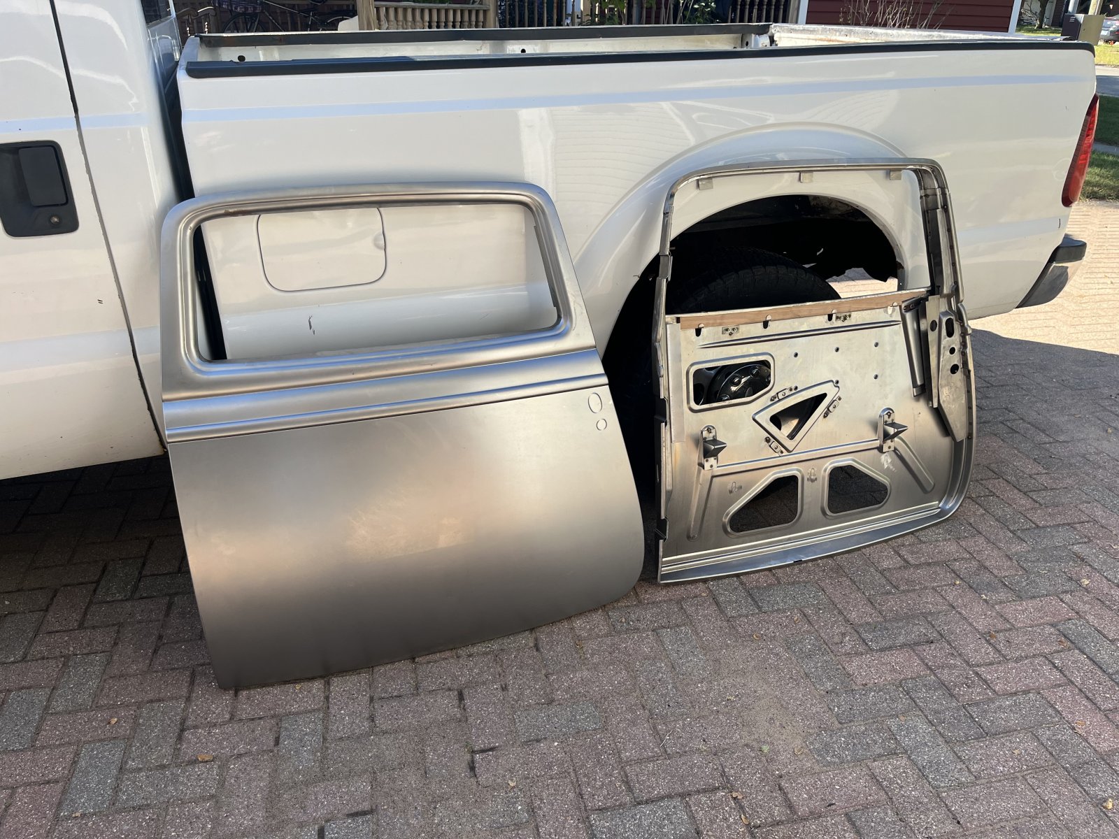

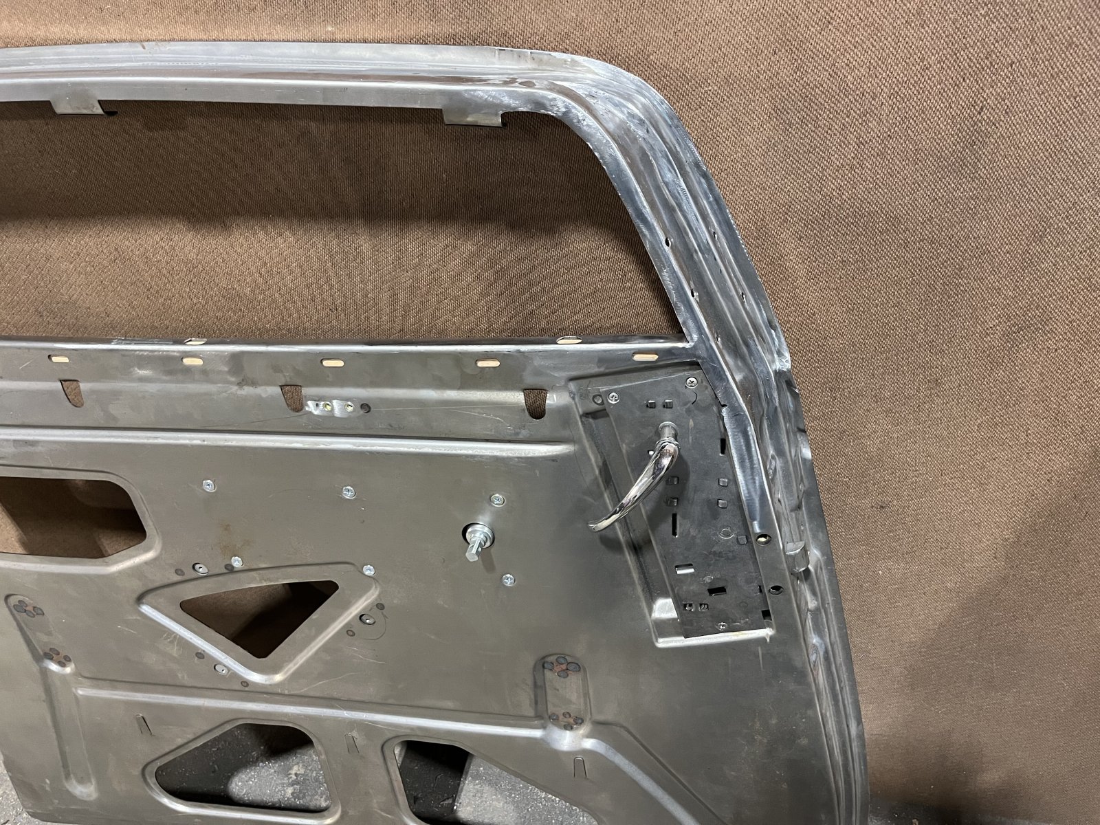

    1494F554-50F5-4612-99F7-EBCC135D1215.jpeg I picked up my un***embled doors. Kenny has all his stamping issues solved and these doors are available now.

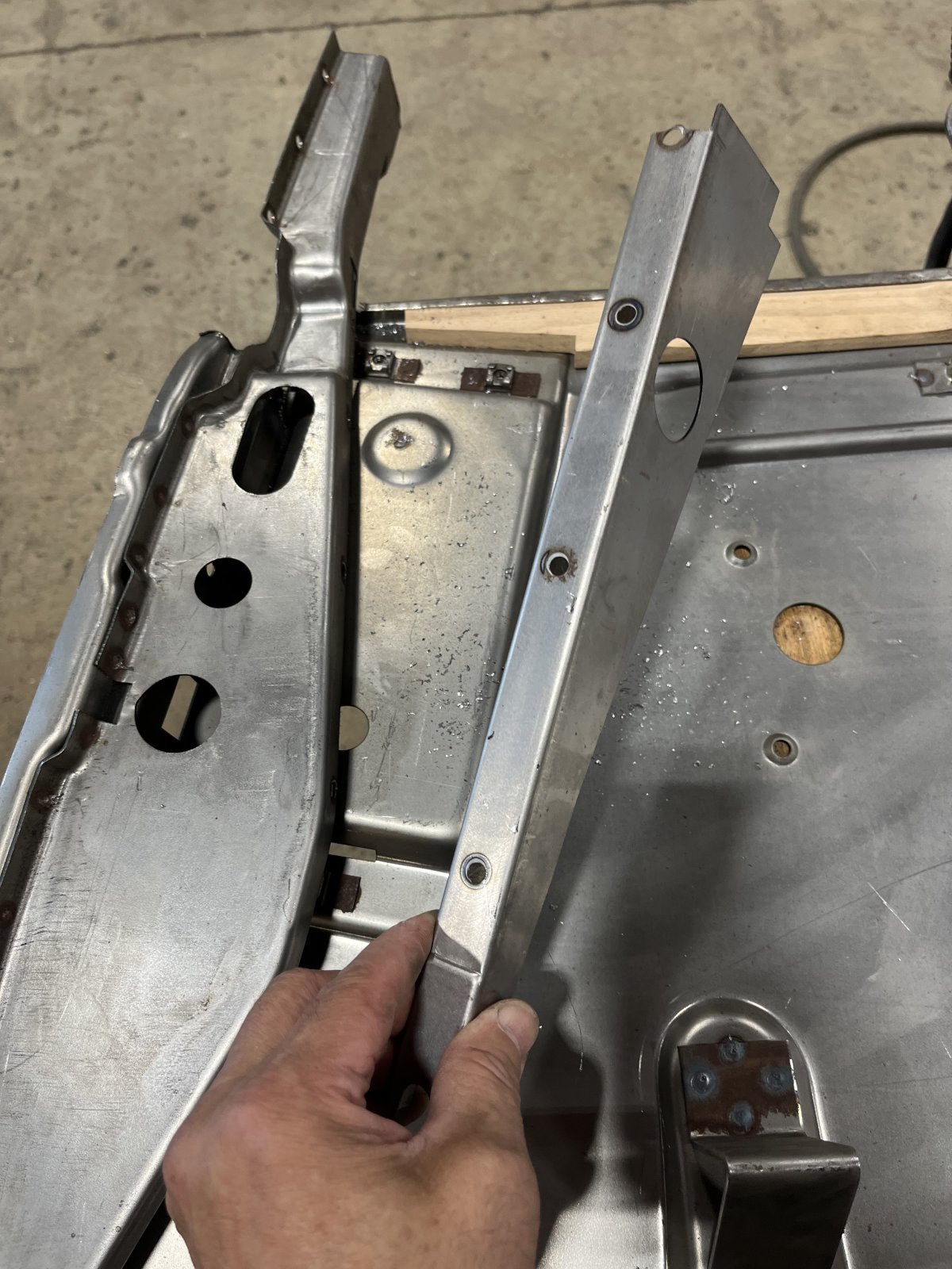

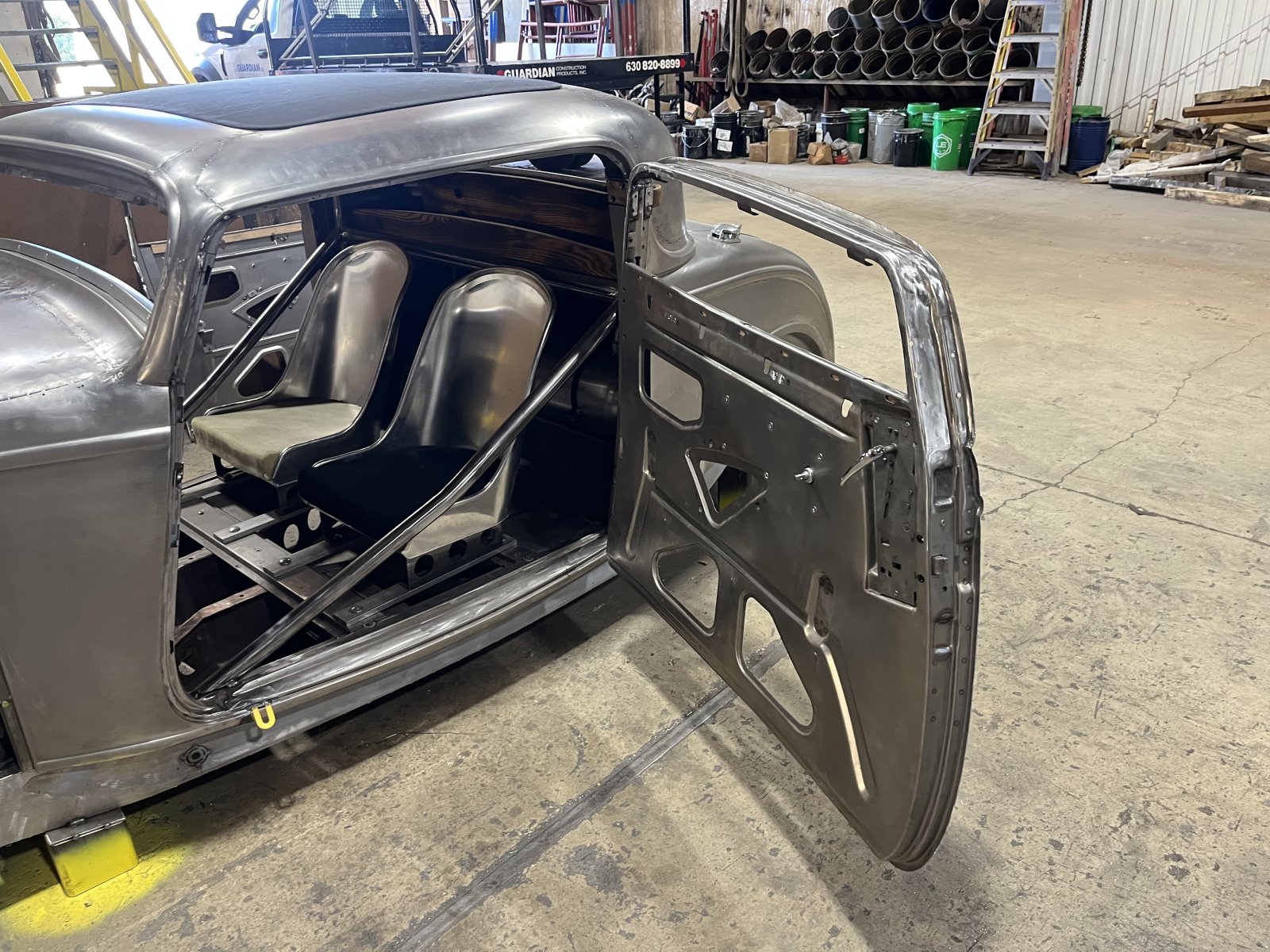

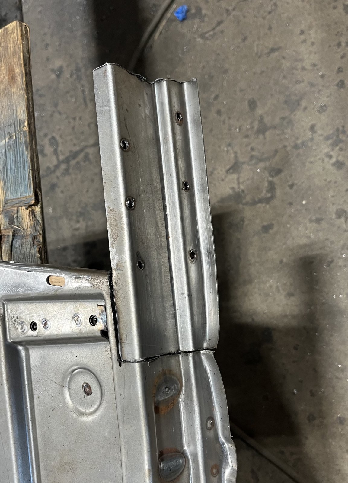

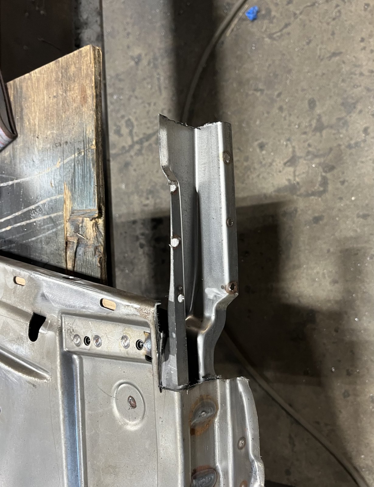

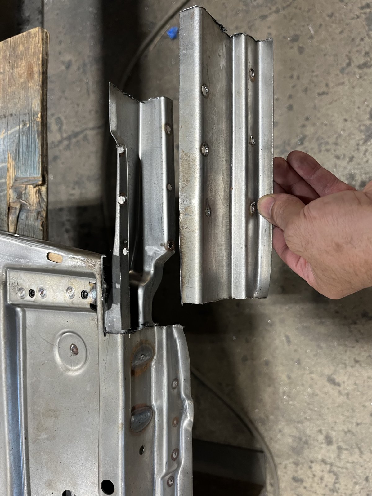

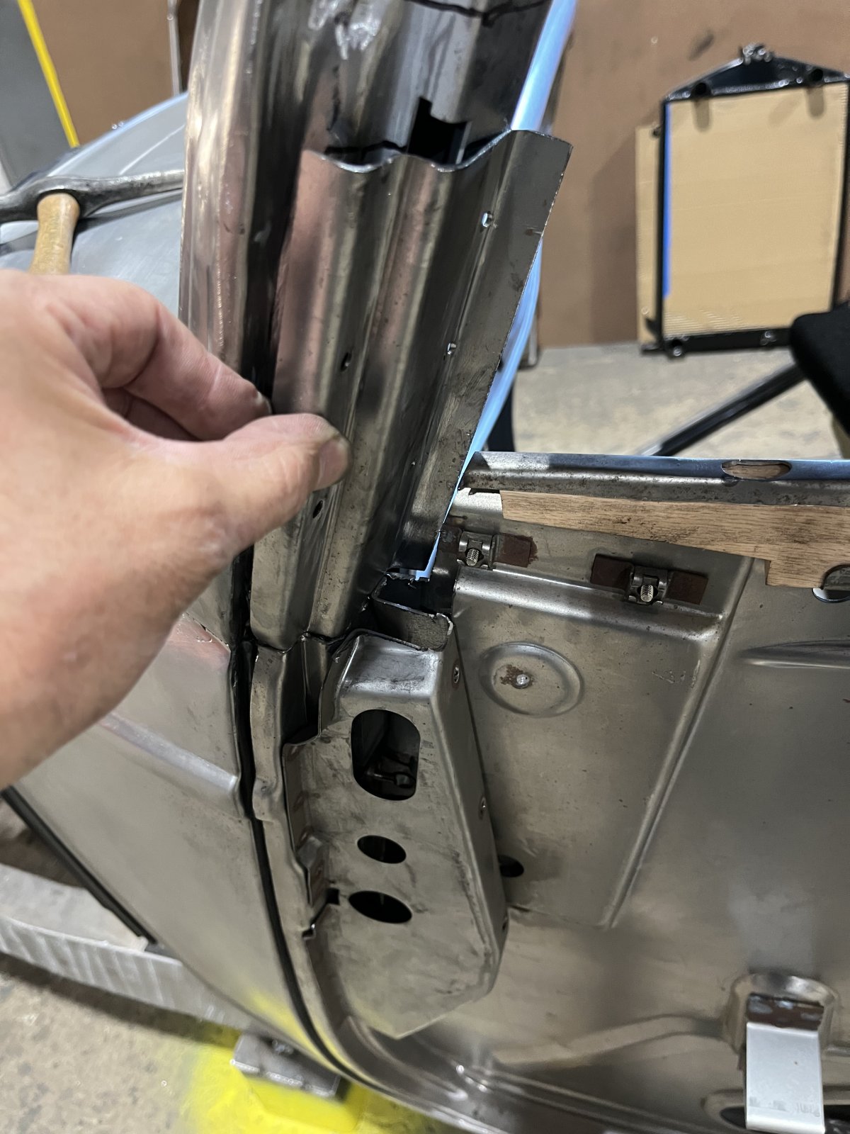

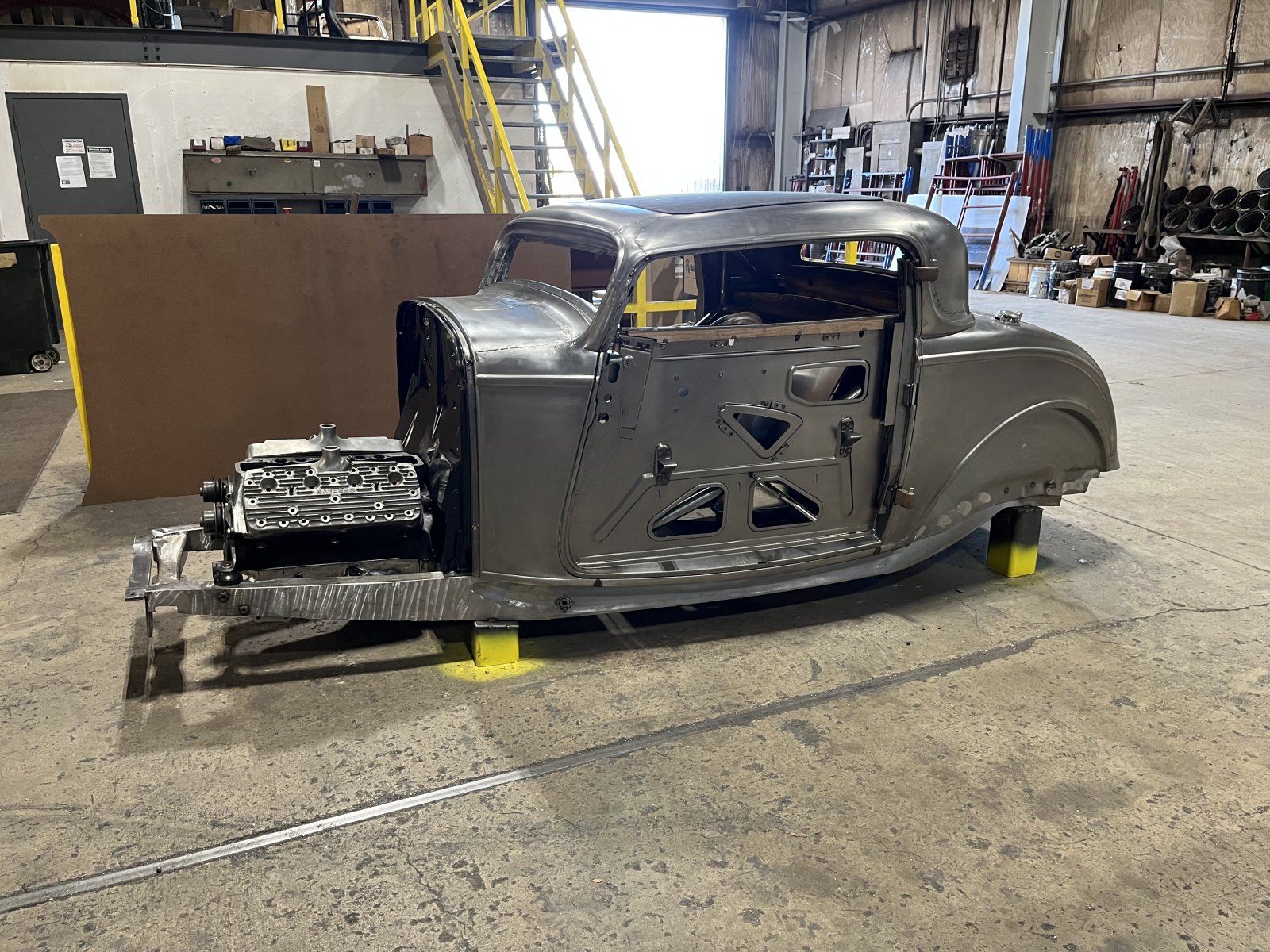

    T******* the left inner door to fit the body. C2685D01-D39D-4E58-8F30-B8F7E7DA9563.jpeg AD320A2A-ADB2-4BA0-91E6-56BB2AE96FC2.jpeg 92E8E79F-857A-4D4D-B0CE-4DBD992B24BA.jpeg FB515A1F-49CD-46F7-8253-0B1054B19F83.jpeg A817E3D3-FA04-4EC1-AECE-51E4812095AB.jpeg 158780B0-F201-4652-AEC9-56B759AAE960.jpeg FAD0440C-DB32-477C-A7B0-9260A3FDB358.jpeg 52937560-06D2-495E-ADBB-86A1CD37FEB6.jpeg B55F19D2-CD65-4FE9-B32F-13E3B7CCC90B.jpeg

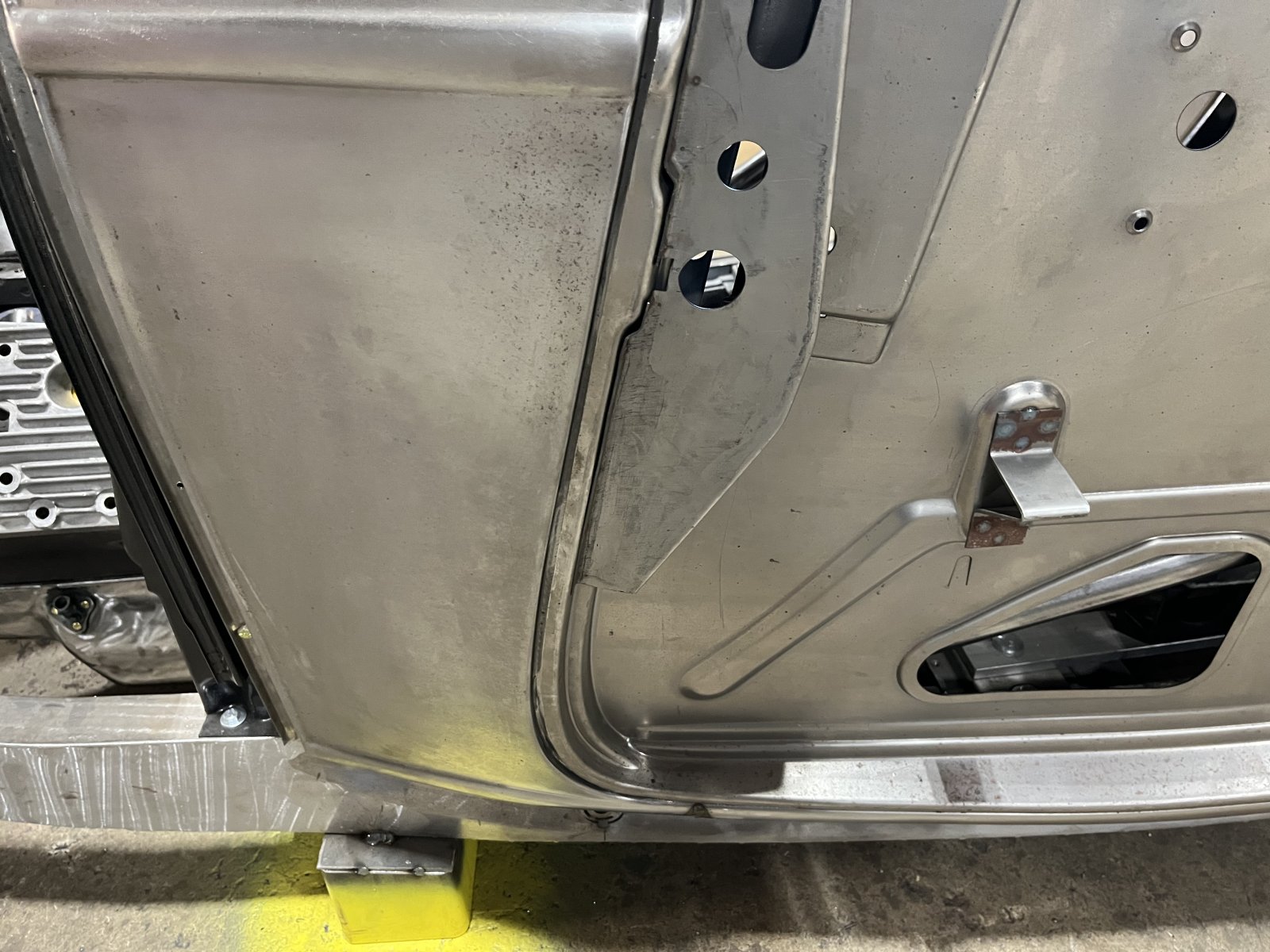

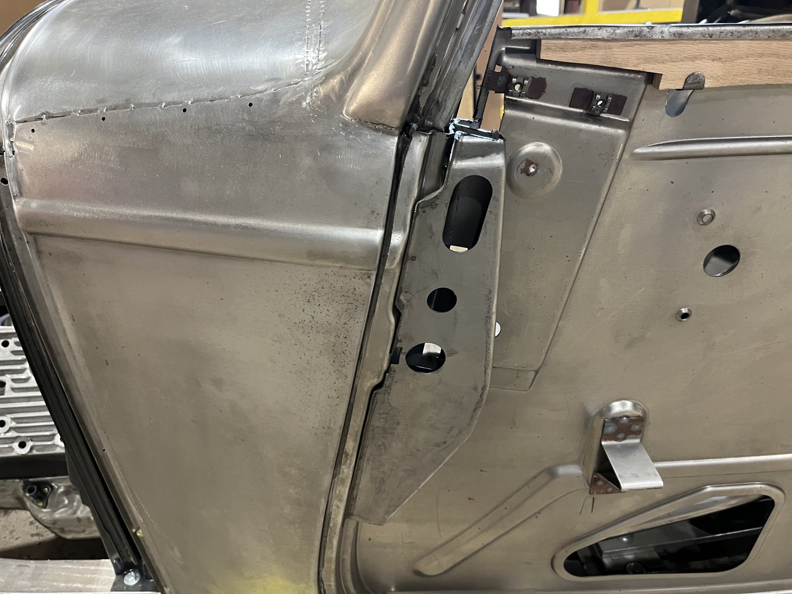

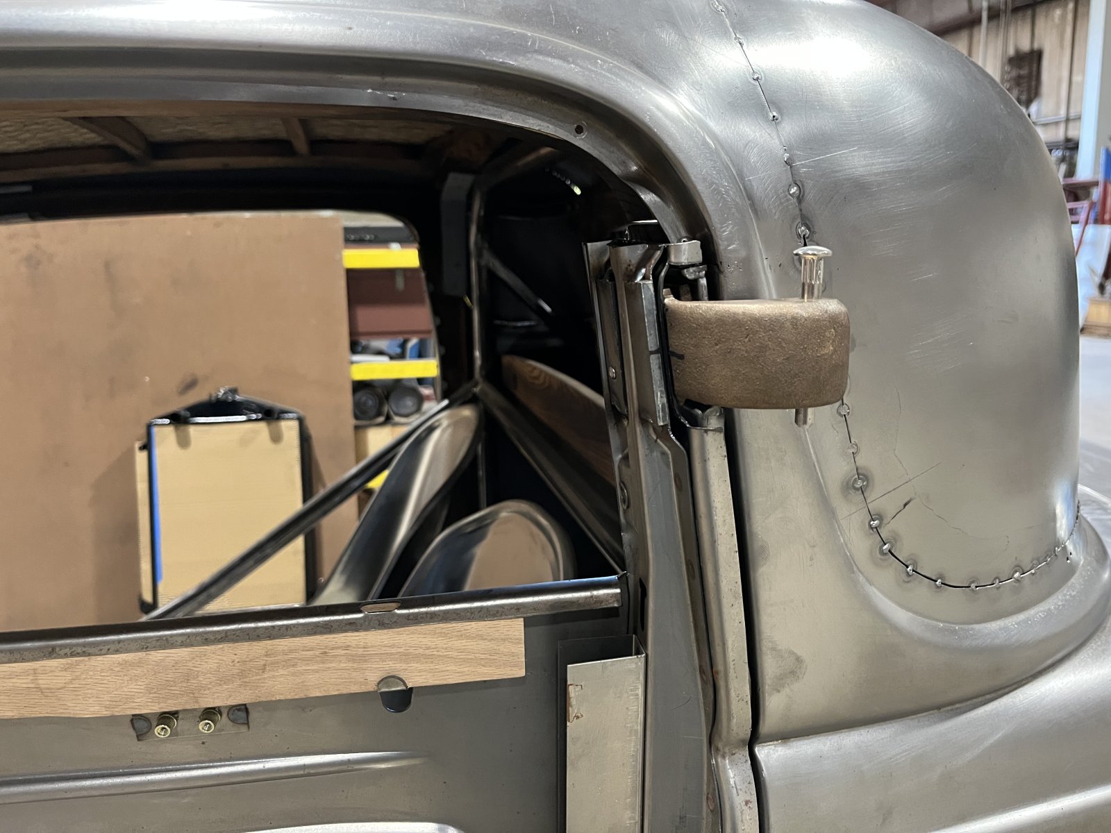

    Getting the hinges aligned and fitted to the inner door A645AA81-E5DA-4A56-8CD2-3E69D9EF8BED.jpeg FC931AA2-E5EA-451C-8BCB-93C9B9A982FF.jpeg EC78BBCF-DB83-4928-938D-E252F7A03548.jpeg 350CDB5D-84BF-4AB1-ADC5-C89AC97EC702.jpeg E1B681E1-DB63-4718-B273-8DC61588564A.jpeg 16826228-D138-4AC5-8501-9B05B6E8A949.jpeg 950D7048-A7A0-48A3-9B0A-C6AC3AE39C8C.jpeg

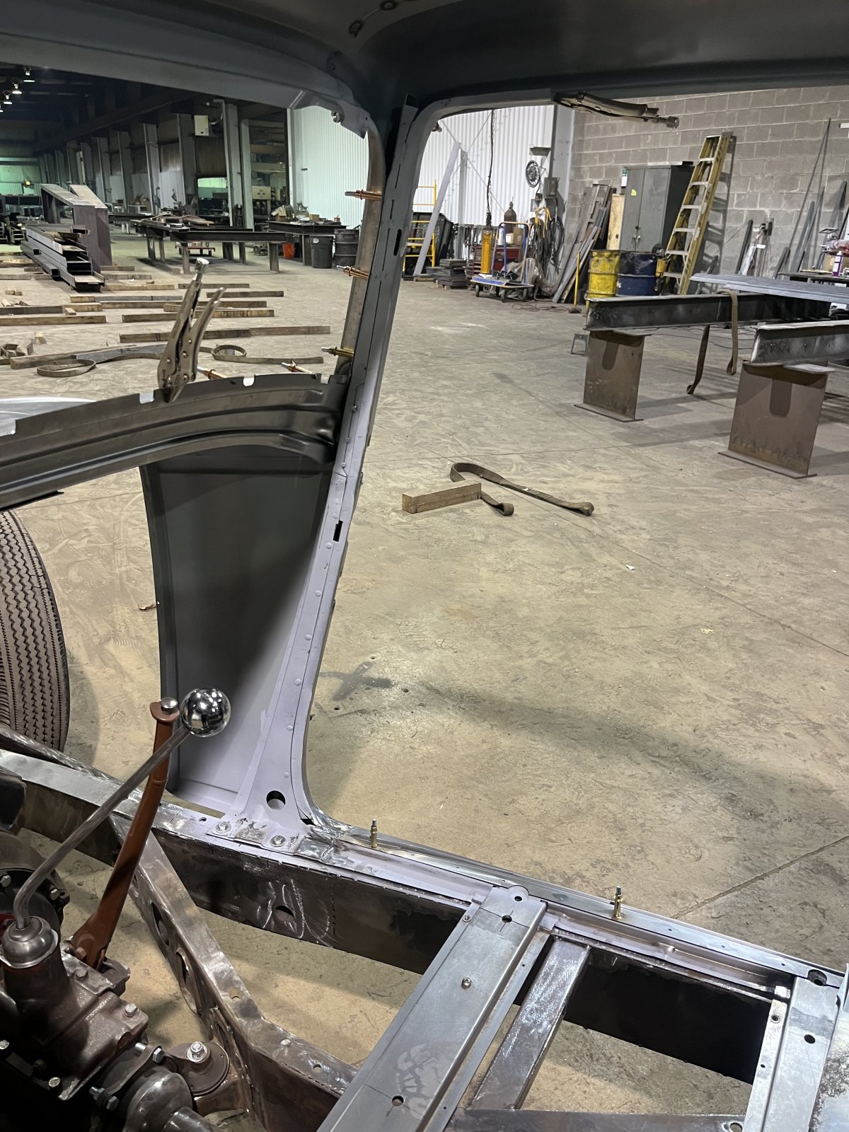

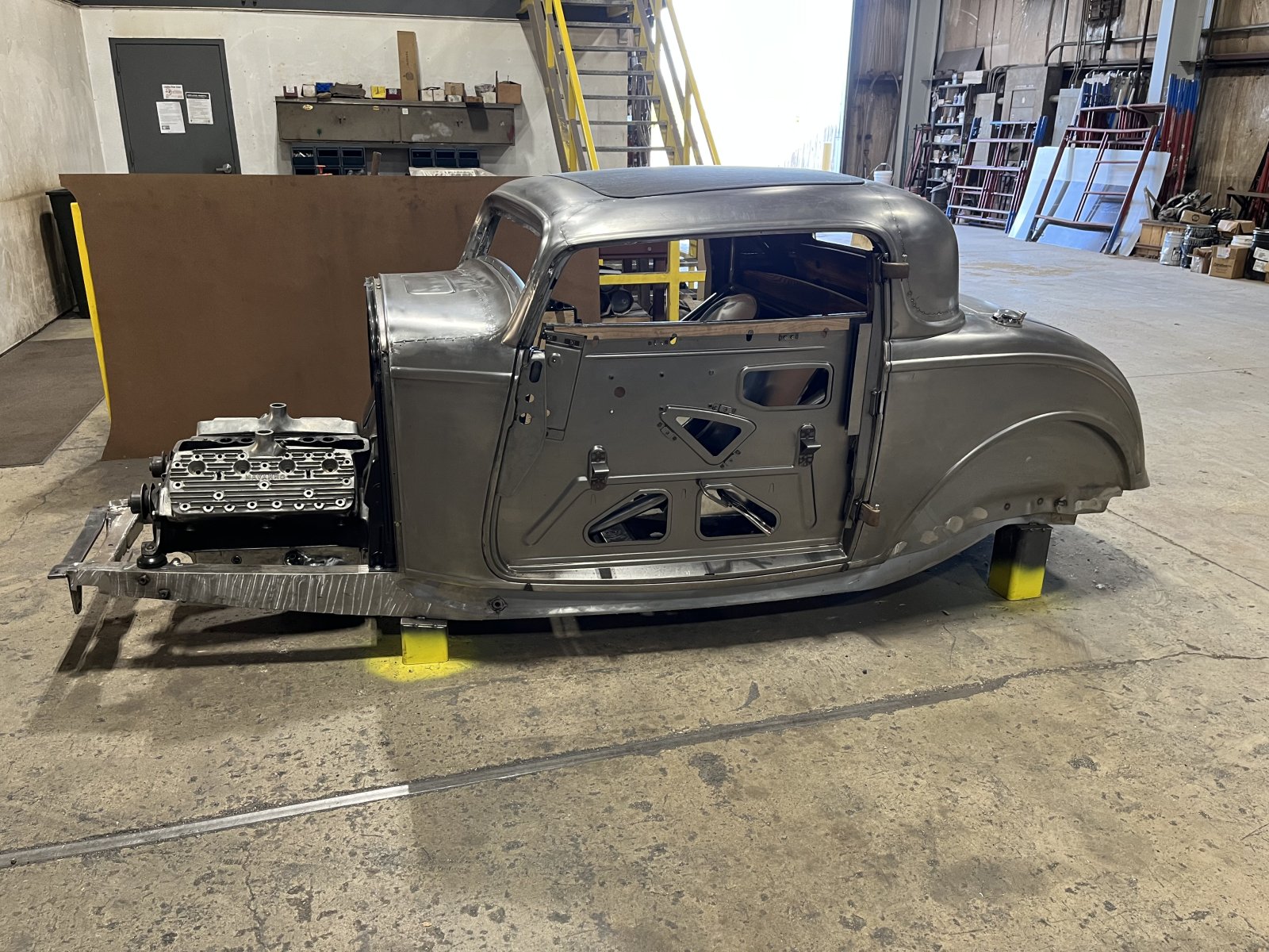

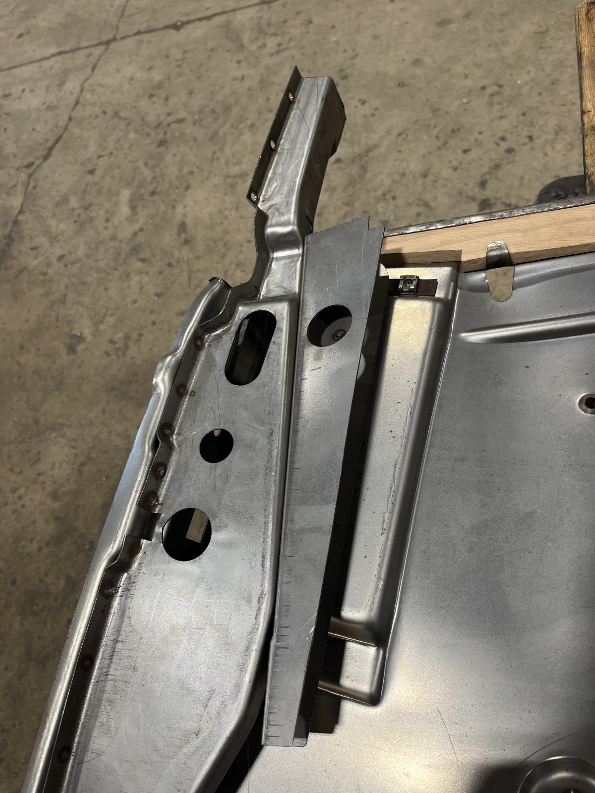

    3C85C3B8-6F74-4A74-AF23-563BE9386A80.jpeg 15572394-46DD-4A37-B632-E4C84E3E1502.jpeg 1D3B092E-B994-4422-940B-38690A2DD2A8.jpeg 61B275EA-B83C-46C5-A610-184670CFEDCC.jpeg Putting the door top back together with the laid back a-pillar. Next is weld this part up , then add the reinforcement structure at the a-pillar. The final piece will be putting the side gl*** track guide in.

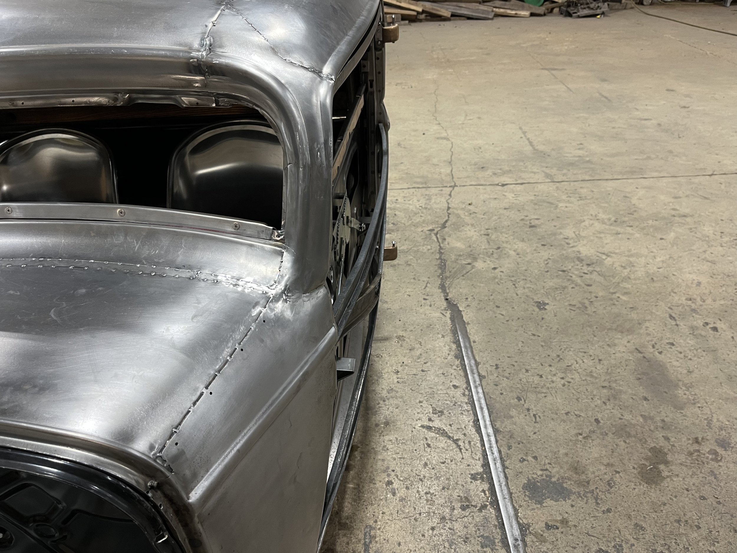

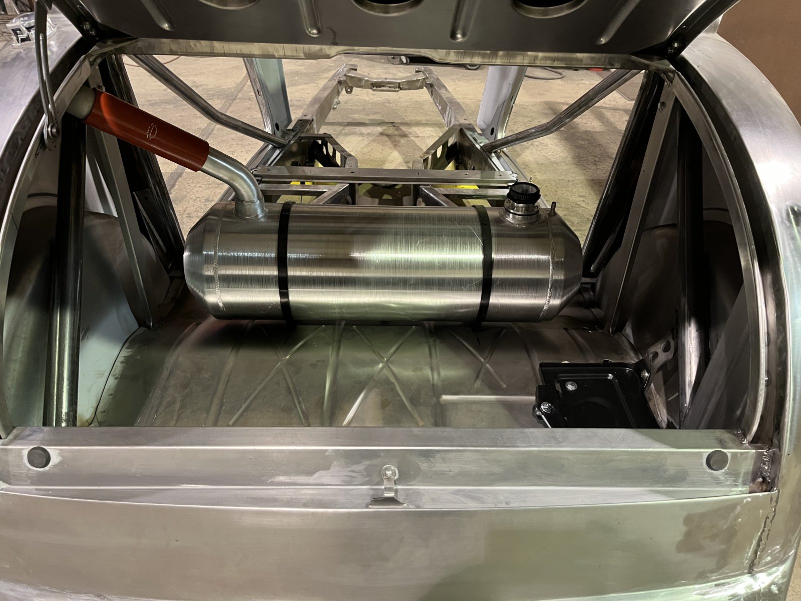

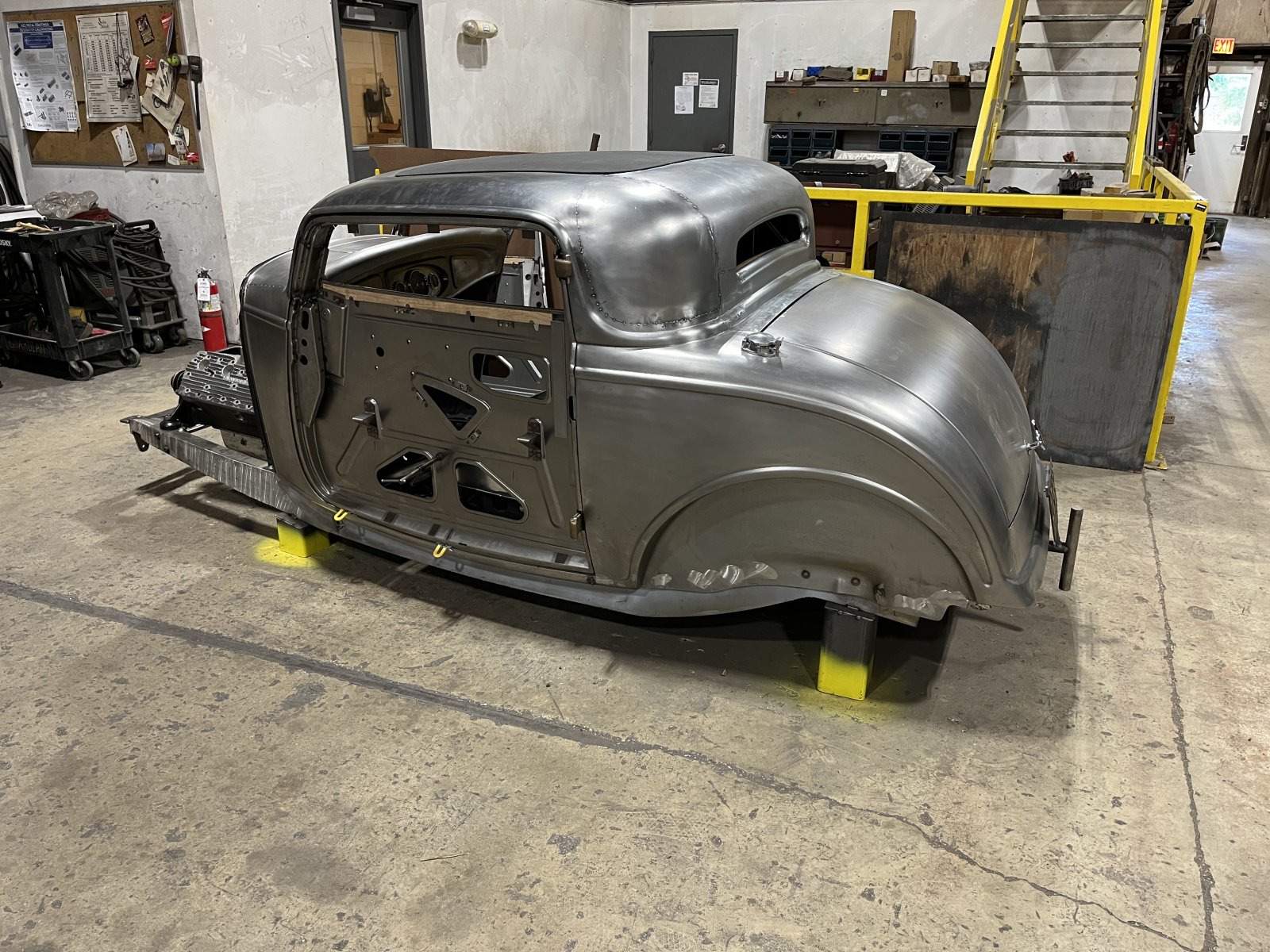

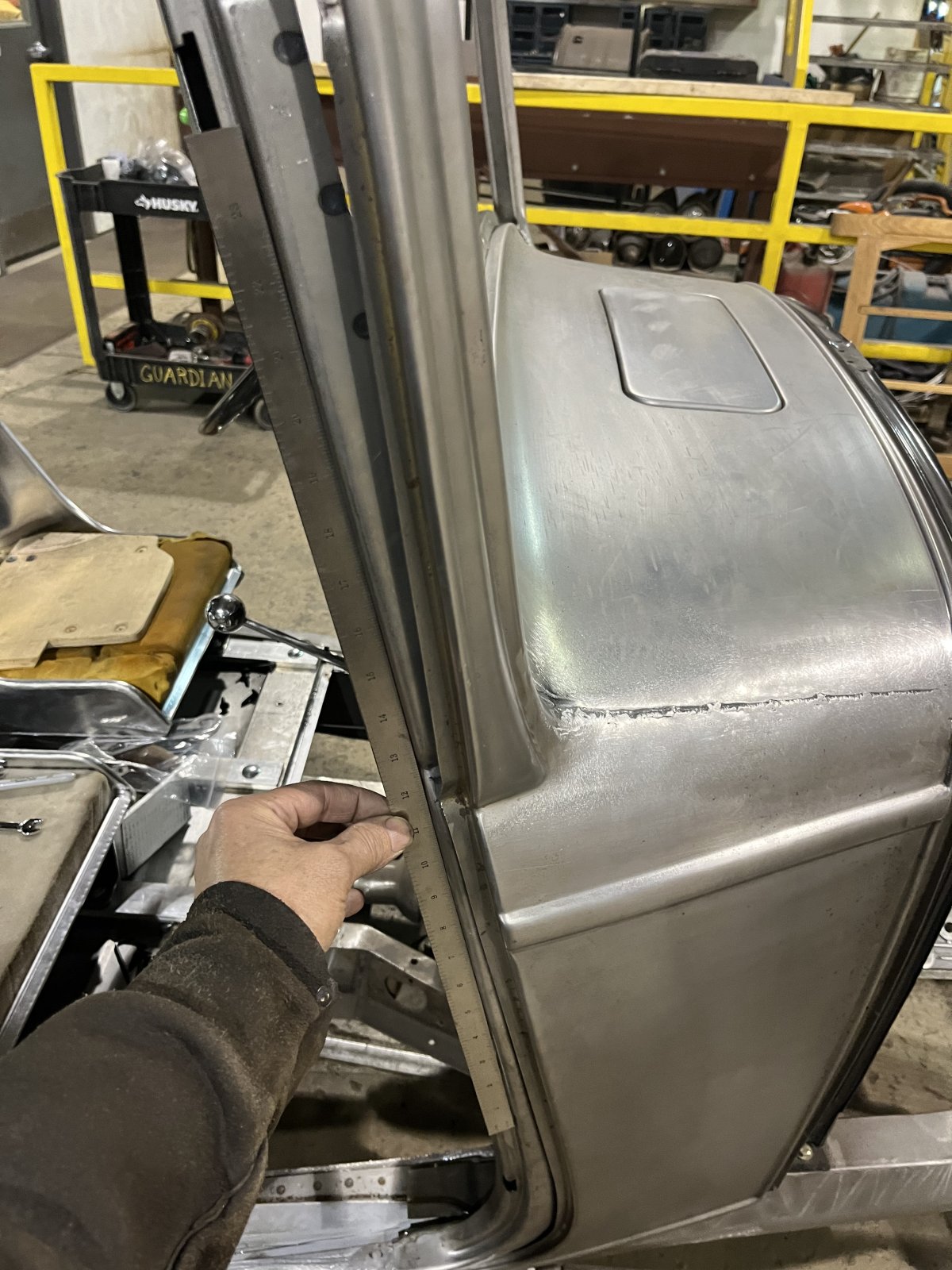

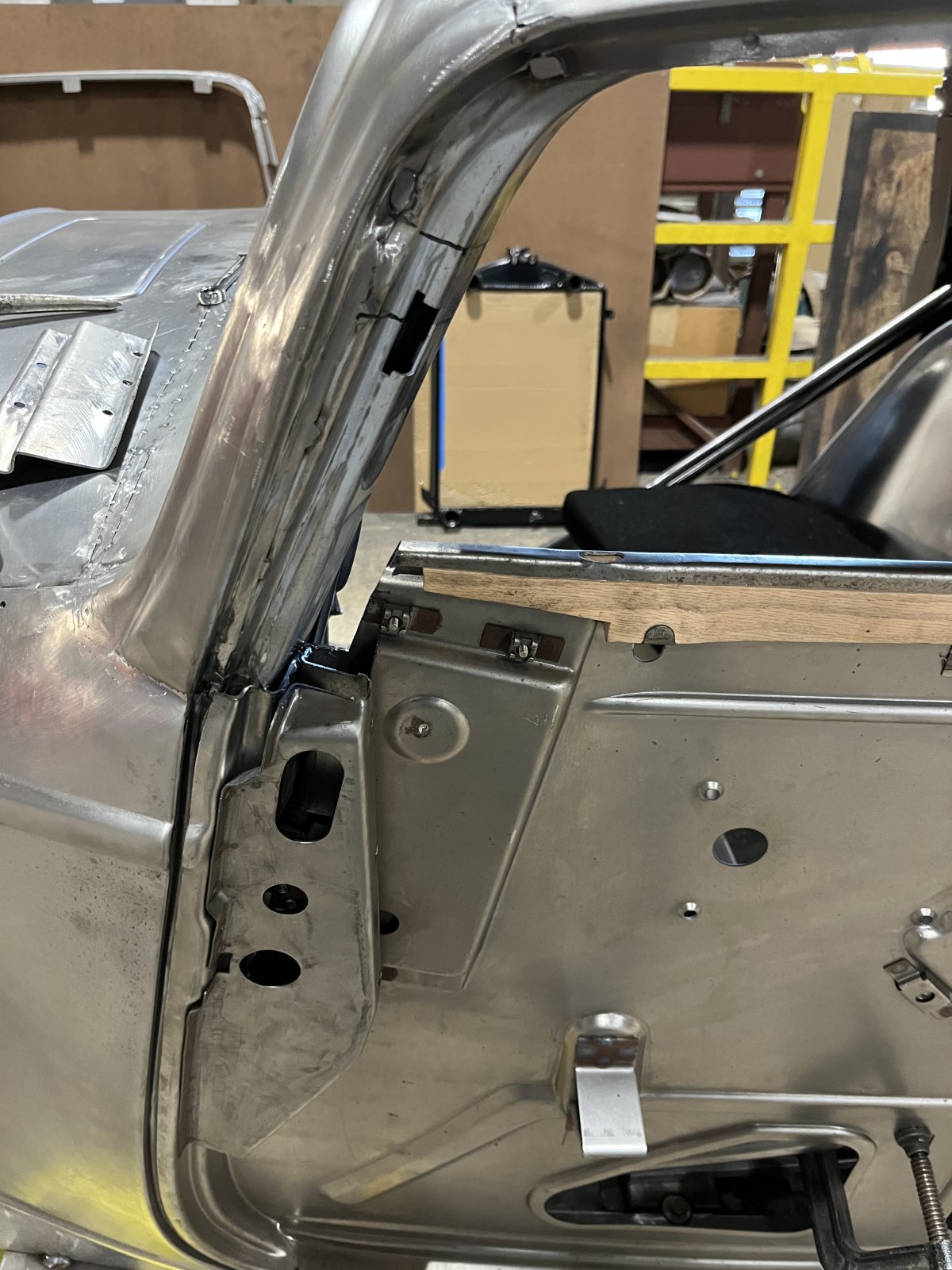

    F1F67751-6408-48DC-8557-7F0ED125AA5B.jpeg D06679DA-0F11-4986-95AD-C25E7EF64E28.jpeg C71DE65B-BBEF-43F5-B183-F2B057DD409C.jpeg EF0EB3AE-BA2A-47DA-AEF3-BA468B60FB2F.jpeg 1ADEB731-8C5C-4FB6-B89C-15F359E8DA97.jpeg I’ve only had two snags building this car.
    First was the A-pillar/front door jamb not fitting. A relief cut was made in the body to correct the alignment with the jamb.
    Second was the fuel filler hose and the roll bar pipe interference. Easy fix. Making a roll bar to fit and keep all the wood inner structure was well planned out. But the fuel hose from the flip top cap to the tank needed a little tweak.
    the car is going together great. The build could have been a little easier if I had an original 3-window to do side by side comparisons. I’ve been lucky to have many H.A.M.B. members help me with their knowledge. Much appreciated guys.

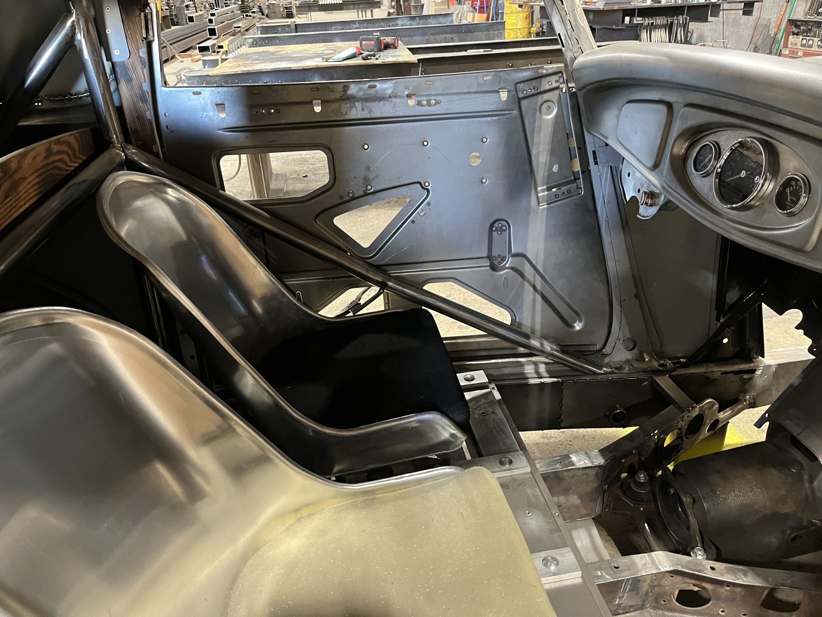

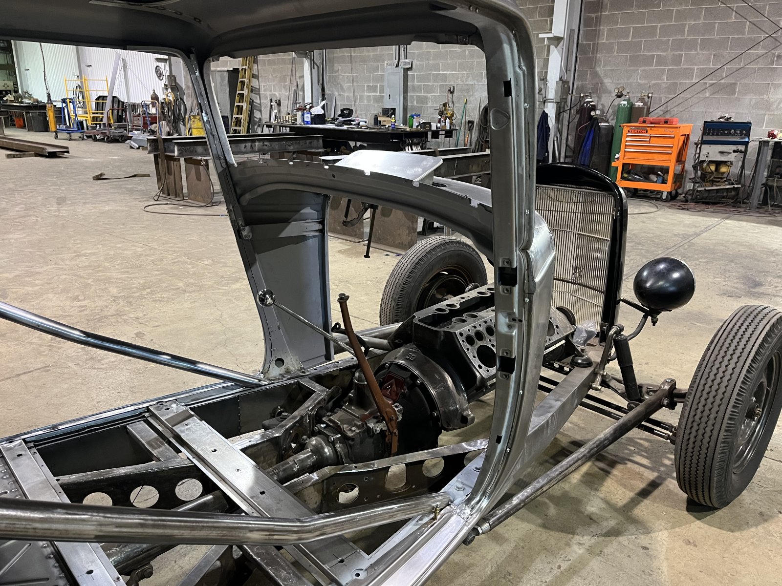

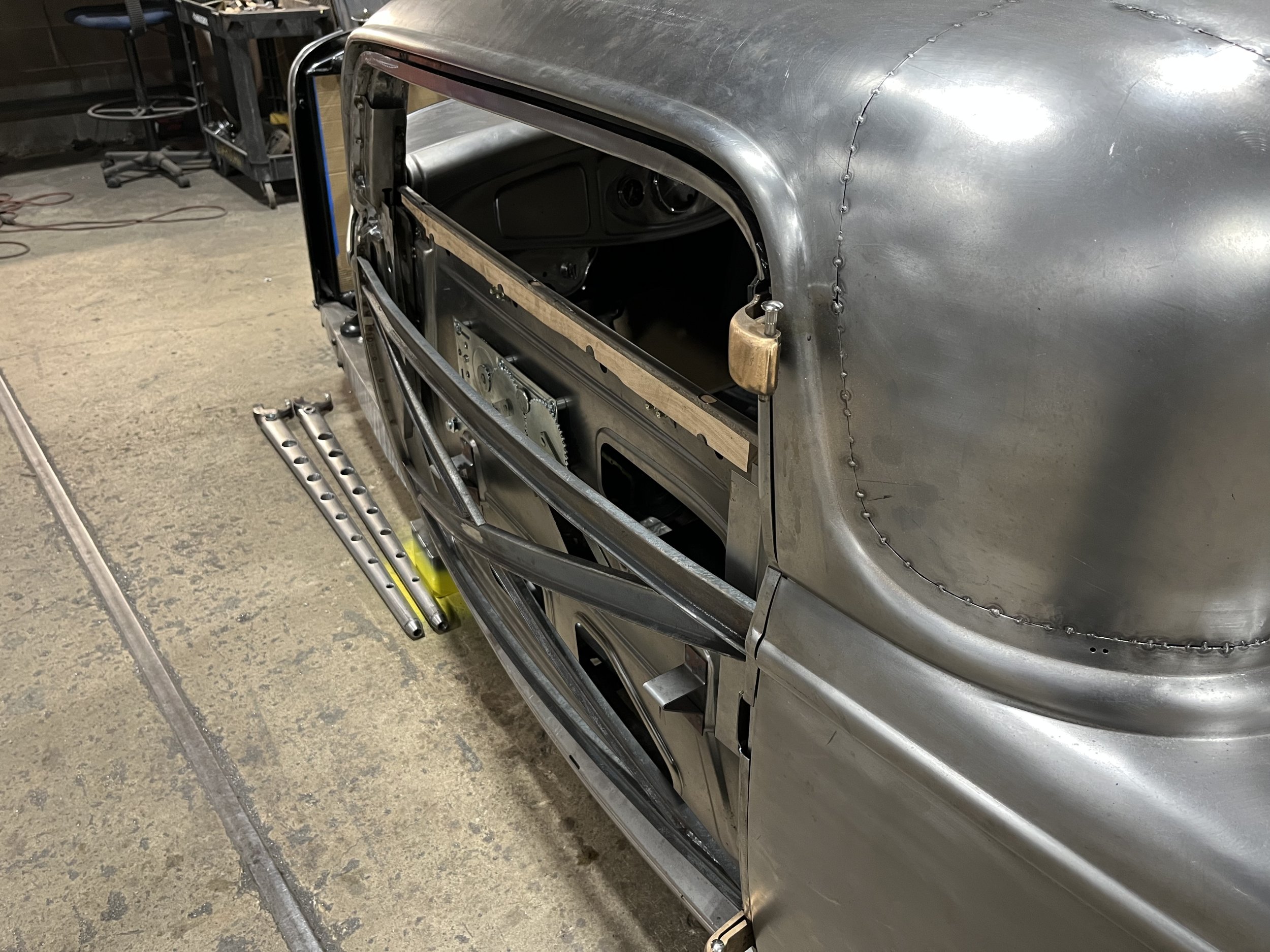

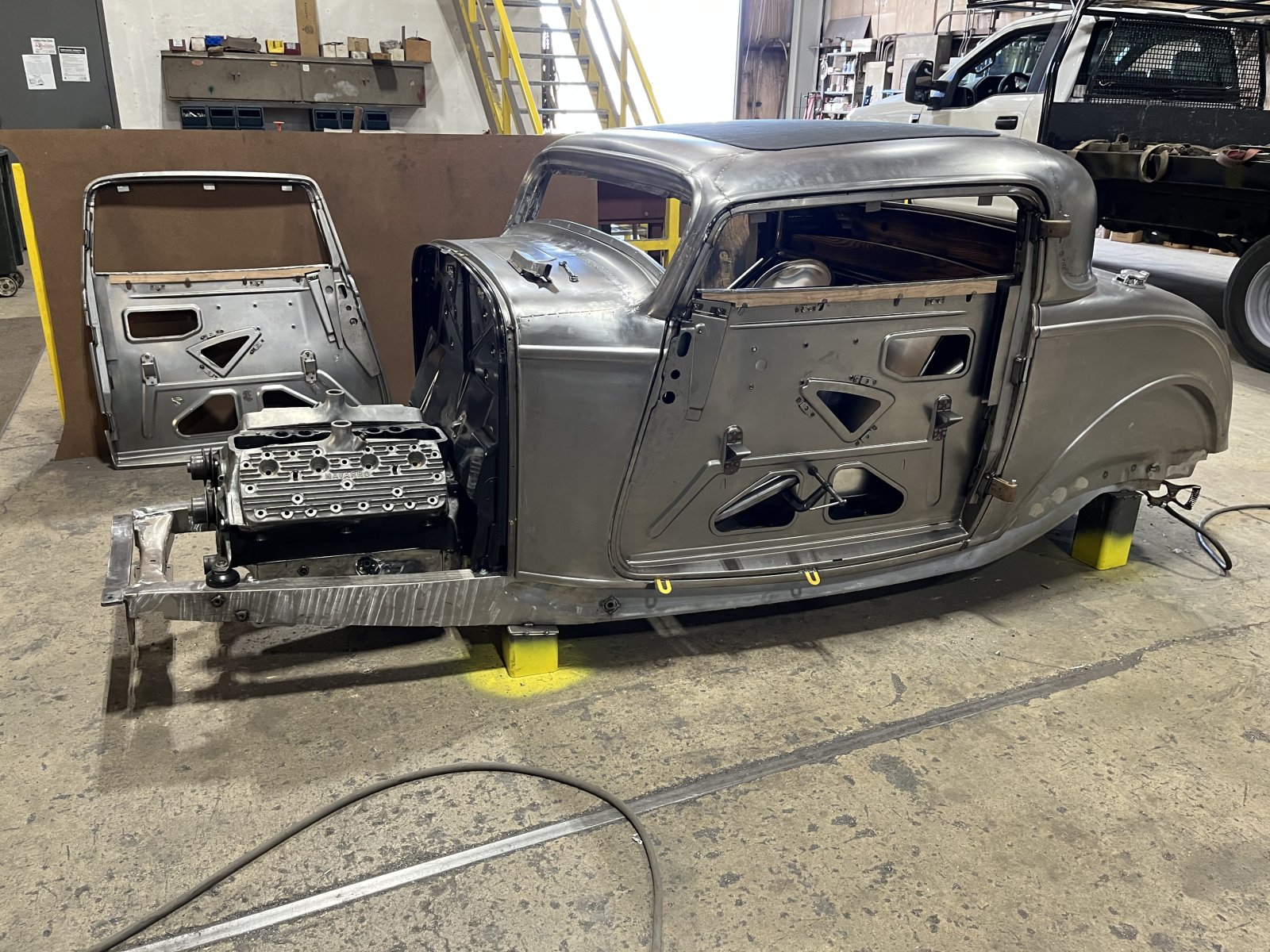

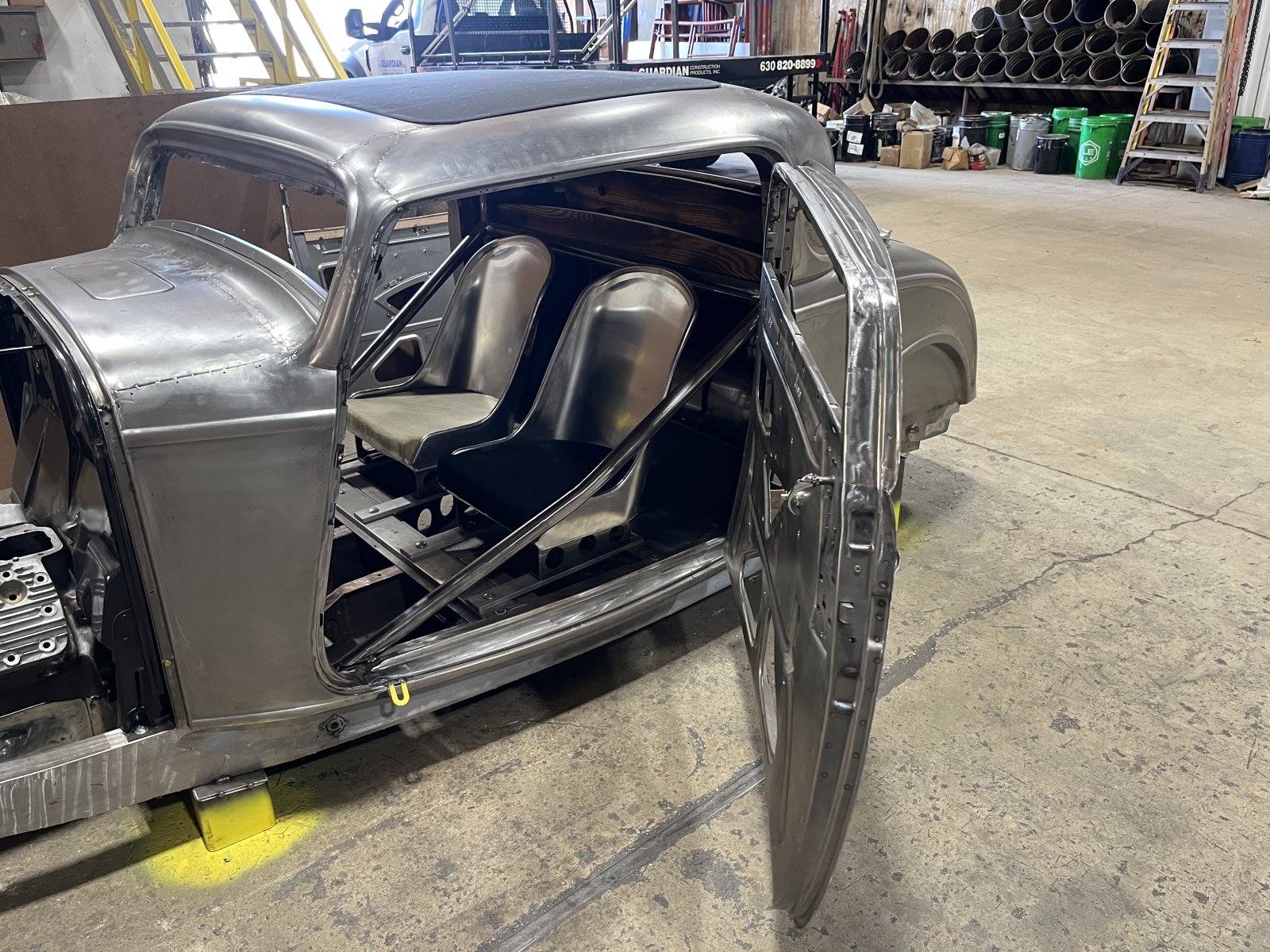

    52D6B8AF-C042-48D1-AF26-B95CB178A5D3.jpeg 3D253617-8858-46E0-B8B9-20CA53FA05EE.jpeg ADF9738B-B021-4755-B688-D8FF7F63C09E.jpeg 03E1BCC0-C8F1-48D1-8E33-1ED136952626.jpeg A88327EB-8F39-47C3-81B0-1C5B8DC24CAD.jpeg 837DBE48-EE79-4D12-AA42-FBB76A9633D8.jpeg 1B2CBC71-828A-4088-977E-535B428F0AC8.jpeg 58ADCD71-1692-42BA-AAE1-0F17D436185C.jpeg E3C75E56-76BF-468C-AF93-48159D3BDC65.jpeg EC53BB10-FC8B-4F54-B603-336755E67FA4.jpeg The left inner door is fitted and finished. I will fabricate an X-brace and get the gl*** channel, regulator, and gl*** template made and working before I fit the door skin.

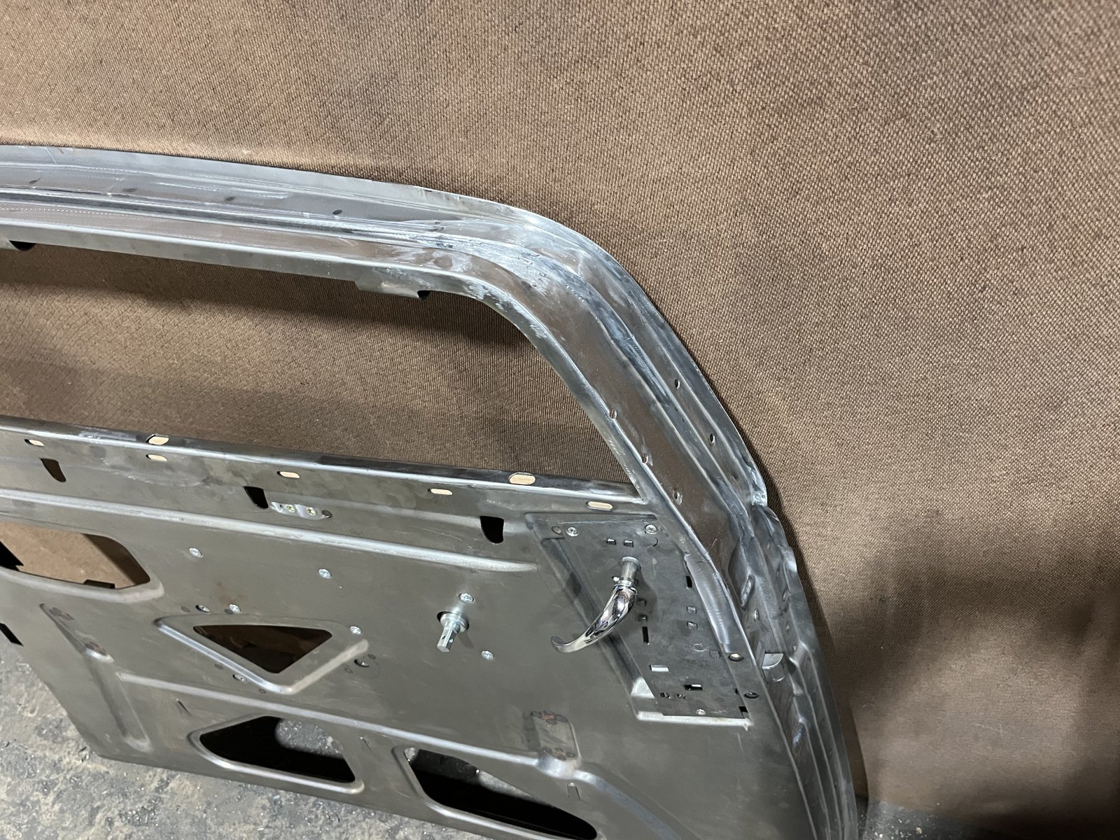

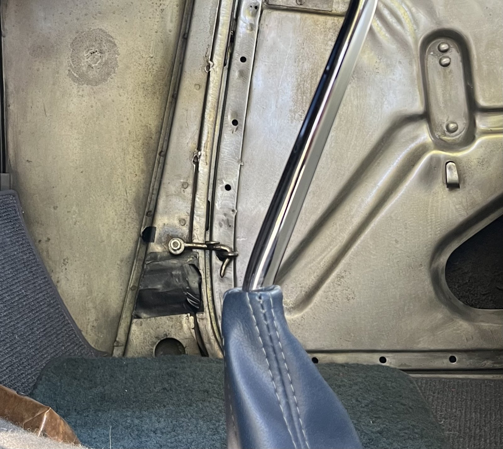

    I have the Brookville dead bolt system but I may just use a hook and eye latch as my safety. Would seem more period correct to me. I’m not sure I need anything since my frame is boxed and X-braced, plus the roll cage should prevent body twist popping my doors open. B3516564-2803-4D58-B355-0BE347F58F30.jpeg
    Fordors, Outback, 31chevymike and 6 others like this.
  18. oj
    Joined: Jul 27, 2008
    Posts: 6,589
    oj
    I like that, kinda simple, did I miss the door check strap?
    Outback and 31chevymike like this.

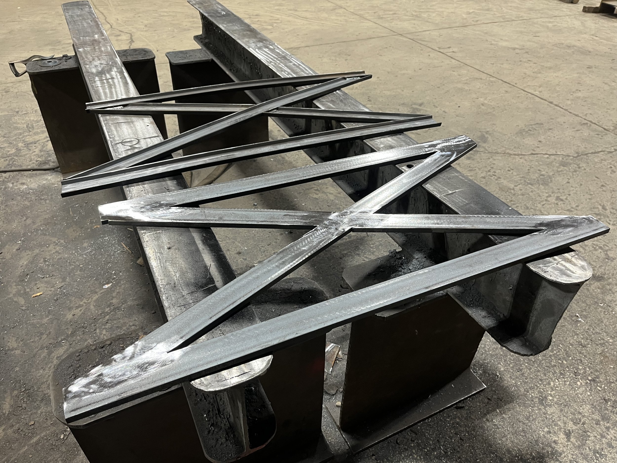

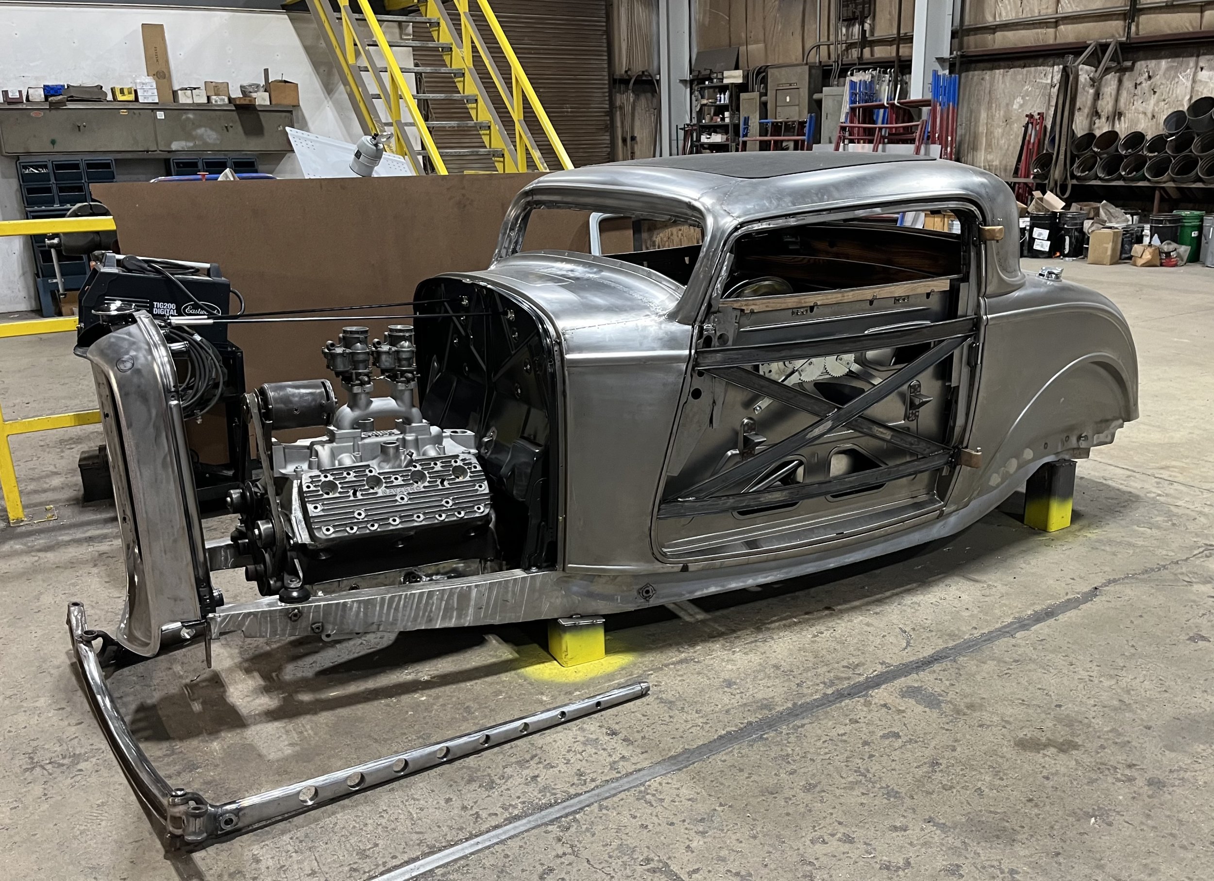

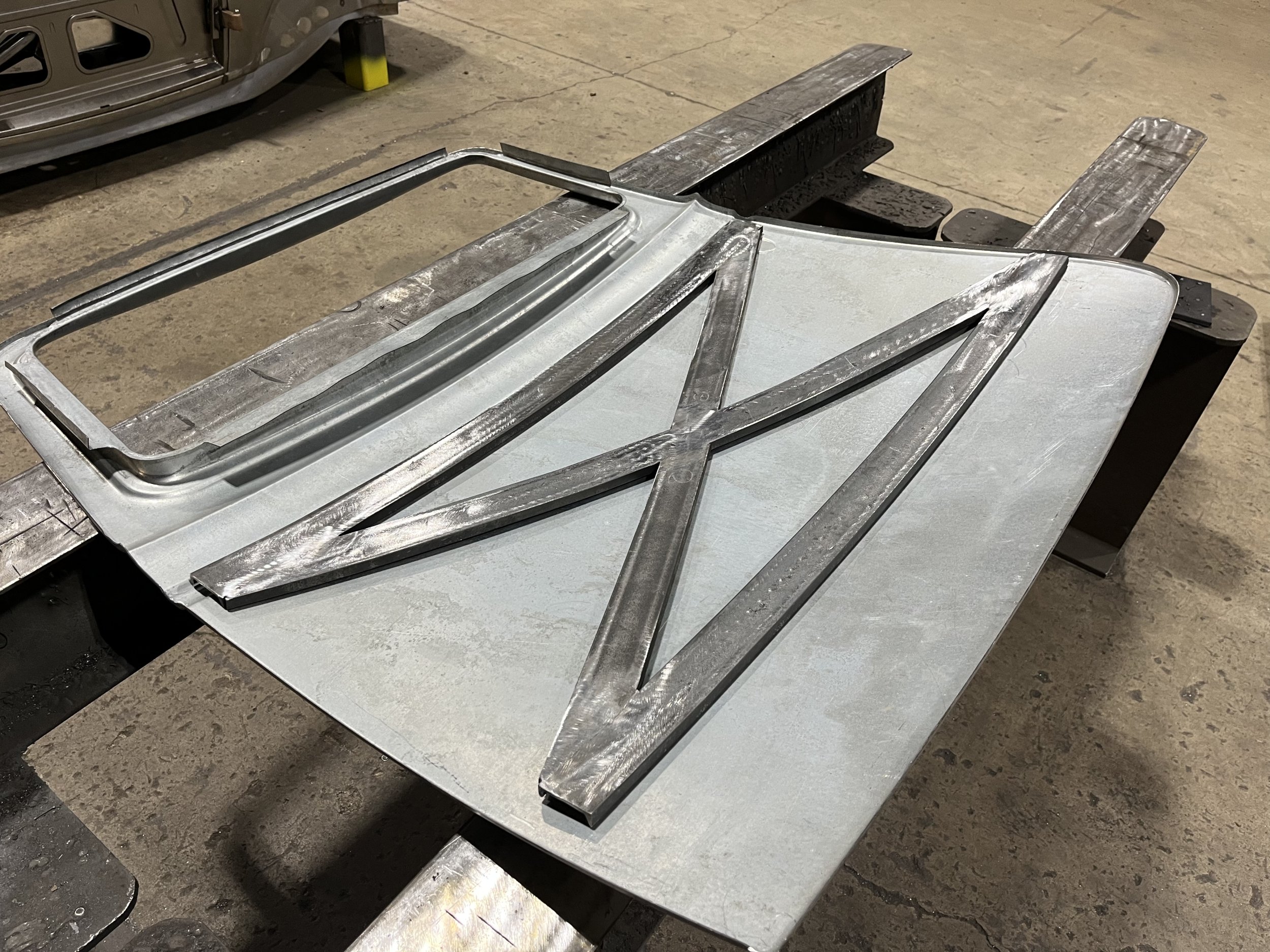

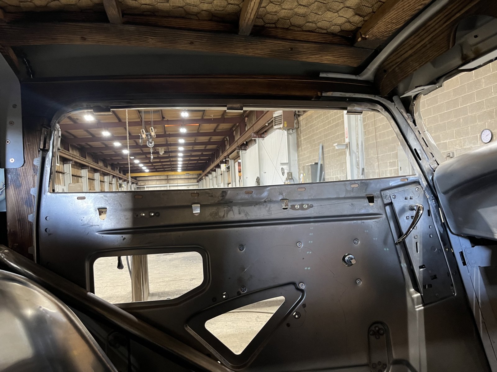

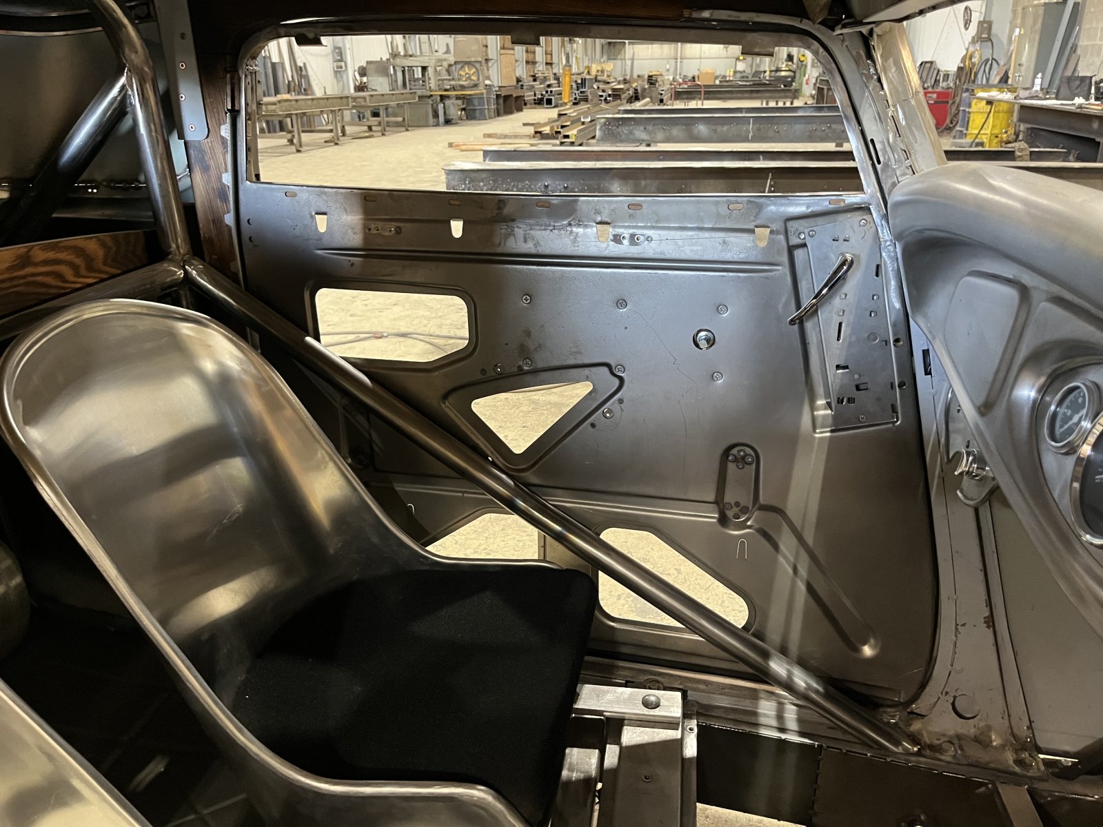

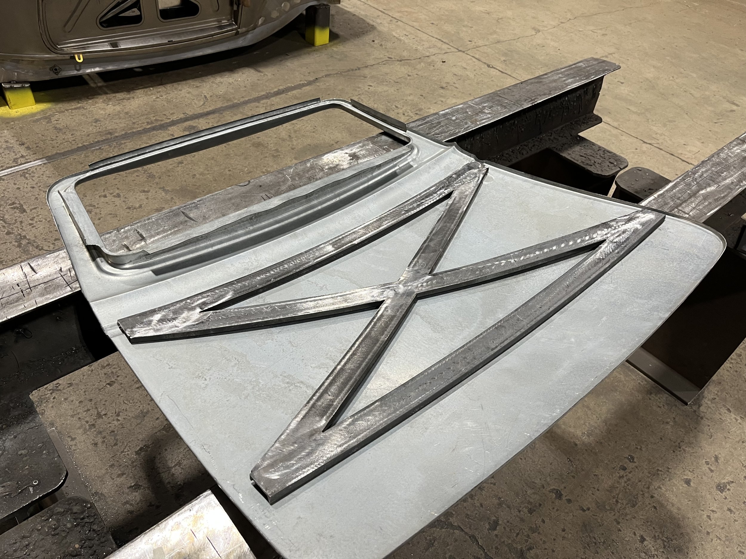

    A0D2812E-C2D0-4069-B4F5-D94690485DE2.jpeg F0906B67-3E96-48C6-ADD4-3B482D82EE81.jpeg 03A25BF8-3B82-44E8-A415-91FD71B072AD.jpeg 2D34DA6F-19F8-4EB4-840B-3EC592D0ECD5.jpeg I have the inner door finished. I made X-bracing for the insides. This really strengthened the door, but added weight. I’m going to drill 47 holes in the brace to lighten the door.

    I spy spacers between the inner skin and the window mech. New one on me. What's that about? I haven't got those and my winders seem mysteriously stiff. Hhmmm. Really interested in finding out your why!
    I also see your door bracing is made of steel channel. No wonder it's heavy? Nascar side bars??
    Chris
    31chevymike likes this.
  26. 65standard
    Joined: Jun 14, 2011
    Posts: 1,096
    65standard
    No spacers on the regulator. That is how they are designed to clear the clock spring. Those are mounting studs. Mystery solved.
    The channel is 1/2 x 2 x 1/8 thick. It’s 1.33 lbs per foot. What would you recommend I use?

    alchemy
    Bobby Walden makes his inner braces from sheet metal. Turns edges for strength.

    65standard
    The sheet metal braces sounds like a good idea. I could have brake formed a channel out of 16ga and used that.

    alchemy
    A lot of extra weight on a door with 33% less hinges sounds like it could be a problem. If it were mine I’d probably be bracing the backside of the B pillar more than the internal of the door just to hold the door up.
