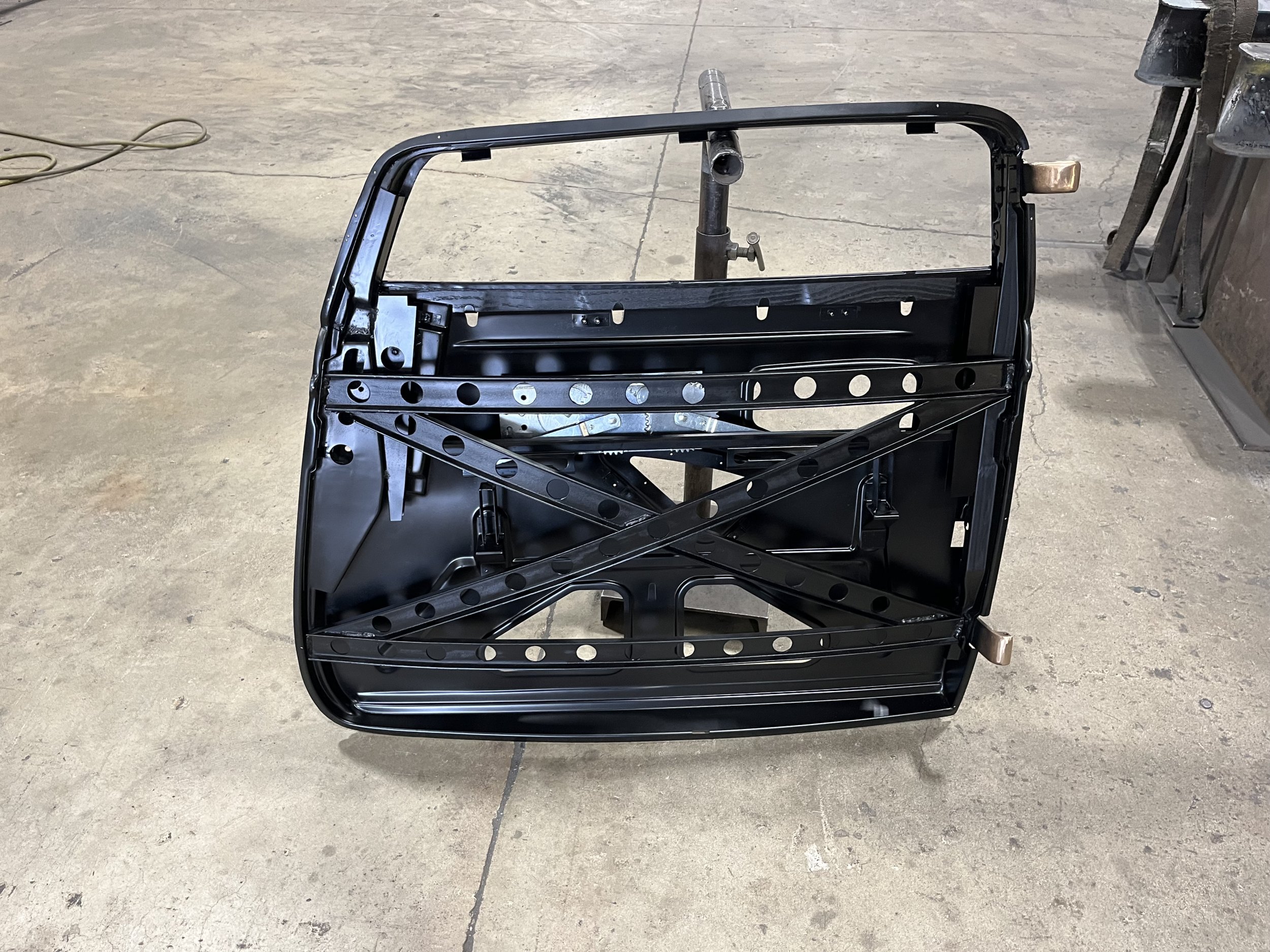

    3FBEF62F-352F-429E-BD5C-A9A2C15444BB.jpeg DFE3594E-4FA3-4955-8633-5760DFFE4D8B.jpeg The brace is 14 lbs. not sure how much weight I remove with the chop, smaller gl***, and lack of door panel?
    Here’s my little interior door panel/pull.

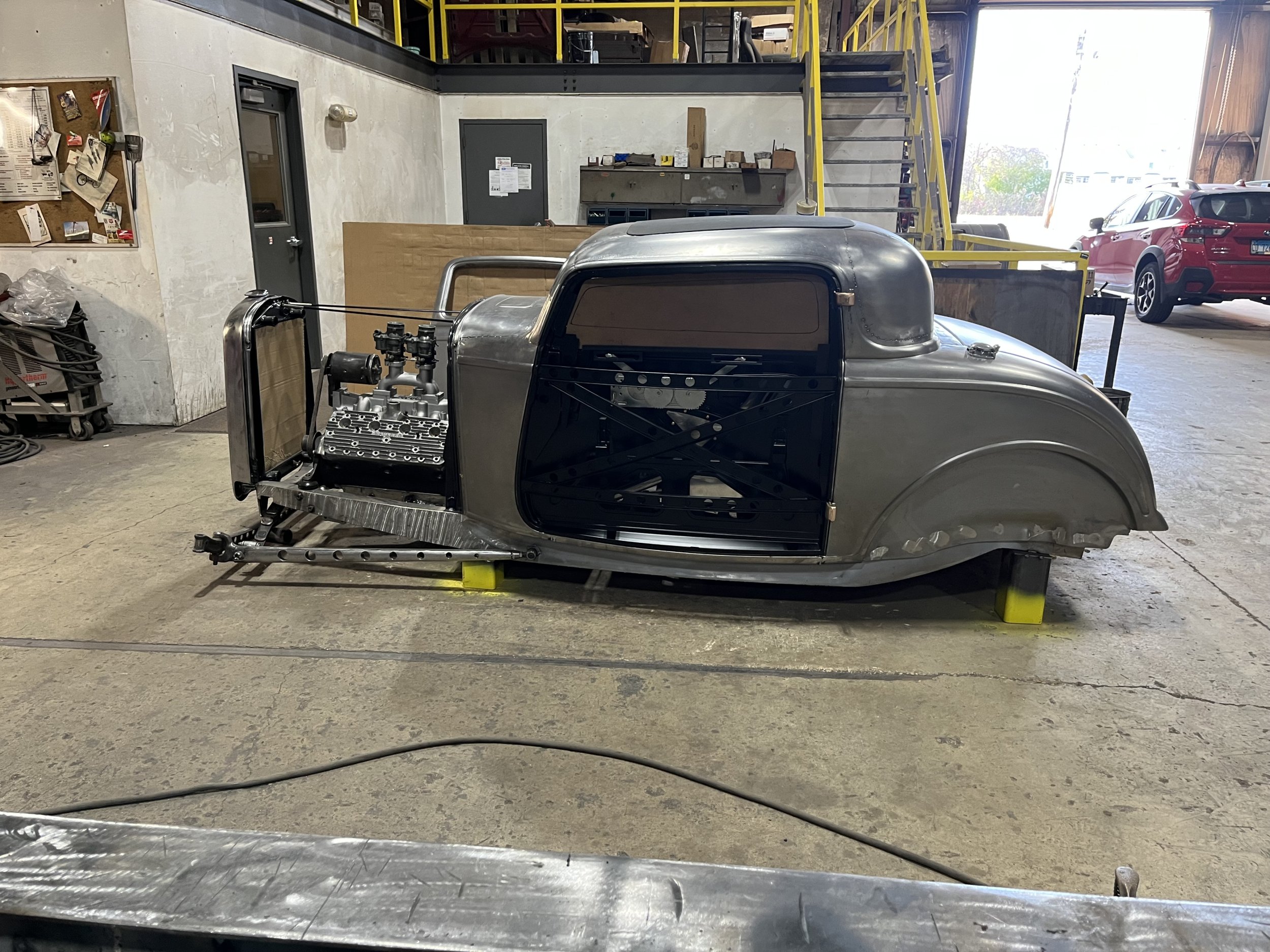

    Working on the outer skin now that the inner structure is done with working window and Nader/X-brace for strength and safety.
    with the inner door skin scribed and trimmed to 1/4 “ of the body opening, I then rough trimmed the outer door skin to the door. Next I pinned it on.
    Then adjust the door gaps with a hammer and dolly before folding over the edge. That will be last part of building doors.

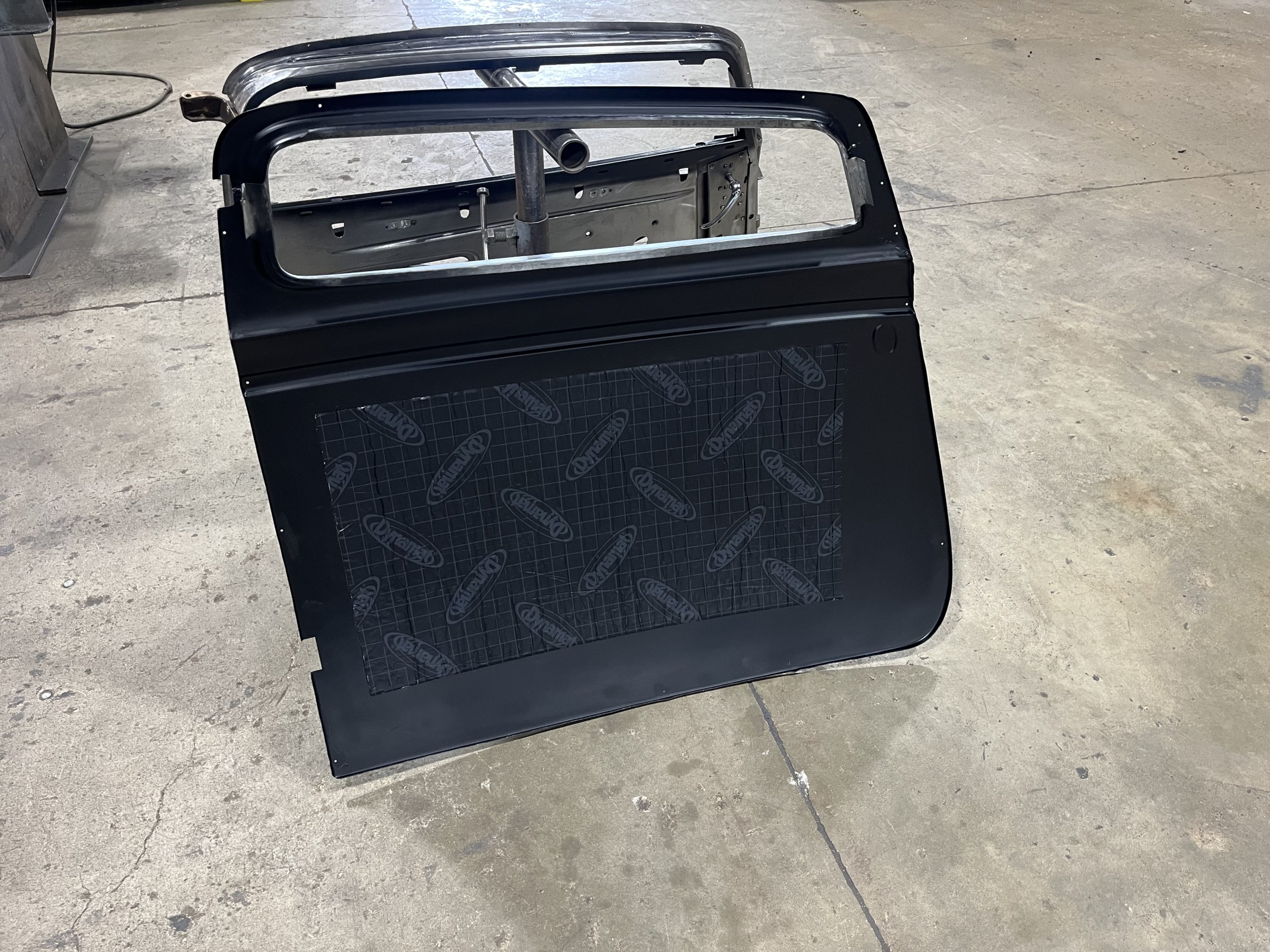

    Here is the completed inner door. I even filled the middle hinge like I did on the jamb. I coated the inside of both panels satin black and put dynamat on the out skin to muffle the metallic sound of the door. IMG_7206.jpeg IMG_7210.jpeg IMG_7211.jpeg IMG_7213.jpeg IMG_7226.jpeg IMG_7228.jpeg

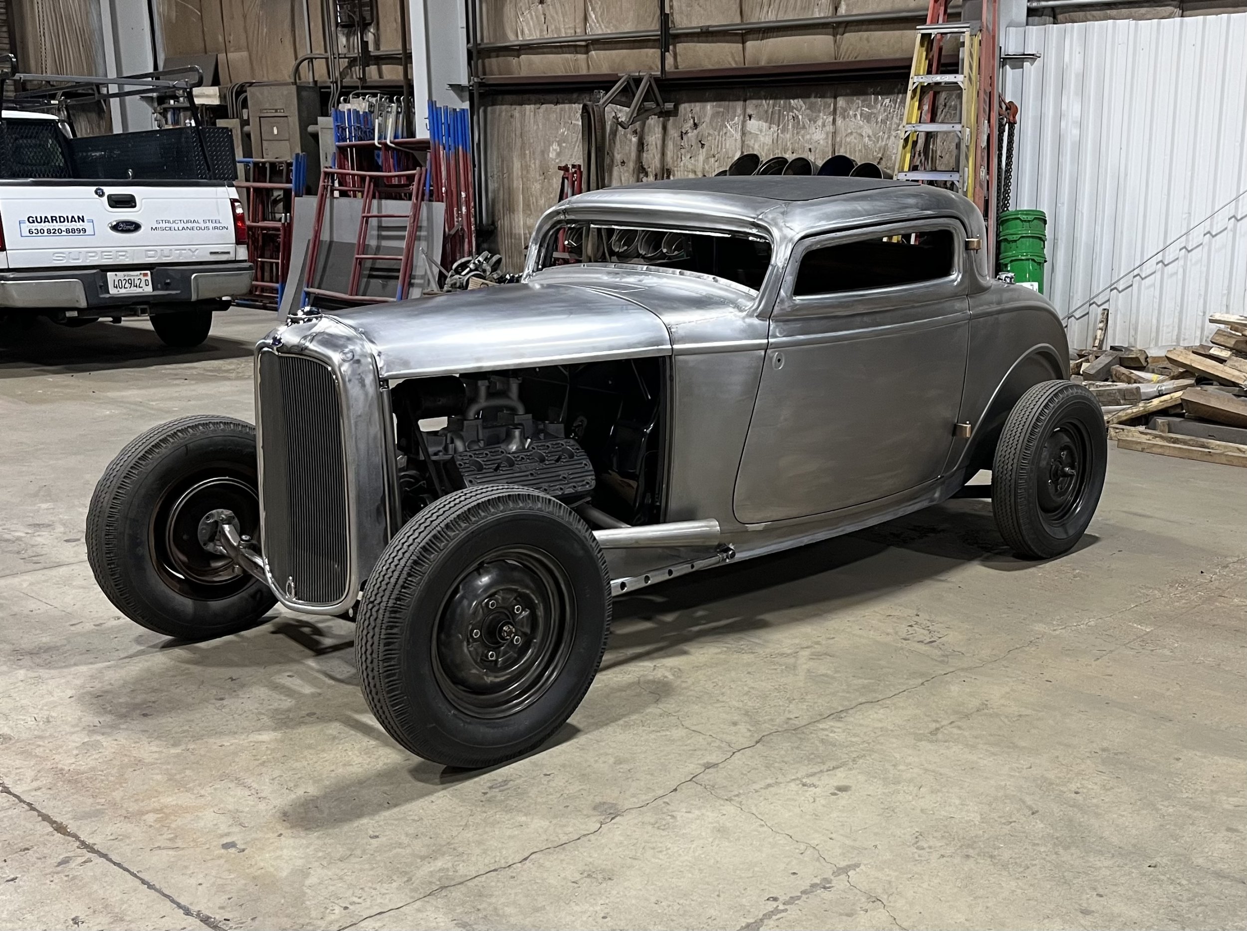

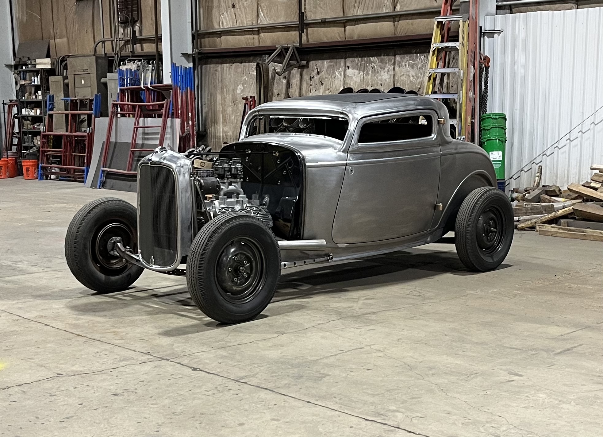

    Some more door details
    and with the one piece 2” longer hood. With the correct 5.00x16 front ribbed tires and 7.50x16 rear tires and at full weight, it should have the stance I’m going for. IMG_7229.jpeg IMG_7232.jpeg IMG_7239.jpeg IMG_7267.jpeg IMG_7286.jpeg

  25. The37Kid
    Joined: Apr 30, 2004
    Posts: 32,537
    The37Kid
    Longer hood needed a narrower grille shell, correct?
    31chevymike and porkshop like this.
  26. flamedabone
    Joined: Aug 3, 2001
    Posts: 5,761
    flamedabone
    Wow!! That is major progress. Nice work.
    -Abone.
  27. 65standard
    Joined: Jun 14, 2011
    Posts: 1,096
    65standard
    nope. It’s a custom made hood using the stock grill shell.
