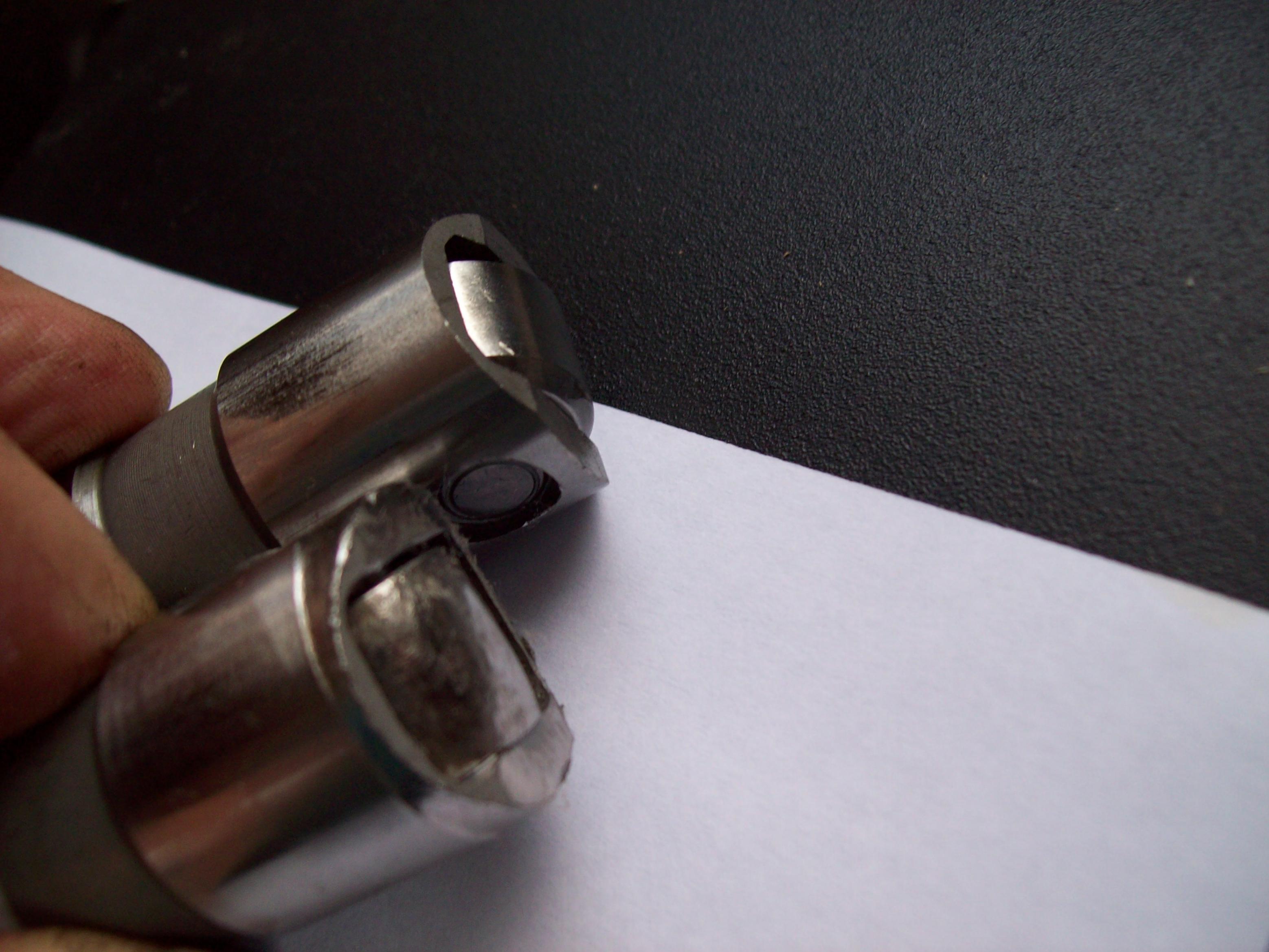

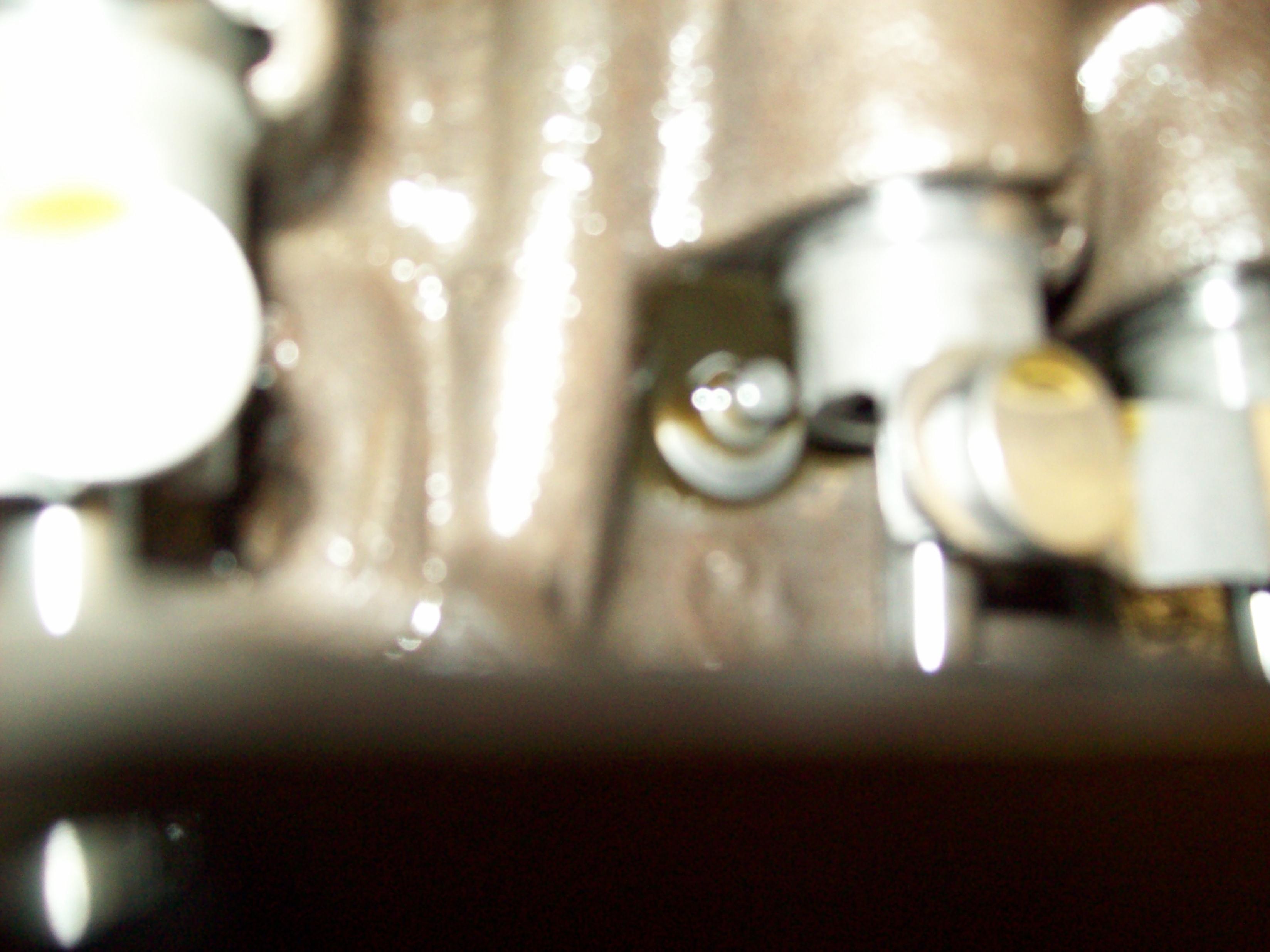

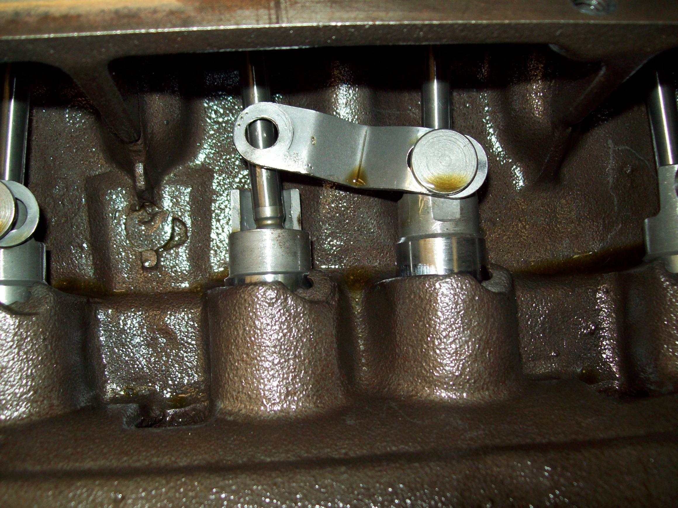

  1. Made what I THOUGHT was a good score on a set of "White Box" roller lifters for my blown DeSoto Hemi. Everything microed out fine, machining looked good, etc, etc. They worked fine...for about 50 miles! Got about a mile from home, and the engine started back firing through the carbs and running rough. Heard lifter ticking noises and it seemed to be missing on a couple of cylinders so I pulled the blower/intake/valley pan. Check out what I found! I've ordered a new set of Lunati Rollers (made by Morel) for $339, with free Shipping, from Race Mart in Tampa. I haven't even pulled the cam yet, but I'll bet that I've got 4 bunged up lobes in the bargain. And I knew better, too. You may ALL start kicking me in my *** :eek:.

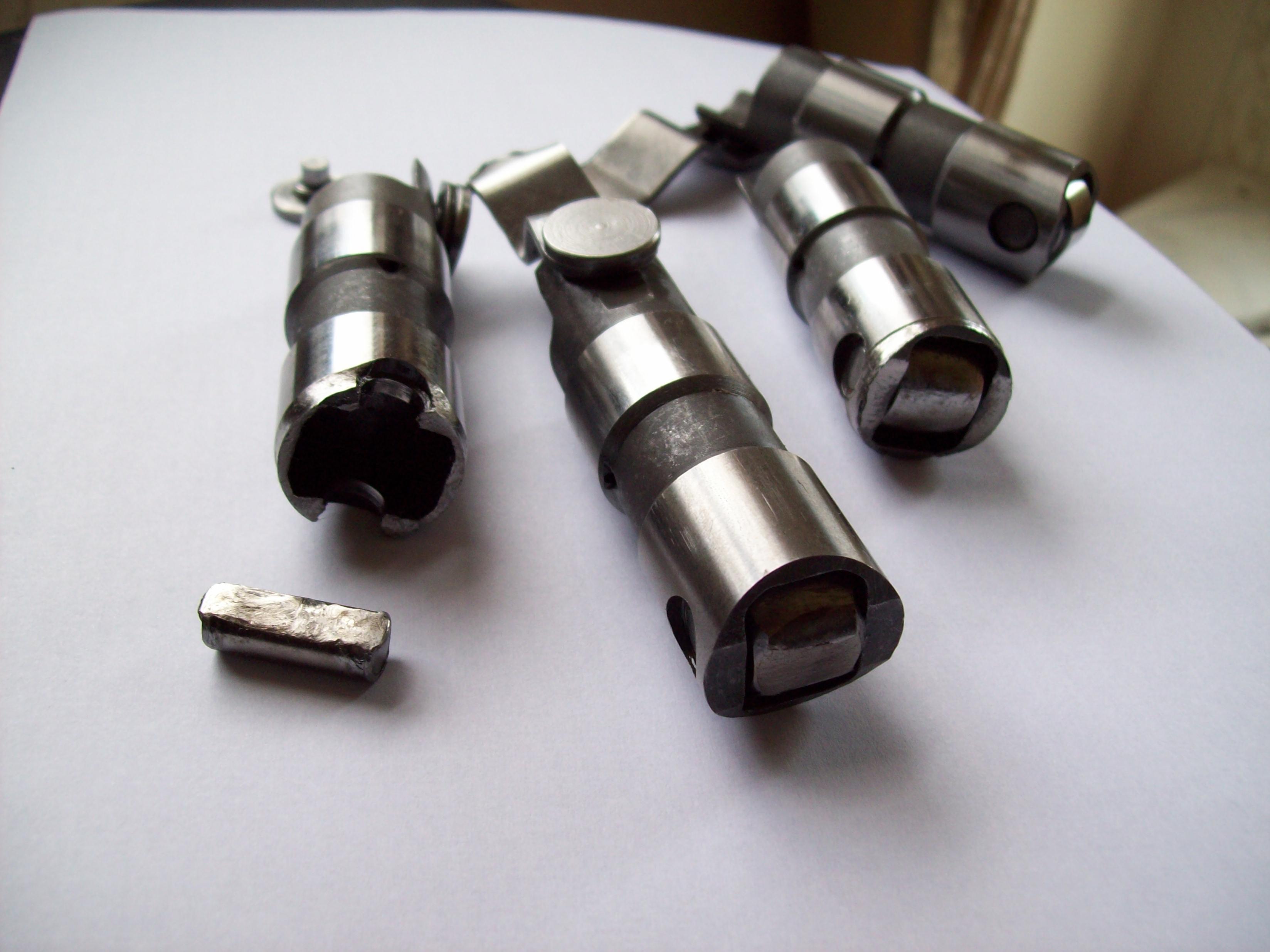

  26. More pictures of the lifters. Believe it or not, the cam (Mid 50's made, with American steel) is fine...a testament to Chet Herbert's work. Square wheel, busted lifter body, busted link bar...and half of the rest of them are collapsed. Still got a wheel in the oil pan, too. NO, I didn't over rev it or pound it. I was babying it until I broke it in. Closest I can figure is that the rollers weren't rolling right...may be slightly ****ed. At any rate, the Lunati's are repackaged Morels...according to the Tech at Lunati. We shall see what we shall see. BTW, they weren't Hot Heads, I got them on ebay...

    Wow, the way those rollers look I'm surprised that the cam didn't have any damage. Those rollers must be pretty soft.
