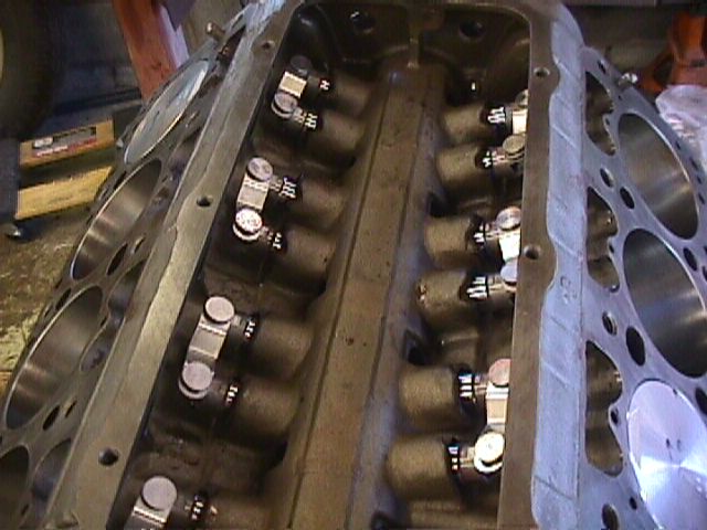

    If you don't pull the cam out I'd at least check the lift on that lobe. That roller should have ate the lobe off by the way it looks.

    Ditto! With **** like that out there, I'd do a service and let people know where these were bought to keep others from running metal through their engines.

    i've seen a set of comp cams vertical bar roller lifters do the same thing.

    Sorry for your loss. I've never seen lifters with a "Link Bar" what is the reasoning behind that?

    All roller lifters use either a link bar or some sort of guide to keep them from rotating in their bores.
    Flat tappets need to rotate in their bores. Roller lifters are a different deal altogether as they need to stay in one position to allow the roller to stay aligned with the cam and follow the lobe.

    Roller lifters don't roll very well if they turn sideways............ the link bars hold them in proper alignment to the cam lobes.

    In the pics it looks like the roller links were hitting the top of the lifter bores. I think the lifters were fine and the interference caused all the ****ons to be wiped off the lifters. In the pics you can see the broken peices of block in the location with not enough clearence.
  18. HI - There was plenty of link bar clearence. What you see in the pictures, that appears to be broken pieces of block, is cast into the top edges of the bores.

    I do, however, wonder about how well the link bars were holding the lifters in line, cam walk would be a good bet as well (he should have a good torington bearing or at least a bronze bushing between the cam gear and block with a properly loaded cam ****on holding everything in check) and I also wonder about valve spring coil bind and valve guide/seal to retainer clearance at max valve lift. Ummm an outside chance that the valves are touchnig the pistons? Its possible to have light impact and not be the wiser. The list goes on.....
    It seems a little early to blame the cheap parts with the motor still ***embled and the root cause of the failure not really nailed down yet.

  29. ...Not to mention the fact that most of the remaining "good" lifteres are collapsed and don't hold pressure. From the look of one set of lifters, the roller wasn't rolling, then the link bar bent/broke when the lifter turned. The other set appears to have popped a link retainer, allowing the lifter(s) to turn. The remaining sets "appear" to be fine however, as stated, most don't hold oil pressure. The rest of the engine is right on the money...it's the lifters that **** the bed...period. Even if the 2 sets didn't grenade, it would only have been a matter of time before the engine wouldn't run...due to the collapsed lifters...
