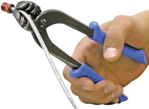

    I use a Snap On pair similar to these for ultra tight bends on steel and stainless.
    The design allows you to grab the line right behind the fitting and make a very tight bend.

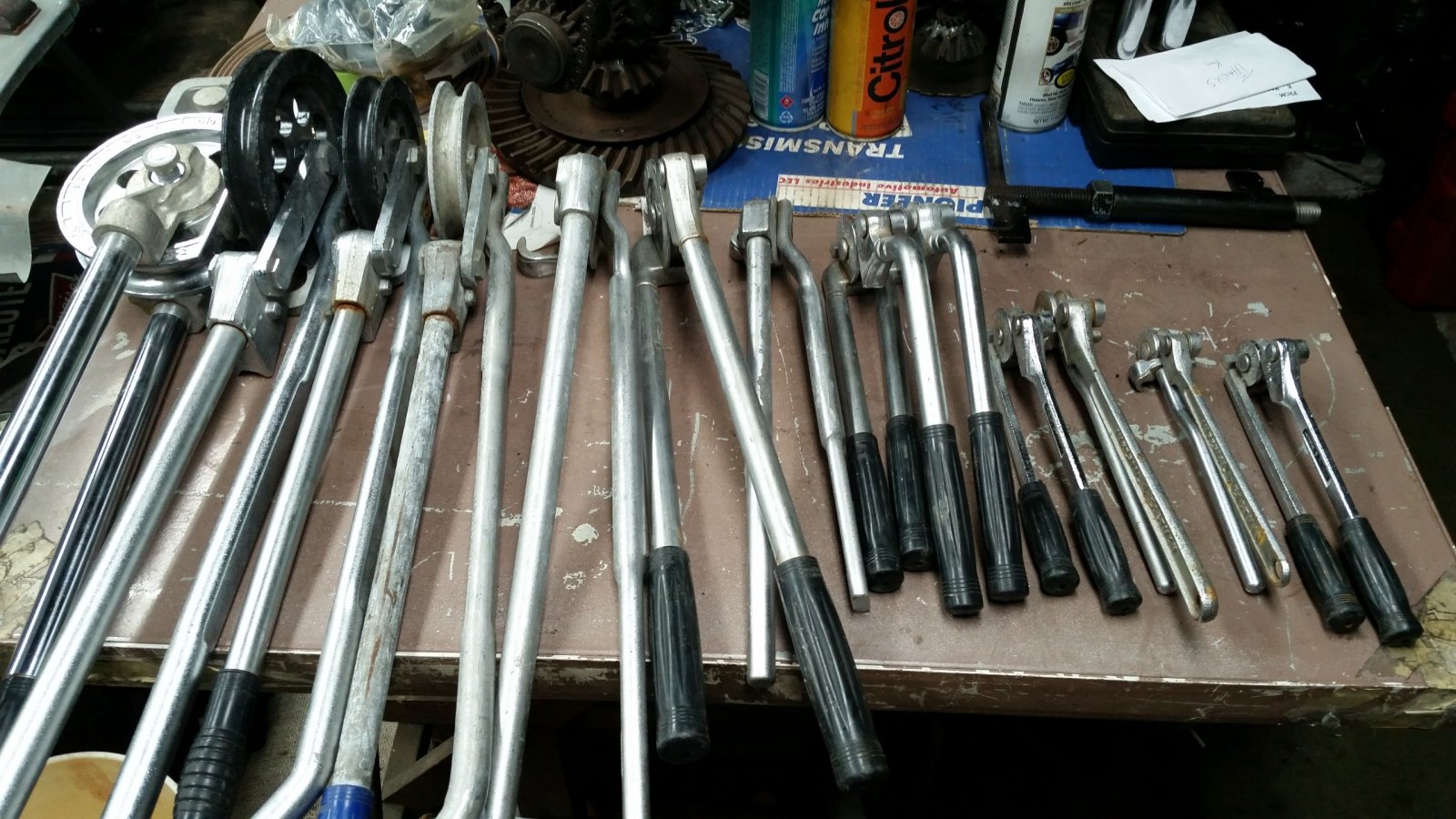

    I too have a drawer of tubing manglers. This tool (I believe made by Eastman... mine is a knock-off) is damn good at tight corners, even when hard up against flare nuts.

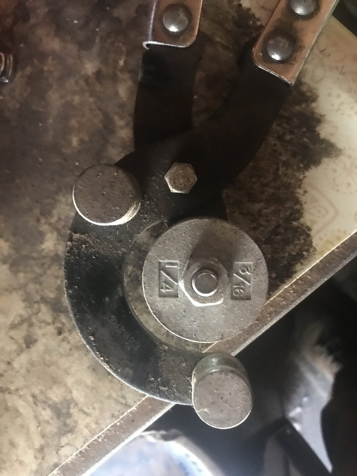

    I got snap on and cheap versions of these and they work great if you lube the tool or line first so it slips a little while you bent it .
    These guys work good for very tight bends in and around fittings and working with line already on the car .
    Also had good luck with the cheapy spring benders .
    have also used sockets , extensions , hammer heads and handles mounted in a vice as a mandrel to bend around .
    whatever works to get the correct bend or angle , but like I said lubing the line so it will slip a bit seems to work best compared to doing it dry.

    You must do a hell of a lot of tube bending! Nice collection. I love tools!
