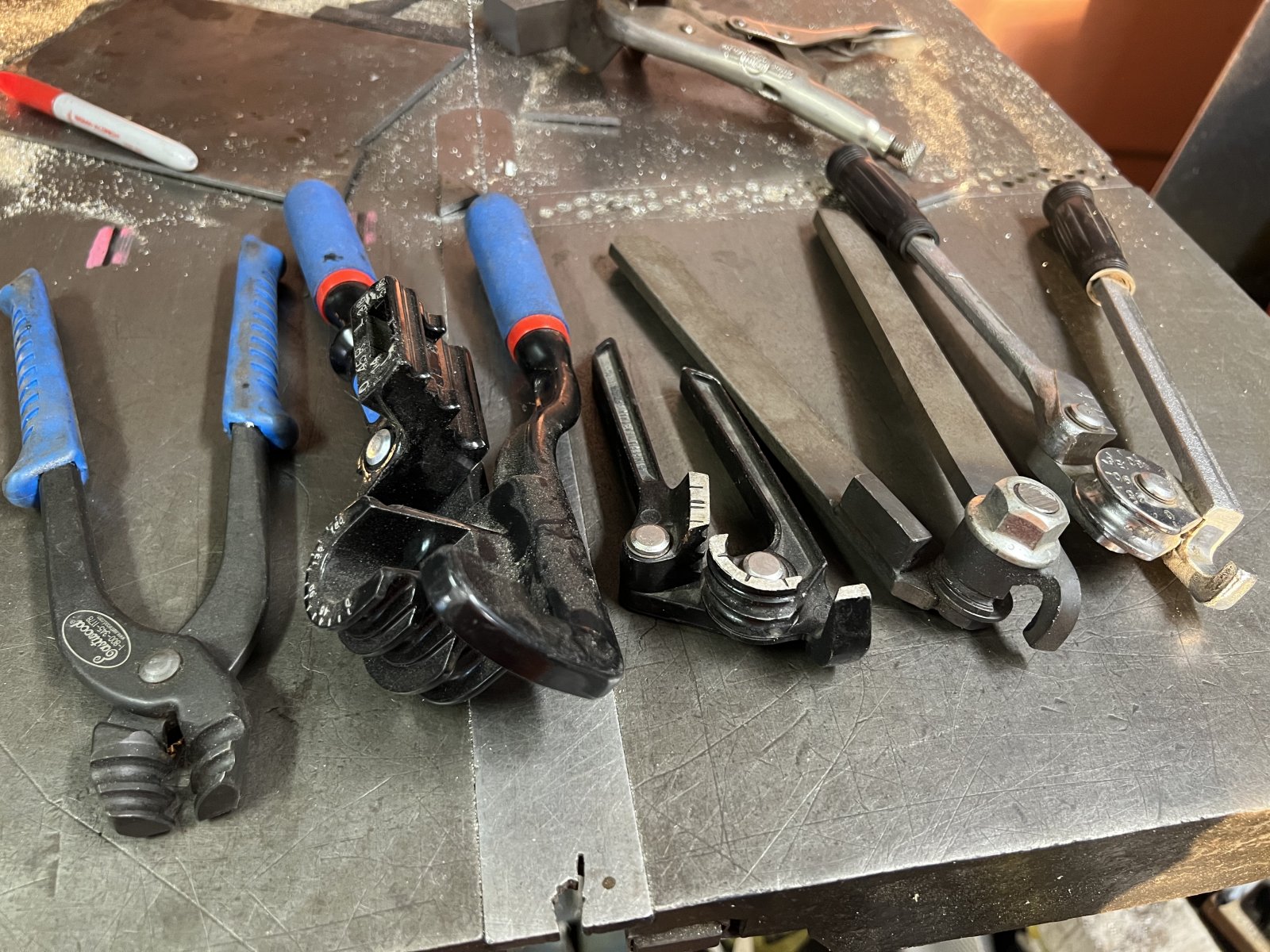

    I have several benders. The one I use the most for brake lines though is my home built tight radius bender. I made it specifically to bend lines immediately after the flare nut. I put clearance in the tool so the nut fits under the retaining arm, and the nut sits against the die. For my second favorite would be the small Eastman 367-RH 8E88EF61-257B-4D95-AD12-AB97E2B20D90.jpeg

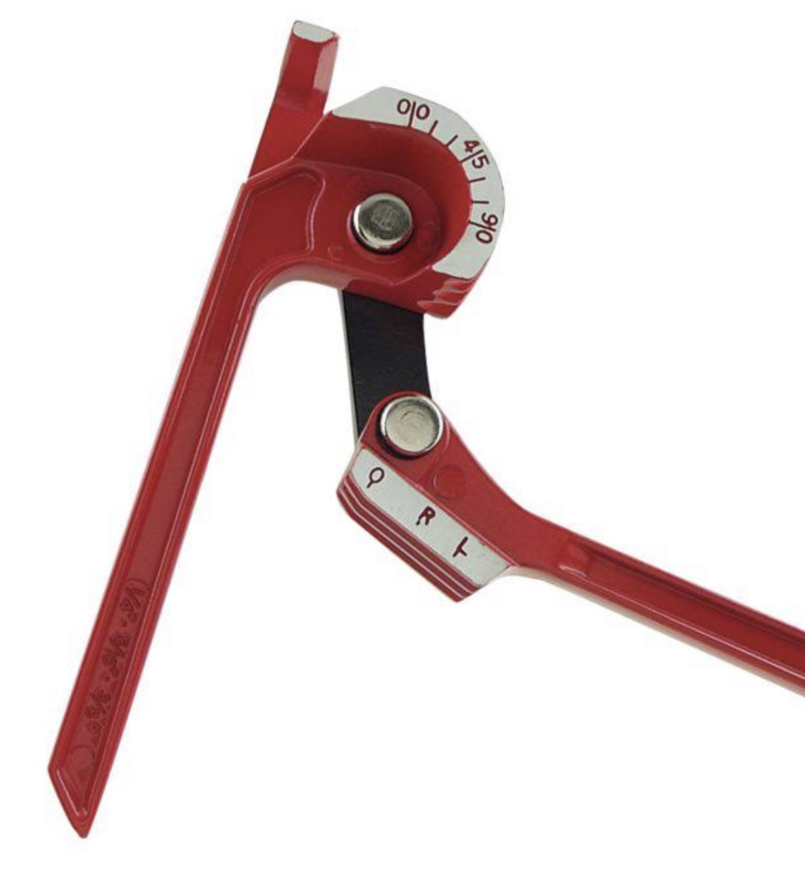

    They are possibly the worst tube bender made. I bought one to do the brake and fuel lines on a 57 Fairlane, the bends are nasty and you need hands like Andre the giant to use them. I gave them away.
  16. Harv
    Joined: Jan 16, 2008
    Posts: 1,567
    Harv
    from Sydney
    I got ****ered by one of those too. It was advertised as tight-radius, but is no bettter than the radius on the simpler, cheaper tool Anthony owns in post #39. I no longer use it, but use my post #39 one frequently for normal-radius bends (it does 3 or 4 different tube sizes without changing anything).
    Cheers,
    Harv
    bathcollector likes this.
  17. bathcollector
    Joined: Jul 8, 2006
    Posts: 292
    bathcollector
    yep, done the same and bought one like #39 too and have found it really good but the bend radius isn't as tight as it could be. Works for me though.
  18. BamaMav
    Joined: Jun 19, 2011
    Posts: 6,968
    BamaMav
    from Berry, AL
    That's the same one I have. Think I paid $5 for it at a garage sale. Works fine for sweeping bends, not so much for anything tight or over 180*.

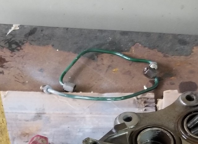

  19. The HAMB strikes again and I learned something!! These things are sweating and putting a cramp on my back to the road timing. I thought I may have to take them to a brake shop to have them bent because I have nothing in my tool ****nal to replicate. Now I have to find one that will bend right at the nut. Tried a tight bend over a file handle and it wasn't even close before it kinked. I have the Eastwood flaring tool. Wish I had that before. It has saved me a lot of money on therapy and alcohol but, the dies make it so you can't flare within 2-1/2" from a bend. So the bender on the far left - do you put it next to the nut and roll or twist the handle over? As you can see I need to get the line to what looks like 145 degrees over on itself.

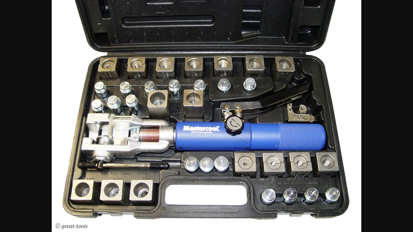

    If anyone is looking to buy one of those really nice flaring tool sets, be advised that they come in different stages of completeness. So when you see one cheaper somewhere, it may not have as many flaring blocks. Some also have blocks to make the "push on" type flares like the ones used on modern fuel injected cars. They can also be used for making tight and easy fuel pump connections coming out of a gas tank, even though you use other mechanical connections at the carburetor. I'd buy the more complete set and pay the extra cash. Even though EFI is not Hamb friendly, it has been used by the OEMs for about 40 years, and if you own any of those "newer" vehicles, you may need to repair them as well as Hamb era vehicles.

  23. TRENDZ
    Joined: Oct 16, 2018
    Posts: 386
    TRENDZ
    Yes. the far left one can be placed right on the nut. It is difficult to use with stainless or higher quality steel tube, bit works well on that nicop stuff.
    The second from the right is one I made for exactly what you are up against. The tool is clearanced to get the nut into the centerline of the radius. The finished outside of the bend is as close as 1/2” from the back side of the nut.

  27. gimpyshotrods
    Joined: May 20, 2009
    Posts: 24,636
    gimpyshotrods
    Just be aware, although it does indeed produce a perfect flare every single time, it is of no ***istance in reminding you to put the tube nut on first.
