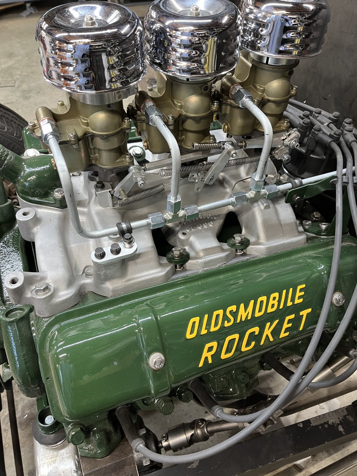

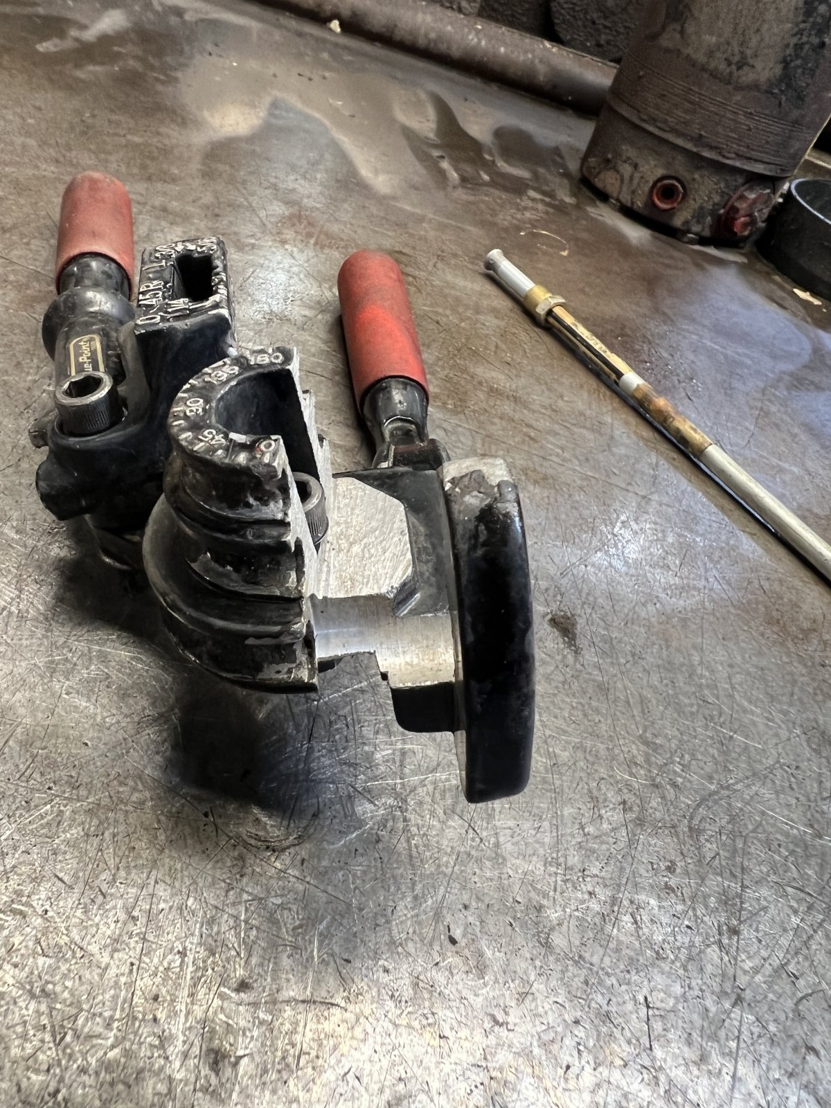

    I know I used it on a few trucks and some tractor stuff, I don’t recall it being difficult to use or making poor bends. I’ll look around for some old line and make a few bends. I just didn’t have anything close by when I grabbed it for a pic.
    Guess it’s been awhile since I used it, the top two rollers don’t roll anymore;)

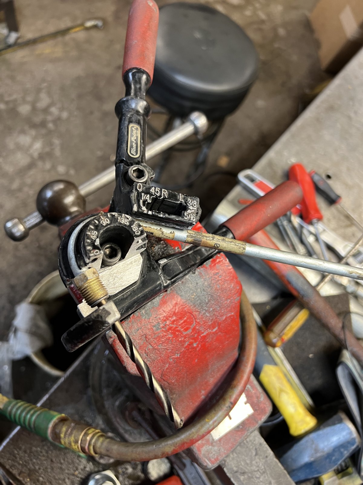

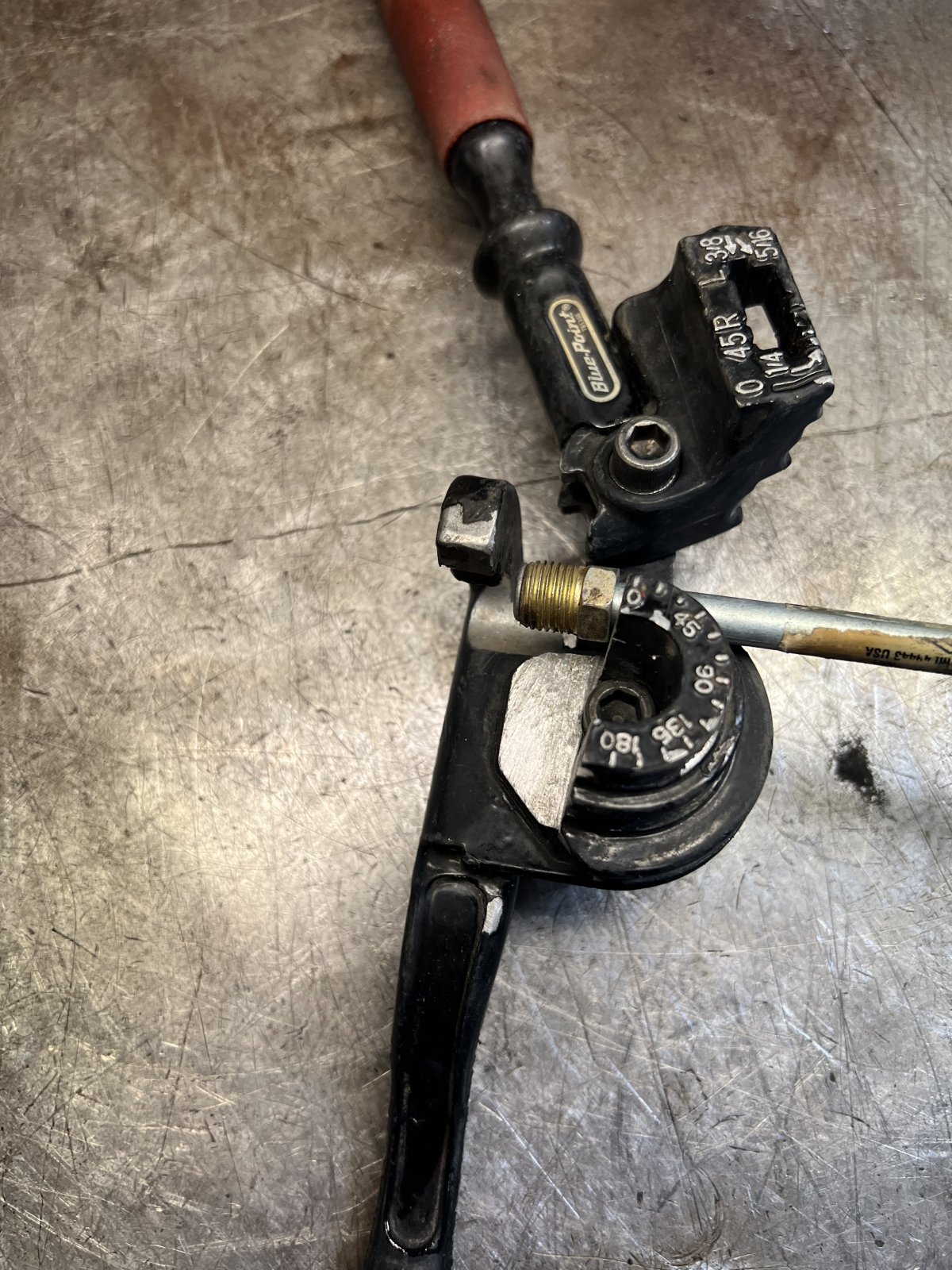

    Another trick some of you may want to do…
    I modified my bluepoint bender to bend at the nut also. A little cutting/clearancing, and an internal mandrel to rest against the tube stop. 6ED51159-827A-4212-927B-14B7A9A65ABF.jpeg 2F591477-C242-46B5-BE3D-B140CE2DCDB1.jpeg 30976669-D8A9-47DF-BF90-26548F009CCF.jpeg E0E4AEB7-9A32-444D-A294-CB5000FD1E73.jpeg

  14. TRENDZ
    Joined: Oct 16, 2018
    Posts: 386
    TRENDZ
    I sawed off a large chunk which worked for the smaller sizes, but I did need to use an end mill to make clearance for the 3/8 nuts.
