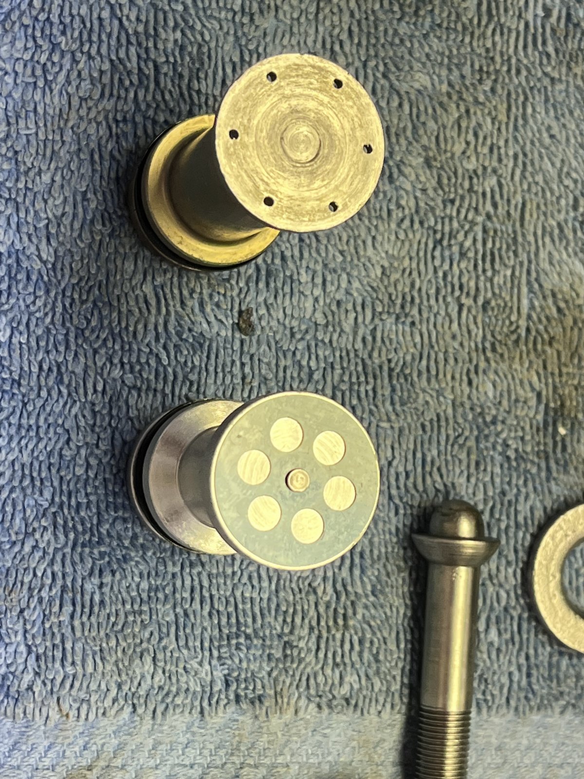

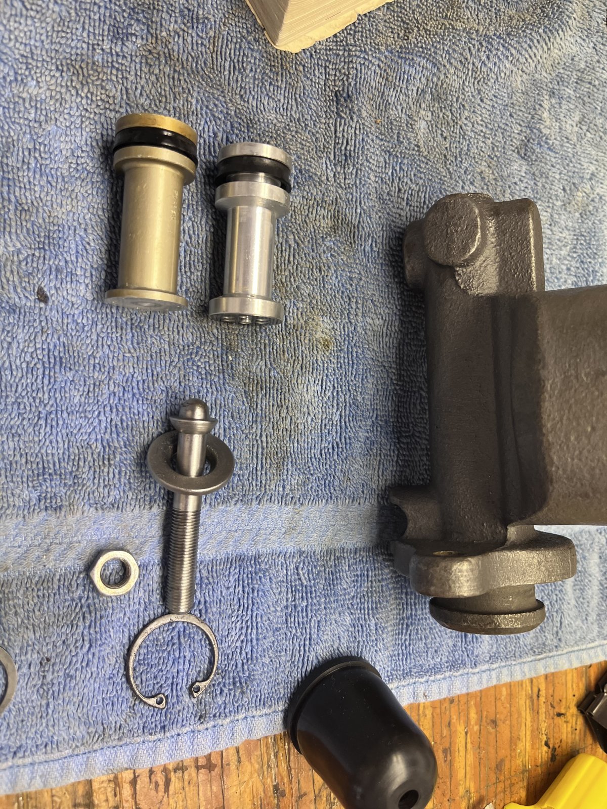

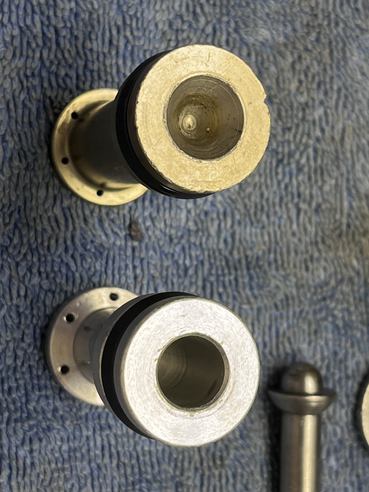

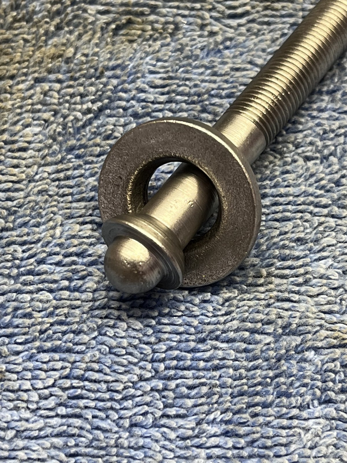

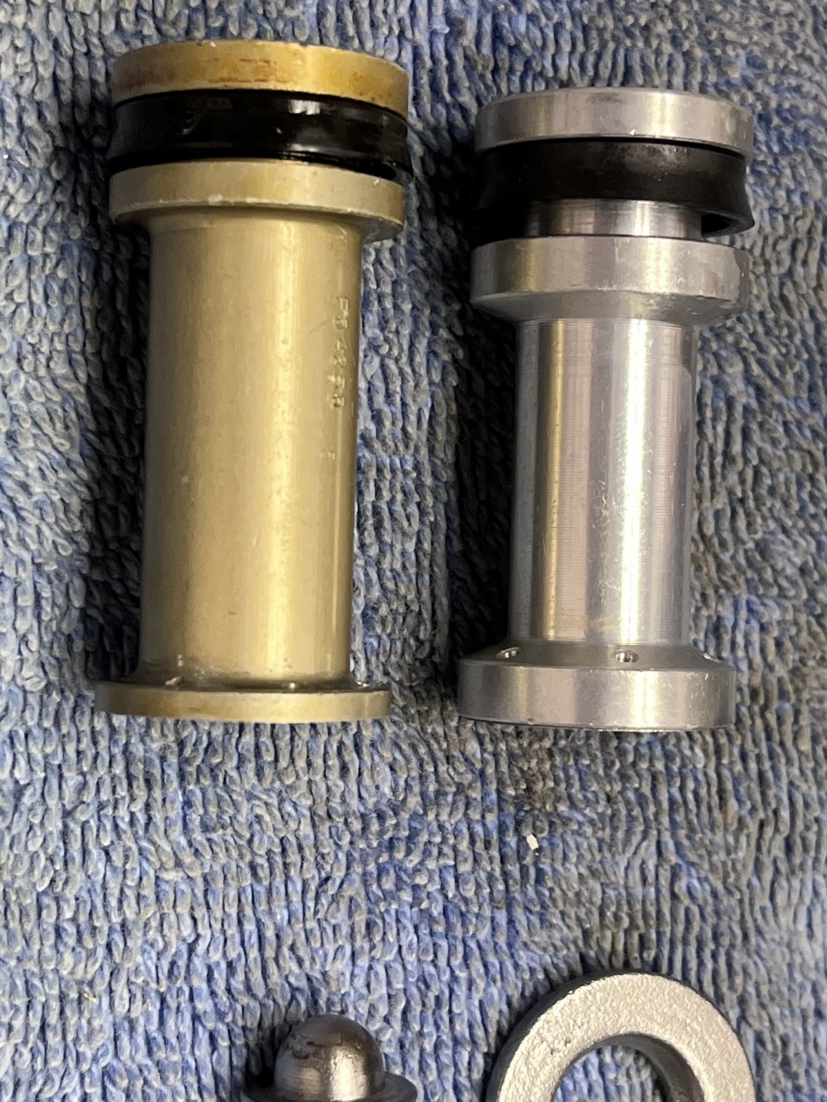

  14. MattK22
    Joined: Feb 17, 2017
    Posts: 24
    MattK22
    Both front hoses failing at the same time? I’m not betting on that either, but they will get replaced with new ones just because it’s the smart thing to do.
    All this advice is good. I added some pictures to help weed out anything suspect.
    Pulled the MC off this morning to see if anything was incorrect or mismatched comparing the factory guts to the kit guts. Right away I noticed the stop plate was flipped. That’s about 3/16” of displacement. So that should correct the hard pedal. I put it on that way when I installed the pushrod and plate assembly a few years ago. That’s on me for F’ing that up. Along with the general filth and the missing valve seat from the factory, it was a good decision rebuild it.
    Next I compared old and new parts.
    The new piston is 0.030” longer, it has a full length relief for a power brake rod and the piston ports have a check valve plate over them. Thin spring steel. So I gained 3/16” but lost 0.030”. And the push rod doesn’t seat in a ball and socket way. So the kit is wrong.
    It’s a Napa 234 (2029). Not correct for this application. So more research on that. It needs to be exactly the same. I don’t know why they’d add a check valve to the piston ports.
    On my car you can adjust the pedal height to whatever is comfortable as long as the piston hits the stop plate and the pedal is not hitting the bracket preventing the pistons to full return position.
    Thanks again for all the great info. I learned a lot more than I bargained for.
    For all of you that we’re betting on the push rod as the culprit, you win.
