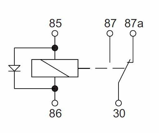

    Kerrynzl
    Just add one of those "noisy" flow through Facet fuel pumps to prime the engine [approx $20]
    Wire it to a relay connected from the fuse box on the secondary side
    The primary side of the relay is also from the fuse box [or ignition] but ground it via the oil pressure light sender.
    As soon as the engine starts [with oil pressure] the pump switches off, and the mechanical pump can draw fuel through it.
    I did this on my 57 Chevy and after parking it for 18 months it started within a minute of priming.
    Connect it like this
    Terminal # 30 to a switched output on the fuse box
    Terminal # 87 to the Facet fuel pump
    Terminal # 86 is Bridged over to Terminal # 30
    Terminal # 85 to oil pressure sender [ground]
    Terminal # 87A [optional] to electric choke
    :Terminal # 30 and # 86 is dead until the ignition is switched on [the whole relay is dead]
    :The fuel pump is only priming with the ignition on until the engine starts
    :If an electric choke is used, it doesn't cycle until the engine is running
    :Terminal # 85 should be used for ground because a lot of relays are diode protected [ shown] I try to make this a good practice
    This also gives the starter motor and battery a fighting chance of survival
