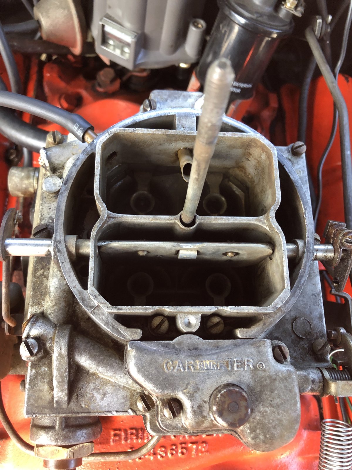

  8. Eth727
    Joined: Jun 20, 2024
    Posts: 310
    Eth727
    This is where the auto choke and choke valve ? are currently at.
  9. 05snopro440
    Joined: Mar 15, 2011
    Posts: 2,955
    05snopro440
    I don't think that tells us anything. Is that with the engine cold? What happens to the choke when you touch the pedal and/or crank it?
  10. Eth727
    Posts: 310
    Eth727
    Yeah that’s it cold. I don’t know anything about these carbs. So when I start it cold or hot, I’d my foot supposed to be on the gas but not pumping it? Once it starts then let it off?
