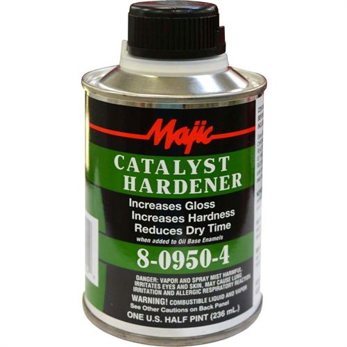

    34536.jpg I bought this at the local hardware store.
    Elcohaulic and D-Russ like this.

  11. lostone
    Joined: Oct 13, 2013
    Posts: 3,901
    lostone
    from kansas
    Managing a body shop I've seen some of these concoctions end badly.
    I've had customer's come in who have brewed up paint only to have it start peeling within a couple months. Alot I've seen have large checks and cracks show up in a few months due to incompatible products so be sure to read instructions and check for compatibility.
    rpm56 and AGELE55 like this.
  12. Valentines Speed Shop
    Joined: Jan 1, 2009
    Posts: 160
    from Boxiron,MD
    I used both Valspar and Manic. Honestly I believe them to be the same.
    8 oz per gallon. Acetone to thin to desired consistency.
    Holding up good So far! 2 plus years.
    Oil based paint is very forgiving compared to modern automotive paints.
    Not as shinny but I like my old cars to look like old cars ;)
    Randall, Packrat, D-Russ and 2 others like this.
  13. Valentines Speed Shop
    Joined: Jan 1, 2009
    Posts: 160
    from Boxiron,MD
    *Majic stupid auto correct

    Here's the Valspar hardener
    D-Russ, AGELE55 and brEad like this.
