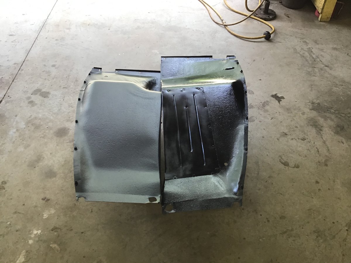

    I finally got a chance to shoot a practice panel using flat Rustoleum thinned with mineral spirits and catalyst hardener. I shot the wheel well side of my inner fender. It was pretty corroded, so I placed it in a citric acid bath for 4 days which removed all corrosion. It still has surface pitting, but I can live with that in the wheel well. I painted it first with Rustoleum primer for rusty metal (heavy coat) using a brush and let it dry for a few 9846C4F9-4607-46EF-8E62-1A7DDDFDD2AA.jpeg 29D67C9F-B6F7-44A4-B049-1344328896AB.jpeg weeks.
    As suspected, the hardener added a sheen to the flat paint, which I would rank as a satin finish. I like the finish. I think I will likely go with it on the engine bay side with of course better prep. The wheel well side will now get under coated.
    I think I’ll do the other panel using the same mix, but starting with Rustoleum Satin Finish paint. My guess is it will move it up to a semi gloss look. More to follow folks....

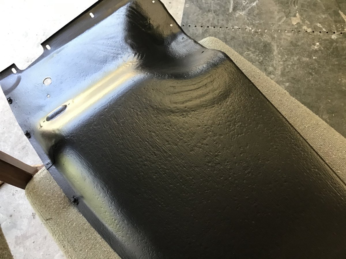

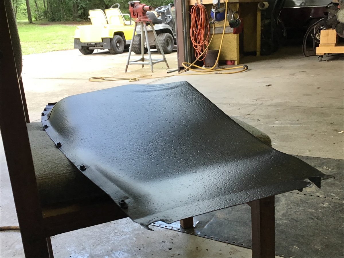

    And now the satin with hardener went up to being (my humble opinion) between semi gloss & gloss. Hard to capture it in the pics. Also got a little negative reaction on my filler panel , which had a different primer and honestly not properly cured first...
    All in all, I like the concept for frame, inner fenders, etc. If you want to shoot as a top coat, I could see that happening as well, but would use precise measurements for repeatability. HAMB member Valentines Speed Shop , mentioned using Behr Oil based Paint From Home Depot available in hundreds of colors. So flat Behr in the color of your choice with a little hardener equals a satin rat. 455FA686-94A2-4C54-9904-6C804145991D.jpeg

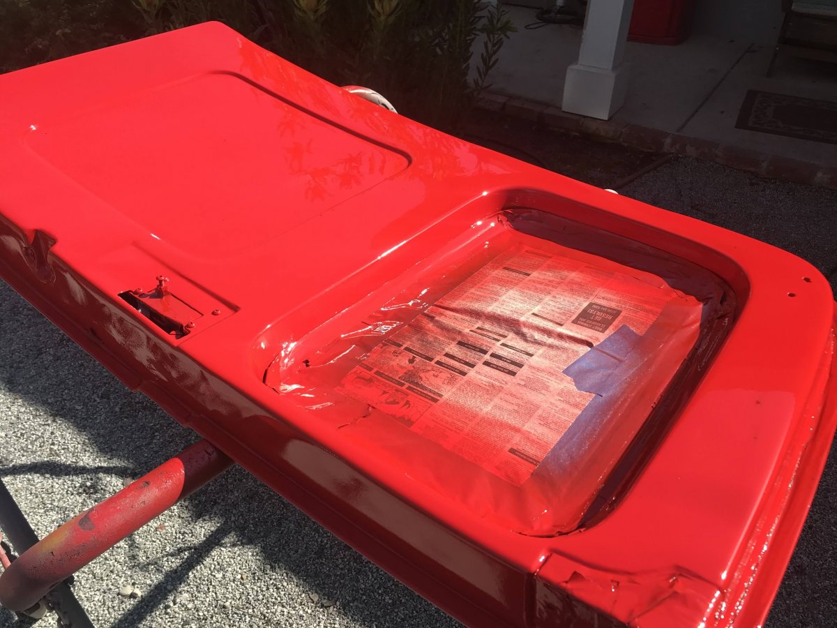

    Here is the inside of some panel doors I shot with Rustoleum gloss thinned with acetone and some Valspar hardner. Pardon the dust, a breeze kick up right after the last coat. Nice glossy, hard finish.

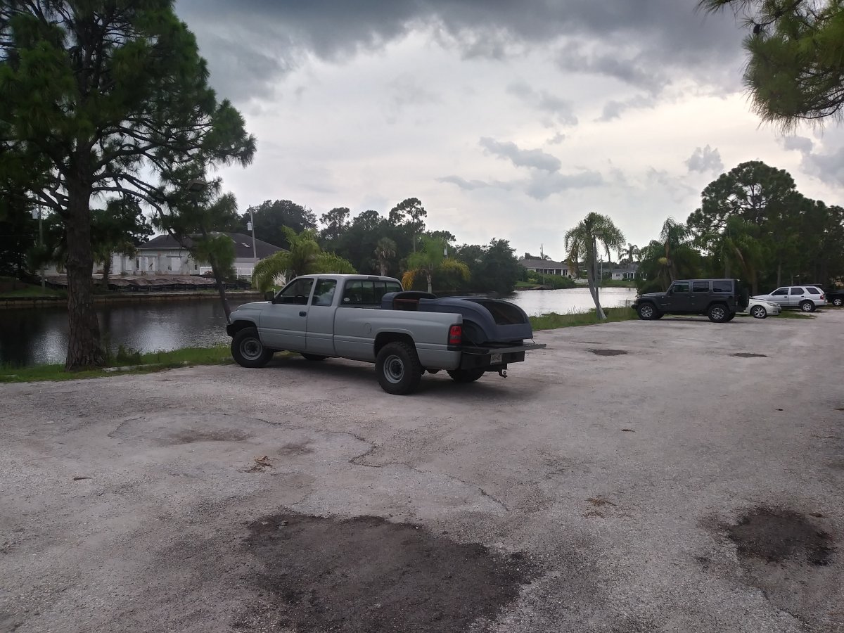

    Here is my beater parts getter truck that I painted with Behr semi gloss and hardener. Just to give you an idea of the sheen. (Maybe it won't get taken down with the 32 roadster in the bed :rolleyes:) 20200608_172956_HDR.jpg

    Here is my beater parts getter truck that I painted with Behr semi gloss and hardener. Just to give you an idea of the sheen. (Maybe it won't get taken down with the 32 roadster in the bed :rolleyes:) View attachment 4717540 [/QUOTE]
    Palm trees in Maryland?
    Good catch Agele55! LoL I picked the body up in Florida from a fellow Hamber and had to snap a picture with the palms.
    Although there is a tropical style bar near me in Ocean City, Maryland that brings in palms every summer ;)

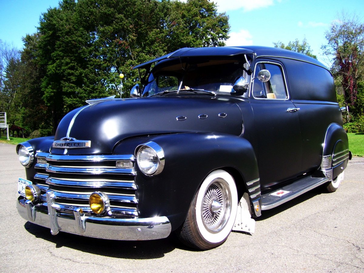

    Painted my last 2 rod with it: Semi flat black/ acetone/hardner. paint1.jpg paint2.jpg

    Nice cars and digging the finish.

    They both look really good.
