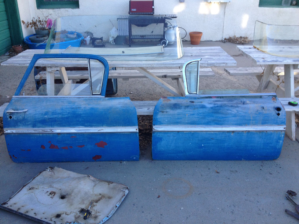

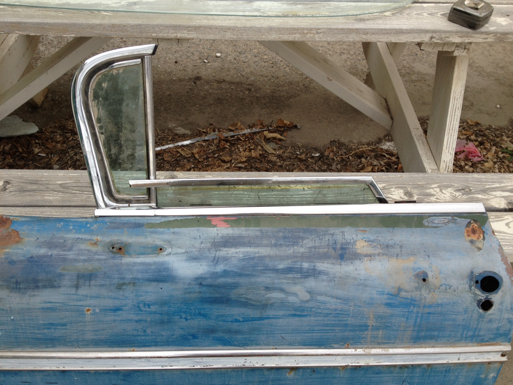

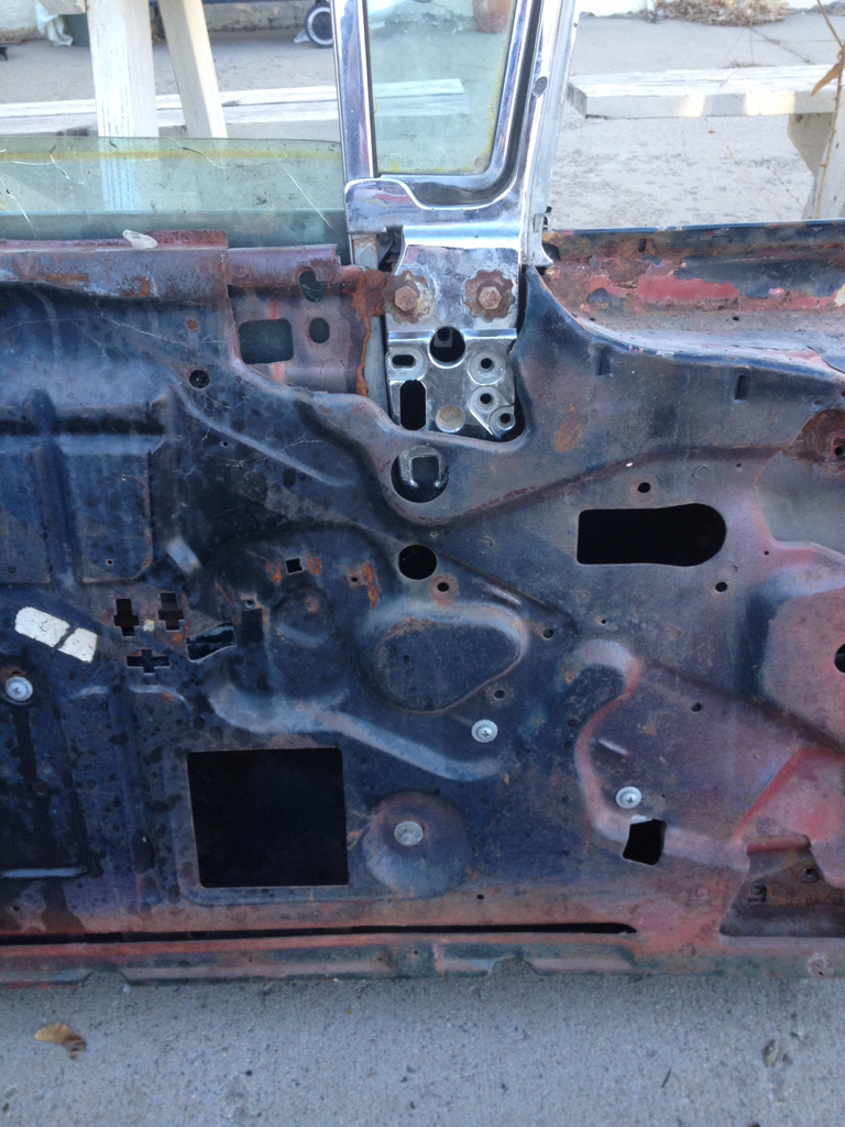

    One stock elcamino door and one modified hardtop elcamino door.

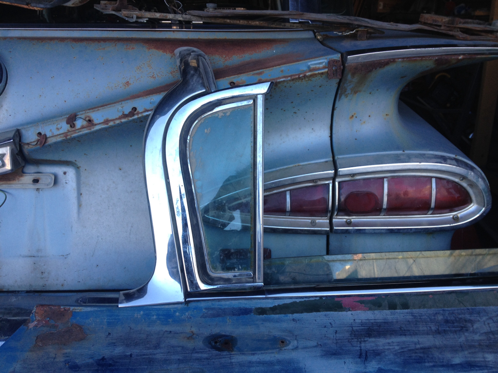

    Hardtop wing windows with the convertible trim.

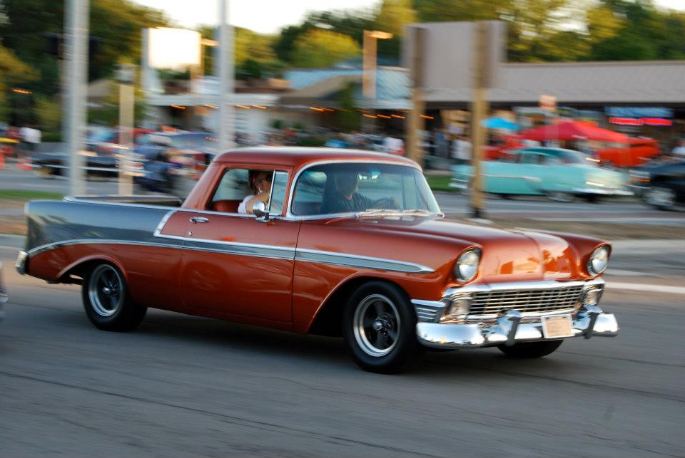

    Did my own design on my current 56 ElCamino from a 210 Wagon. Nicest compliments are the ones that say it looks factory. I have driven it to Detroit for Woodward the last few years and it gets it's fair share of head scratching and people who think it was a long lost GM concept design.
    http://www.jalopyjournal.com/forum/threads/some-pics-of-my-friends-1956-elcamino.399170/
    After checking a ton of ideas others had done, I found the rear window area is where a lot of these builds loose it and do not flow well with the design. Like you I collected and tried a lot of extra parts, built some toy models and came up with a design of what I thought the car might look like if it had been built in 56.
    I am also now doing something similar with a mid 60's Malibu 4dr Wagon that I have turned into a 2dr Nomad with a little Tri-5 Nomad inspiration.

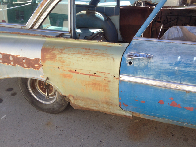

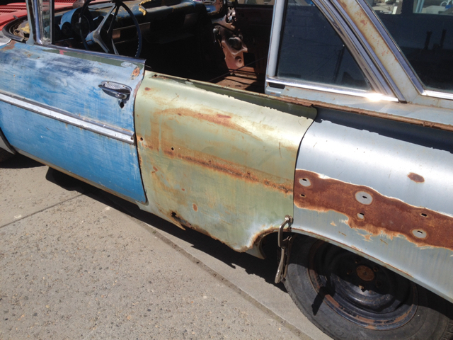

    Does anyone know what the measurement for a 2-door hardtop piece of door gl*** is? I'm try to get the door gl*** frame built and I'm unsure what the length is. Thanks.

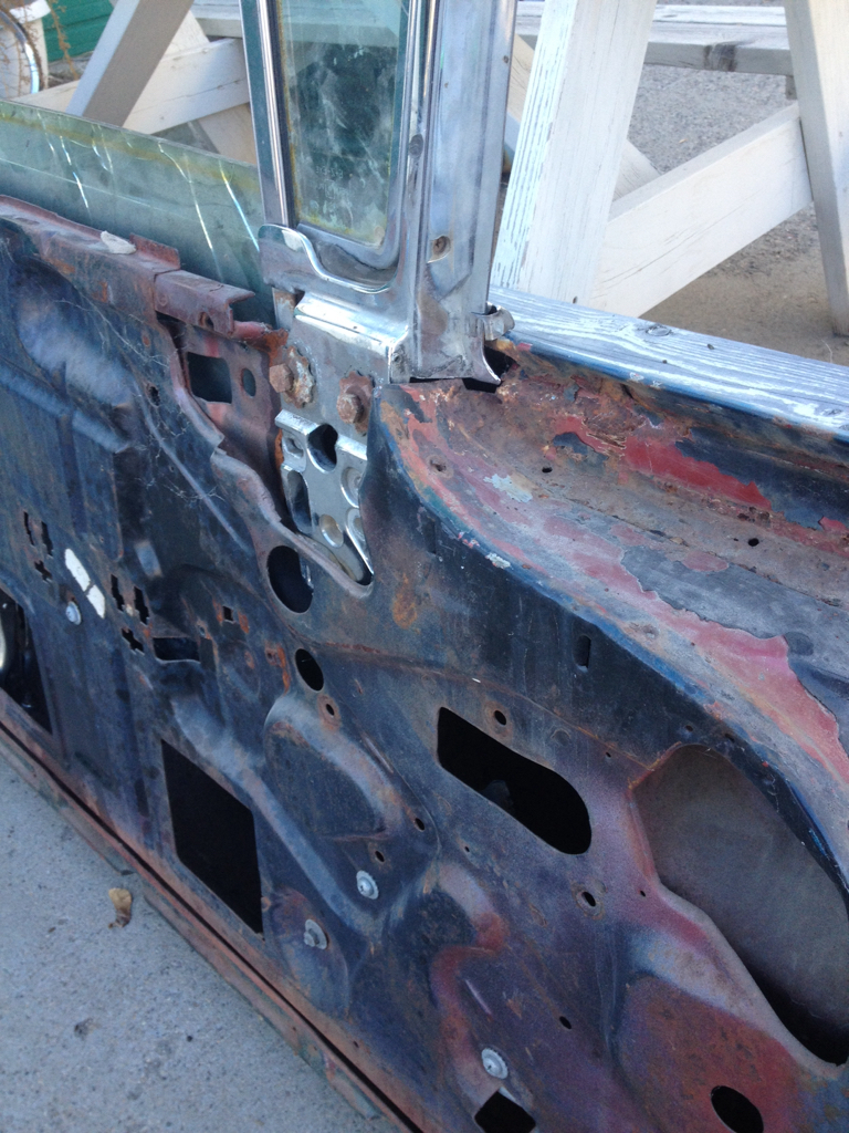

    What did you have to modify to fit the hardtop vent windows to the El Camino doors? Love the project btw

    I have a pair of 60 Pontiac hard top doors I'm using for the swap. I removed the door tops and the window channel. Cut out and welded in the sheet metal that the hard top window channel mounts to. The lower mount is already stamped in the door. Cut out the wing window mounting so the hard top wing window will mount. Still have to install the inner brace that stops the window from rolling up to far. Hardest part was getting the door top off.

    just wondering, are you trying do decide which way to go? it looks like the drivers door is off a hard top and the El Co door on the p***engers side.
    i'd vote for the hard top, if there was a poll

    I'm going hardtop. I haven't modified the p***enger side door yet. I'm trying to get the midsection trimmed and in. So I needed doors in to get them latched for placement.
