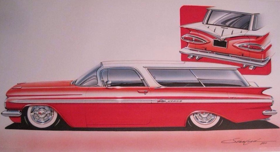

    I Really like Steve Stanford's 59 nomad drawing. That thing is killer!!

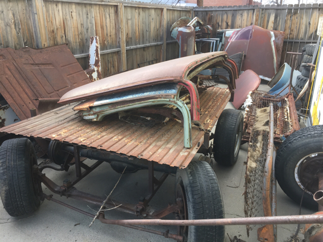

  23. Kustomkid
    Joined: Nov 21, 2010
    Posts: 531
    Kustomkid
    from Montana
    Still working on the car, its just going slow due to winter, but getting ready to get the body switched on to the new frame.

    I got the roof sections dug out today. ImageUploadedByH.A.M.B.1454787034.518828.jpg ImageUploadedByH.A.M.B.1454787048.402103.jpg

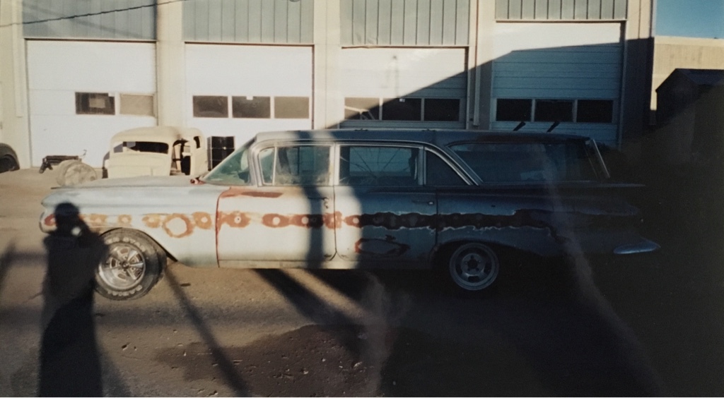

    Just found this. This is when I got the car in 96. Had been flooded and sitting in the mud all the way up to the floorboards. ImageUploadedByH.A.M.B.1460216898.636418.jpg

  27. So was the El Camino you started with just too far gone and easier to swap the parts to the wagon? It must been really, really bad if a wagon sitting in mud up to the floor boards was in better shape. ;)

  29. Kustomkid
    Posts: 531
    Kustomkid
    from Montana
    All the elcaminos I have had over the years were badly rusted out. It took 8 of them to find a tailgate that wasn't rusted out. The wagon is rusty on the front floor boards but the rockets and structure seems to be solid. The frame is shot. The front and rear drums are locked on. I had to torch the centers to get the wheels to turn once I got it home. The tow truck driver wasn't very happy with picking it up. But it's a better starting point than the elcamino.
    I hadn't planned on selling the wagon when I got it, but my dad wasn't happy with all the 59's and Mercury's floating around Ravon so something had to go!
