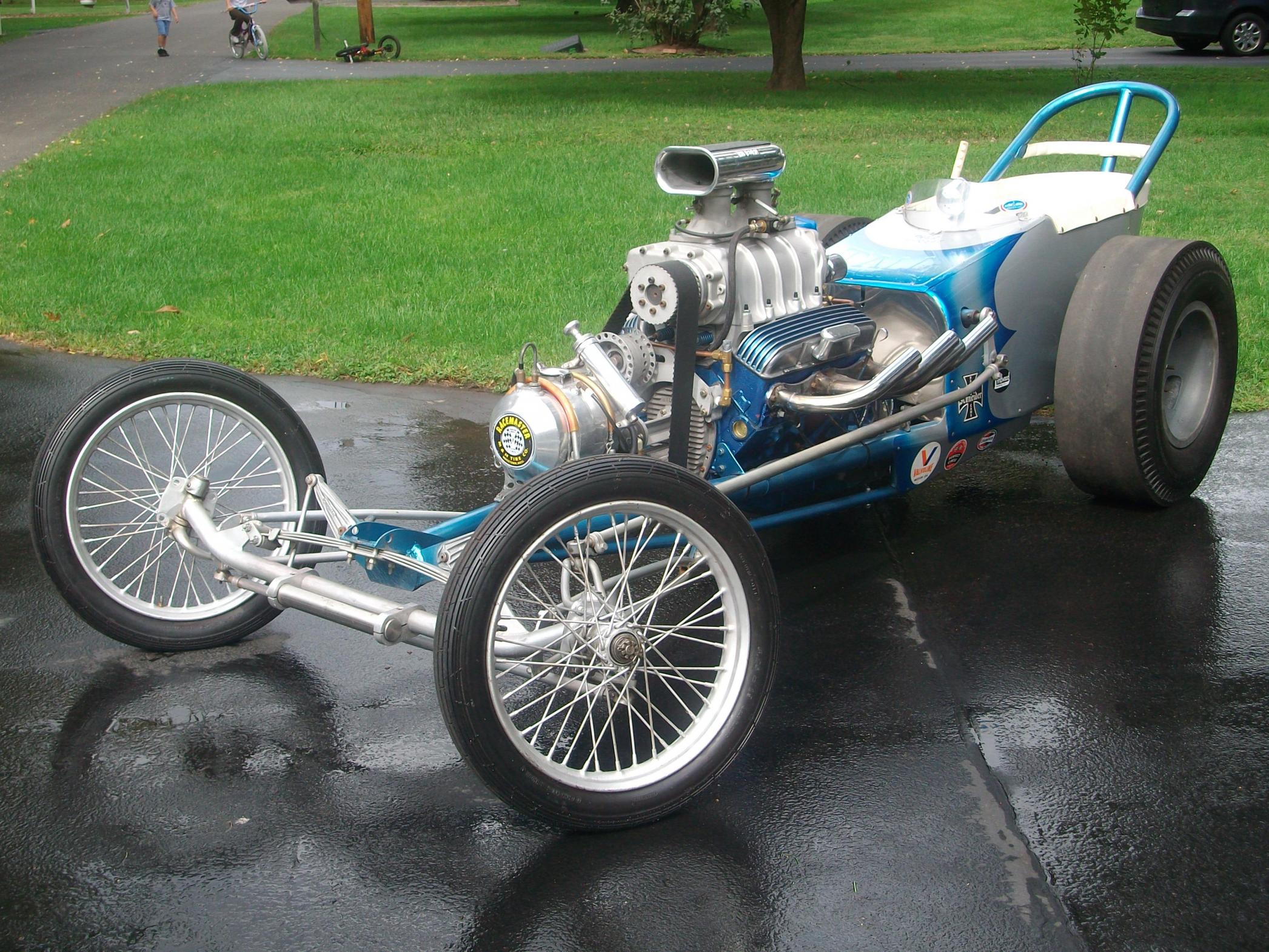

  18. The37Kid
    Joined: Apr 30, 2004
    Posts: 32,674
    The37Kid
    The Lyndwood rail I'm restoring has Harley wheels on 1939-40 Ford spindles. I've been told they were early 1930'd Harley VL side car wheels. They take stock Ford bearings.

    I took my Lyndwood dragster front wheels apart today to re-grease & inspec them, last time I did them was 1991 and the last time before that was 1964! these wheels are made from 1933-34 harley davidson VL hubs with 40 spoke 19" rims runnng 3.25 X 19" tires. this was what was run in the 1950's til the early 1960's on short wheel base dragsters & altereds till aftermarket companies like moon & crietz started making drag race specific spoke wheels (which ended up being shorted & skinnier for weight reductions & looks). These wheels & Timken bearings are the original wheels that were installed on my rail at the lyndwood plant in 1959. The Lyndwood rails used Ford 1942-49 square back spindles. You don't need to make spacers or fancy adapters to run them on the spindles the VL hubs need to be clearanced (opened up a few thousand's)) for the press fit race's.
    Inner Bearing - Timken #08118 with corresponding outer race<?xml:namespace prefix = o ns = "urn:schemas-microsoft-com:eek:ffice:eek:ffice" /><o:p></o:p>
    *The I.D. of my hub at the top of the pressed in race was 2.312+"<o:p></o:p>
    Outer Bearing - Timken #1775 with corresponding outer race<o:p></o:p>
    * The I.D. of my hub at the top of the pressed in race was 2.239+"
    Hope this helps you guys out?
    Paul
    * I have blue prints/measured plans on CD made off of my rail for people wishing to re-create an old style short wheel base rail, PM me if your interested.
    Paul

  28. There is an interview floating around about the Harley wheels that Pat Bilbow used on his dragsters. As the story goes, Joe Jacona found a stash of the wheels in Philly, but they required an adapter to fit the early Ford spindles. Joe had a machine shop in Philly make a bunch of the adaptors, and sold and/or swapped them to Pat for several years.
    My point is, the Harley wheels on Shadow's (Paul) and Bob's cars would not have fit without the adaptors Jacono had made.
  29. the shadow
    Joined: Mar 5, 2005
    Posts: 1,105
    the shadow
    true story, yes! but my spindles have no adapters just the tapered bearings. I believe Joe adapted the harley VL bearings to the ford spindle and Pat decided to for go that route and figur eout what tapered bearings he neded to make it work. bill Ott (badco on the hamb) wrote the story on the draglist.
    Paul
