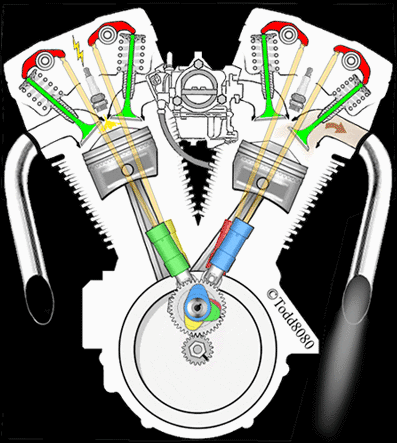

  28. You have to remember that this a a 45° V Twin with a Single crankpin. The connecting rods are knife and fork, they rotate around each other on a common bearing! This doesn't show the wasted spark occurring, but you can see how the motor operates and see when it would happen.
  29. That's an accurate description... One reason Harley 'single fire' ignitions are popular is it does improve idle quality, as that 'wasted spark' at the rear cylinder does occasionally cause a backfire when tipping in more throttle and sometimes kills the motor. If you've ever heard a Harley sneeze and then die when given throttle, this is why.
    As to the timing, the ignition rotor is ran at camshaft speed (1/2 crankshaft) and has two cutouts (for electronic ignition) that the pickups sense. They are not 180 degrees apart, but are offset by 45 degrees to account for the uneven firing. I would assume that the early points ignitions had two points lobes similarly offset.
