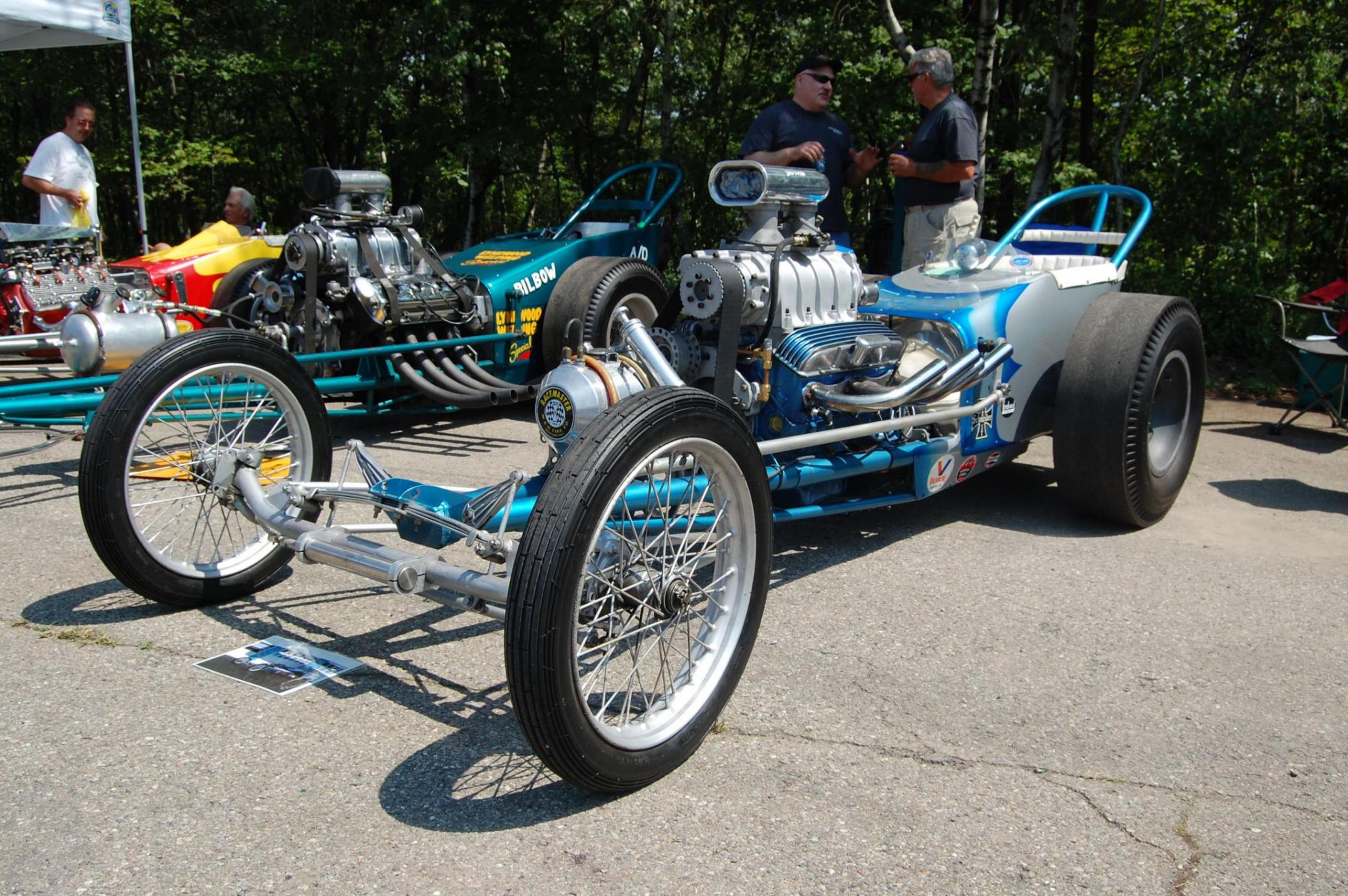

    Can i use front wheels from a Harley Davidson i my front engine dragster?
    If it`s posible,how fast can you drive with it?
  2. Dont think you will find a set of Harleys that will fit an automotive spindle...
    We used to machine an Aluminium hub and respoke them using the cycle rims and spokes
  3. the shadow
    Joined: Mar 5, 2005
    Posts: 1,105
    the shadow
    Yes, you can use early harley davidson VL hubs(1933-'34). the hubs will need to be machined a little on the inside (just a few thousands) to accept the races. common set ups were the VL hubs with 19" rims & 3.25 X 19 tires on a ford spindle. Lyndwood Welding used this set up on there eliminator front engine dragsters in the late 50's & into the 60's till smaller/lighter after market hubs & rims became available. Pm me and I can send you the timken bearing numbers you will need to adapt the hubs to a early ford spindle ('37-'48) + pics if you need them.

  4. Look at Kerrys digger. He modified some Jap wheels and they look good.
