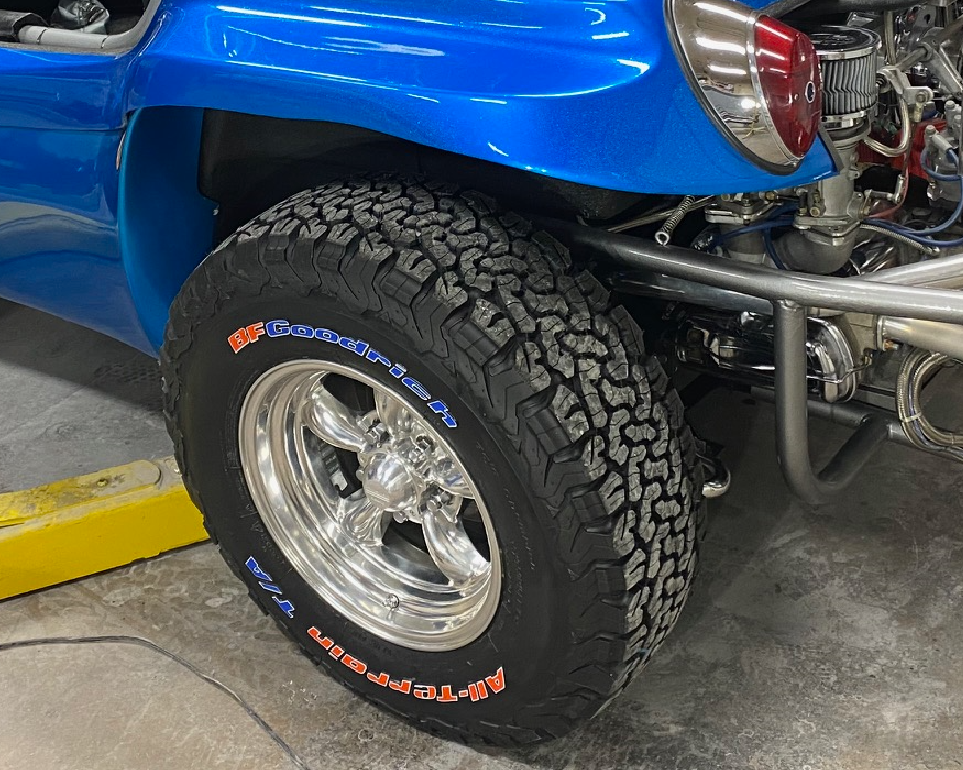

    I have tried the lettering pens and stickers but never the brush and one shot like @Joe Blow suggested but I would think that would give the best results. I did not like the letter pens as the coverage was not uniform and they didn't wear well. I have used stickers a couple of time and they seem to work very well. You can order them to fit the font and size of your letters so you can apply them over the top.
    I did that on my OT dune buggy. I mounted T/A All Terrains black wall out
    and glued the Red/White/Blue stickers over the existing letters to give it a new look. Just another idea.
    And I have ordered the stickers in a reverse cut so the black is on top for a vintage look on not so vintage American Cl***ic tires.

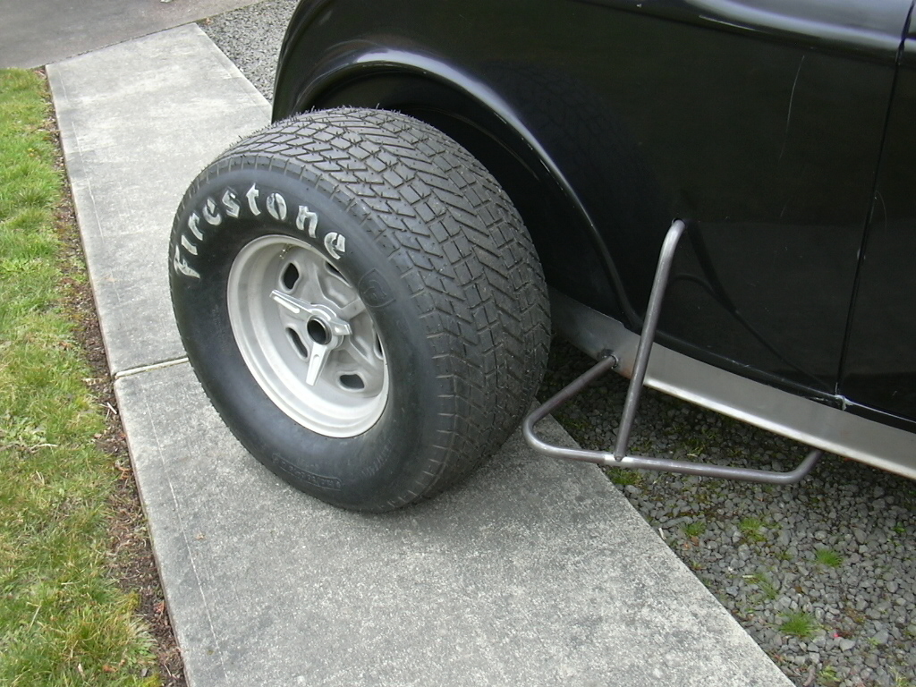

    Pete had his painted.
