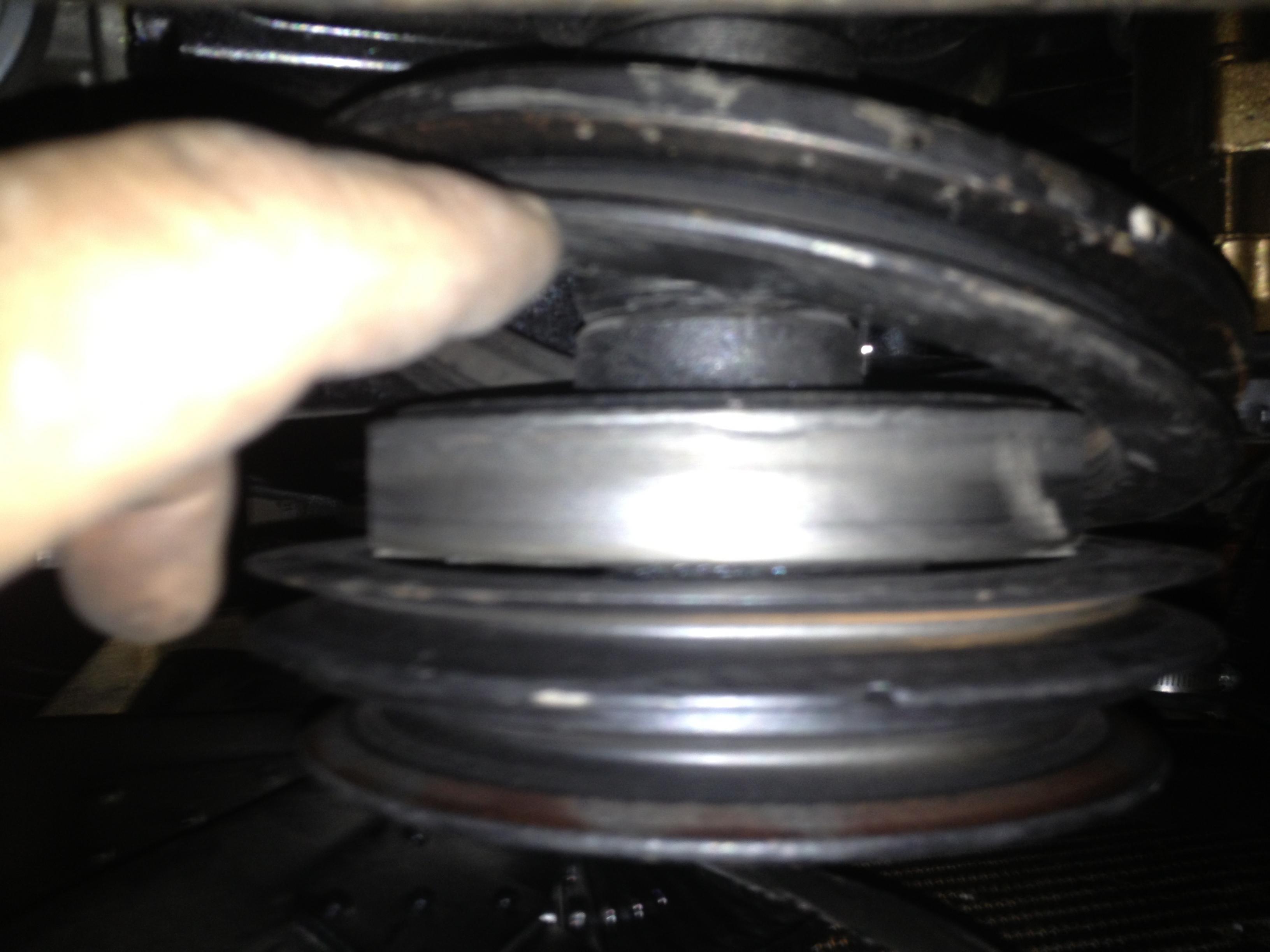

    Here is a picture of the one balancer that broke

    I see two different size pulleys on the dampener.
    If you're running two belts to a two groove pulley with the same diameter, the belts will fight eachother causing a lot of heat and friction

    The smaller pulley on the crank is the steering pump the one in the back is for the alternator the one in the middle is the ac but I currently have the compression off. If you look at the water pump pulley the one on the alternator is smaller and the one for the steering is bigger. Ford placed them in a stagered pattern but if you take the 2 circumference top and bottom of both add them up they equil the same side to side

    I just put on a gates 7400 ran it to the gas station n back n smelled rubber burning sure as shit tossed this balancer too. I went took off the belt had my buddy fire it up I watched the crank pulley and its as true as true gets to the eye had hom shut it down. then took a dial indicator n it never moved until I got to the timing mark bump the crank for sure isn't bent
