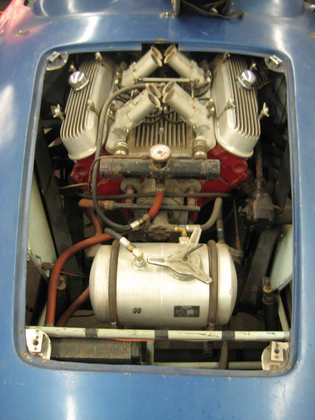

    Very cool!
    those blowers make maybe 7 pounds of boost just put corn free premium in it and see what you’ve got. The front pulley -stock- is a variable diameter and as the motor gains revs it increases boost. Pretty neat stuff. The carbs will be boost referenced as well. Might be as simple as a hardline from the mech fuel pump to the charge pipe.
    it’s all pretty simple and there are tons of threads about them. That car is cool as hell, thanks for sharing
    edit: poor signal today the photos finaly
    Finished loading. That looks like the pulley has been replaced with a plain pulley and the pulley
    Clutch ***embly removed. So it’s just like getting boost from any other super charger.
    cars like that probably have a binder around with info or a notebook. Find his user name and we can start the treasure hunt for info
