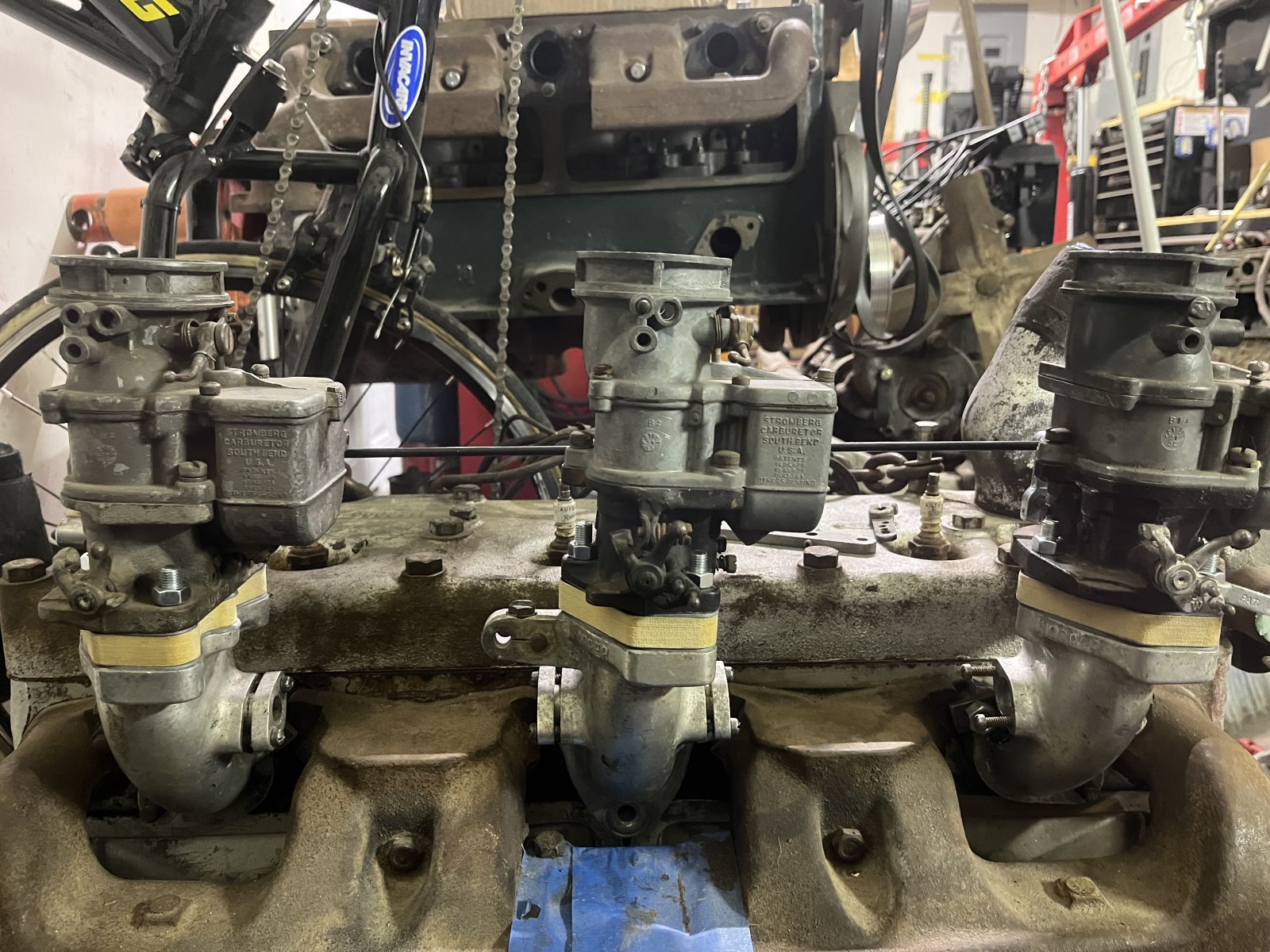

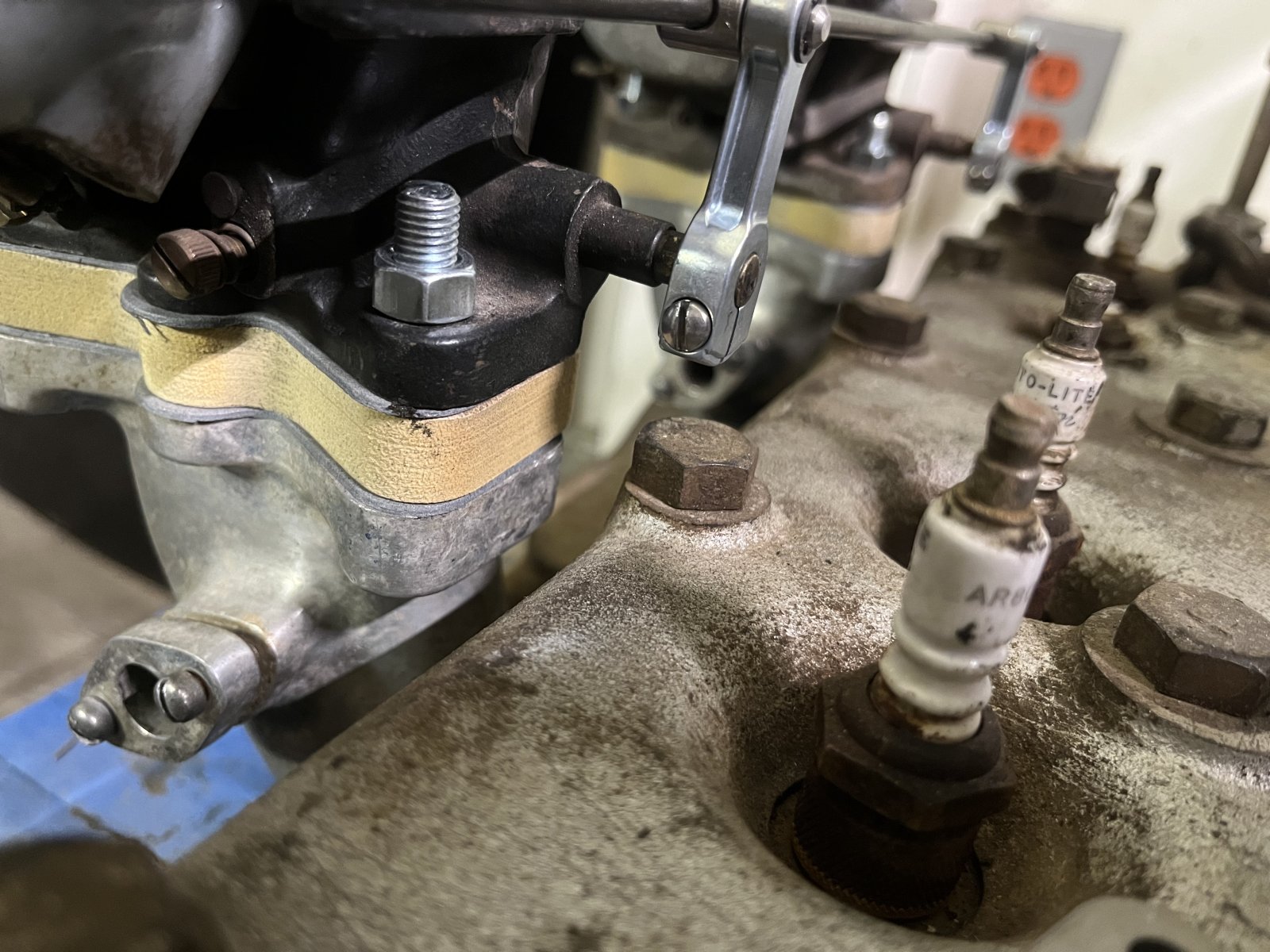

  21. Borrowed 3 core 97s from a buddy, set them on the intakes — looks cool as hell, but the first issue came swiftly— the throttle shafts are too close to the head bolts to put the Stromberg linkage arms on.
    the br*** Harper arms would have had to be very skinny on the bottom.
    I’m thinking 1/2” spacers - maybe phenolic, maybe aluminum IMG_1068.jpeg IMG_1069.jpeg IMG_1070.jpeg

    Will 1/2" spacers be enough?
  23. we'll see !
    I went ahead and ordered (3) 1/2" phenolic spacers with studs, nuts, and gaskets from Dashman on Ebay.
    Six Ball likes this.

  25. Finally got the new studs in, 1/2” spacers on, and one piece of solid linkage mocked up.
    next thing is to get the factory linkage on the head, and then start figuring out how to get the center carb to engage the factory parts

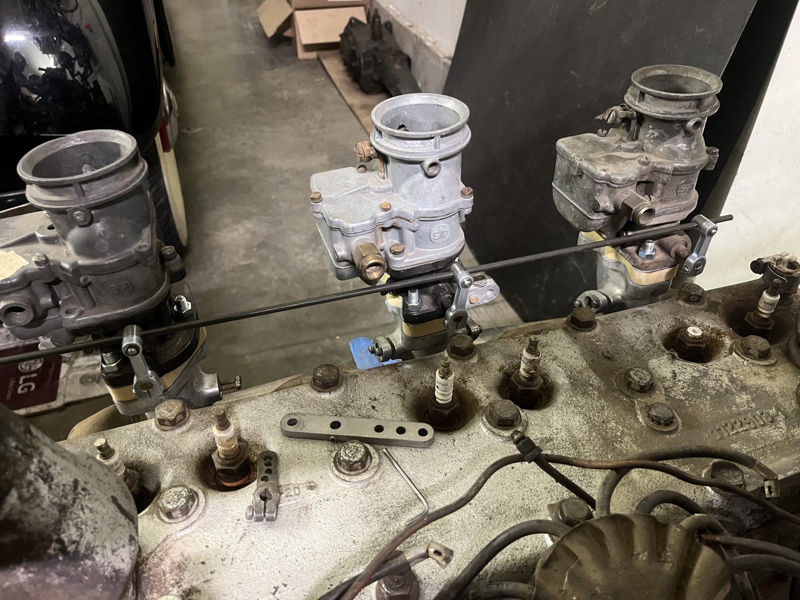

  27. I have definitely been slacking on this project !
    I finally dug up stock linkage parts and set them in place.
    Time to start thinking about the first bell crank to get the engine mounted linkage to start acting on the carbs. The primary side will be the original throttle linkage side IMG_1466.jpeg
    Six Ball and Budget36 like this.

    Fun to see you figuring this out. The stock linkage just adds to the total package.
