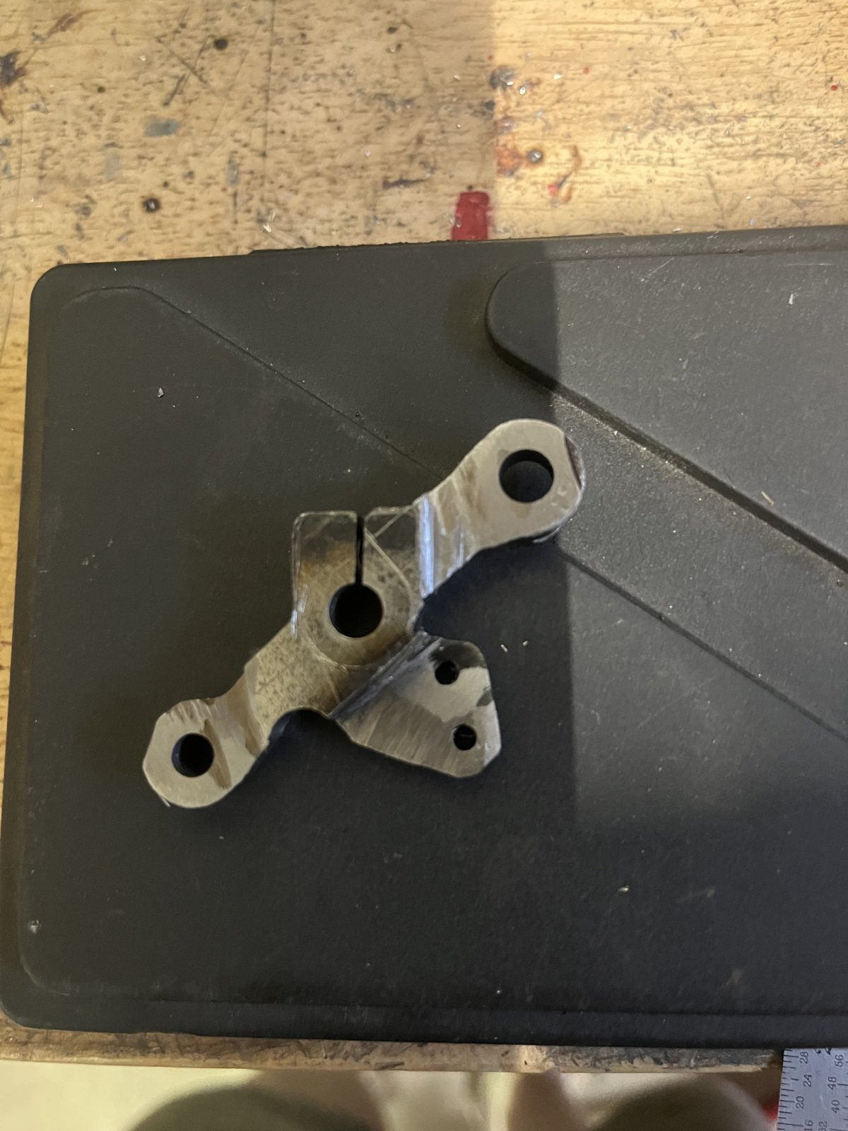

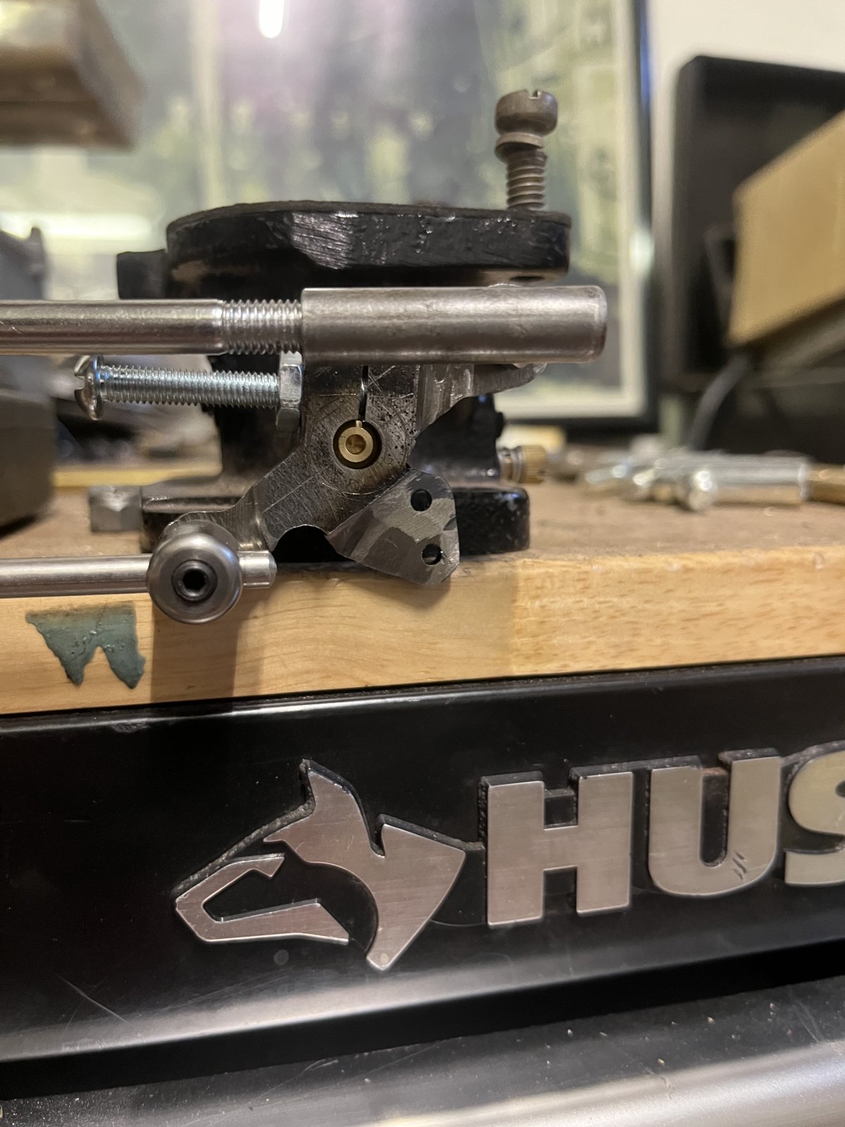

  5. Roughed in the first linkage arm

    Basically the primaries (first set of linkage) would be just straight but only opening 1/2 of each carb. The secondaries would also be all 3 the same with just the ratio to come on later and then fully open quicker. It is progressive linkage running different sides of 3 carbs instead of running 3 different carbs. It just looks so cool!
  7. you make it sound so simple !
    what I'm hoping for is to create one linkage arm casting that I can cut down for all the positions... the primary side all 3 need the accelerator pump link balls, while the secondary side don't. both sides center carb will need center engaging, while the other four don't
    really though, it's the center progressive that I'm most concerned about trying to figure out

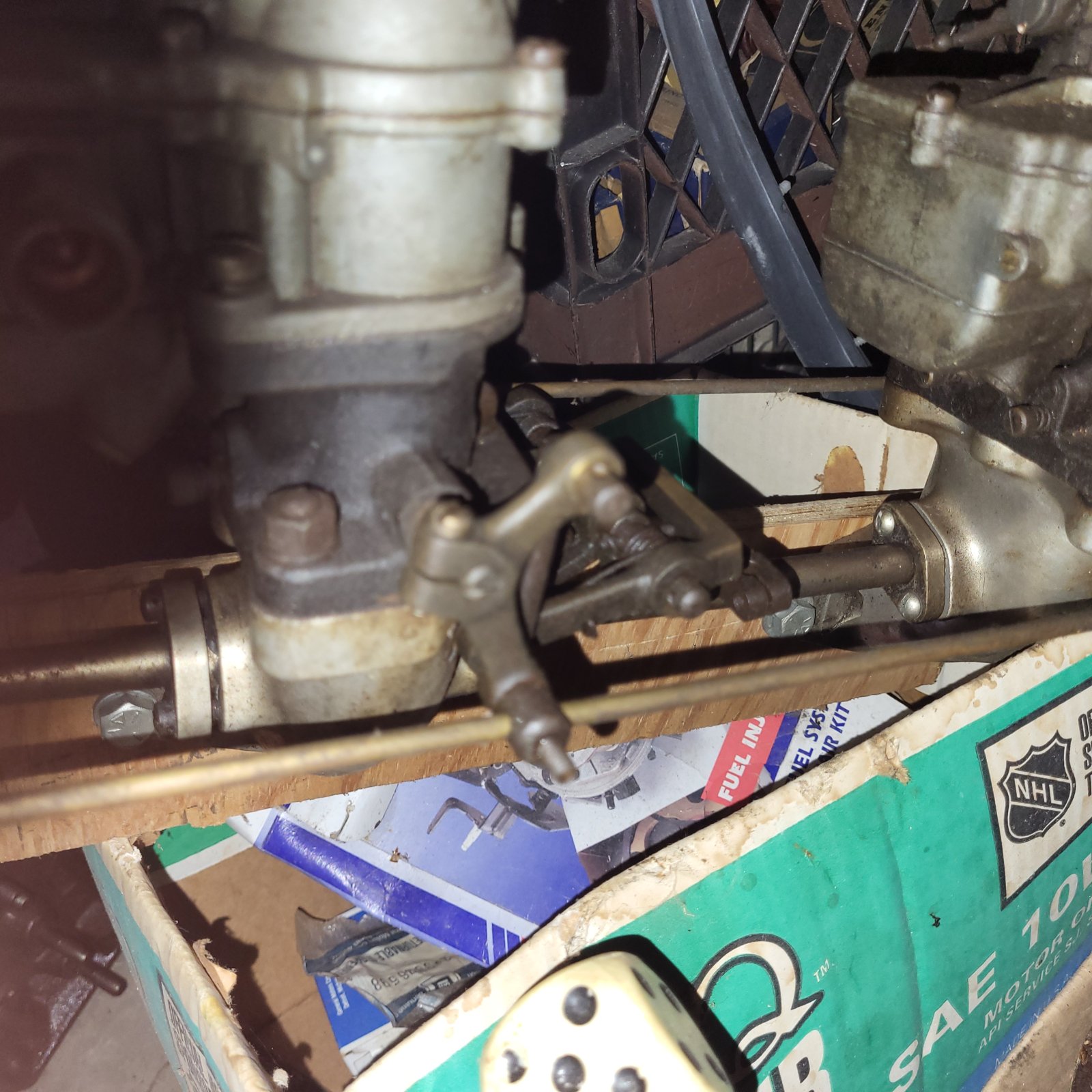

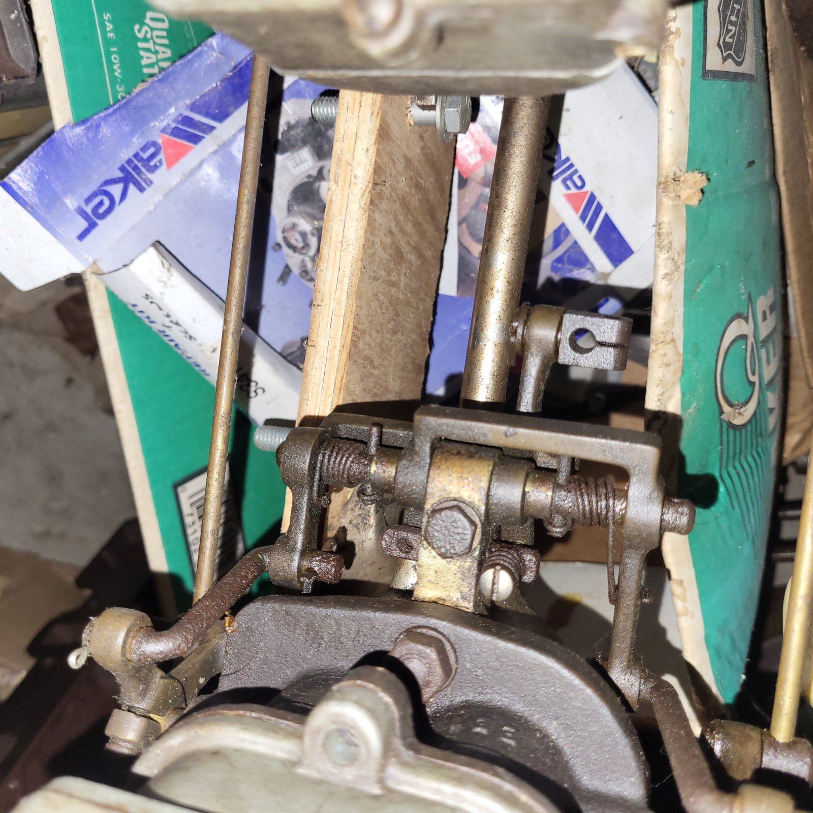

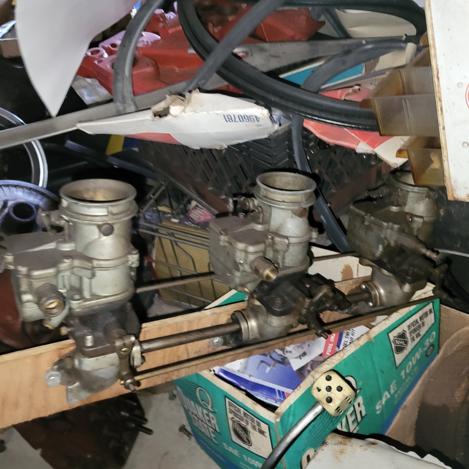

    3281149-9819537dea98b81198ef8ade2104e194.jpg 3281151-ce122b8692b2e5b042e400f692ee0e5e.jpg 3281152-8f88dd0dc6a0b970dcf53417cb4b65f6.jpg 3281154-e9e8eb3b69c3b805180d22cc69c01089.jpg 3281155-54e36d348e9f2b846b4935f4ca21c25f.jpg 3281153-9f3b2736c3abc70c0b20752eb45e65ac.jpg 3281158-a9ae1ef2e30fff1ed362f5bae374b575.jpg 3281156-9a17baa0c1bcfa6cc8d734712265ff0d.jpg 3281159-c04e2d1154f3e564a4d2bef608b101a4.jpg

    Nice pictures of the most complicated part. The linkage on the center carb is the brains of the outfit.

    For anyone who cares, the carbs have #43 jets on the primary side, and #45s on the secondary side.

  20. in the third pic - it looks like the "upper" "U" shaped piece runs the secondary side, and the "lower" "U" runs the primary side ? --- the pins through the axle, that the torsion springs are hooked around -- is that what engages the two to act as the "progressive" engagement ? I understand the "slider" arrangement on regular progressive dual quads and triple twos -- having a hard time deciphering it on the Harpers
