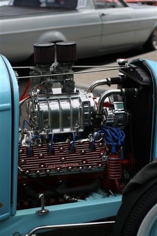

    Here's 2 from the Hunnert Car Pileup. The one in the black car sounded bad ass! P1010806 s.JPG

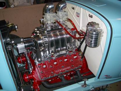

    Dave Tatom, flathead guru in Mt Vernon, WA <www.tatom.com> likes Whipples on flatheads a lot. Says that the lesser power drain, compared with a roots type, produces significantly more net BHP.
    Personally, I think there's nothing cooler looking than a GMC-blown flattie.
    Both of these are 3-71s, and I think FlatOz' 4-71 looks amazing.

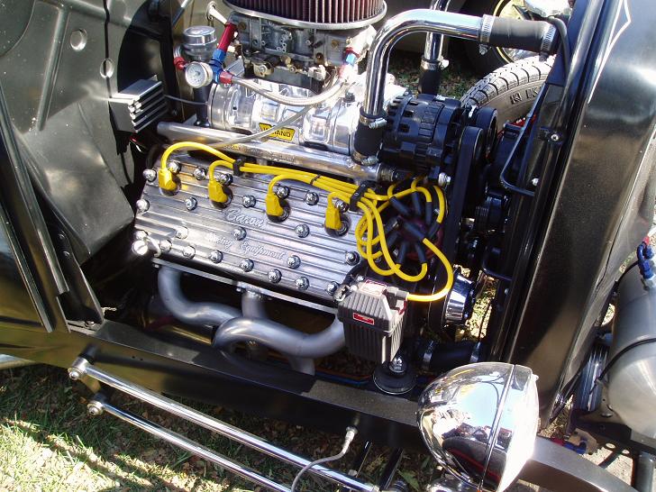

  12. While we're postin blower pix, here is the setup with the WW carbs....
    Rat
