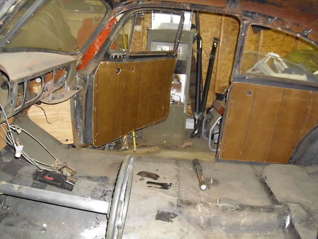

  10. Great tech Jake. I use 1/8" PVC board. I get it from a sign shop. It cuts very easily with a razor knife or any saw with a fine tooth blade. You can drill it, router it and it can easily be shaped with a heat gun and holds its shape. best of all its 100% waterproof. It costs about $30 a 4x8 sheet.
    Heres a panel I made for a 37 Dodge.
